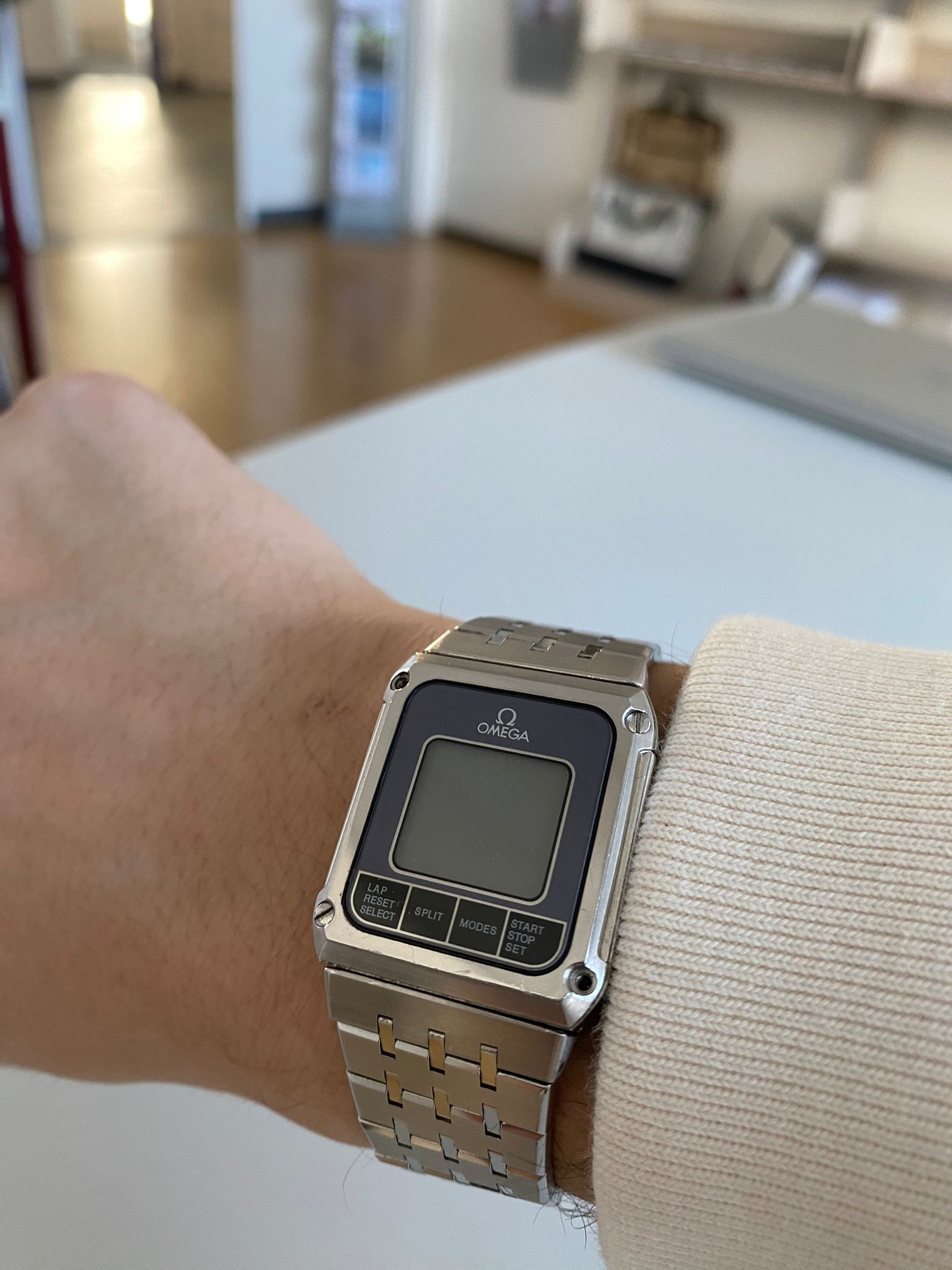

Hi everyone,
I recently bought this Omega Equinoxe at an unbeatable price but there are a couple of things to do before it's back on its feet. Mainly changing the battery but that's not too much of a problem. Where I'm struggling is finding two screws to replace the missing ones on the dial (see photo).
Does anyone know what type of screws this particular watch takes? I guess I'll buy some second-hand somewhere on the internet but I have to know which type to buy.
Thanks a lot in advance for your help 😉

So basically I changed the battery with a 391/381 MD Silver oxyde (which is what it takes according to a watch tool.net
After that, the digital side of the watch started to work again. Although some numbers don't show at 100% (I'm thinking this is probably a capacitor or resistor problem), that side runs fine and all functions are OK.
The problem comes from the analog side which won't work at all. I'm also thinking there is probably some sort of misconnection on the circuit board but to be honest, I have no idea. I wrote to Omega directly and they said they can't repair these old digital watches as the technology is too old and they don't have the resources (shame). I don't know if a conventional watchmaker could repair this as (same for Omega), it's old digital tech that's impossible to replace.

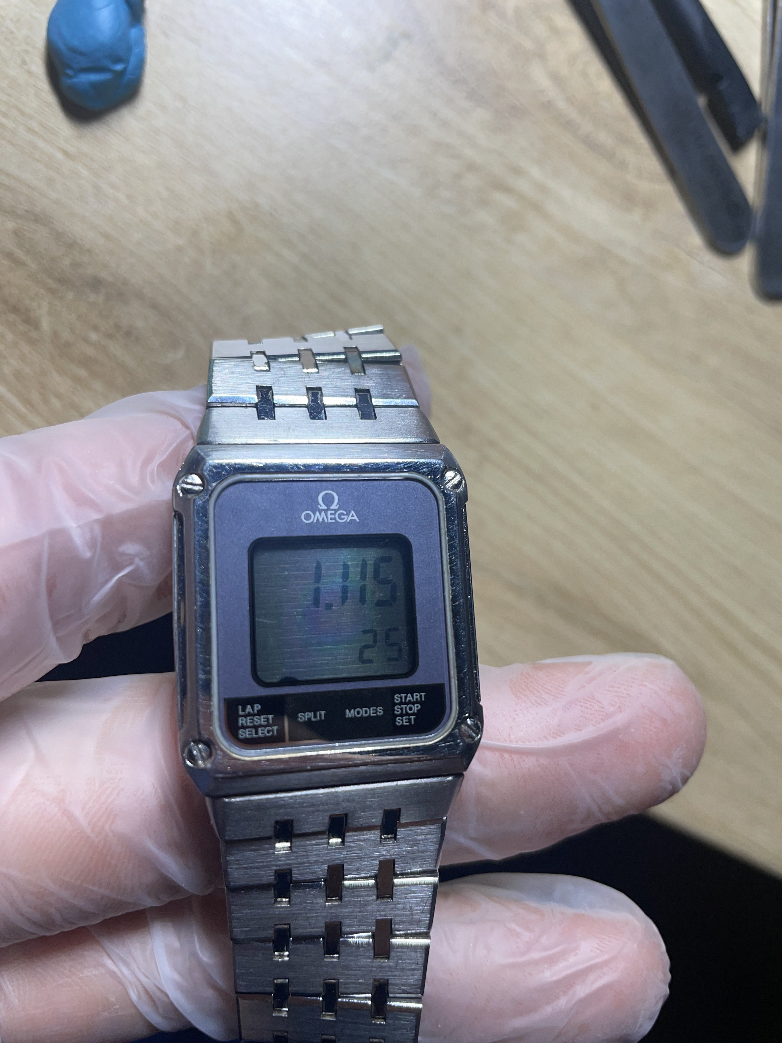

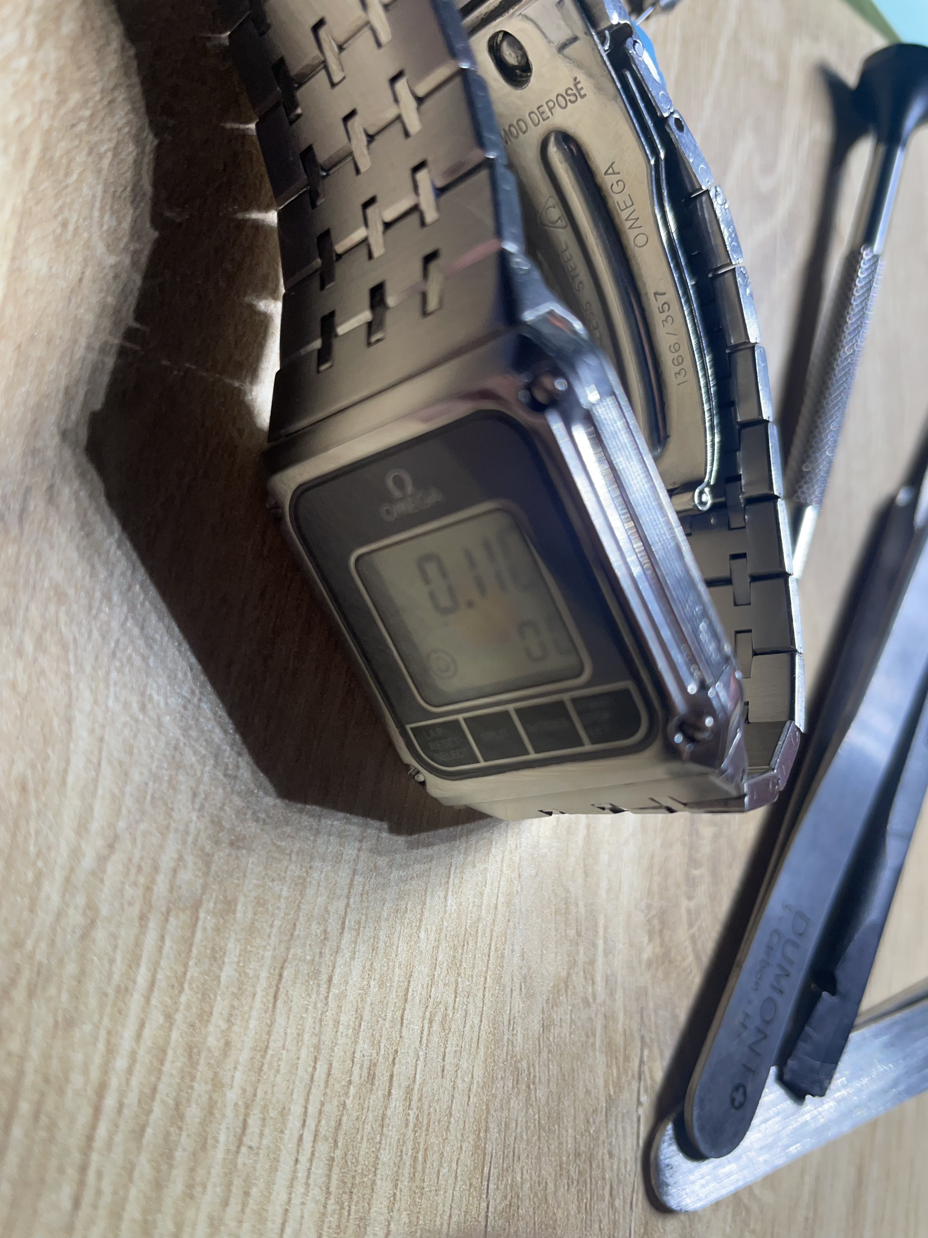

Hello, you look very familiar with the omega Equinoxe. Can you please help me ?
I just got one and I have a problem on the digital side. On every "screen" I have always the same thing, like two I or 1 or an H without the middle bar. For exemple for the hours I have " 1.II0 ", for the alarm I have "1.II0", for the timer I have "0. II0". I attached two photos.
Thank you very much for your help.

2,781
4,706
I can't for the life of me remember where I saw it, but It wasn't all that long ago I saw something about a simple trick that was used to get digital displays to show characters that aren't displaying properly, but I don't remember how they did it.
Sorry I know that's as about as handy as tits on a bull, but maybe it might trigger someone else's memory or at least give you vague direction in which to search.

Edit : the battery is new. I just also see that with the chronometer it shows 00 II0, upper than 10 seconds it's normal and after 20 it shows a weird sign (photo).
I add also a photo of the hours.
Thank you.
