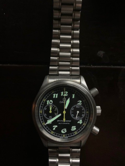

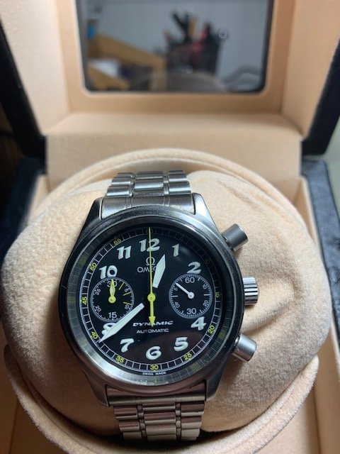

Hi,
I have an Omega Dynamic Chronograph which I bought around 2003. I have not worn the watch very much in recent years, but I had it serviced recently at a local Jewelry shop that works on Omegas. Despite the service, I continue to have issues with the power reserve. I start the morning rotating the crown CW about 40 turns. The watch is accurate as long as it is on my hand, but will generally lose power within 5 or 6 hours when removed. The service shop examined the watch and says that everything, including the main spring, is in perfect order; they think that the issue is with my activity. I don't believe this to be the case because my other automatic watch which has a 40 hour power reserve has no issues. The Omega, however, even died on a watch winder that I purchased for resolving the power reserve issue. I am not sure if a 40 degree angle watch winder, rotating clockwise and counterclockwise at 2280 tpd is suitable, but any ideas on what could be wrong or where I might be able to take the watch to resolve the issue. I am guessing that my watch winder added to the problem, but any ideas would be greatly appreciated. I love the watch and it is otherwise in perfect condition.

That model uses a modular movement with separate chrono and timekeeping units piggybacked. It is very similar in that respect to the Speedmaster Reduced. Independent watchmakers without parts account have no access at all to the parts for the chrono module. As a result most won’t touch that part of the mechanism which can lead to issues since the hand drive passes through this so even if the timekeeping movement is serviced and a new main spring fitted it can still run badly. Even those watchmakers with parts accounts can find these troublesome since there are no parts at all for the chrono module, it is entirely replaced at service time. Find a better watchmaker who will service the chrono module or pay up for an official Omega service. There is no other option with these, a part service is really no service at all.

What @padders said and no matter what you do, lose your watchmaker. Your activity is completely irrelevant for a power reserve of 5 (!) hours after 40 manual turns. It’s them being either lazy or incompetent.

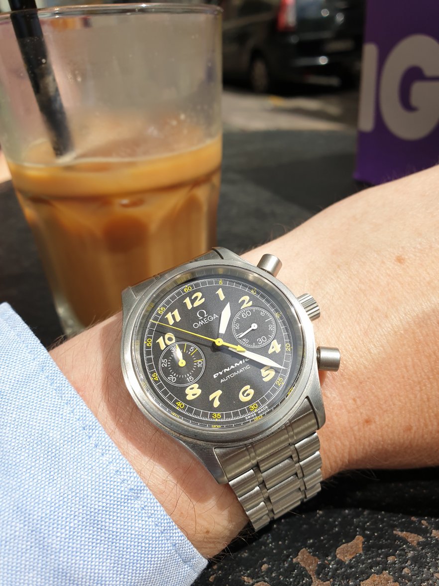

ps note that Troels version looks to have the older Tritium lume, more care is needed with parts changing there as a mismatch can look bad.
