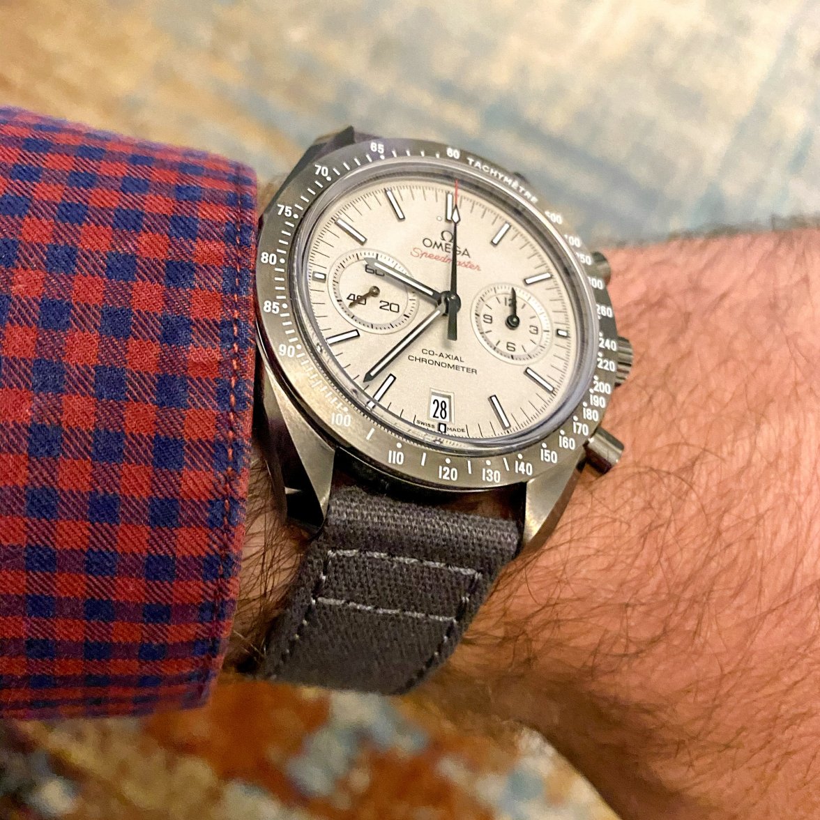

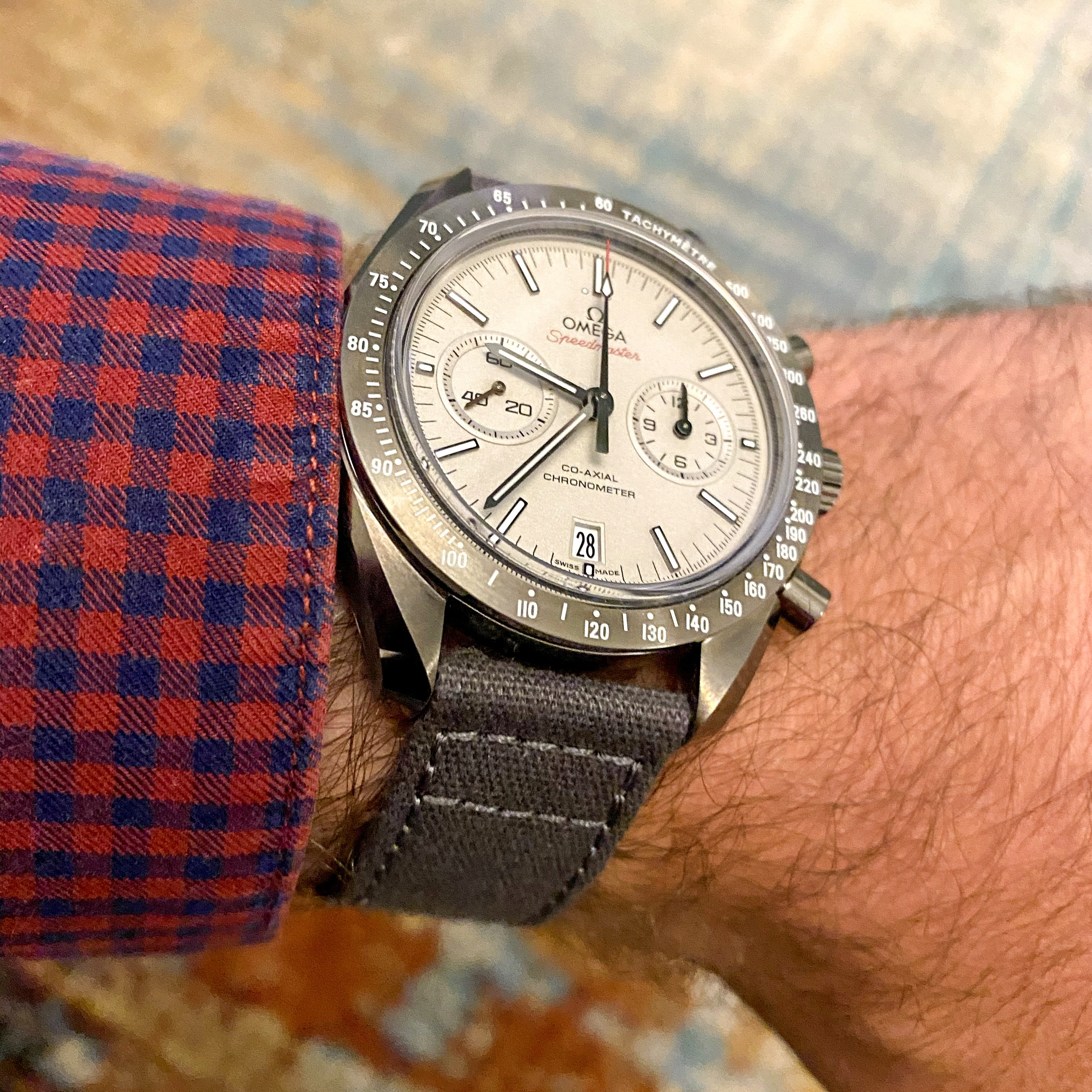

BTW, what nylon strap do you have in that first photo? That looks like something I would like to get.
44
53
It’s a Barton canvas strap in smoke grey. (Barton watch bands) You can get it from their website or from amazon. 20 euros, quick release and they come in 21mm.

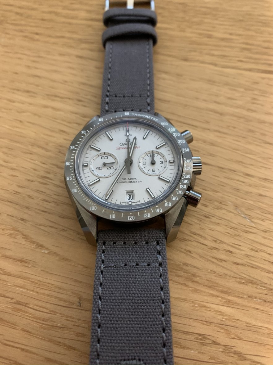

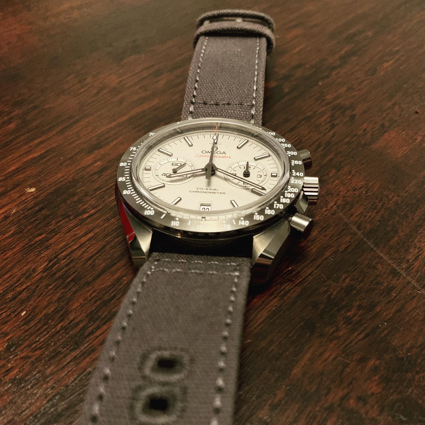

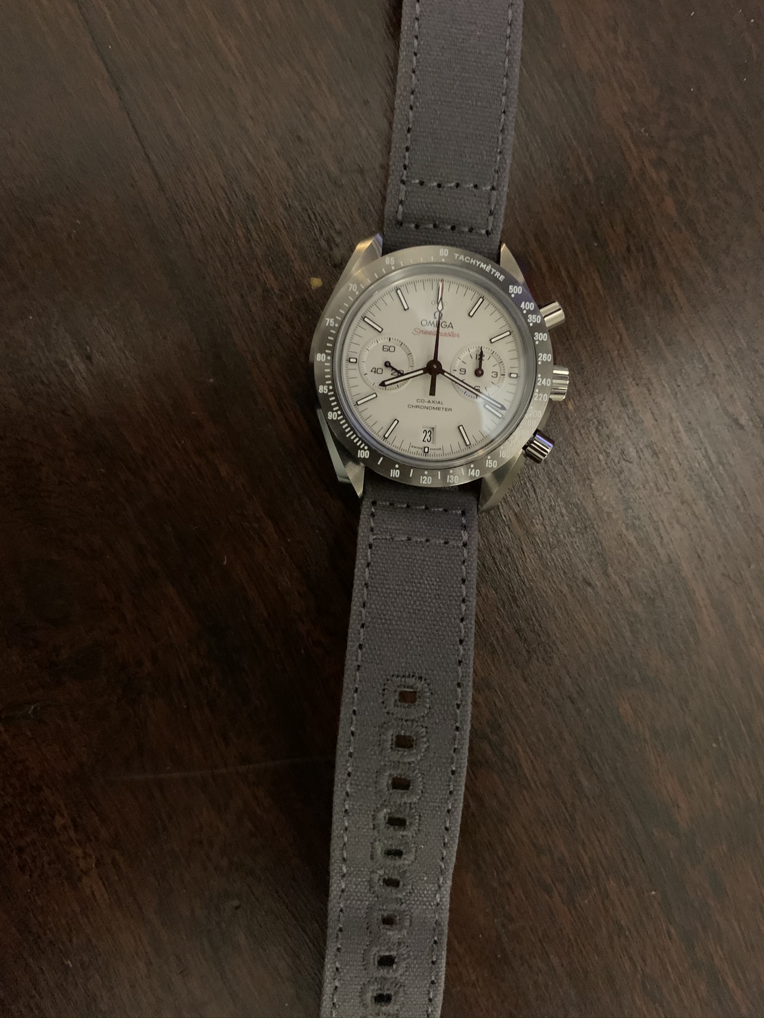

edited to add more pictures:

Wanted to follow up with a new observation that supports my hypothesis that it’s not the clasp but the thickness of cordura deployant straps that is causing the issue.
As I stated earlier in the thread, I could replicate this problem when I had the clasp of my Seamaster 300 MC on the DSOTM cordura strap. I switched out for the original Barenia strap this morning and tested it. It will not open with a single push. Both have to be depressed. The leather is at least a mm thinner than the cordura.
