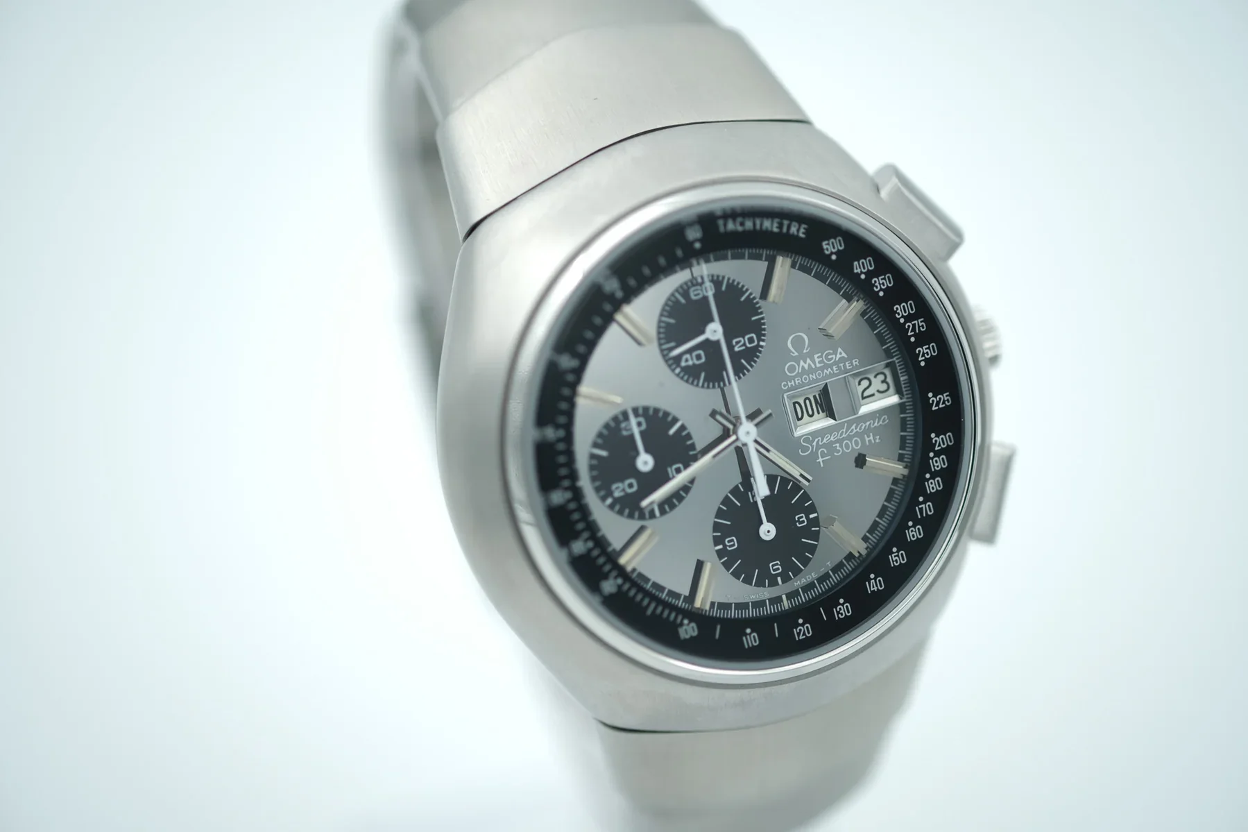

Hello.
I'm looking for an OMEGA Speedsonic f 300 Hz "Lobster".
This foto belongs to: https://artisansoftime.com/products/omega-speedsonic-lobster-ref-st-388-0800
My current knowledge is mainly based on this video clip:
And of course, I've already looked at a lot of pictures on the internet.
And of course I've already read a lot (maddox, old omegas.com, etc.).
And I have now made four unsuccessful attempts to buy such a watch.
I would be thankful for any helpful information.
Kind regards
Smilla

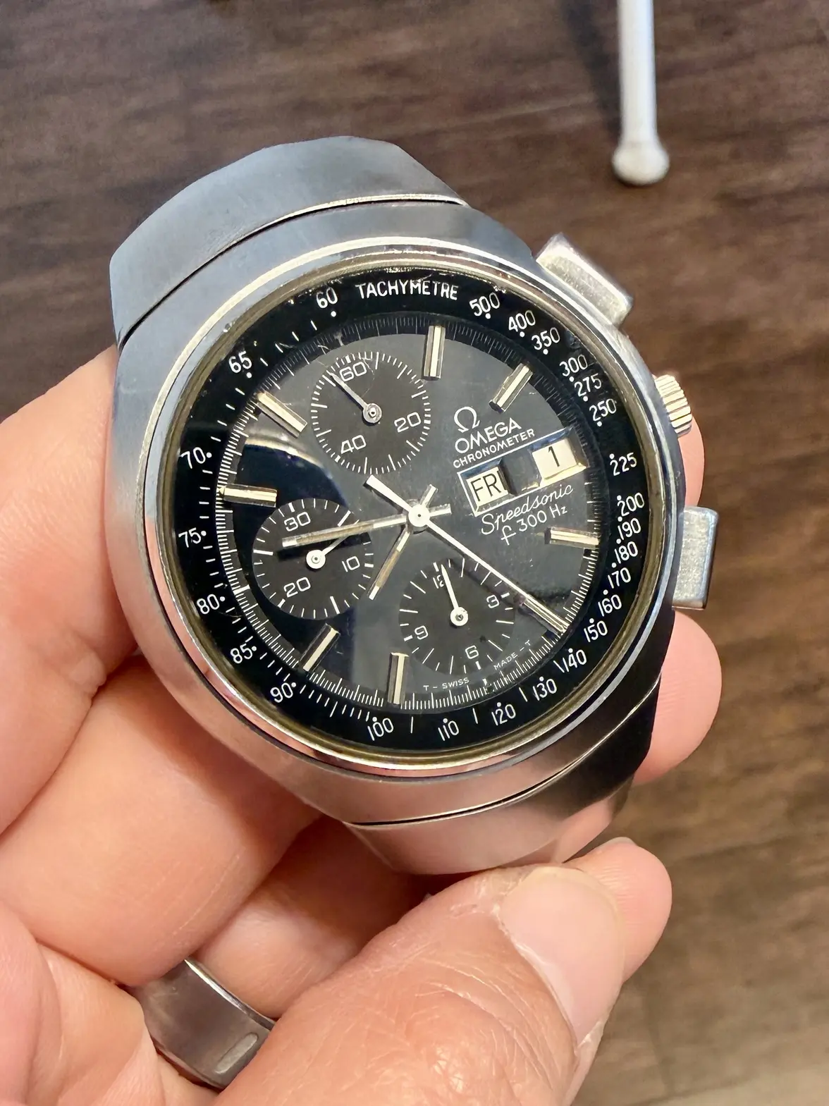

Hi there,
I just found one in Chrono24. Received today. Very cool piece. Do any of you know how to size the lobster bracelet?
Any luck on your end Smilla?
