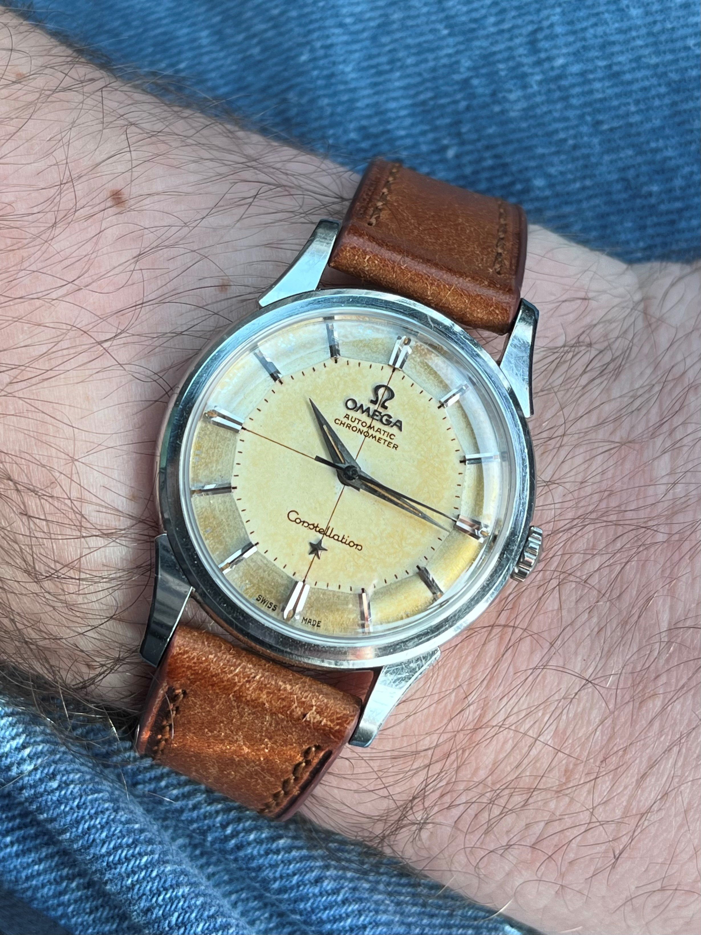

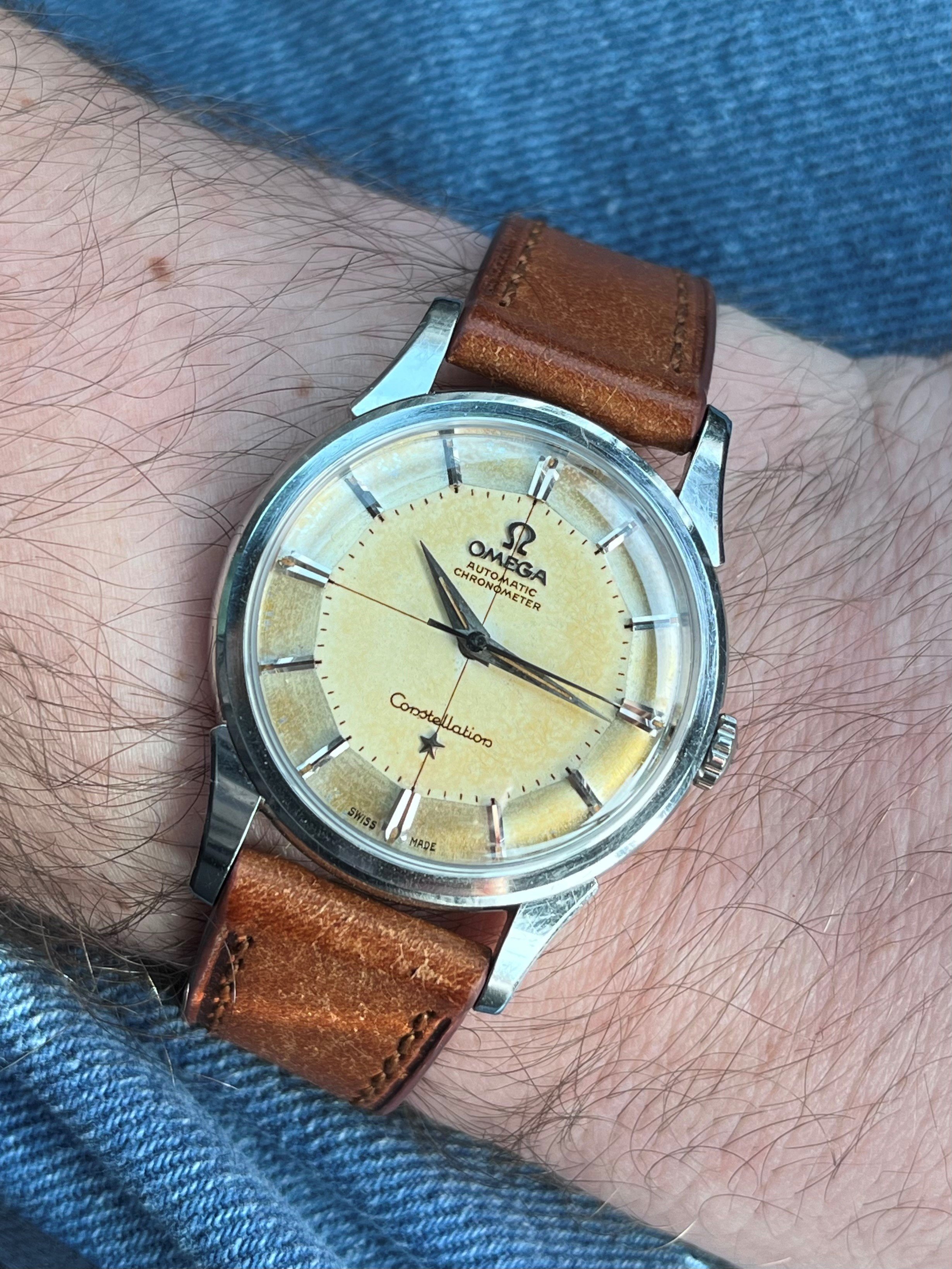

Okey so the watch is now running a bit slower due to a regulation and I think it looks ok. I think the lume kind of matches the lume pips at the end of the indices and the patina to improve the overall aesthetics. Maybe not the best lume work but at least it looks a bit older to match the age of the watch a little better...
Happy easter from Sweden! 馃榾

I think the lume looks a lot better. One thing I don't like is seeing fresh lume (white, or light green) on a vintage watch.
Very nice watch overall, IMO.
I agree on fresh white/green lume, and thank you very much! Kinda needed that 馃憤

Indeed looks perfect from this angle, congrats

And a very nice choice of strap too. Goes well with the patina tint of the dial.
60
60
Thank you I鈥檓 very pleased with this strap, it complements that dial tone real nice! I do want a original reference correct BoR though 馃憤

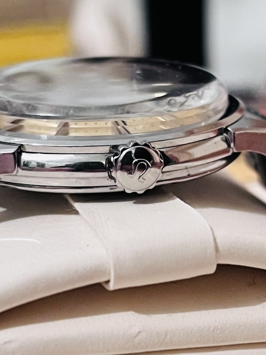

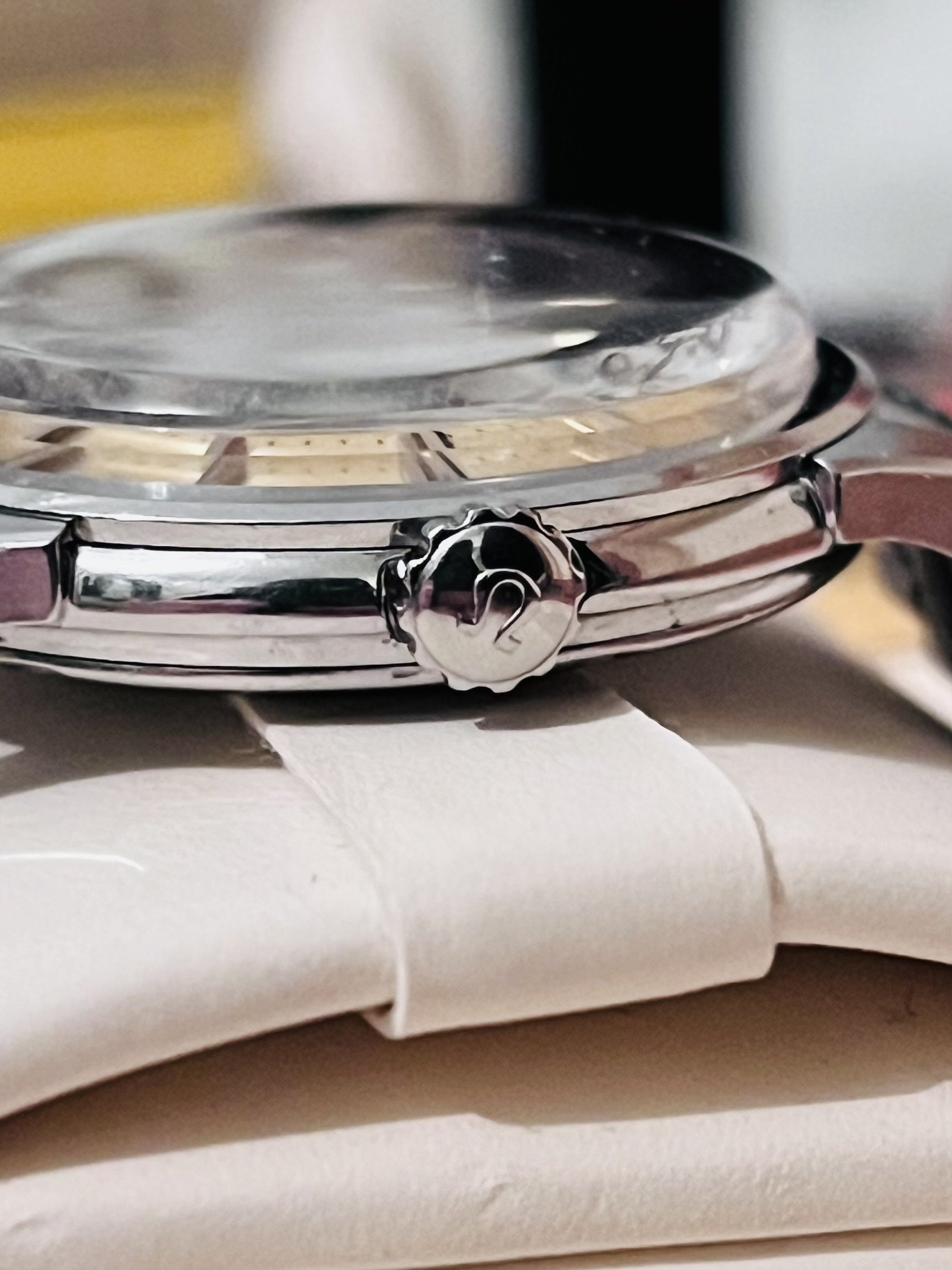

Forgot to mention that my watch maker gave me one extra NOS scalloped crown as a consolation, that if he retires I still have one original crown for future service 馃榾 I know they are pretty hard to come by, so to have one spare (plus my old one if it鈥檚 still possible to use) is a bonus and a nice gesture from him. He did notice from the beginning that I鈥檓 not the biggest fan of the replacement crowns so he did walk that extra mile to find me a scalloped crown to replace my old one with.
I have been wearing it every day over the Easter holiday and I am very impressed. Keeps excellent time now after being regulated so that鈥檚 great 馃憤

Very well done, looks great now and I like very much your strap choice too.
Wear in good health 馃榾
