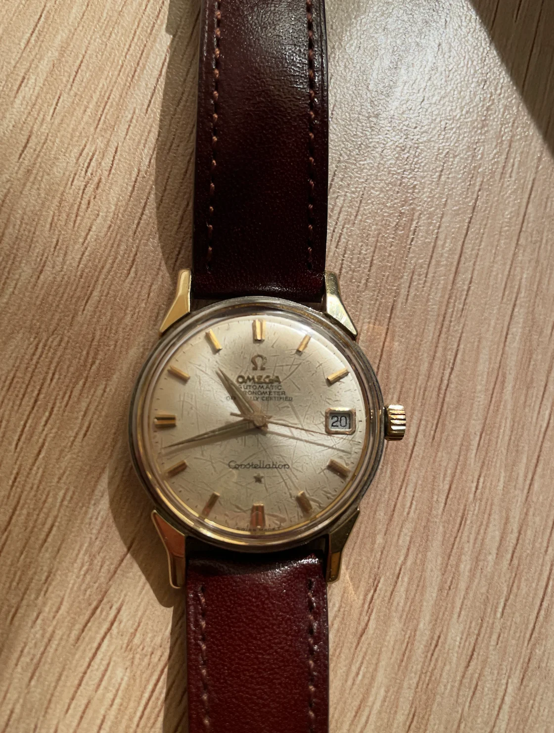

Dear forum,
I am new here, I am searching for the exact reference of this watch (see picutre) that my wife inherited from her grandfather. I came somewhat close by looking at the reference 168.004 but there are some slight differences on the dial, the indexes for the minutes are on the outside, etc. .. so I imagine it is probably close to that date and/or model? Also I could not find so many Constellation models with two little bars at the 6 index. Hopefully that makes sense and some brilliant expert here can tell me 馃榾
Second of all, I am trying to find the upper part of the case that is missing on the watch. Where could I find it and what would be the approximate cost?
Thanks for your help!

welcome @bertiber
you have a dome-dialled gold capped 168.005 - commonly known as a 'dogleg lug' case.
Finding a loose bezel will be almost impossible.
They were made of solid 14k gold and the likely only option is to have one made.
hope that helps

here is a link to a previous thread on missing bezels, with a possible option for a manufacturer

welcome @bertiber
hope that helps
Indeed being gold makes it a bit easier as its a pretty forgiving metal to work with, getting one made shouldn鈥檛 be all that hard as I鈥檝e even had solid gold pushers re-manufactured in the past.
