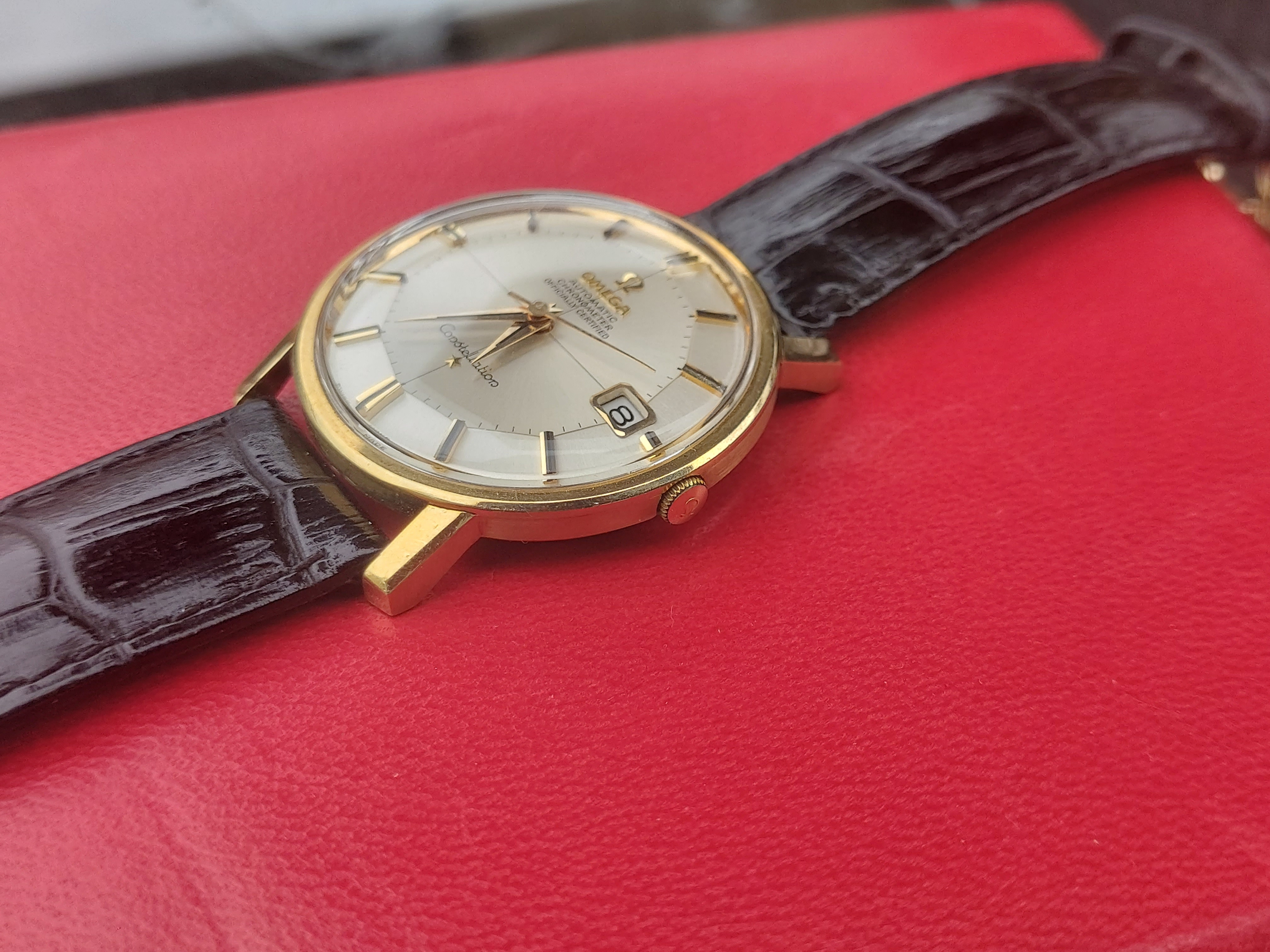

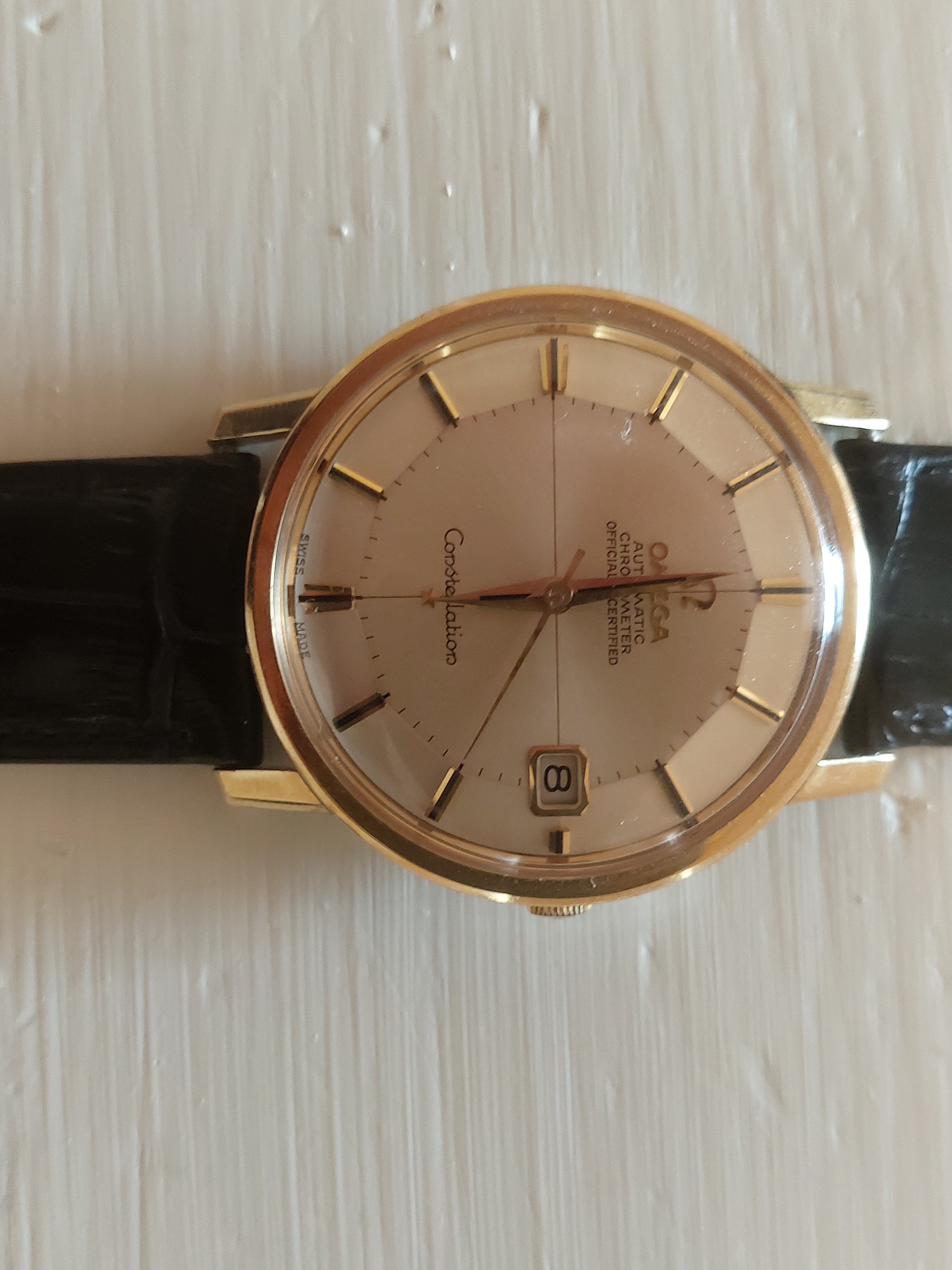

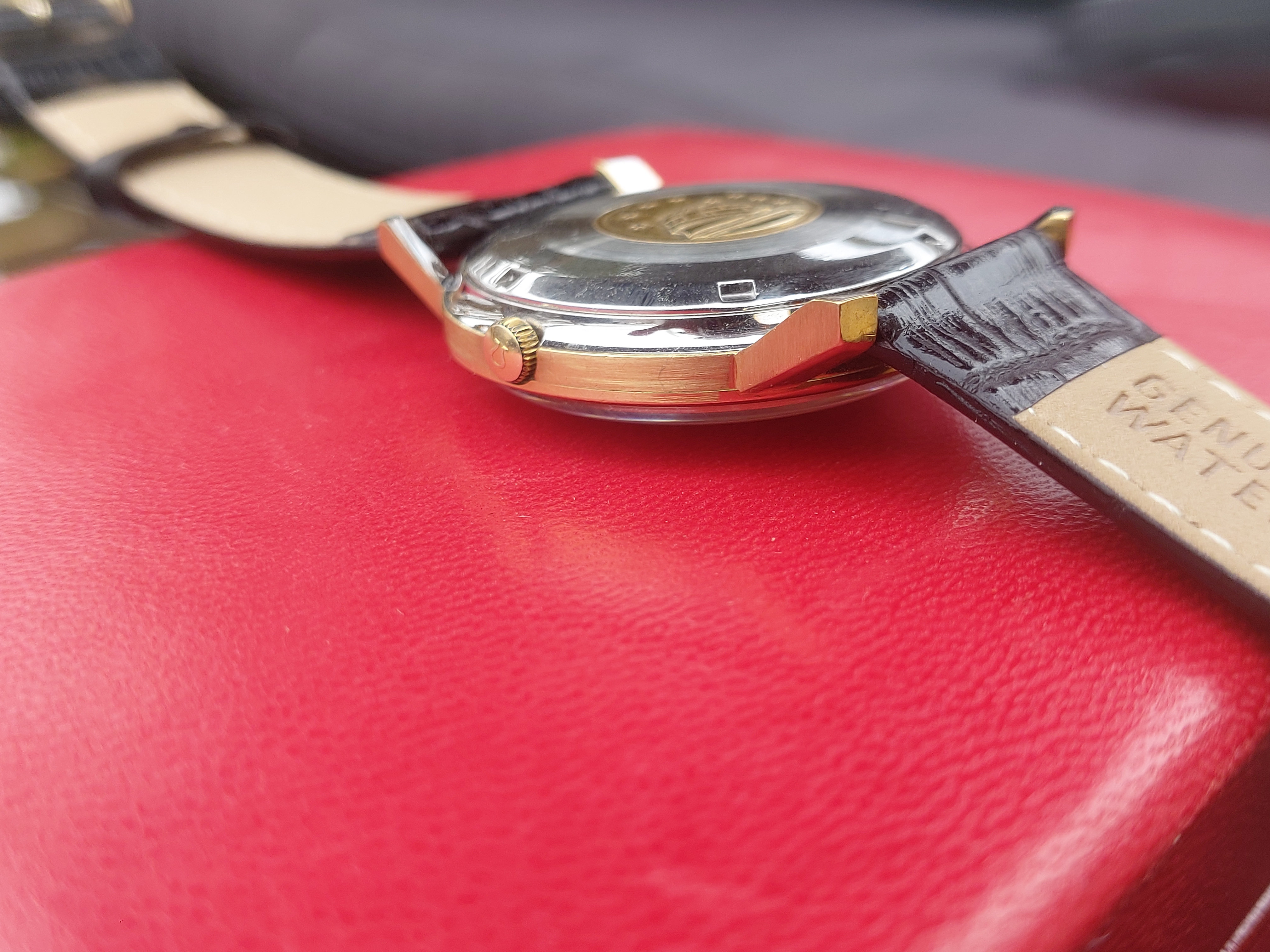

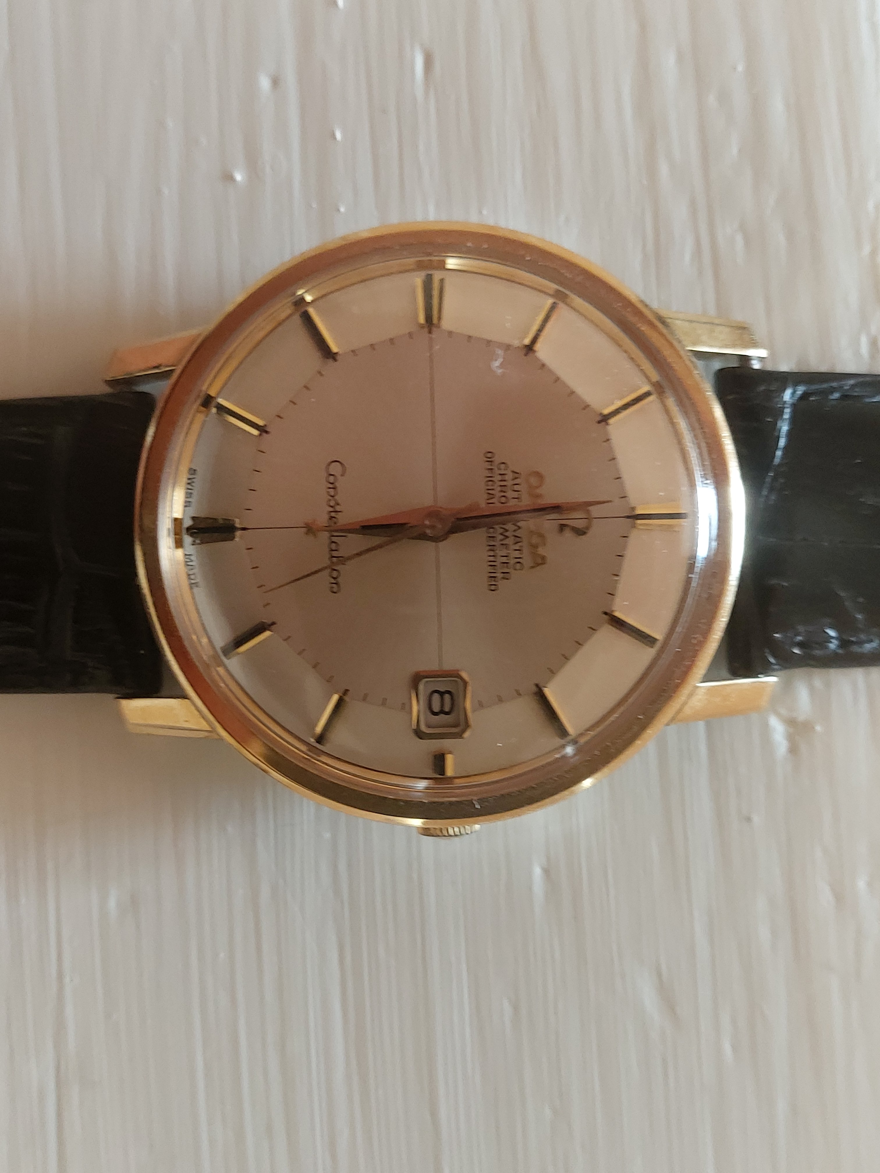

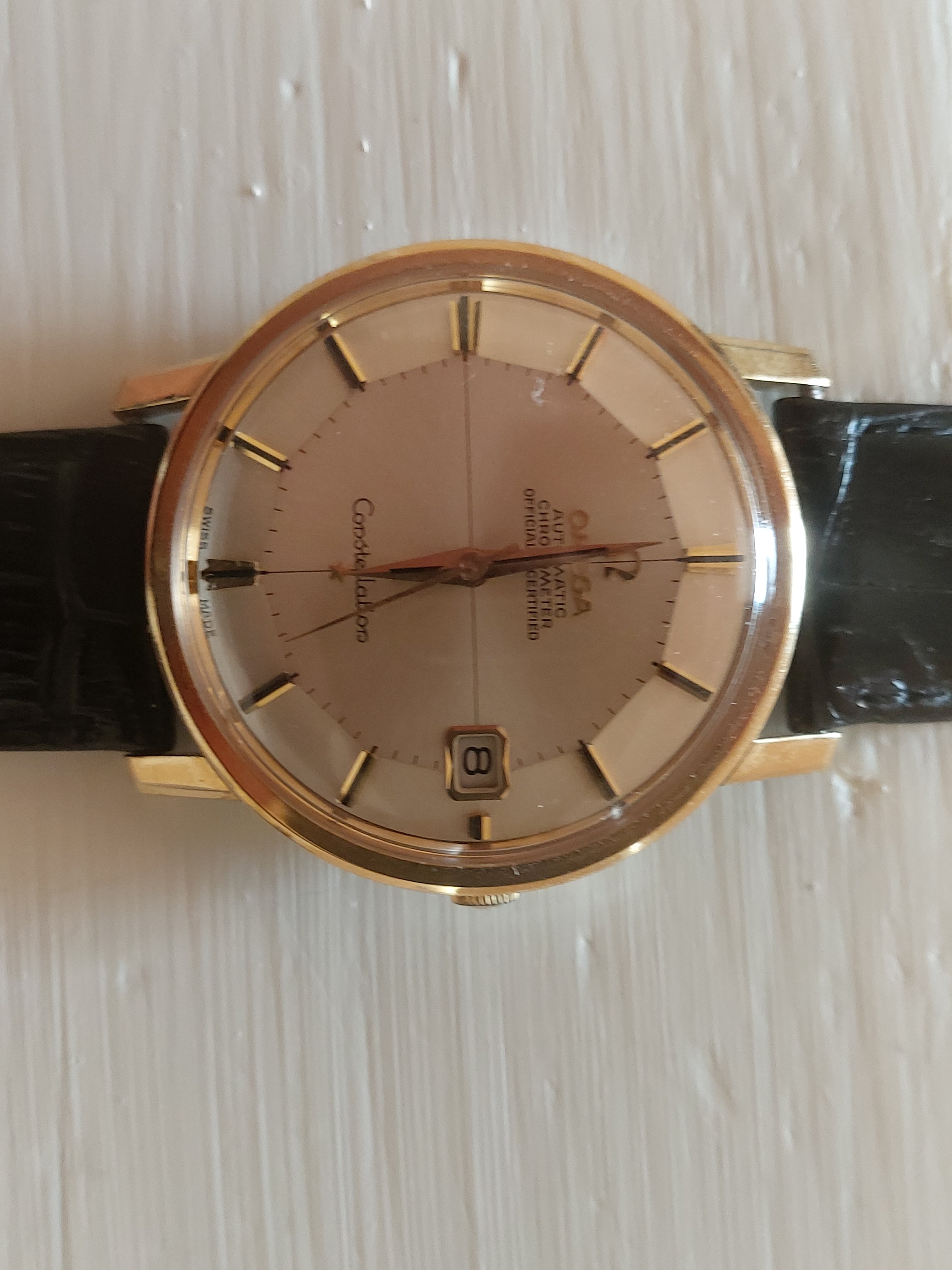

Hello all! I found an Omega Constellation Piepan 1966 and I instantly fell in love with it. As I am new to this universe I am not sure that I found a good example, but I think I did. Is it possible to upload some photos somewhere on this forum and get an exprt opinion from some of you guys?

Thank you! Being totally new, I have tried to make my own assessment based of what I have learned so far. The Omega seems to be unpolished, orbpolished by a trained Omega poliser as it seems to have all surfaces in correct order. Watch got no papers or service history but runs great and accurate. Seller showed me inside of watch and it looked shiny and new. No scratches on automatic movement and such. Screws looked new an untouched. Crown runs smooth when winding. So given all above plus it has aftermarket wristband. I rate it 6/10. Please give me you thoughts.
10,125
57,953
The watch has been polished, but I’ve seen much worse. We need straight on photos of the dial and the exterior case back taken in natural light, as well as photos of the movement and the inside of the case back, in order to properly assess the watch.
2,587
3,883

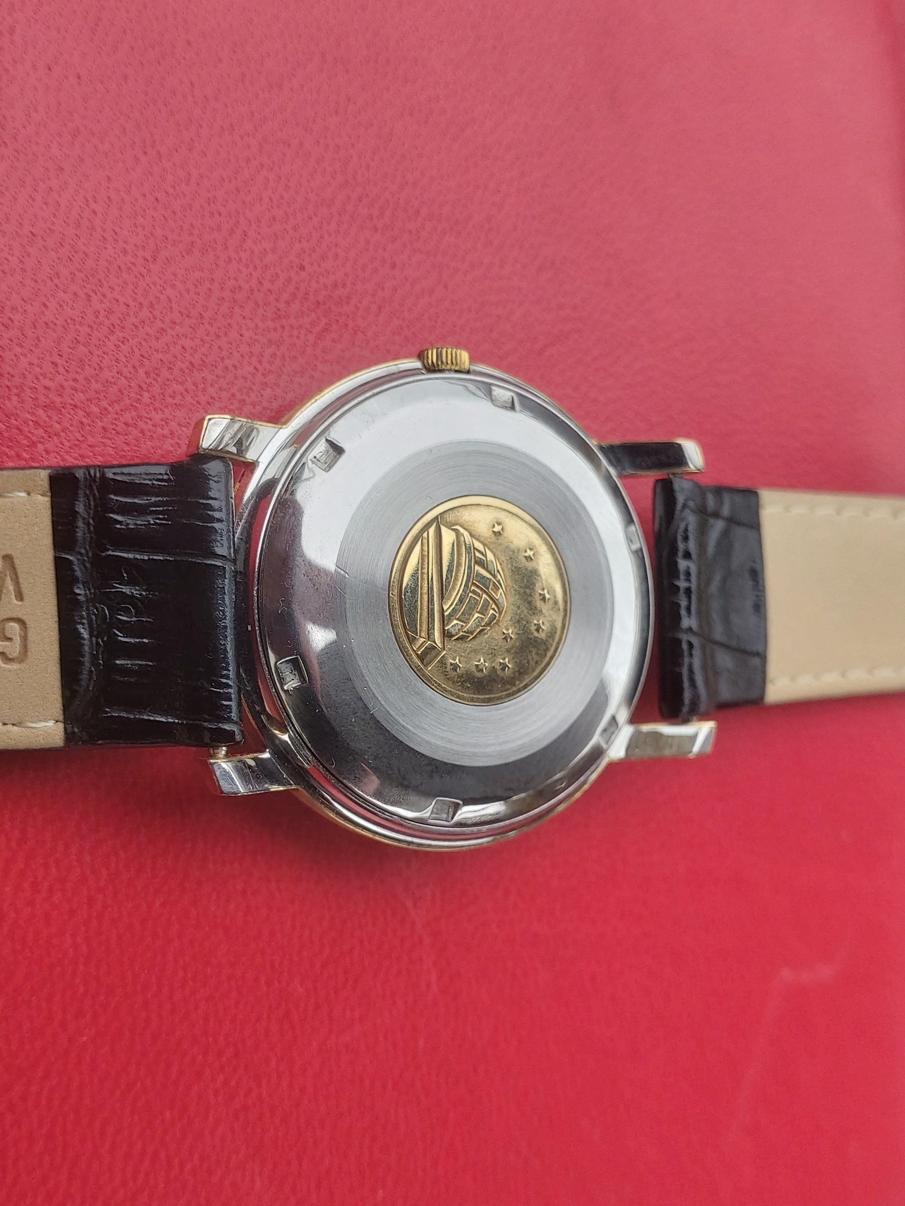

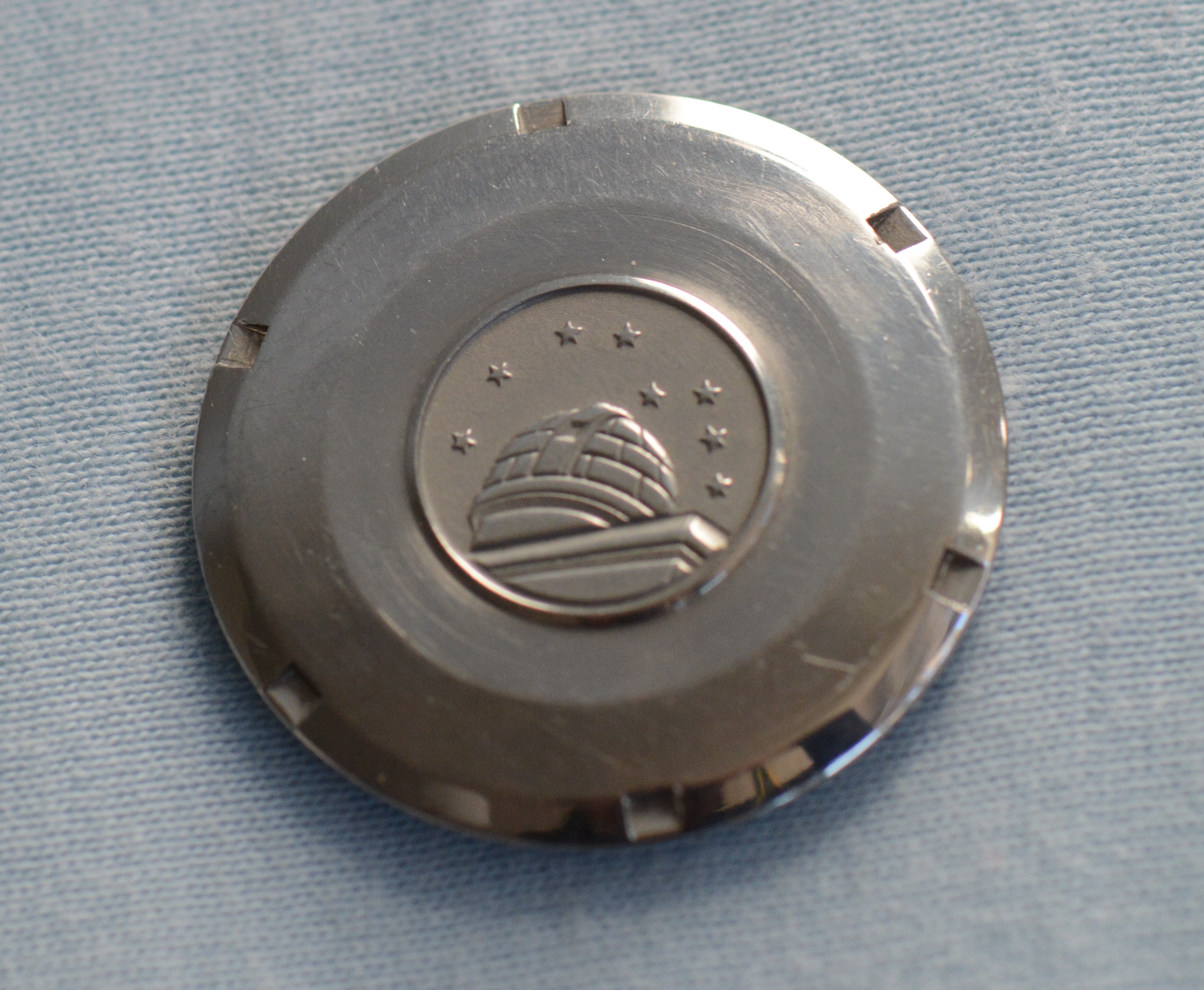

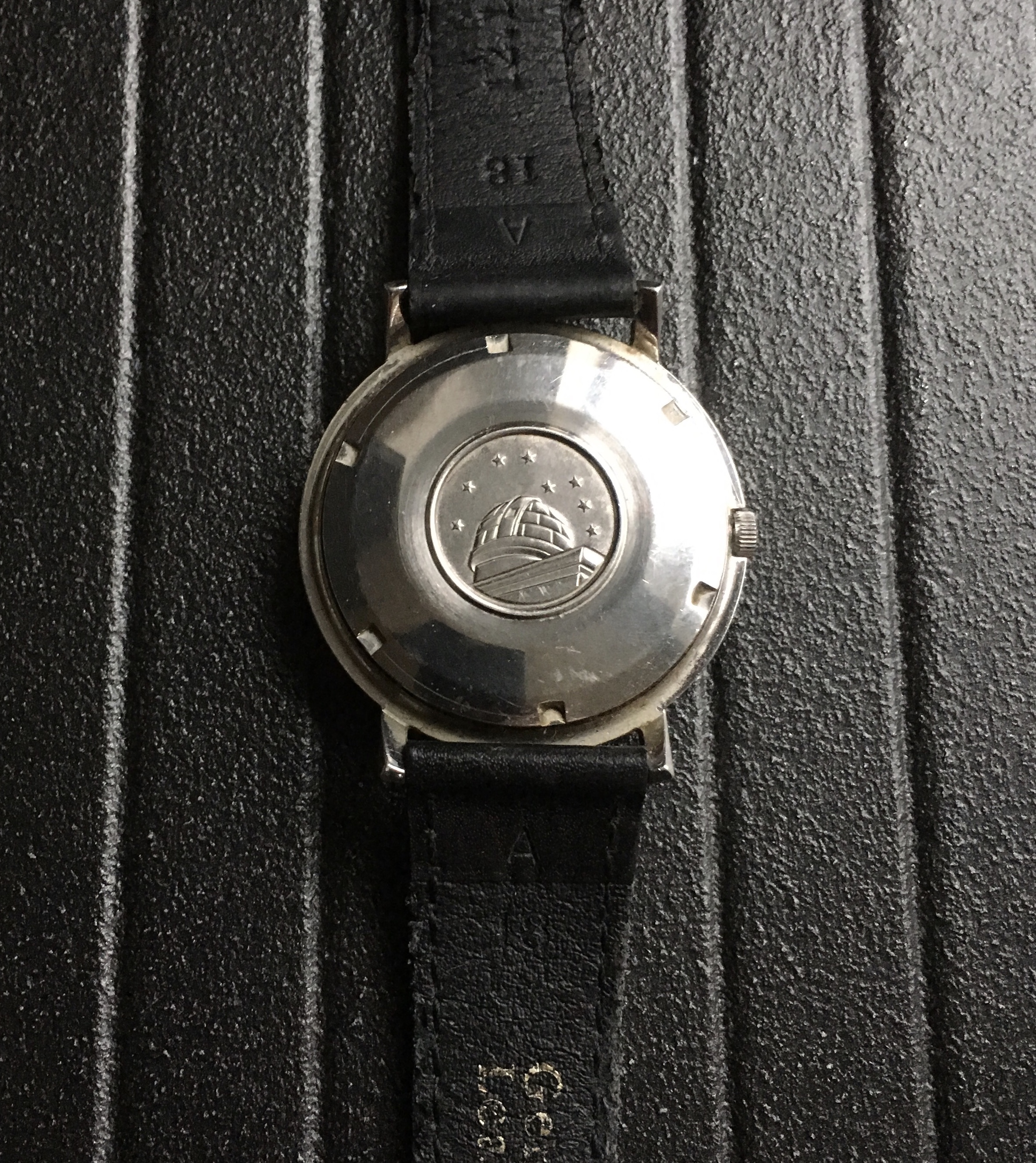

The back also looks like it may have had some engraving turned off by a lathe.

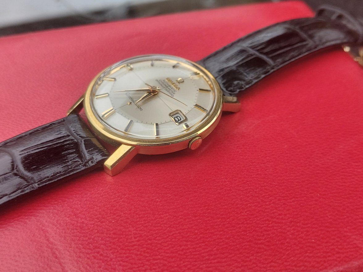

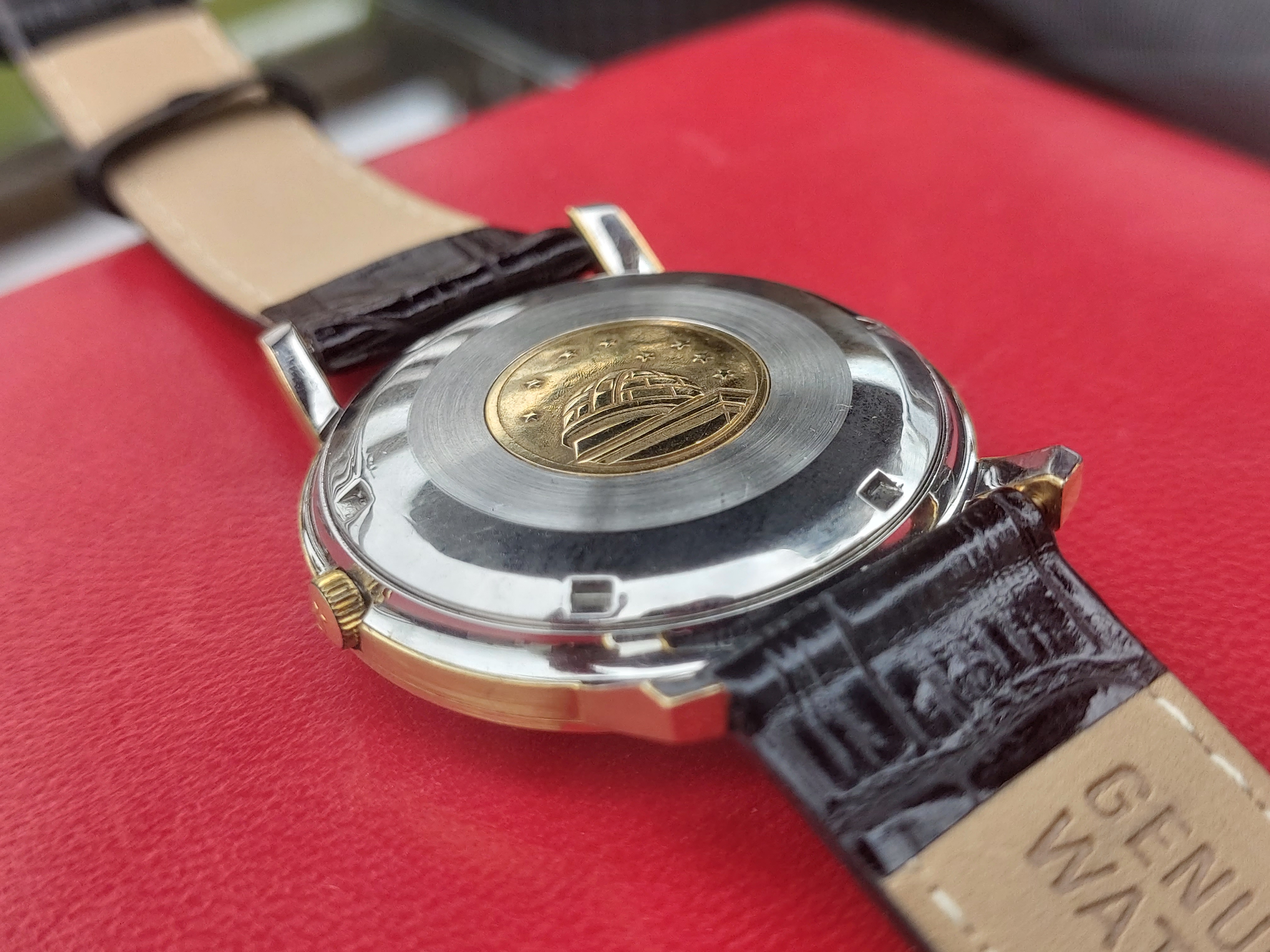

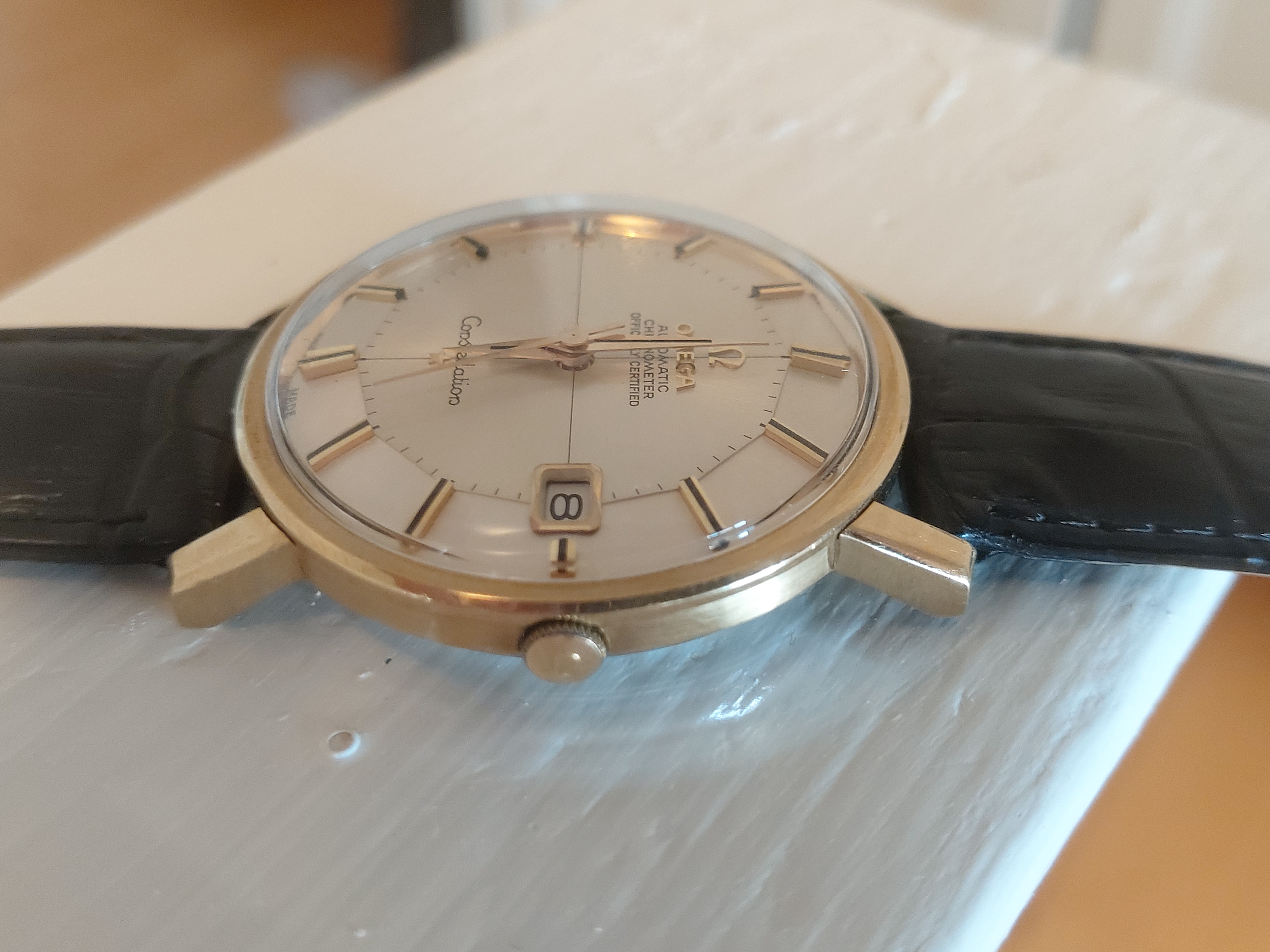

Thank you! Please find addional photos. I dont dare to open it. As I have never done it Im afraid I might scratch it or so. So have to december what I was shown, which to me looked as a shiny, clean and scratch free inside.
1,306
5,826
Was gonna write just that. The contrast of the finishing of the flat part to the beveled part is very stark. Plus, while they managed to preserve most of the medallion, the edge seems flattened out.

More straight pictures indeed (sorry you were faster)... and from the movement too.

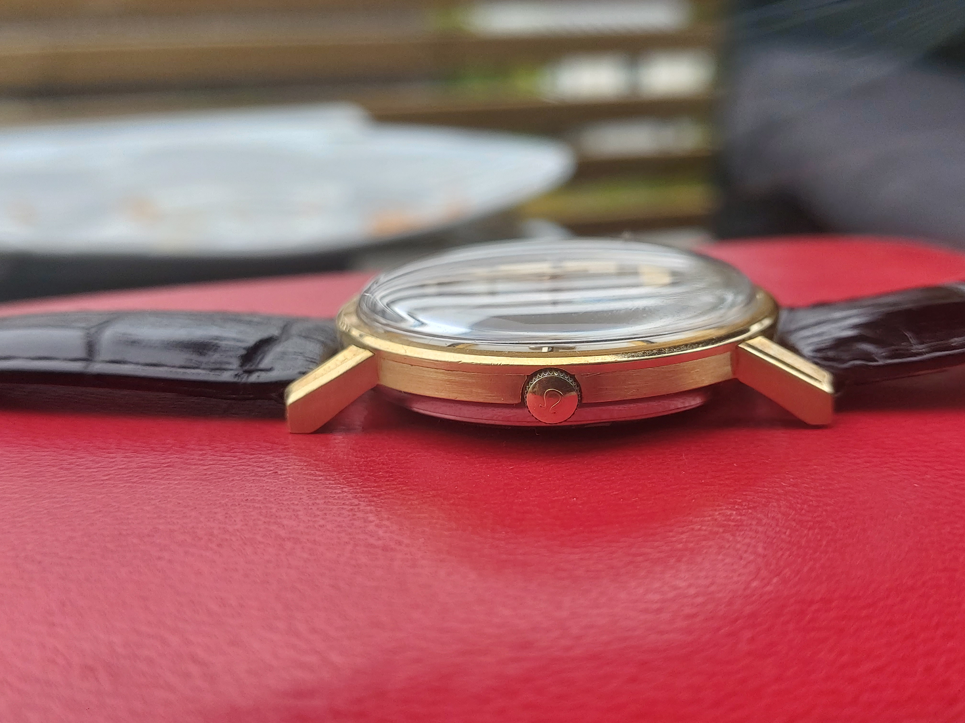

Not sure about the crown, but others will surely be more knowledgeable to advise.
2,587
3,883
Should the star be that close to “ constellation “? I’m learning too.

Thank you all. So I have learned now the the lathe is not original finish as I believed... also that i need to learn to open it But crown is original right?
1,306
5,826
Do you perhaps have a picture without the hands covering the text and the star on the dial?
I believe the crown to be correct.
I would love to hear @Peemacgee 's opinion. He doesn't like us calling him an expert on this reference (which I believe is a 168.010), so I call him extreeeeemly knowledgeable 😀.
6,835
10,505
The 'turned' section on the rear is correct for this reference, as is the flattened edge to the medallion - yes a 168.010 @iamvr. 👍
The proximity of the star to constellation is also correct.
The crown is likely original as it only protrudes a little on the 168.010.

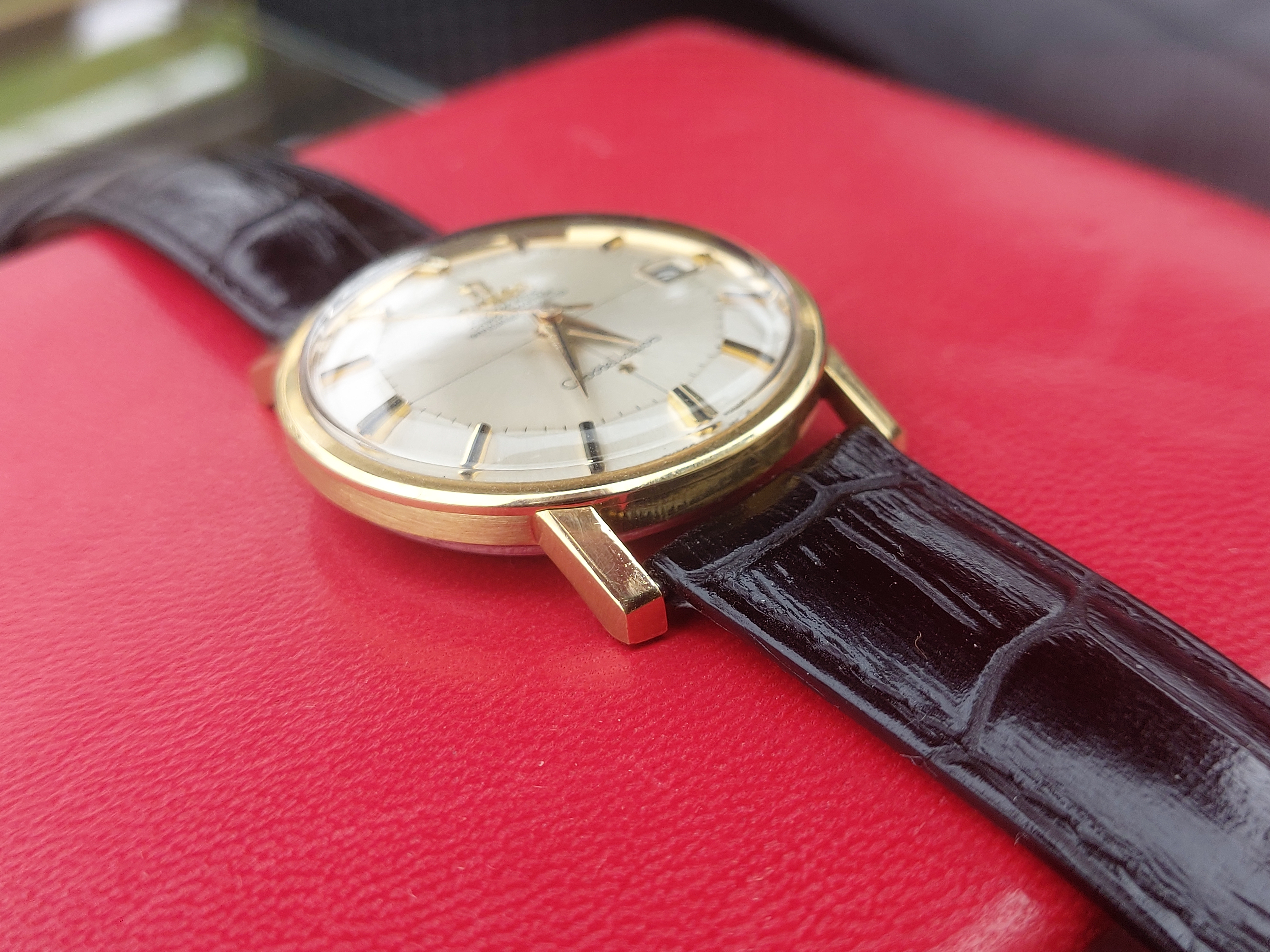

Although the lugs look a little soft in some angles, I suspect this watch looks better in reality than in the pics.
Congratulations OP but you do need a 19mm strap to for those lugs though 😉

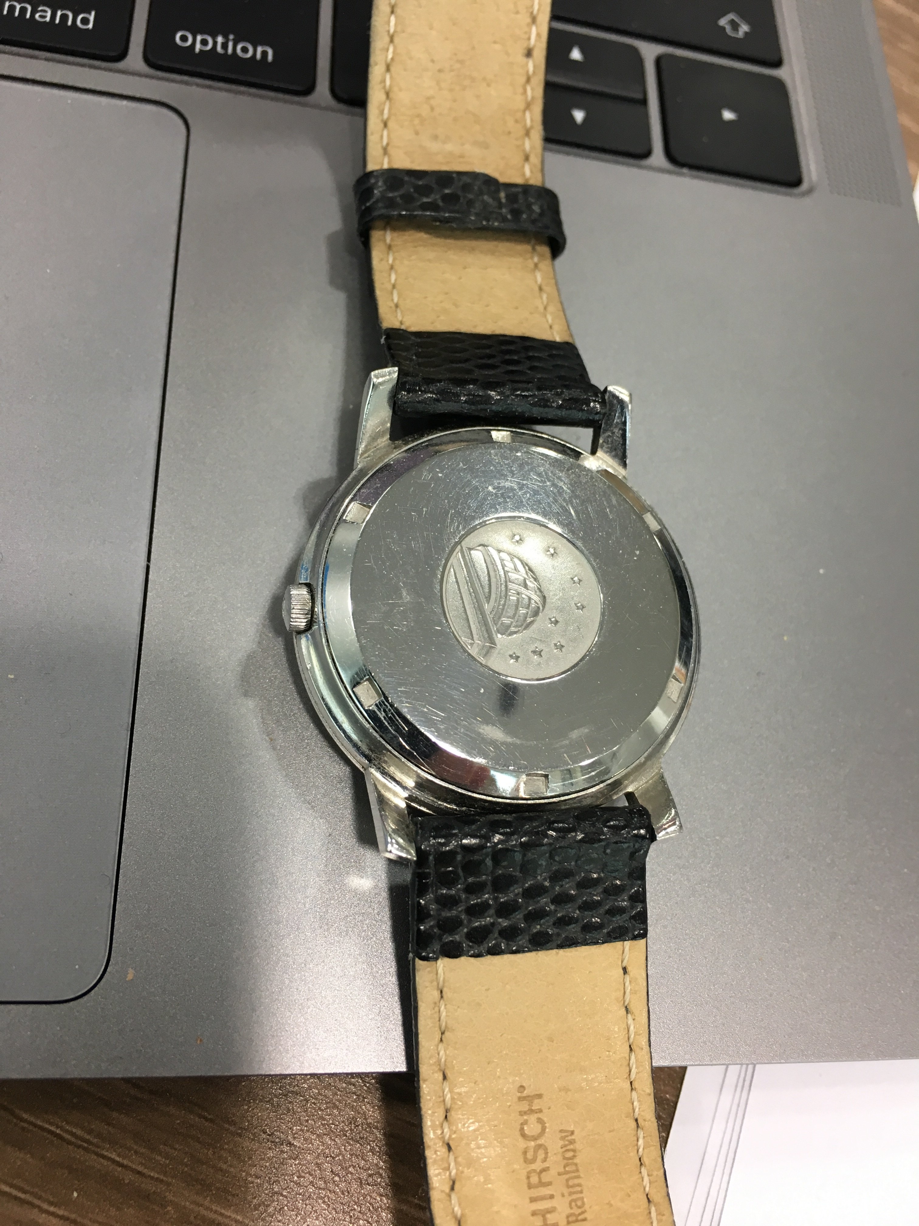

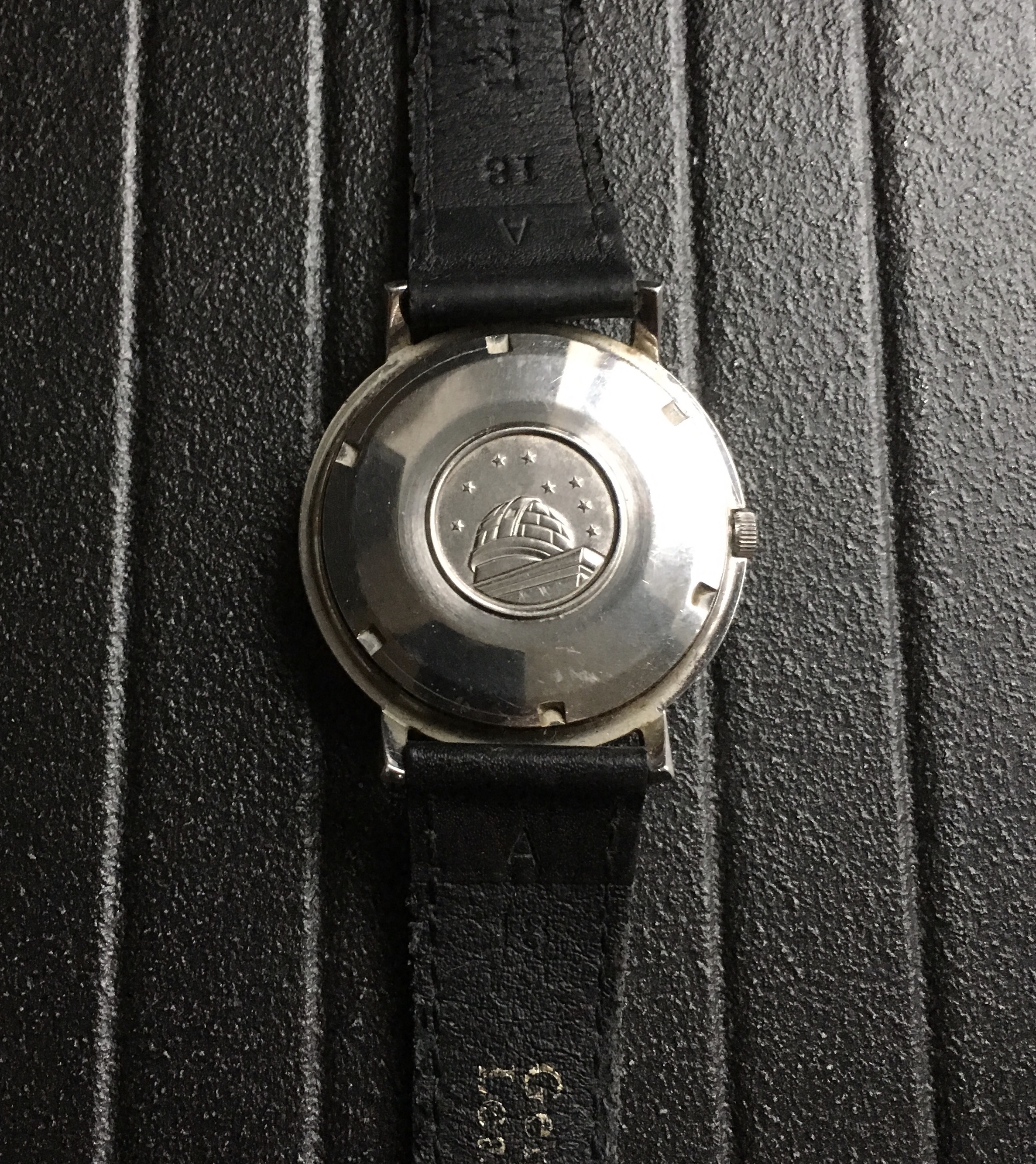

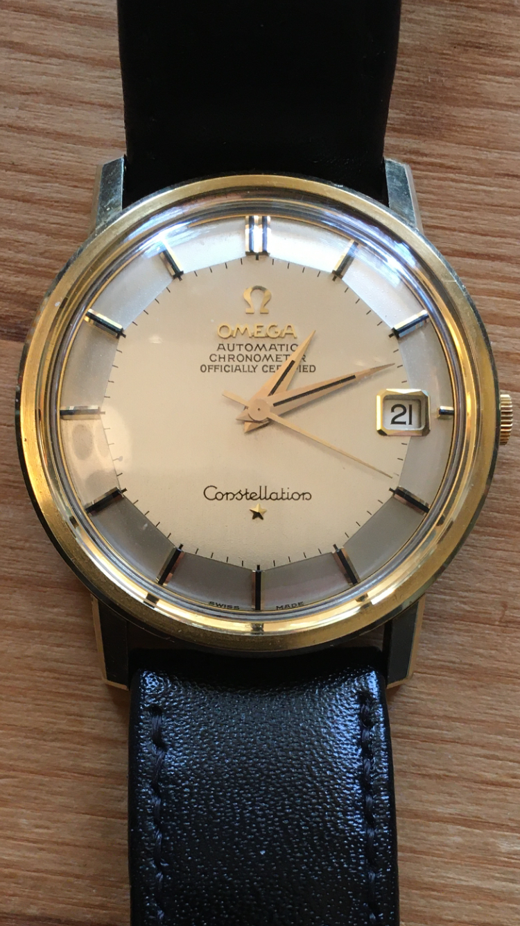

My non-crosshair version of the same watch (notice the thicker replacement crown for reference)
serial 24,241,xxx ~'66/67
1,306
5,826
Many thanks @Peemacgee for sharing your exper... erm knowledge time and again illustrated with an example of yours.
It's again a lesson not to infer conclusions from a stainless steel to a gold cap version. I've made that mistake before. The turned section on the case back of my SS 168.010 is not that pronounced and the edge of the medallion is thicker.
3,596
13,553
Many constellations actually had the turned circle around the medallion originally. It’s just that we don’t see them often, because they were polished away / worn off over the decades.

Could be different years or different case makers.
The early .010s were a transition from the .004 and even carried the cal 561 movt.
Although I believe, like yours, they always had the brickwork observatory

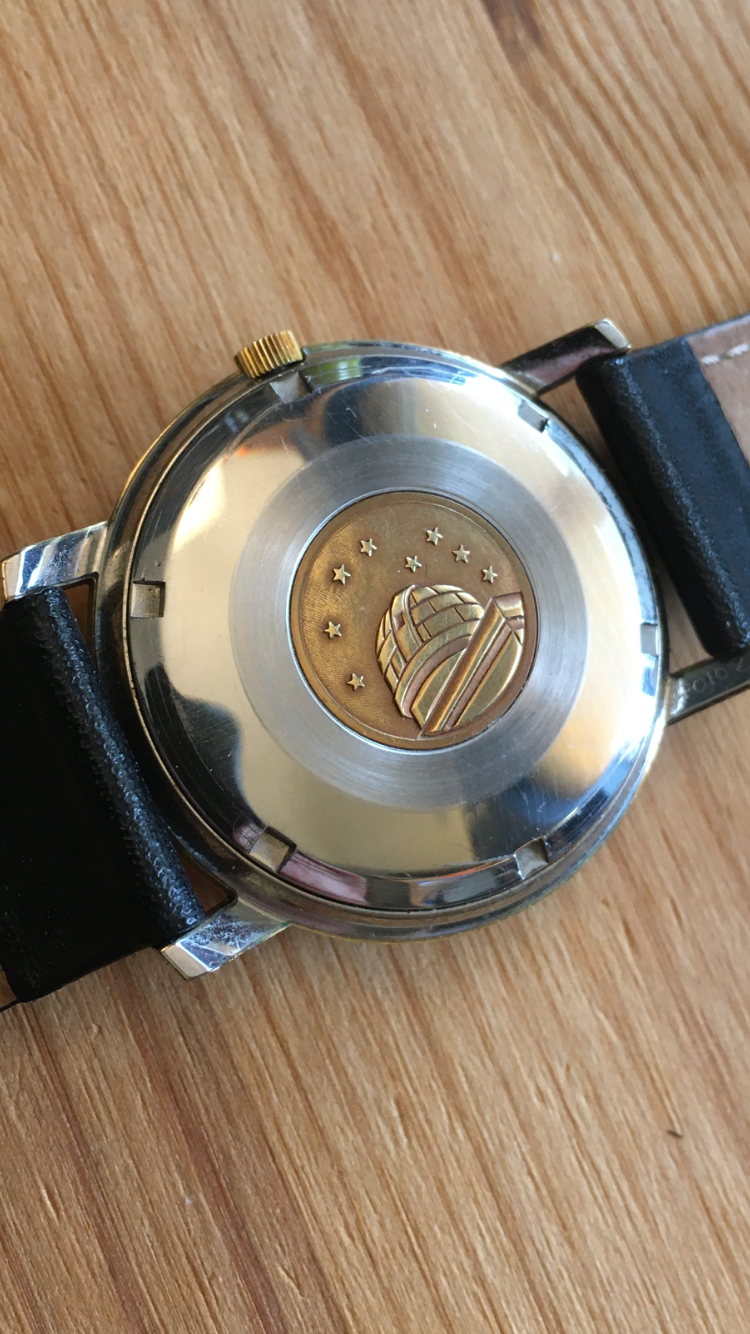

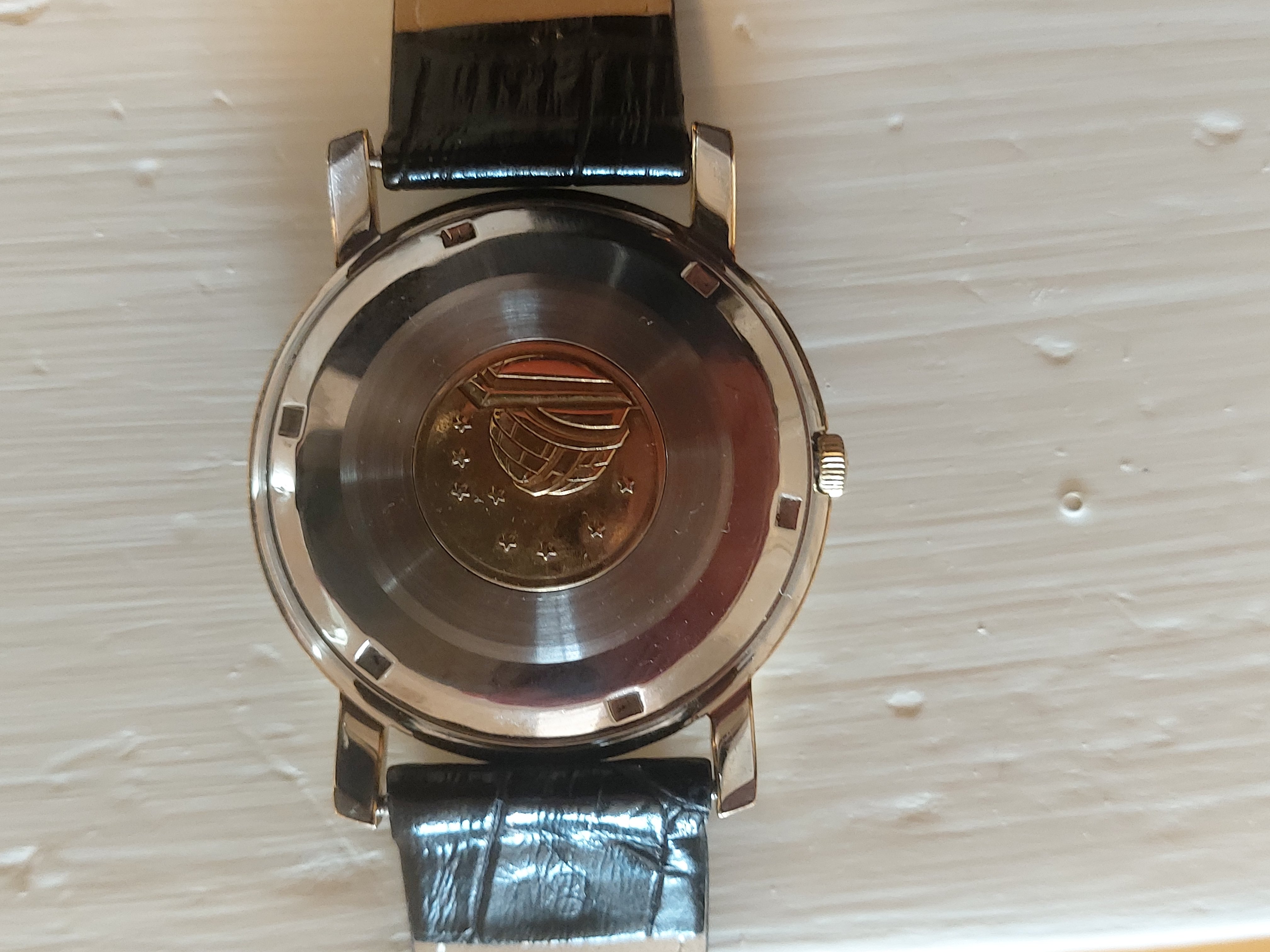

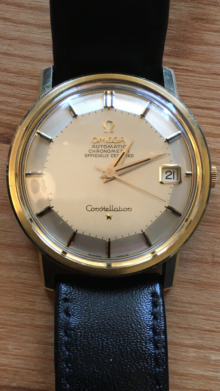

here is the back of another SS .010 that I own - different again
no turned field and almost no edge to the medallion
serial 25,637,xxx ~'67/68
(correct crown for this reference)

and here is the back of a very late .004, (with cal 564 movt) with a smaller turned field and raised edge to the medallion, the edge being not dissimilar to your .010
(with correct crown for the .004)
serial 24,297,xxx ~'67
