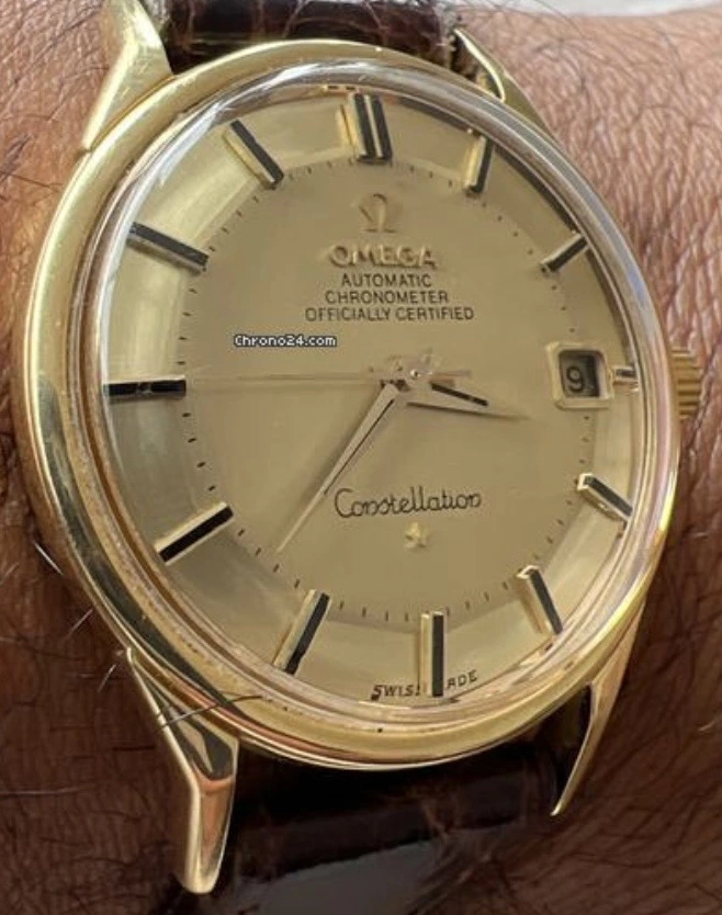

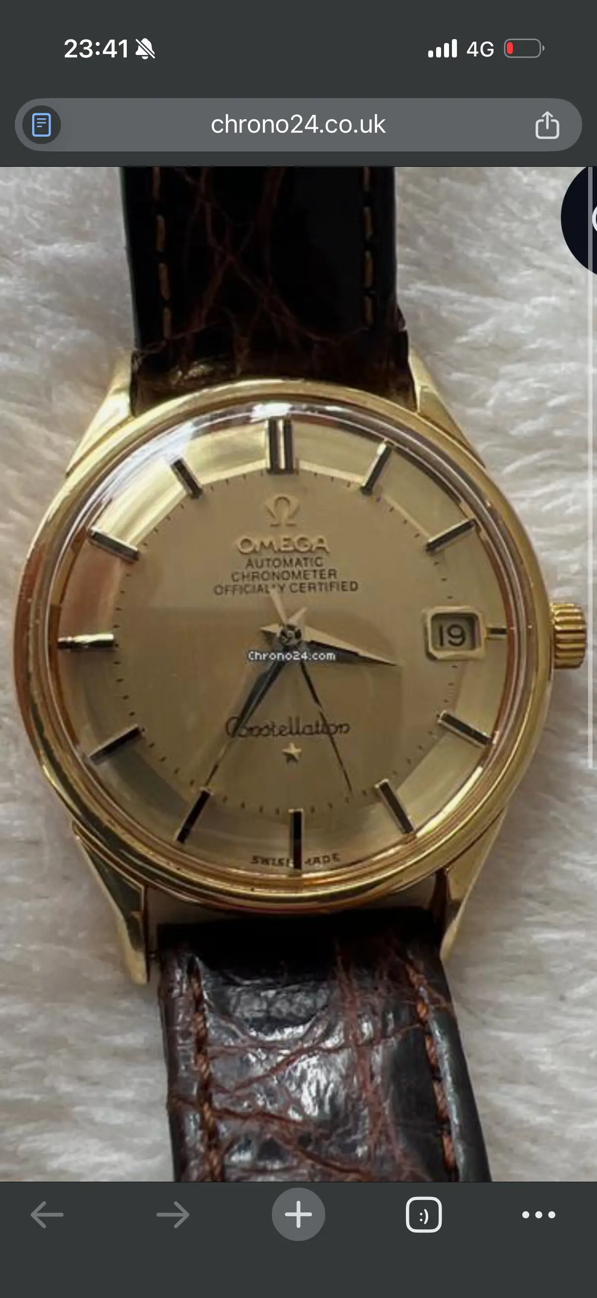

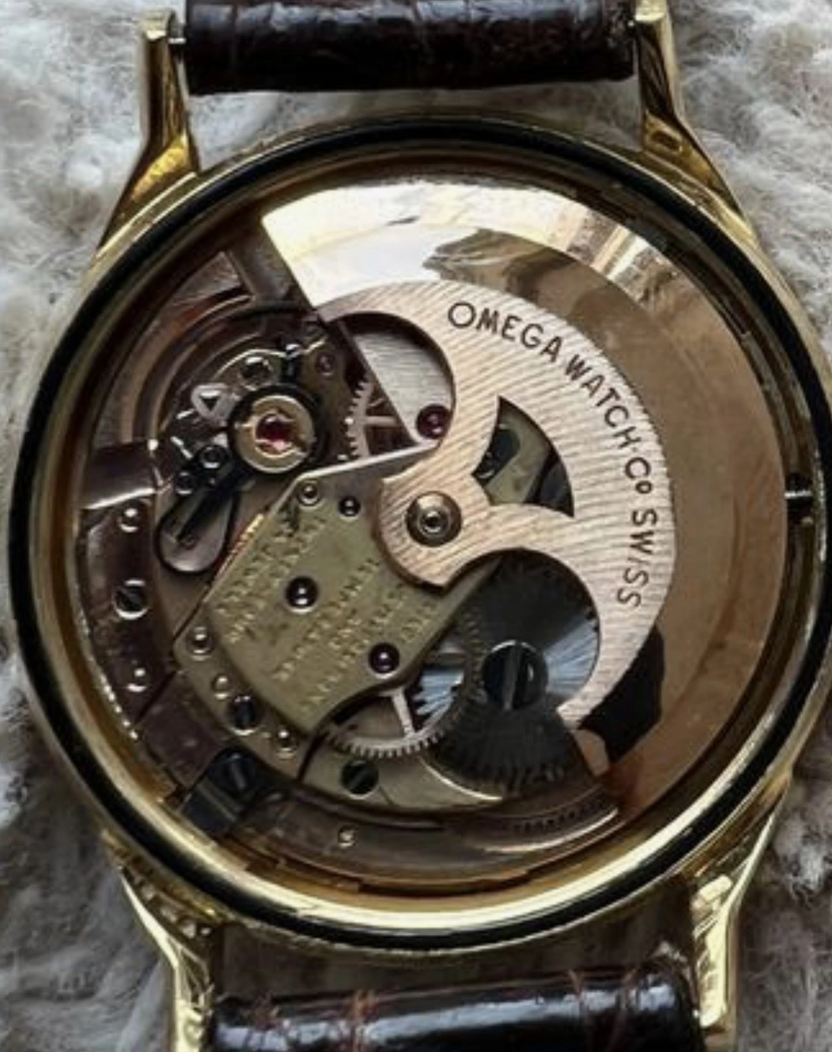

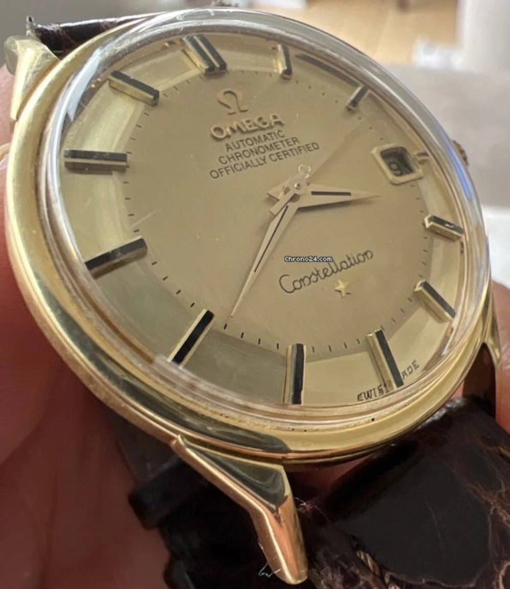

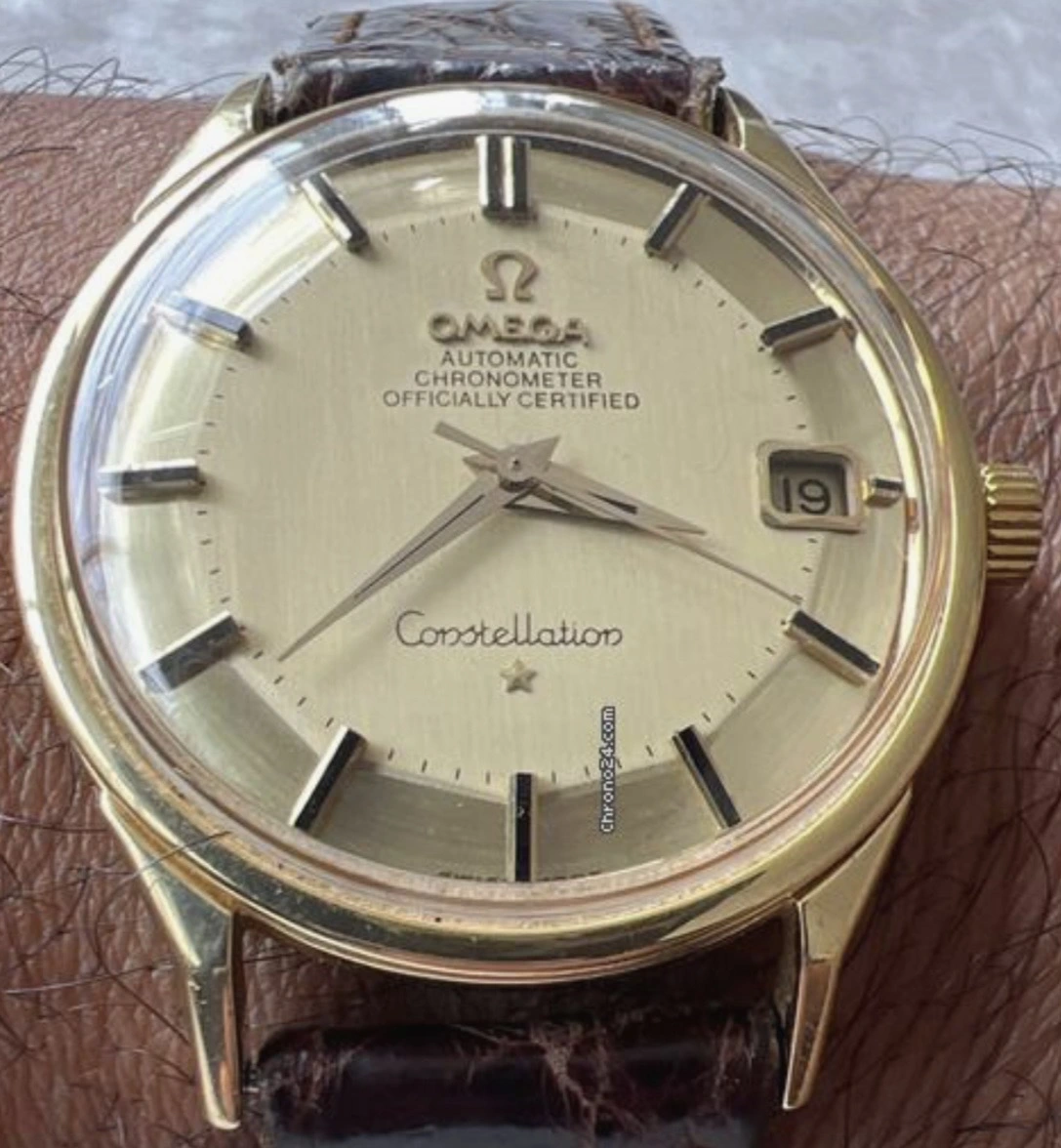

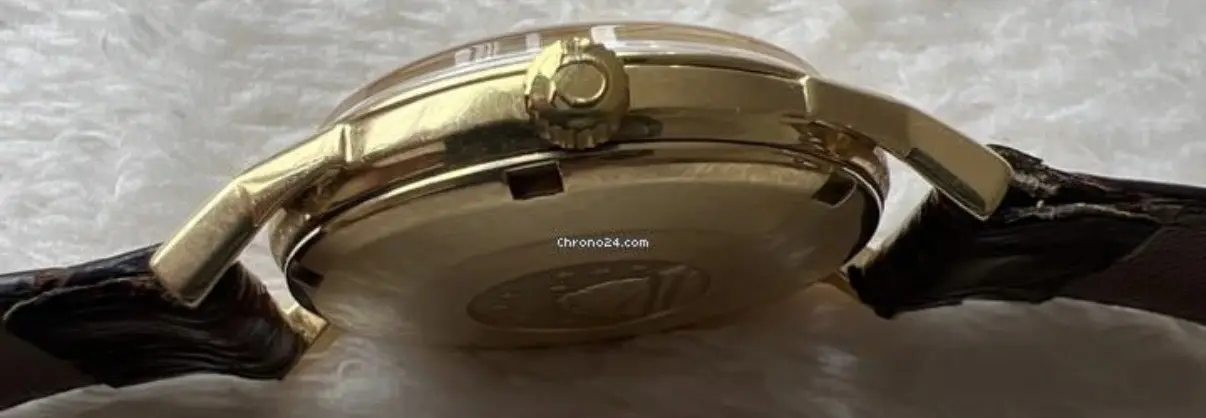

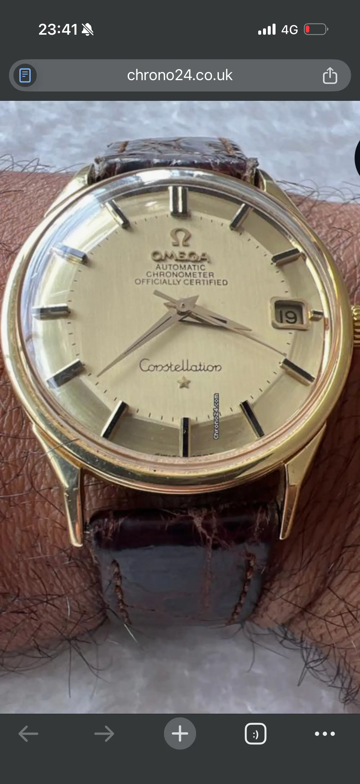

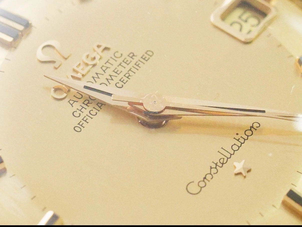

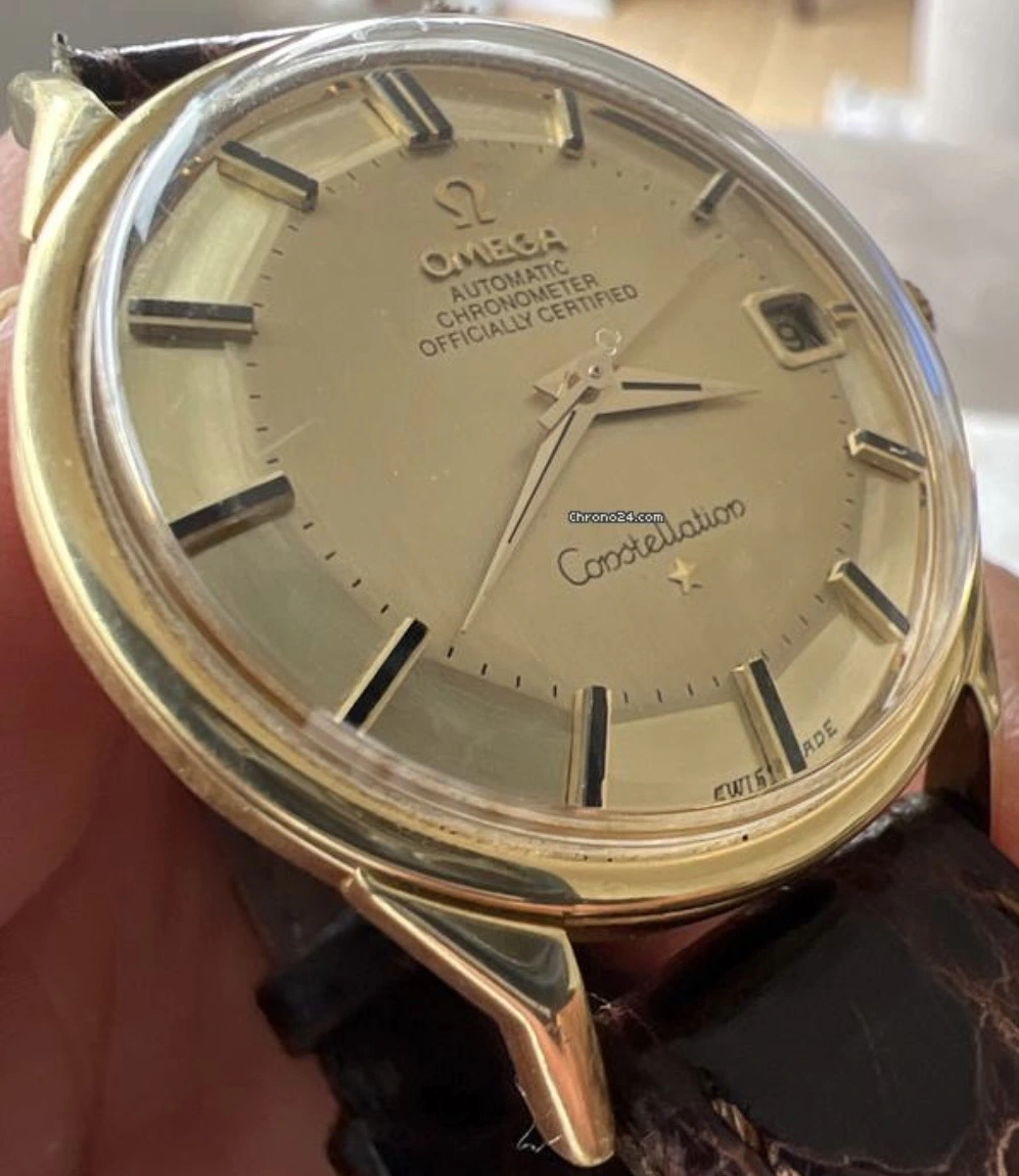

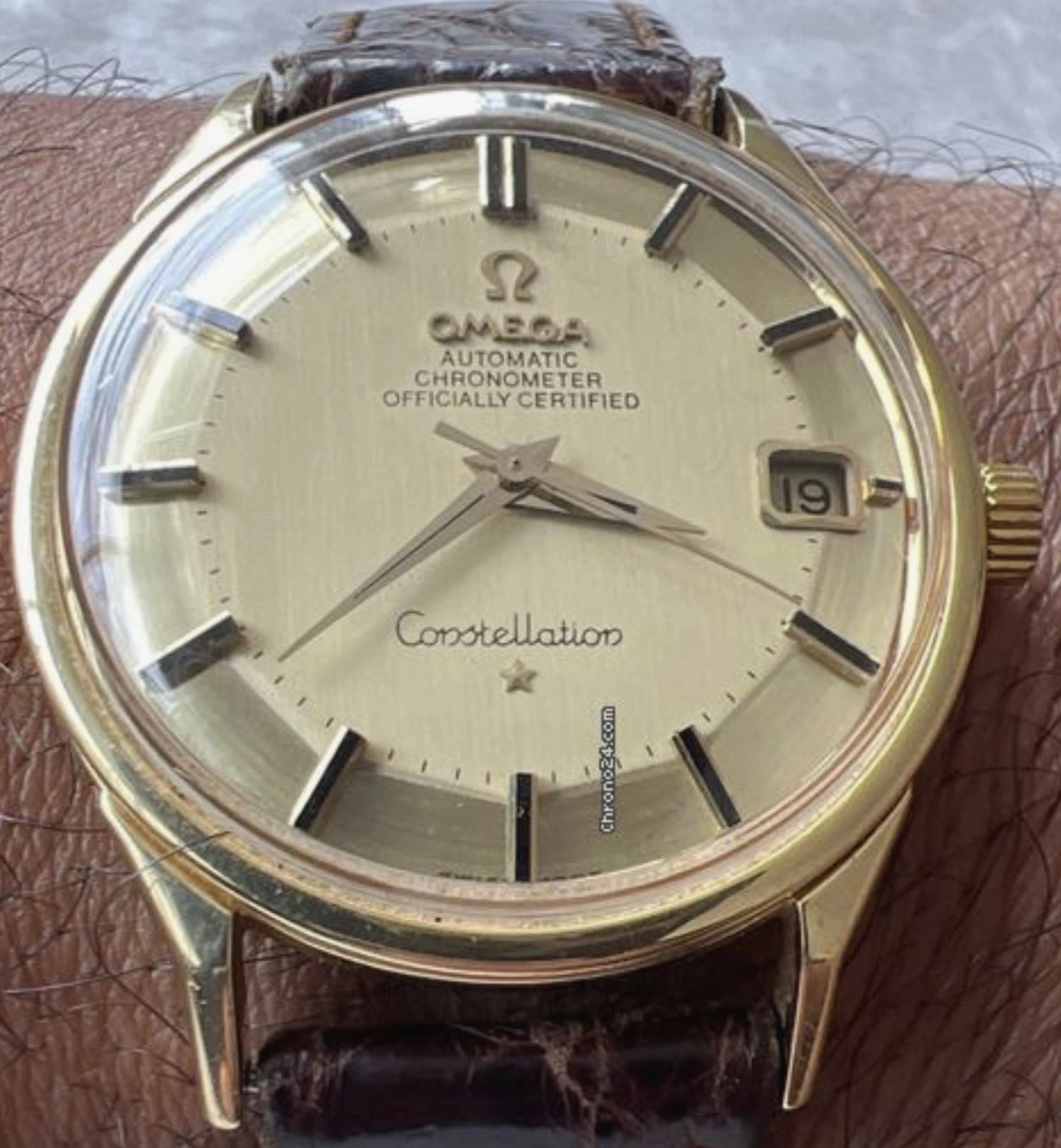

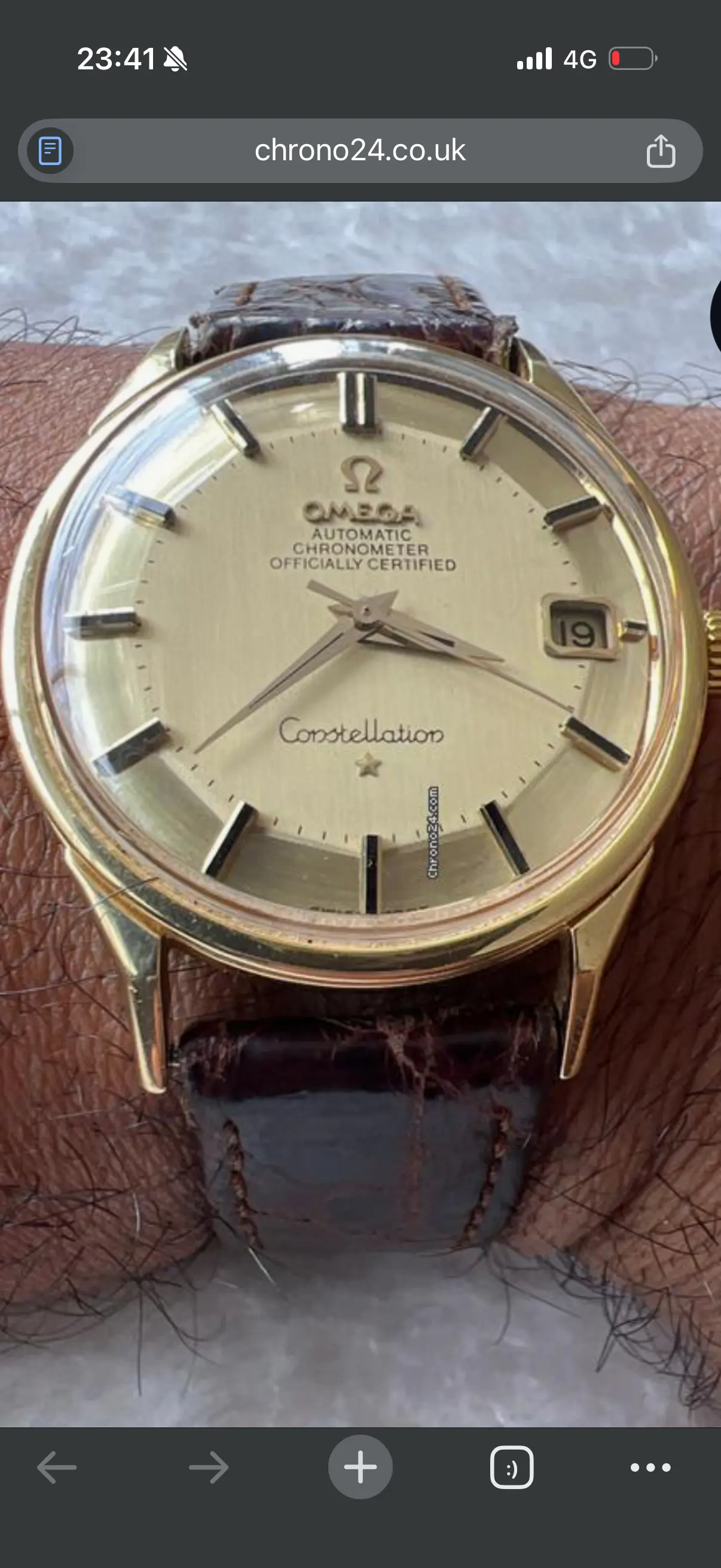

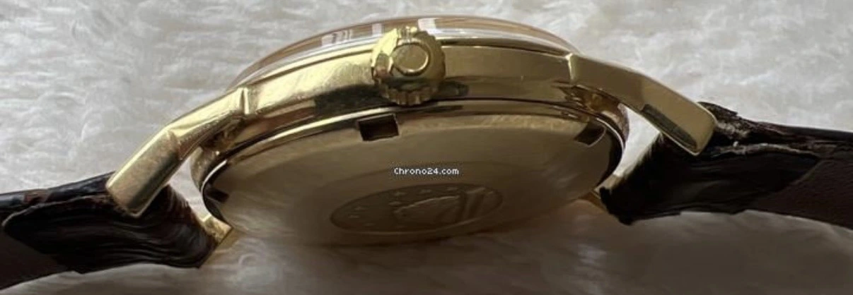

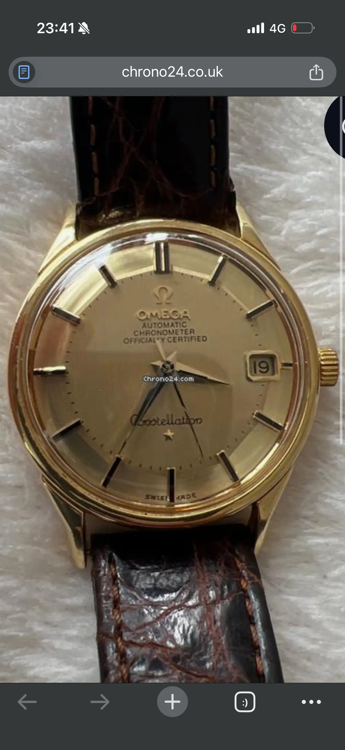

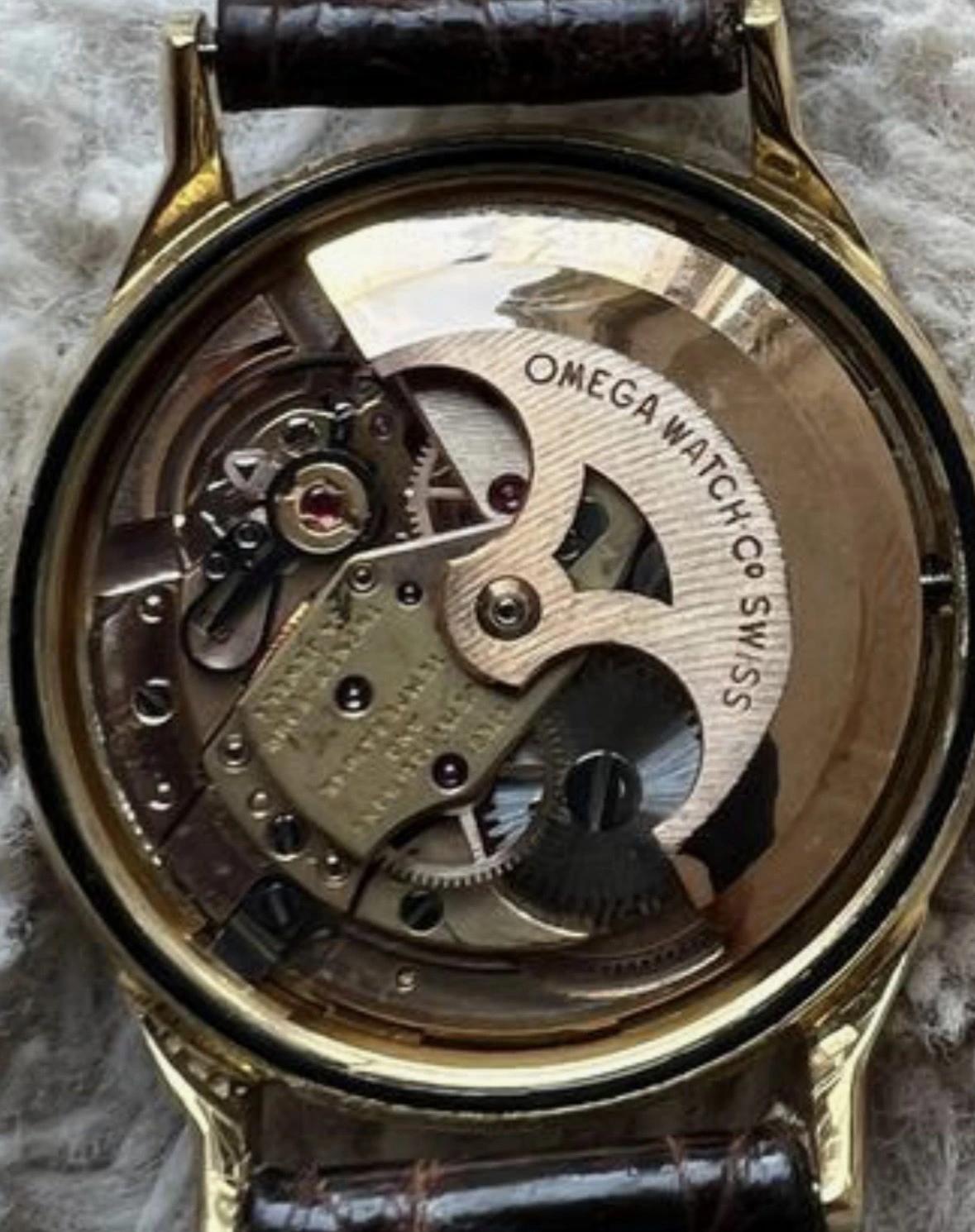

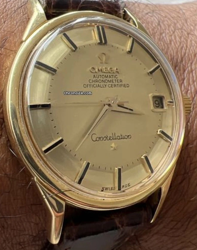

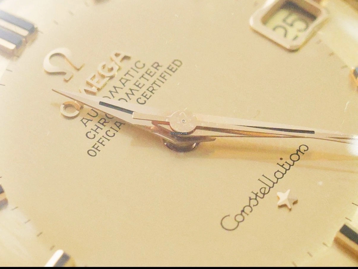

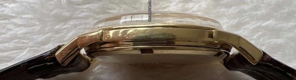

Appreciate the pictures are poor quality but would appreciate any and all views on this watch! Private seller says it is all original (bar the strap), ref 168.005 from 1966 with 18k gold case and solid 18k gold dial.
Can’t decipher calibre from the pictures provided and suspicion that the dial has potentially been retouched - but defer to the experts on this forum on this and any other glaring red flags!
Many thanks
24,837
55,260
Just walk away from this one and keep looking. It's very bad.
325
510
As others said, redial, wrong crown, too polished. What was the asking price?

This one isn't marked OM, so likely not a solid gold dial (aside from other issues).
6,835
10,505
The watch is a bit of a mess, as others have said, with a very heavily polished case and a repainted dial - and not worth pursuing unless very, very, cheap.
Just for the record, only late 60s / early 70s Constellations had gold dials marked 'OM', for 'Or Massif'.
This one has the classic broad, flat, onyx inserts of a solid gold deluxe dial (and also the light vertical graining)

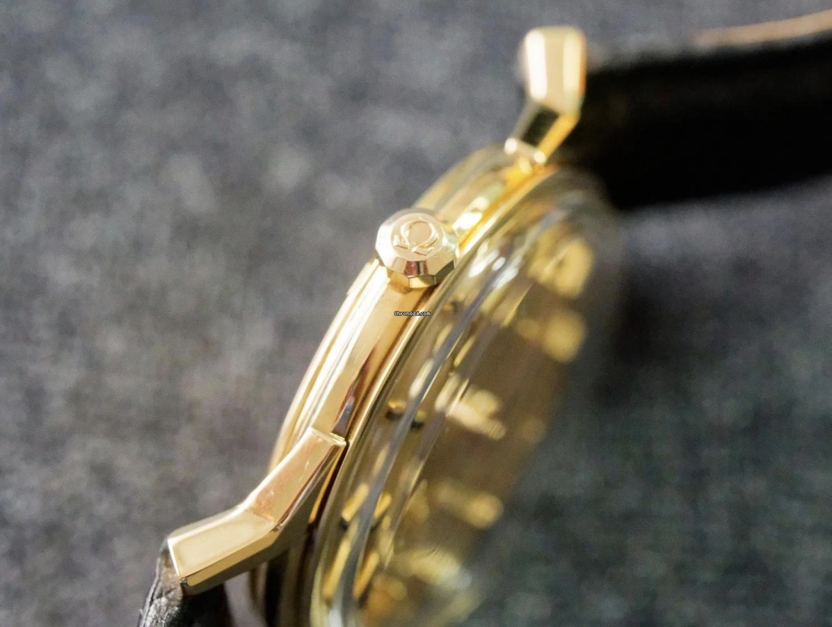

They vary. I just picked one up for 5,500 USD but that’s after waiting almost a year for the right one. It’s the same one you were looking at but crown is correct, and has not been touched in terms of polishing.
Admittedly I’m in the US so my selection was limited as I was not considering international pieces due to the tariffs we have in place right now.

Your watch is exceptional @amuscare87.
I'm surprised that it only took you a year to find one in that condition as watches like that really don't show up very often.

As Jim said, not sure it actually IS gold. IF not, I wouldn't pay $300 for it, and at that, as a parts movement. IF it actually IS gold, whatever the melt value of the case ends up being. Those are pretty thin cases, so I'd say $1500 maybe? But that could be a bad estimate.
6,835
10,505
@JimInOz was questioning whether the dial was a gold dial because it lacked the OM designation.
As outlined above, the dial has all the hallmarks (pardon the pun) that it IS a solid gold deluxe Constellation dial.
2,671
2,856
OH! Thanks for the clarification. Please disregard the 1st 1/2 of my post then 😀

@Peemacgee can you explain a little more in depth regarding the OM designation and what it means? Trying to follow along
24,837
55,260
OM at the bottom of the dial indicates that the dial blank itself is made of "solid" gold.

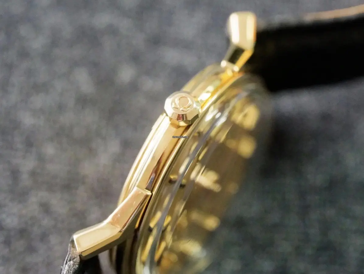

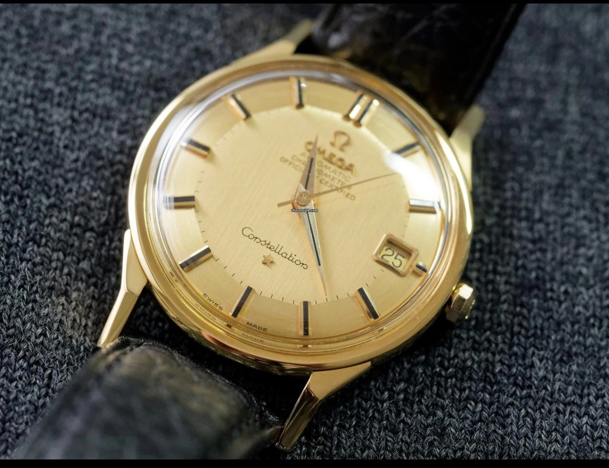

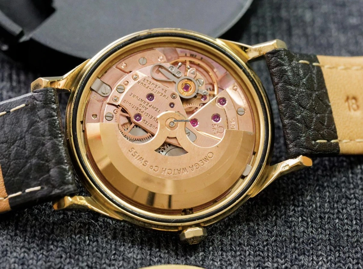

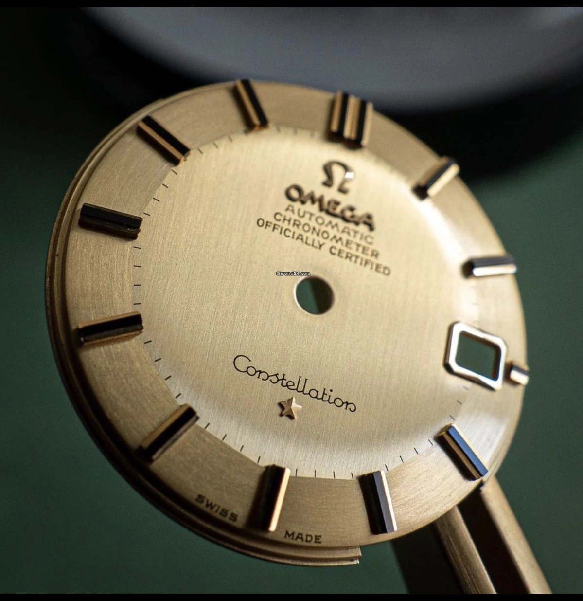

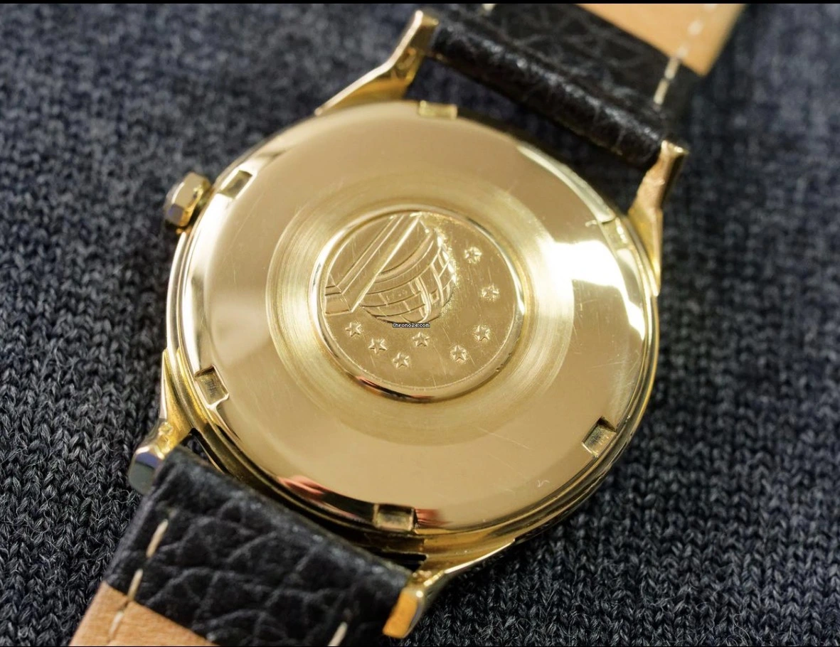

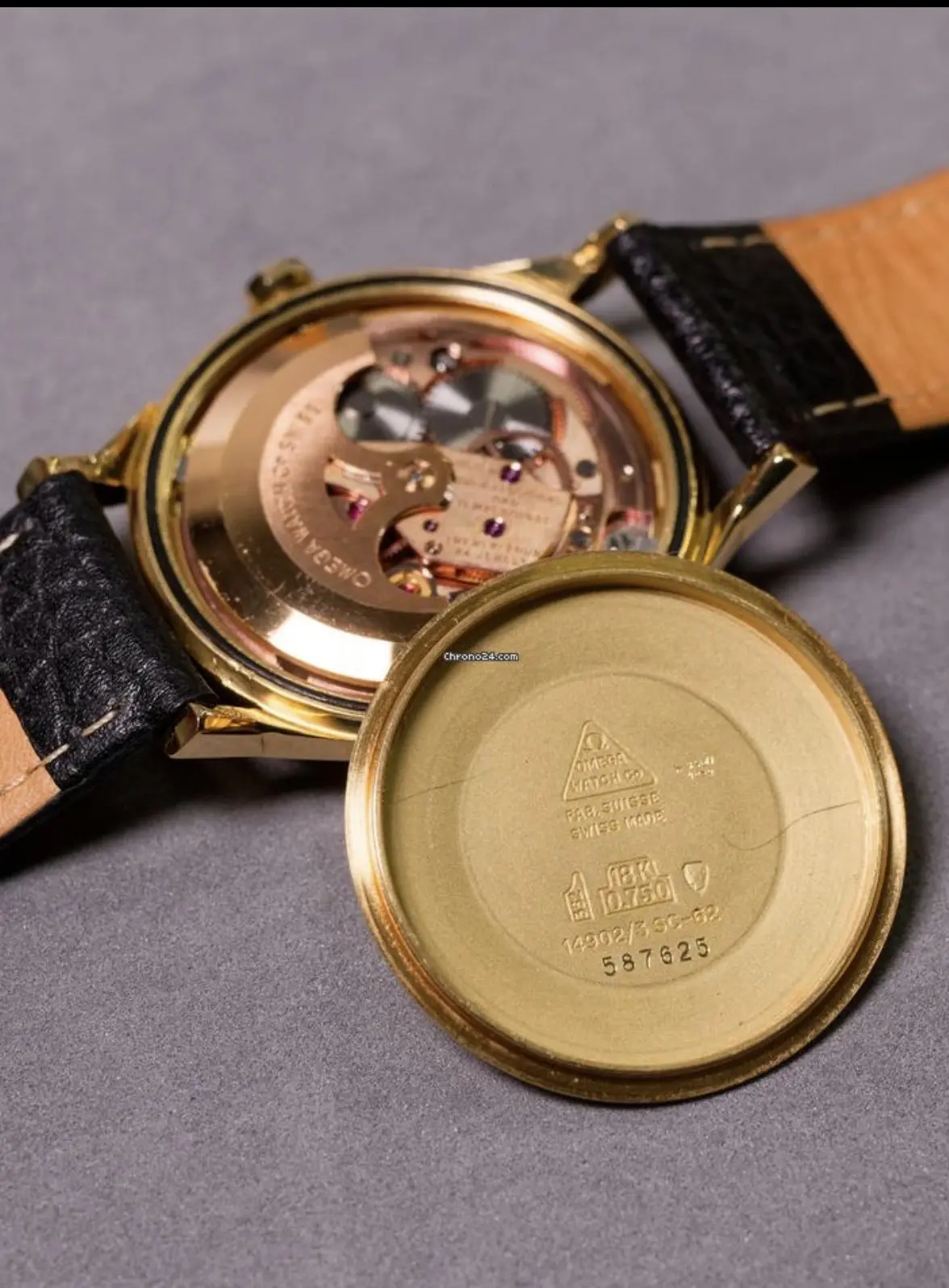

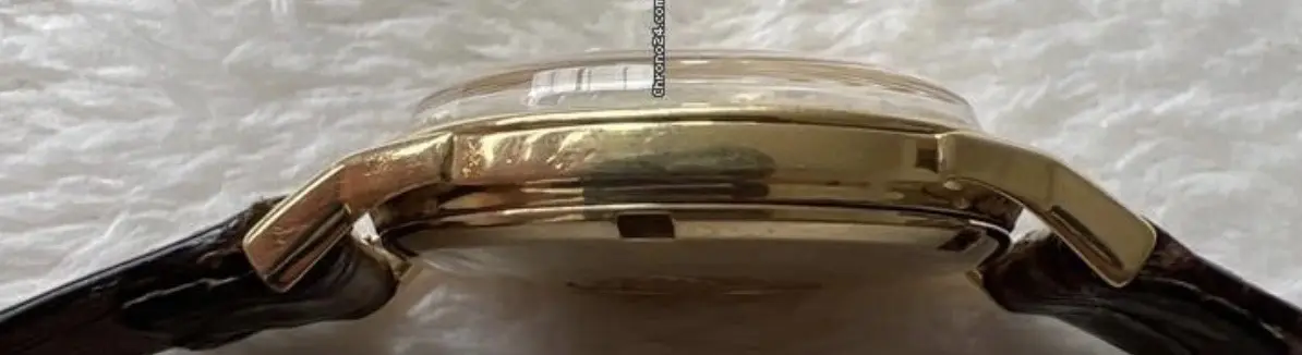

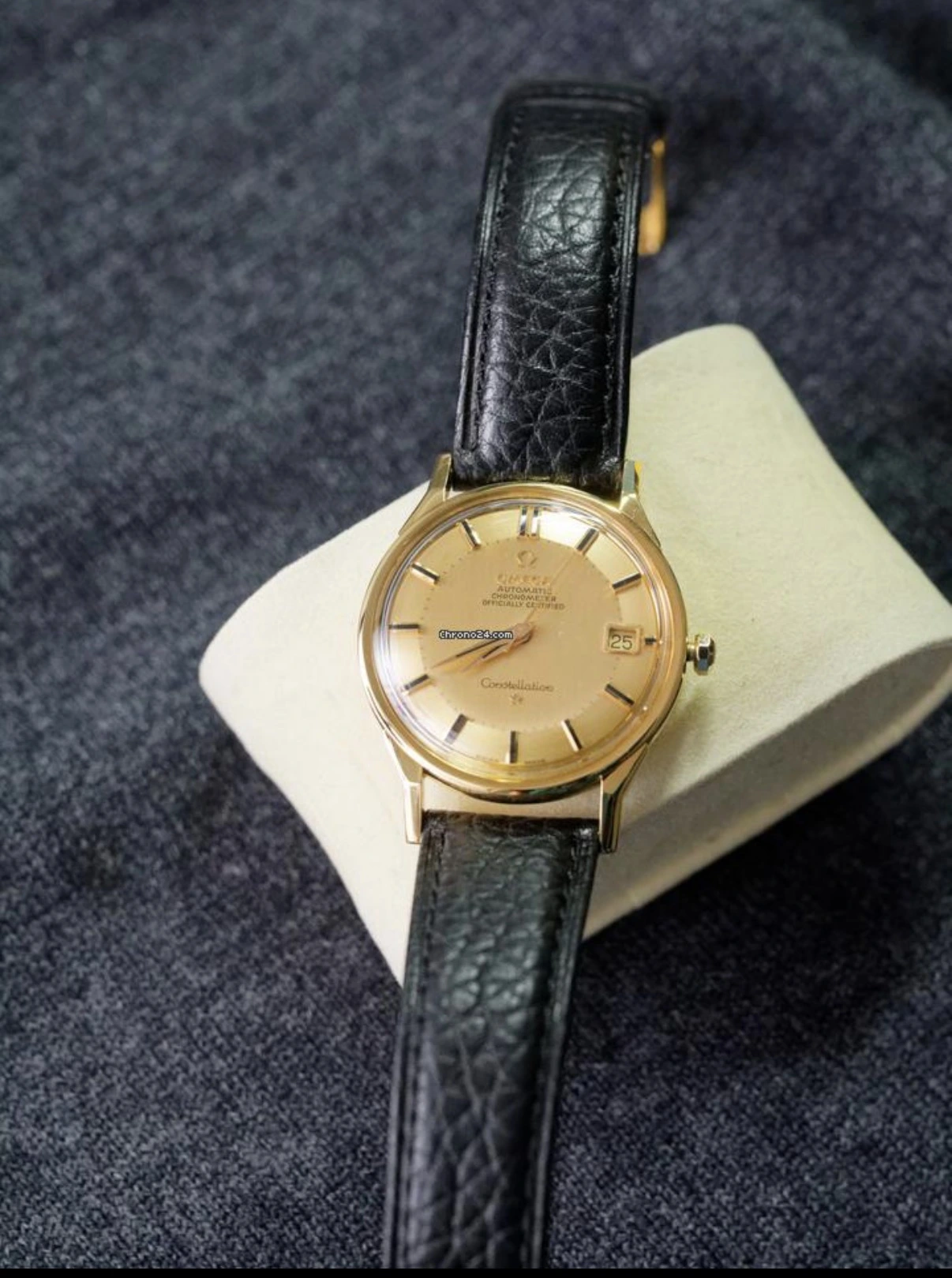

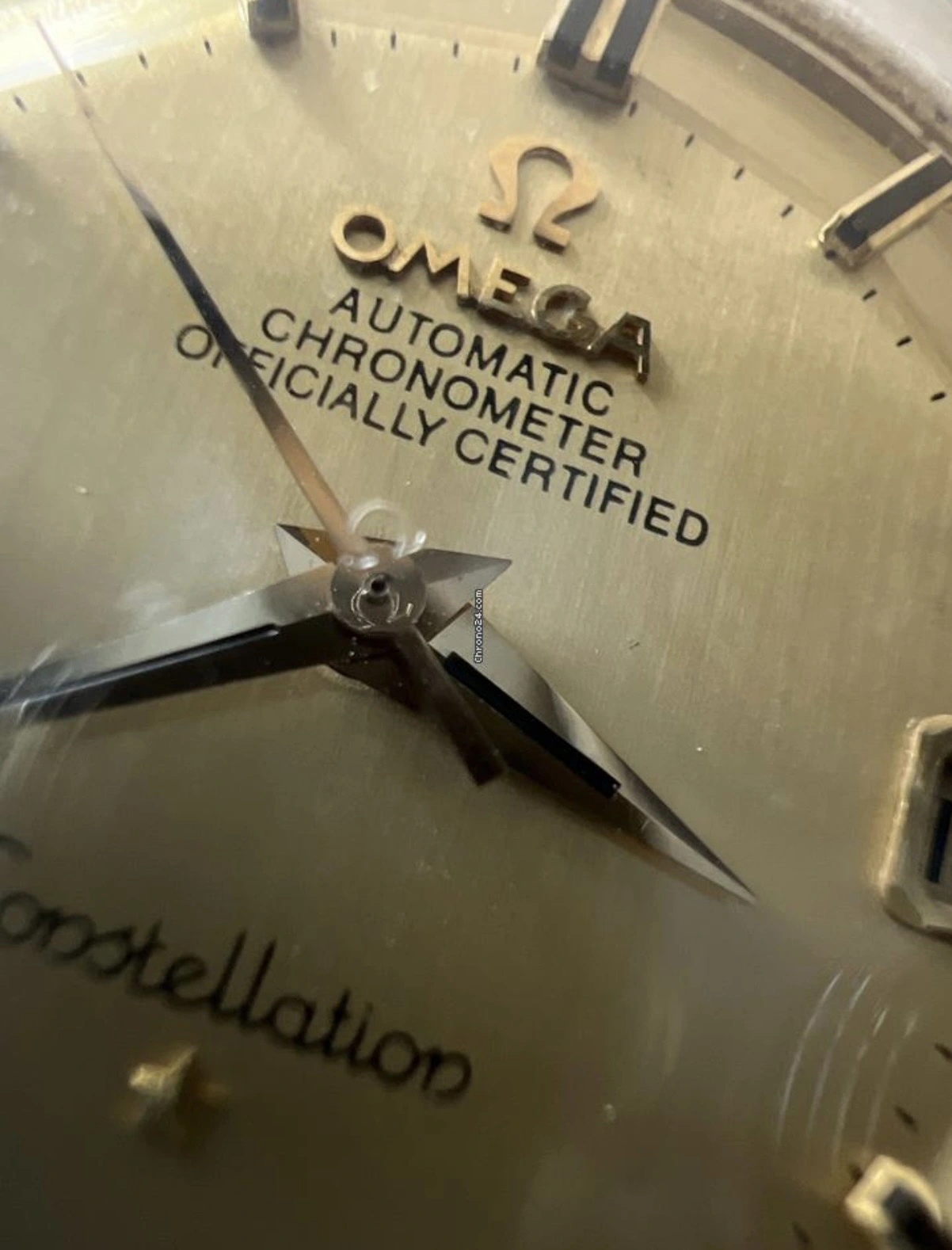

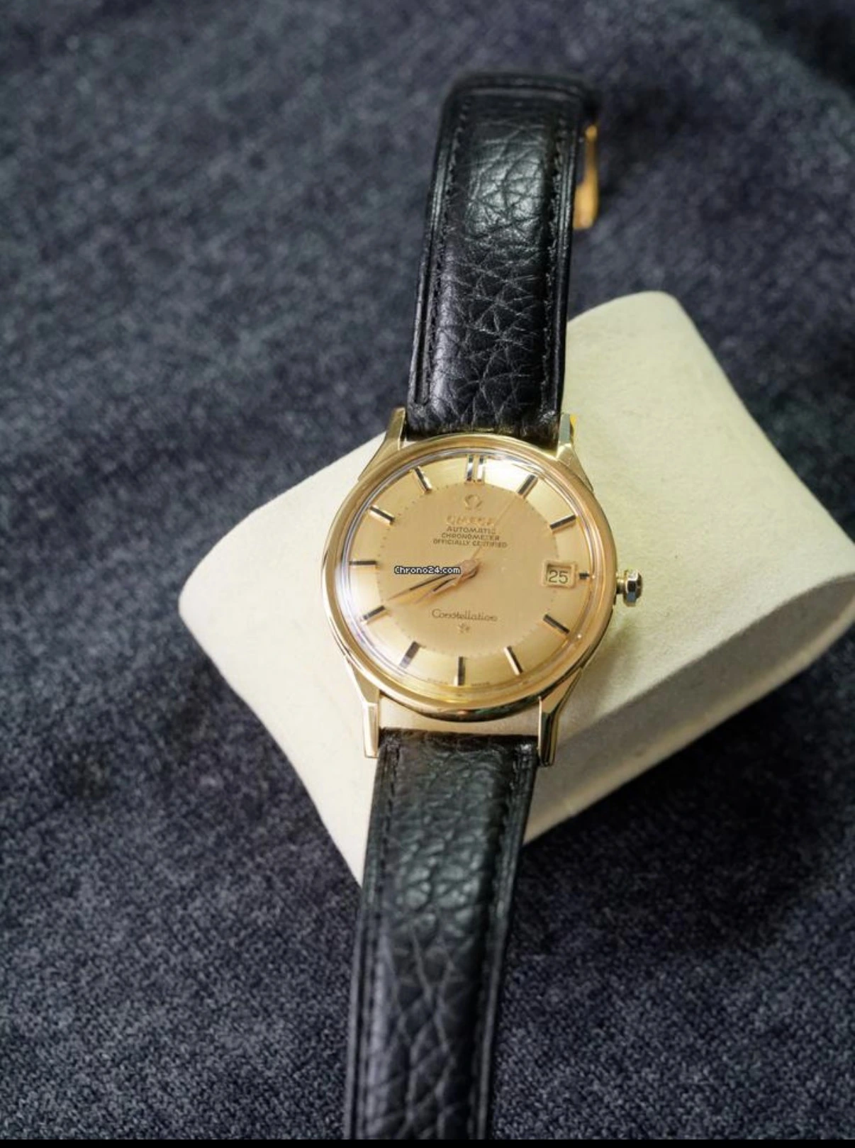

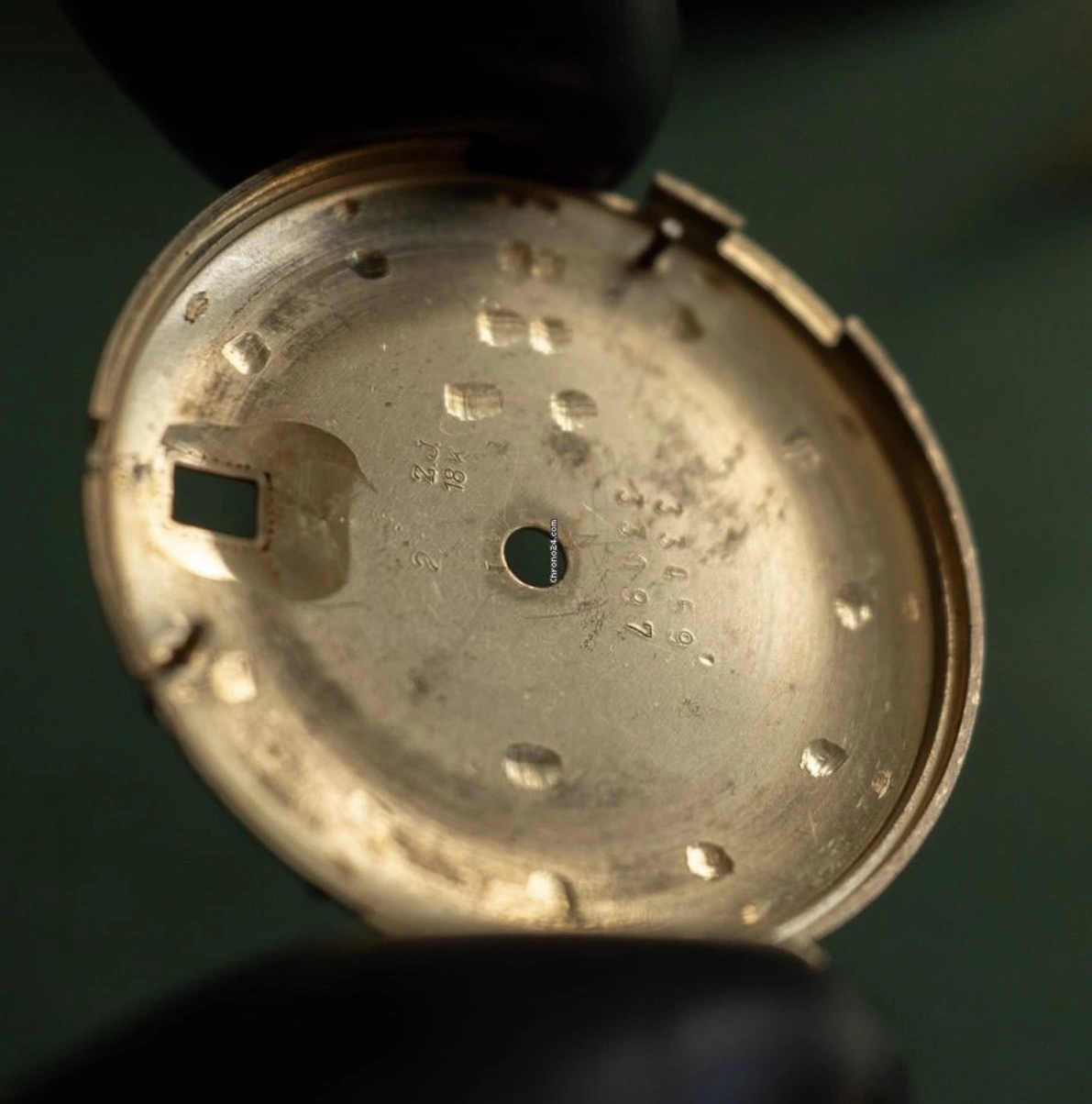

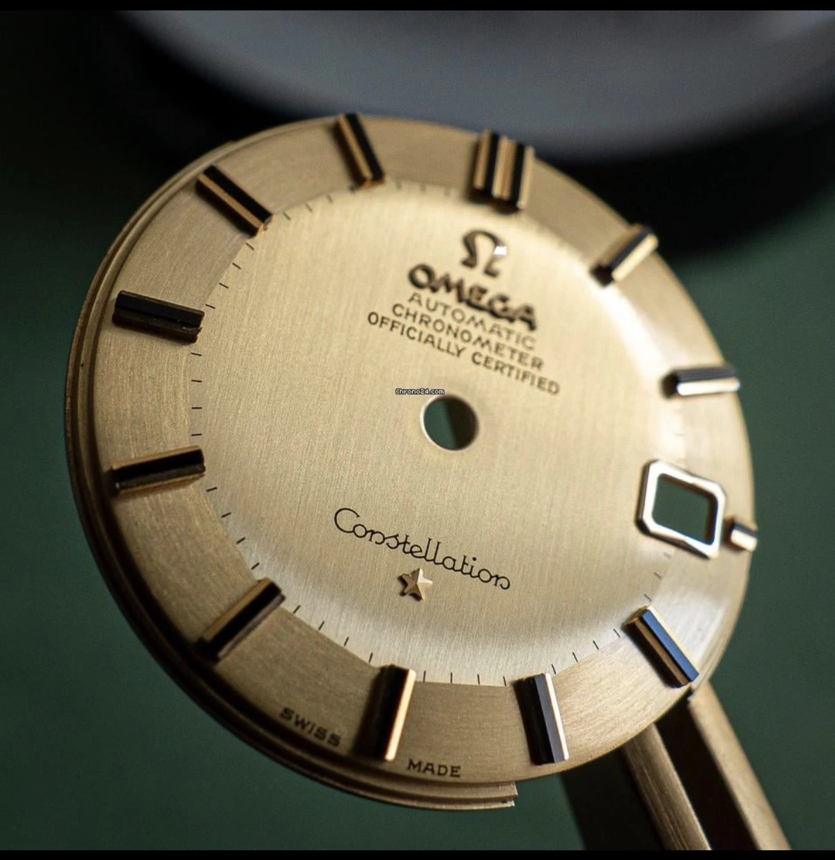

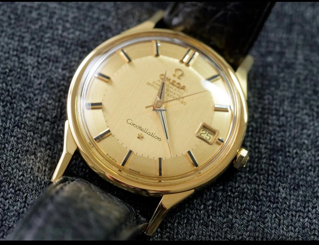

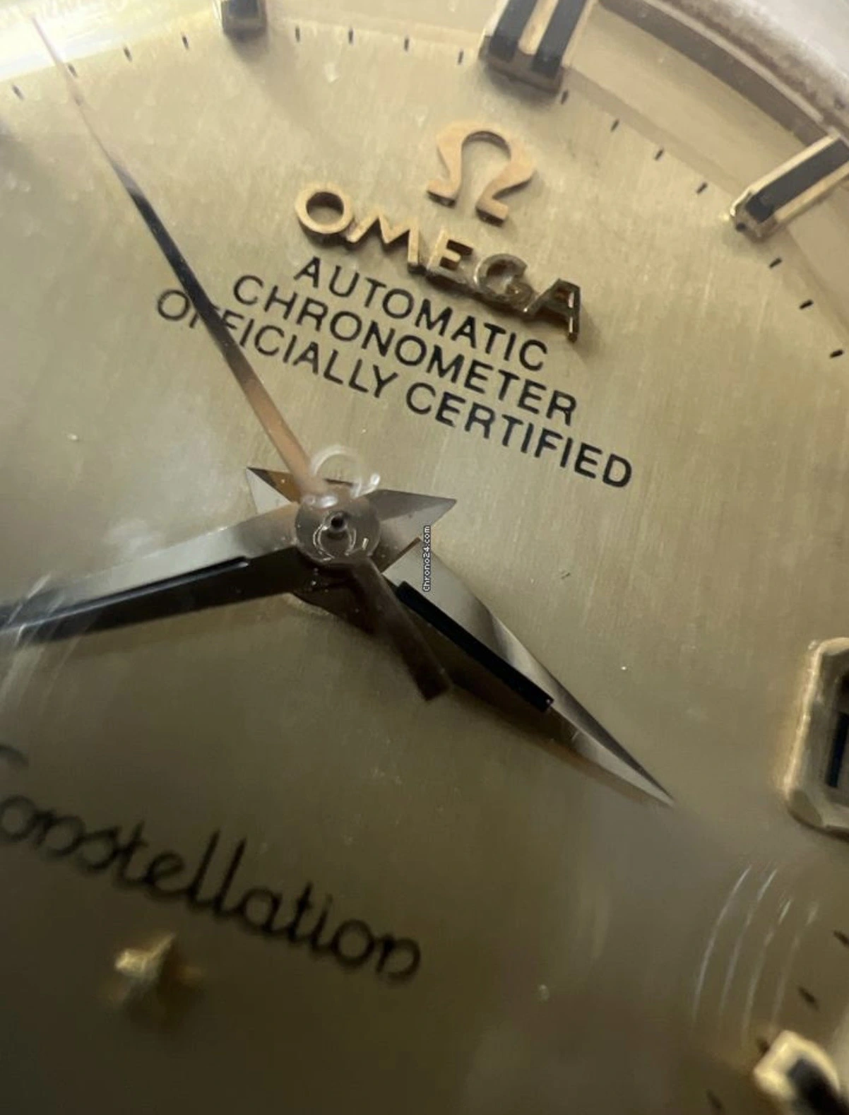

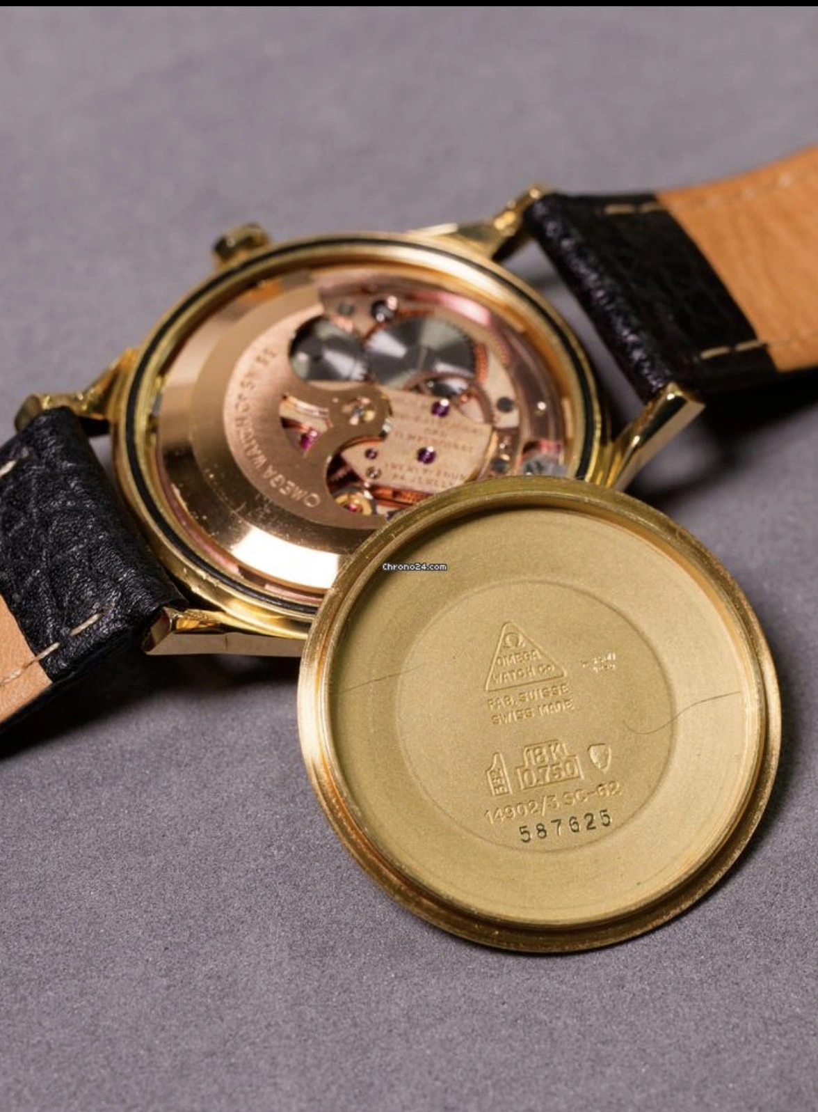

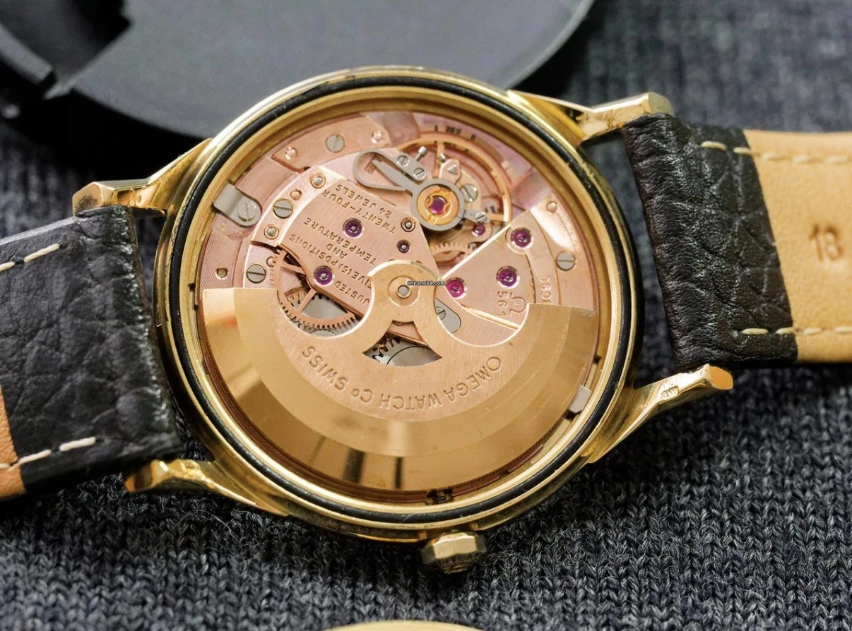

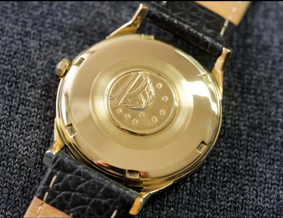

Hi all - me again, this time with a ref. 14902 that I have come across, again with (what the seller says is) a solid 18k gold dial. To my untrained eye, this dial looks better than the last watch I posted above and based on what I’ve read above / on this forum, I understand the ridged onyx inserts would suggest it is a solid gold dial. The lugs, while definitely polished, look reasonably well defined. The case back looks slightly odd to me (maybe the way it’s polished?), so would appreciate views on that as well as the hands, as I haven’t figured out how to assess those yet!
All thoughts very welcome - the more time I spend on this forum, the more I realise I don’t know!
6,835
10,505
First of all - it is the lack of ridges in the onyx inserts that show that it is indeed a gold dial.
Making this a 14903 deluxe constellation.
The dial looks to be in nice condition. However, the lugs look over polished to my eyes I’m afraid.
What is the asking for this one?
