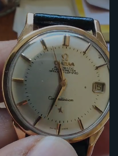

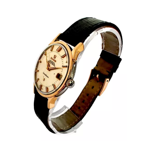

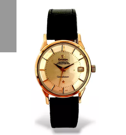

Hello, I am looking for a vintage omega pie pan and found this one, is it fake? Searched a bit and the distance between the "Constellation" and the star looks fake. The 'swiss made' position looks odd too. Thanks so much
34mm / 36mm

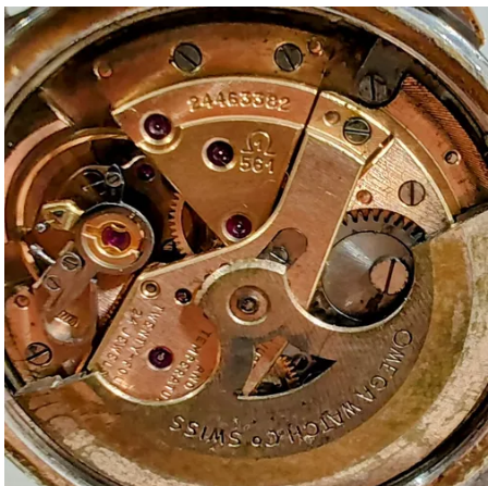

CALIBRE 561
serial number 24463382

Looks more like a poorly done redial. And a massively polished case. And I'd bet it looks better in these purposely overexposed photos than it does in real life.

Not being able to find a photo of an identical dial online is usually a sign that the watch in question has a refinished dial. Never a good thing.

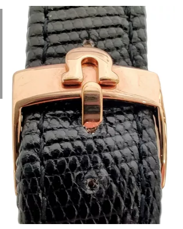

As above plus the buckle is fake and the movement is in horrible condition.

That is an awful, awful example, redialled, over polished, poor state movement etc, use the search engine on this form to search for constellations, you’ll fund so many examples you can spend time looking at that will help you to identify when is good or as in the one you have posted, bad. Also the private sales forum here can throw up the occasional good example.
