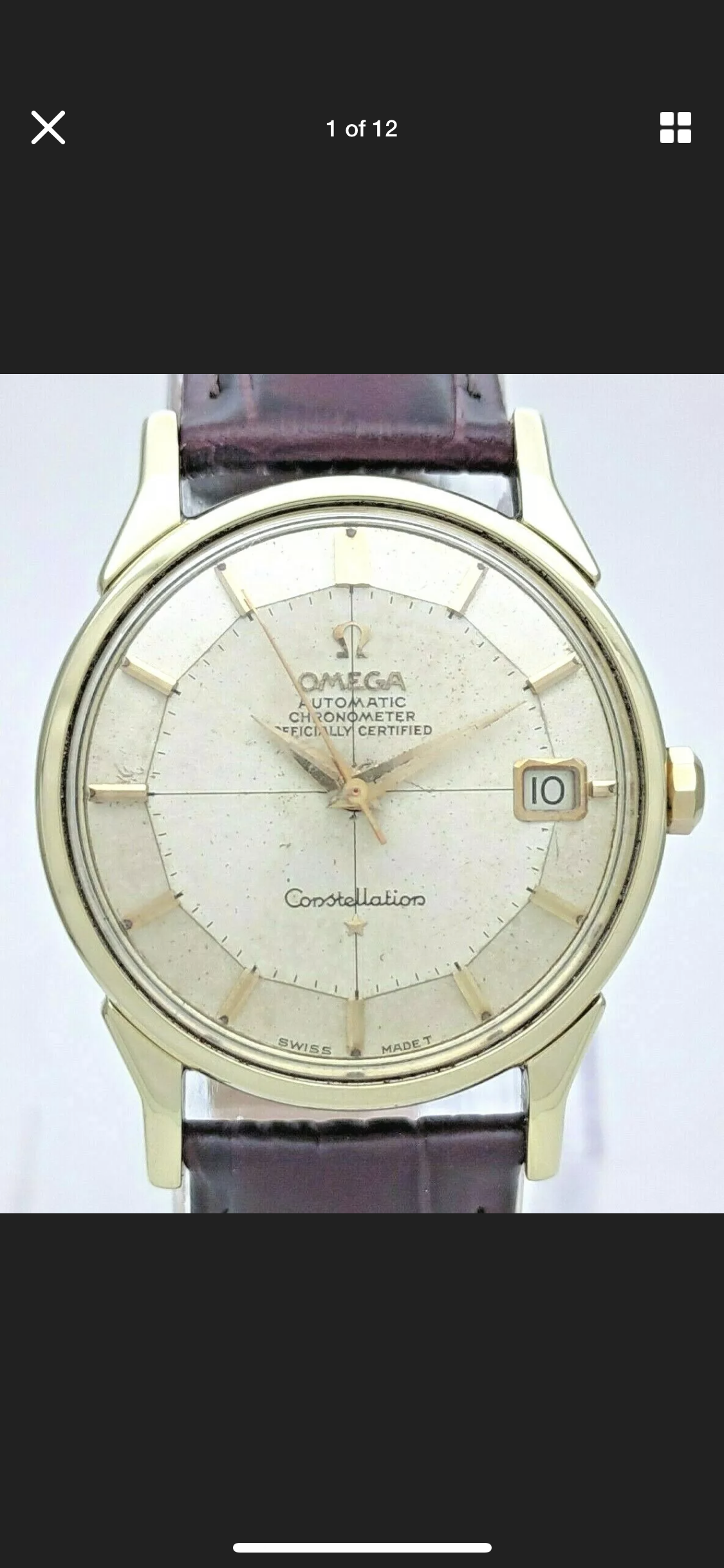

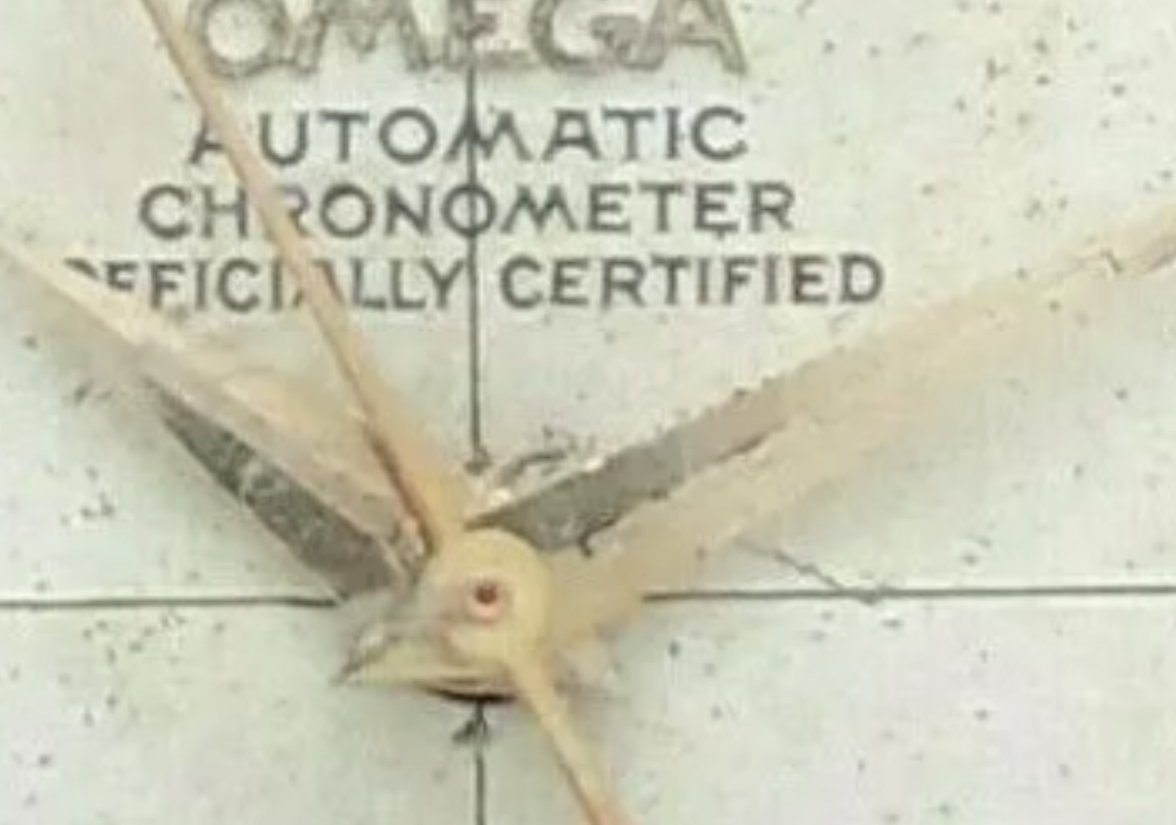

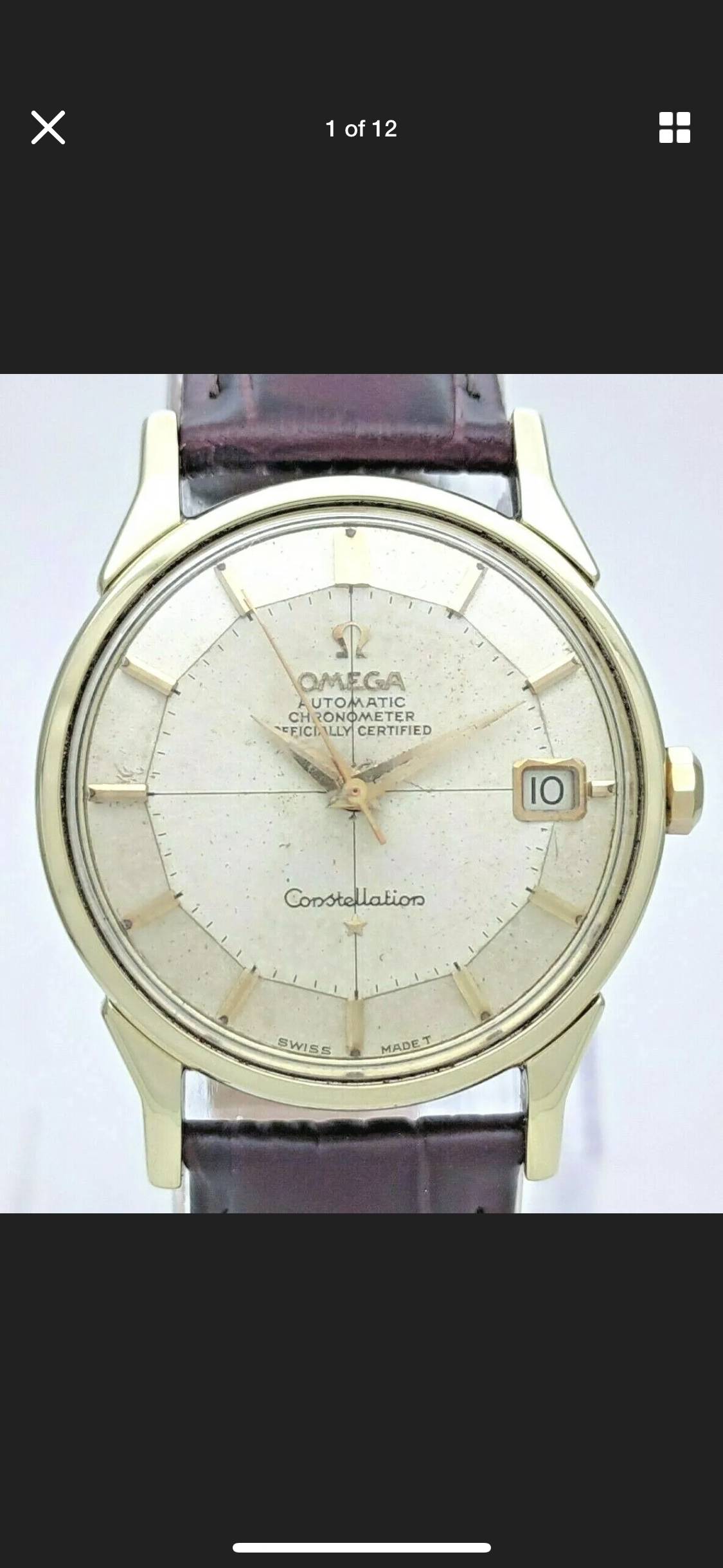

Hey! So I’ve done some homework on this one. The movement looks right, the only thing that seems off is the writing on the dial. It looks repainted but I’m not sure. Thanks! (Also I know I’ve posted here a lot, just need to make sure I’m not making a dumb decision )

For the writing, I refrain, because we have some great Connie specialists who will know far more than I.
A great thing about OF though is you can always ask - we've all either gone or most of us are still in our learning curve, especially on vintage. 😀
Good luck!

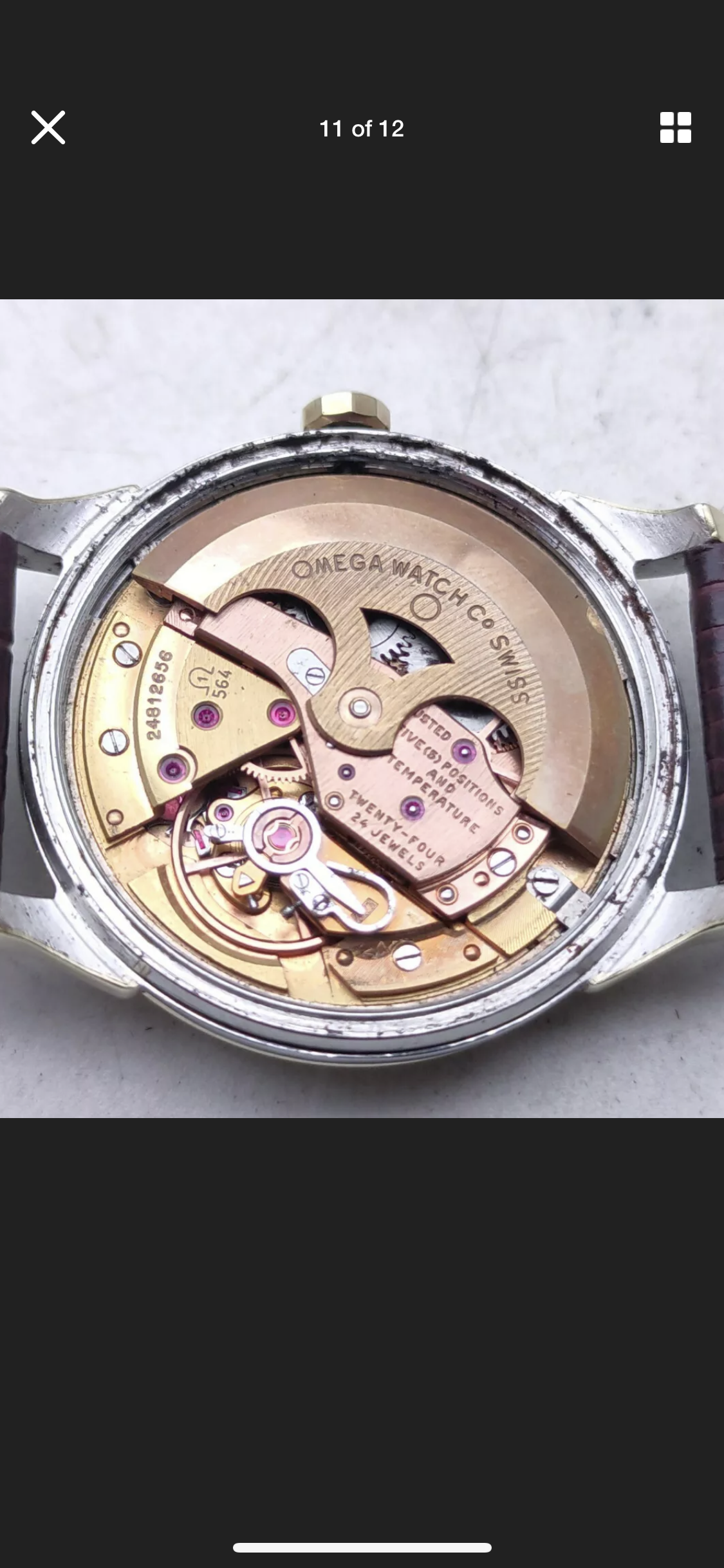

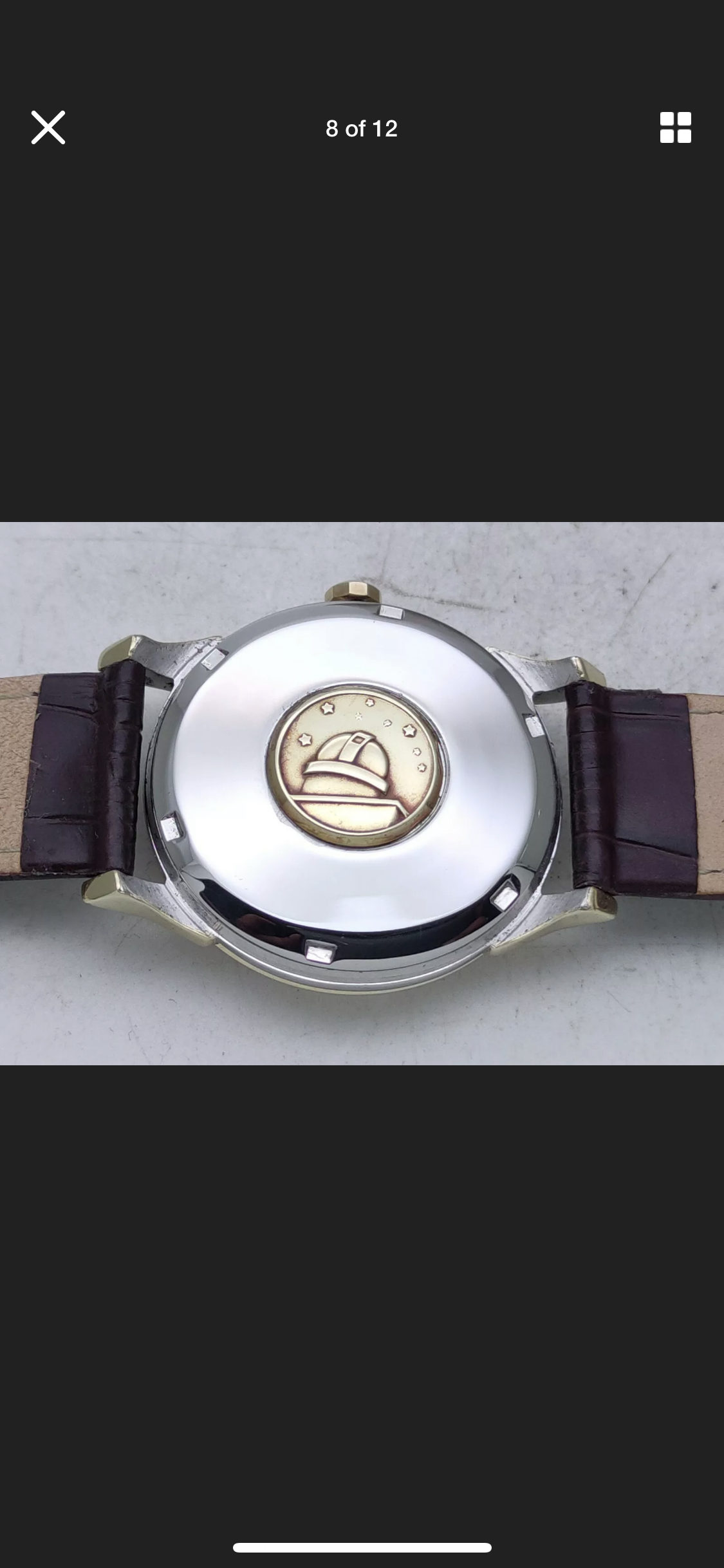

What's wrong with the printing? The case would be the issue for me. I'm also curious what the experts say about the fact that different bridges appear to be plated differently (gold vs. copper?).

Just went back to bid on it. In the last couple hours it more than tripled in price . Definitely not something I can afford right now.

Correct or not, the dial is too ugly for me.
I'm intrigued by the single T, without hand lume. Are the hands correct ?

honestly I’m not sure. There are too many questions with this

Well, it's basically unheard of to have a dial with lume and hands without lume. The combination isn't logical.

Dial looks ok, hour hand and minute hand have lume on them, I see it.
Second hand is generic and a bit too long.

I think you are seeing reflections from the angles, I don’t see lume there. I also see pretty bad case corrosion. That watch is a bit of a mess IMO.

I think the lume on the hands is there - you can just make out the squared edges of the space for it - it’s just a very over-exposed photo. (I wonder why?😒)
however, the watch is definitely a bit of a mess generally.
Polished case, spotty dial, lume on hands and indices don’t match, wrong seconds hand, Joseph’s technicolour dream coat movement, corroded case.
One to pass on.

I see your point. I think I see the cutout you mean on hour hand now. As you say a terrible photo. One to avoid anyhow.

Good eye, I did not see the lume on the hands.
