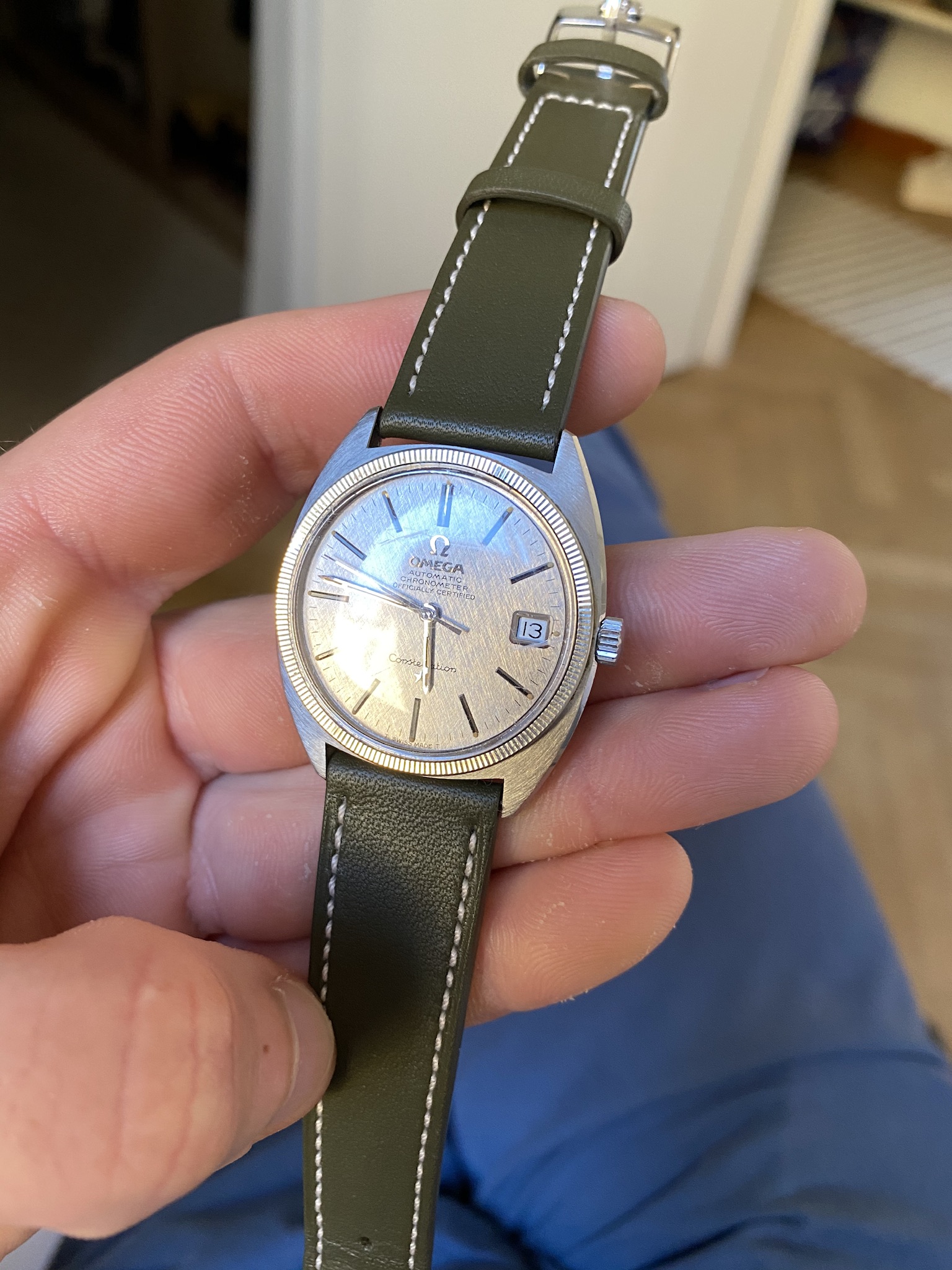

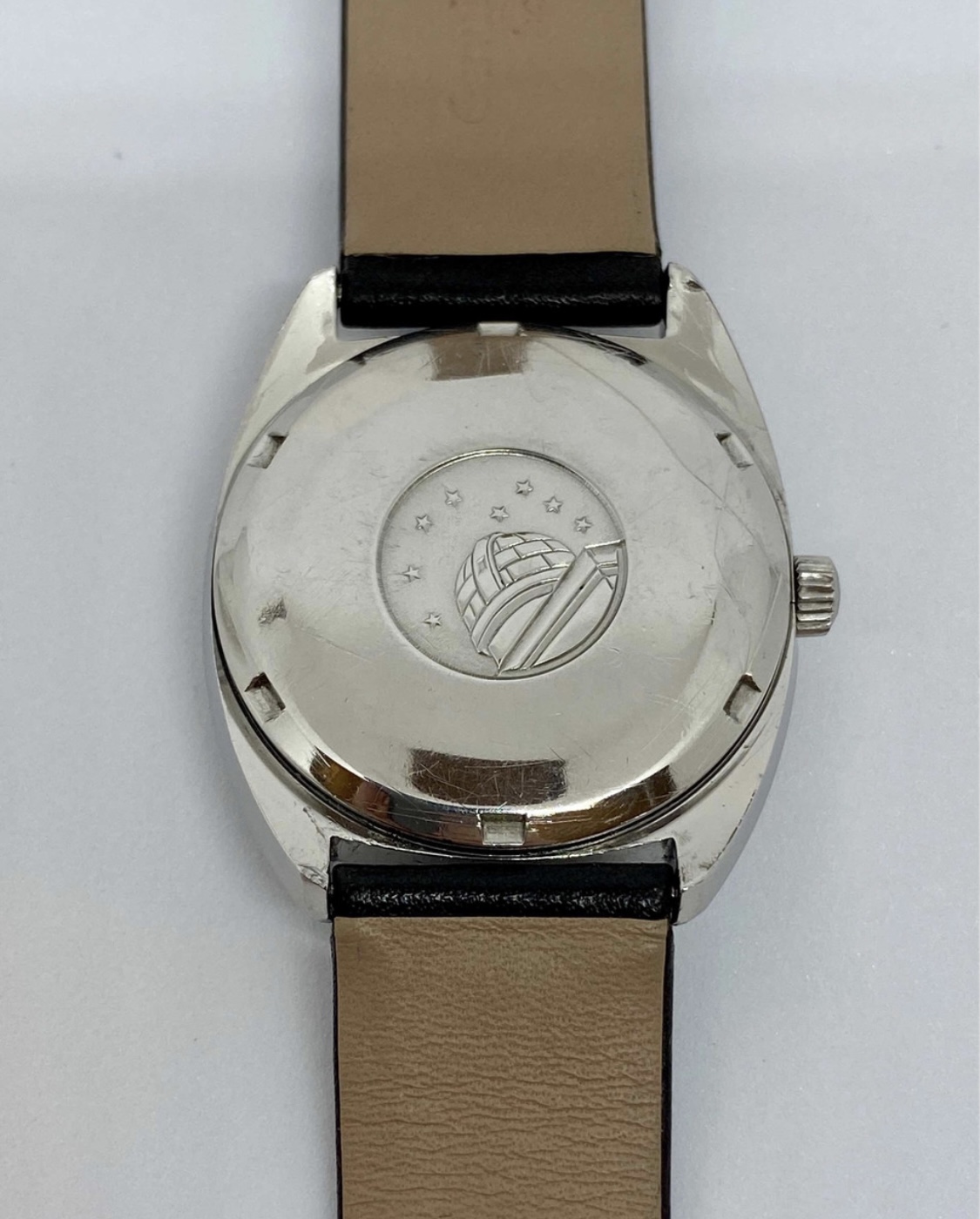

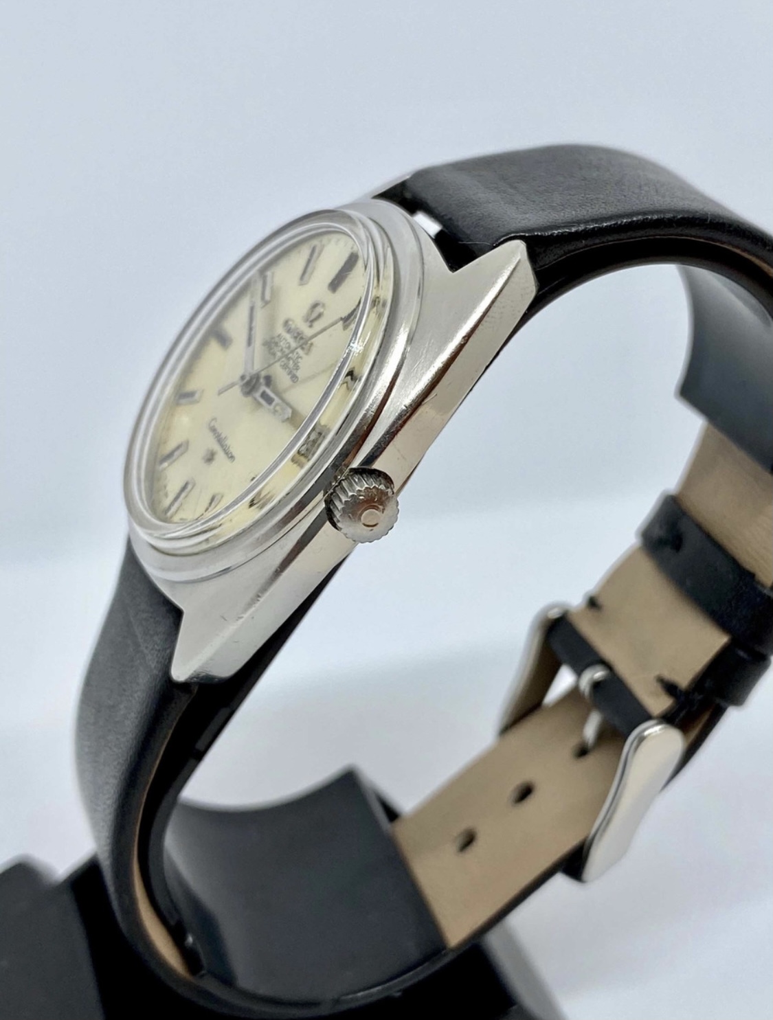

Hi,

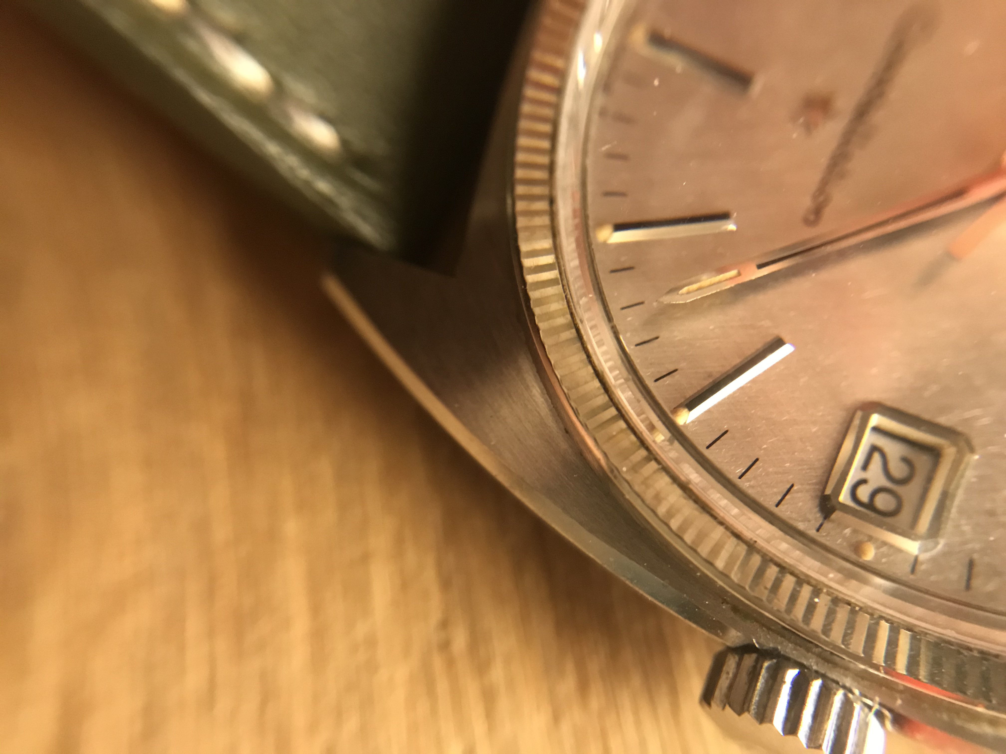

Highly polish, it has lost the brush finish, and it seems to me redial as well... not a collectible exemple from my point of view.

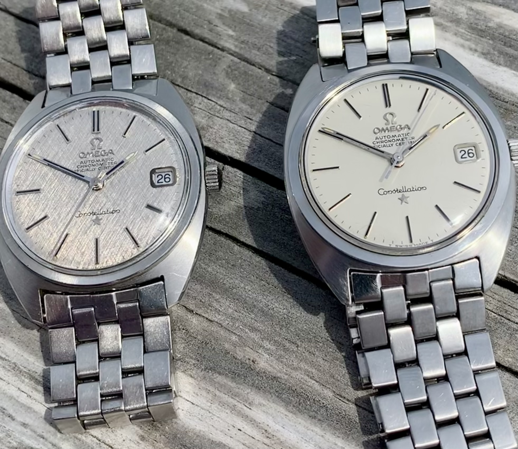

Here is mine in order to compare the case

Not of interest to collectors for reasons stated above, but well priced for what you are getting. As an everyday wearer, this is decent value.

even heavily polished, considering the price it's interesting .. a complete service and you have a nice watch to wear .. 370USD for a C-shape is a real bargain ...

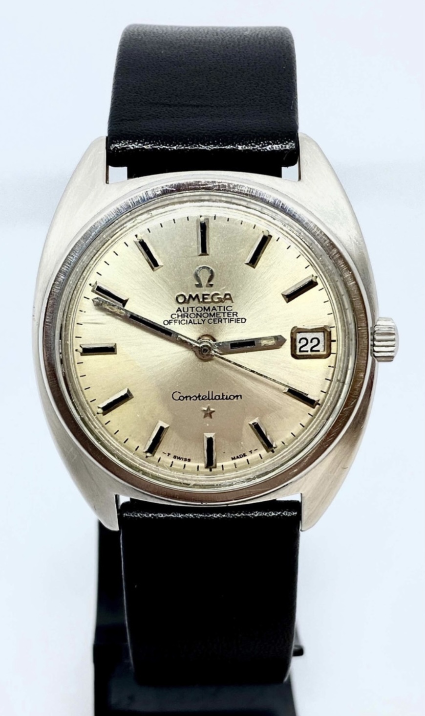

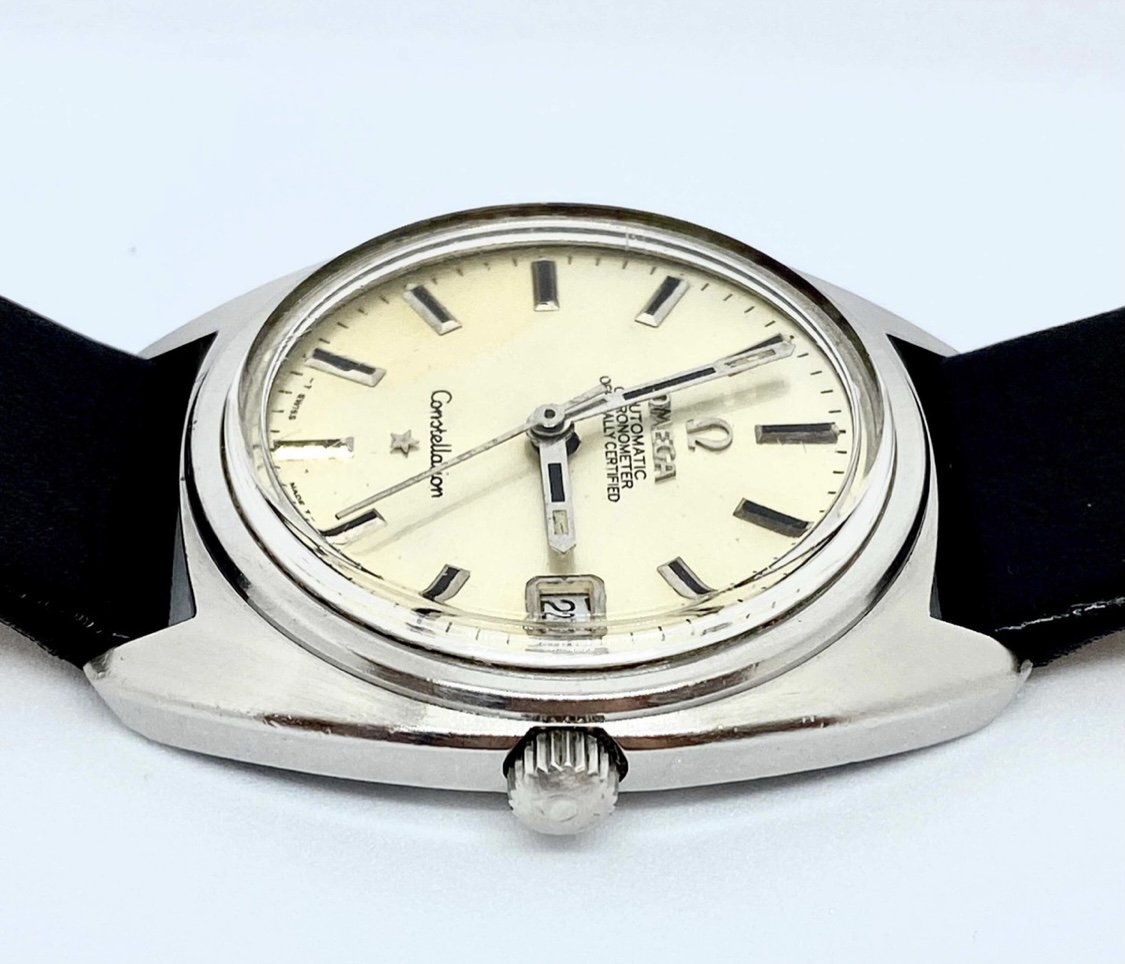

Redial. Hour markers wrong and appear hand painted from later Connie. Look at star - not straight. T Swiss inside track.
Not bad for price but always will not be right. Find a bracelet and it could be ok as a beater wearer but you and any future buyer will know it’s not correct so don’t expect to ever see much price inflation! They are lovely to wear However. .
Mine on right shows what it should look like- bezel finishes vary from brushed to smooth and fluted, hands are wrong too.

The script on the dial looks incorrect - 'Automatic Chronometer' looks weirdly stretched, lack serifs (from what I can see), and look at the two n's in 'Constellation' - they don't curve inwards as they should. So looks like a redial. Not sure about the hands either.
There was one in private watch sales this week that was well priced might be worth a look for comparison as well as the beauties posted by @Norfolk
