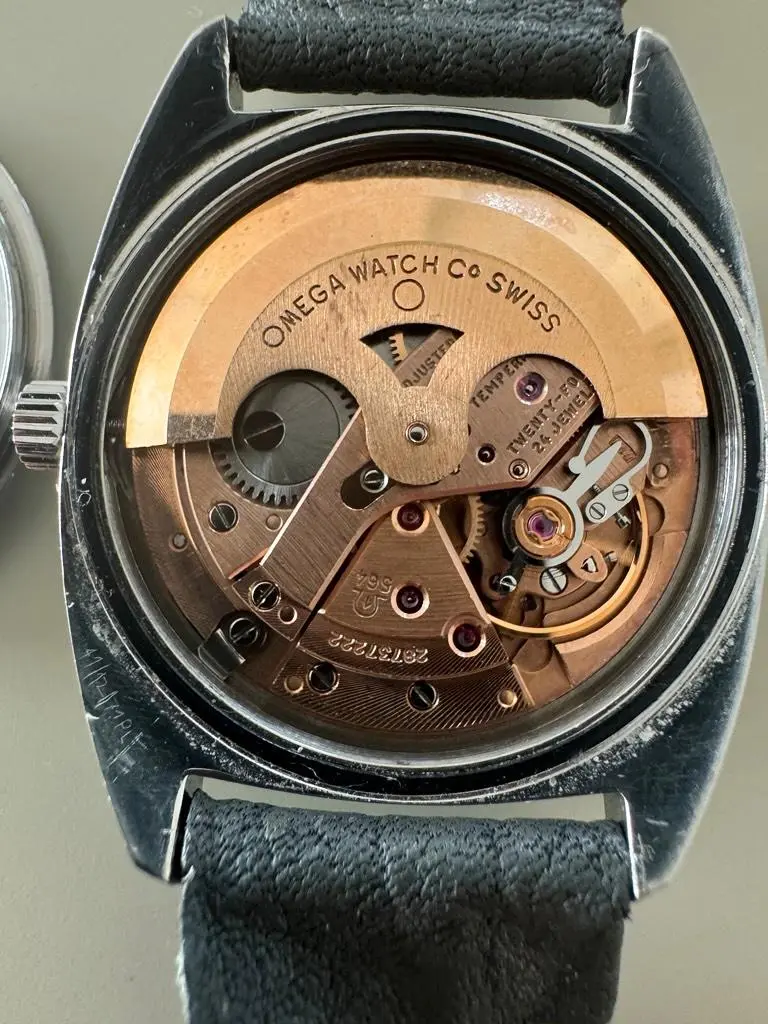

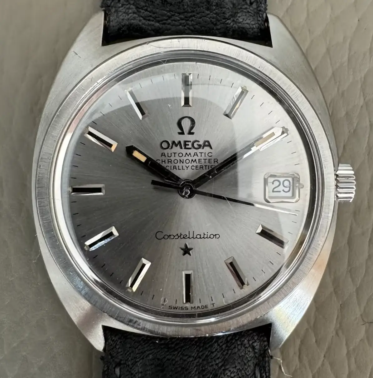

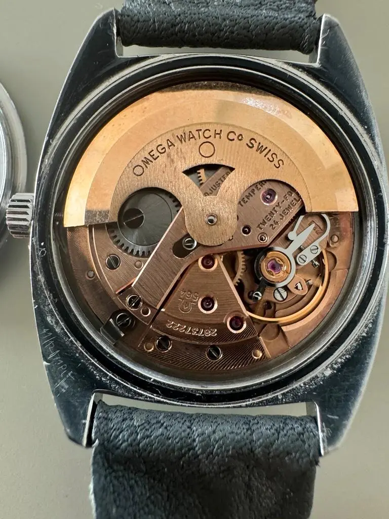

Posts 1 Likes 0 Utrillo ·Jul 10, 2025 Hello everyone, I am going to buy my first Omega watch, and I would like to hear your opinion on this one particular piece, which caught my eye. What do you thin about the condition and what a fair price should be? Thanks in advance for your help.
Posts 3,615 Likes 7,838 SOG53 ·Jul 10, 2025 What is your assessment of the watch? What is asking price?

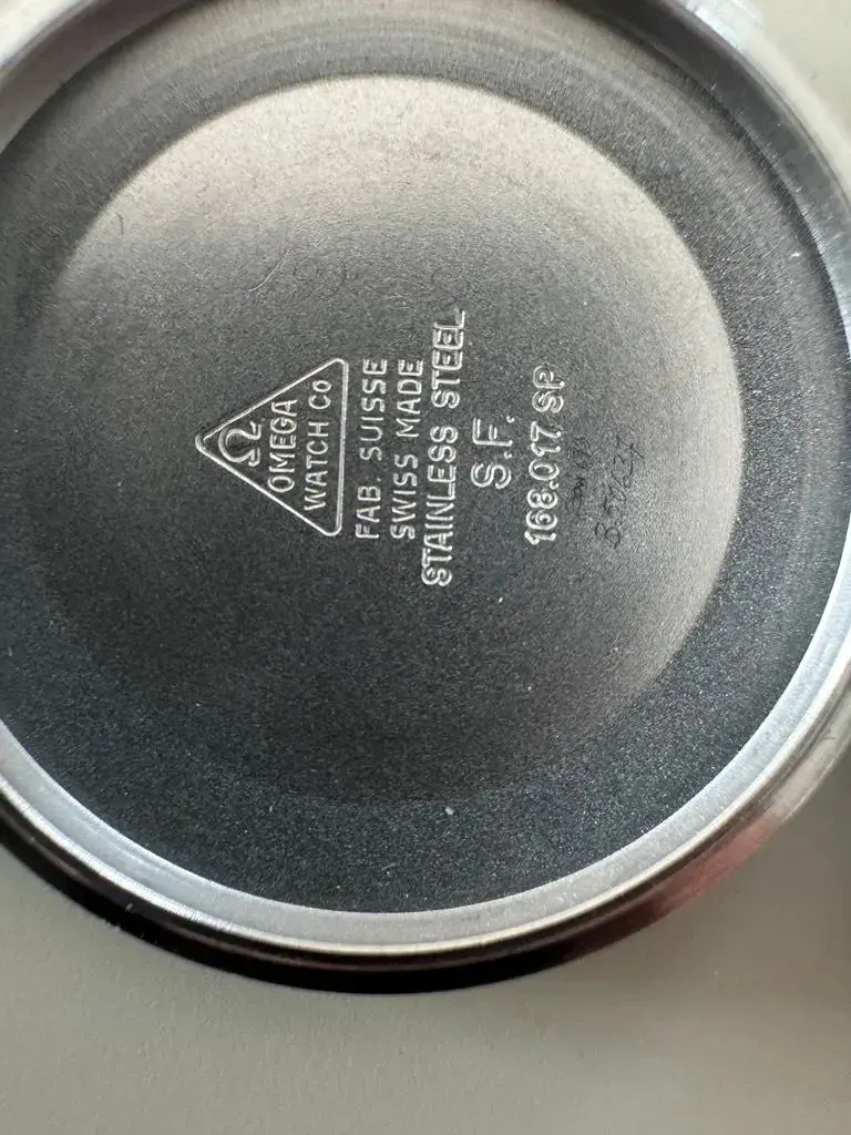

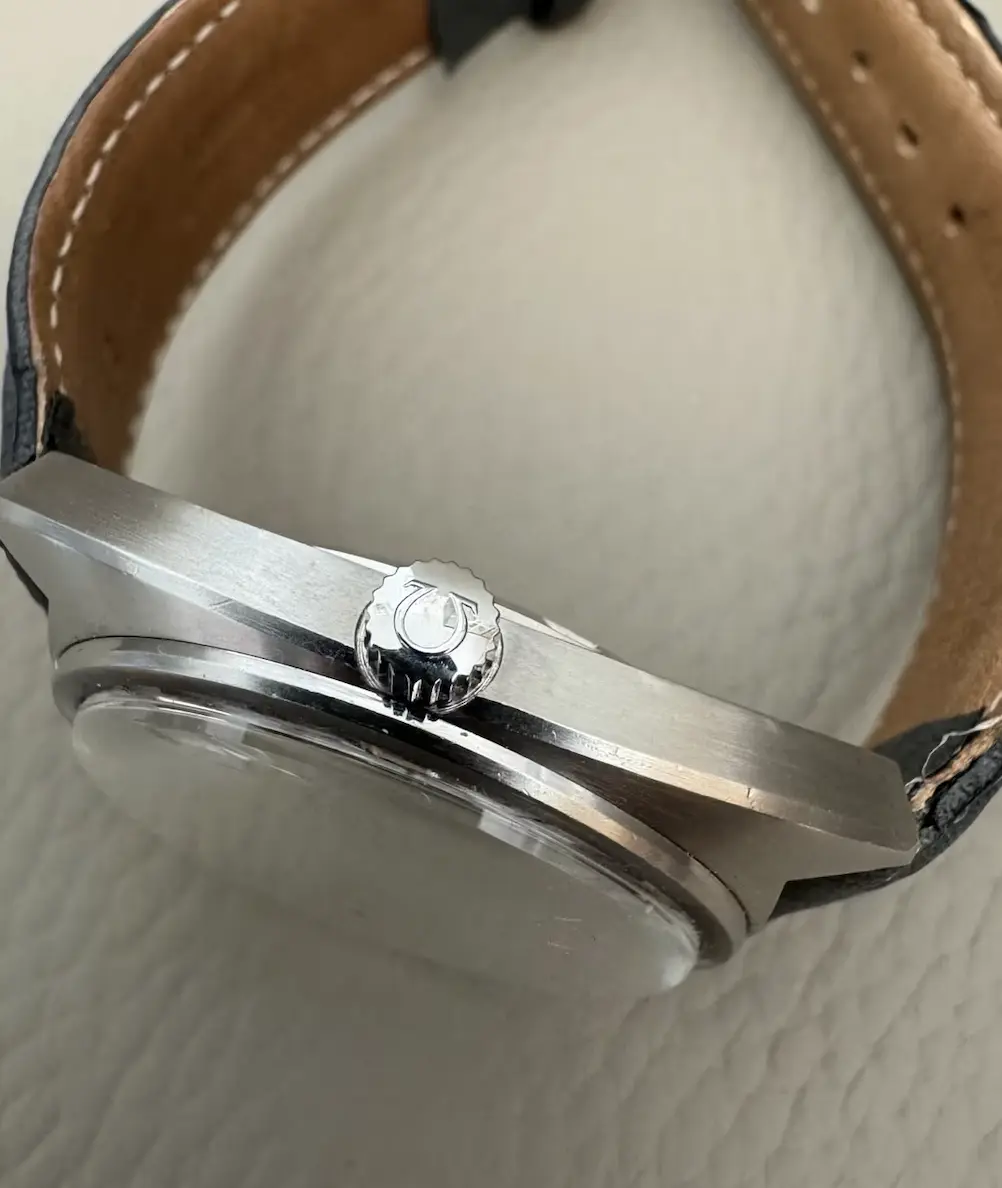

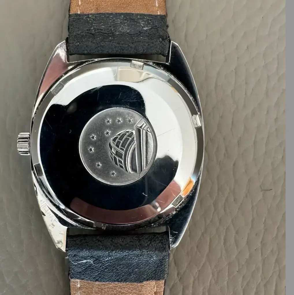

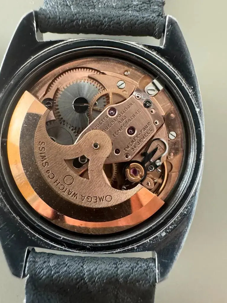

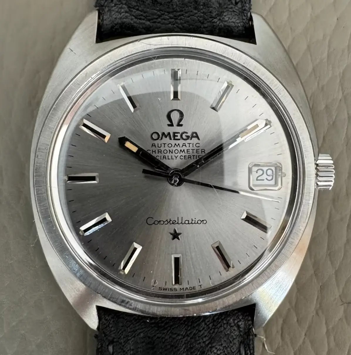

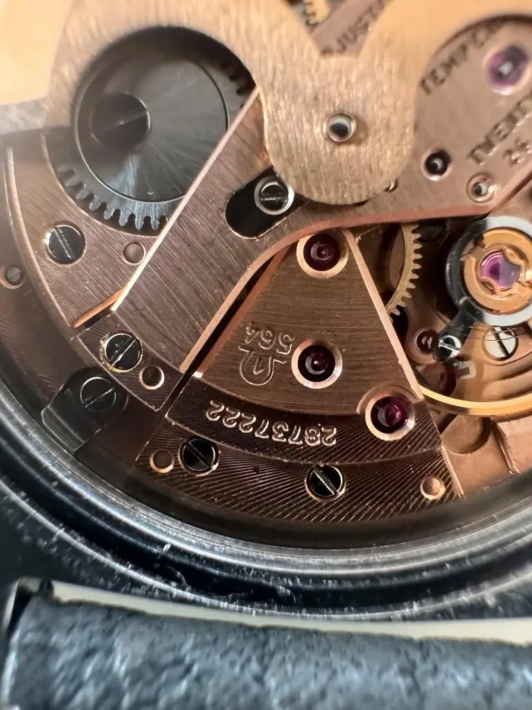

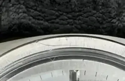

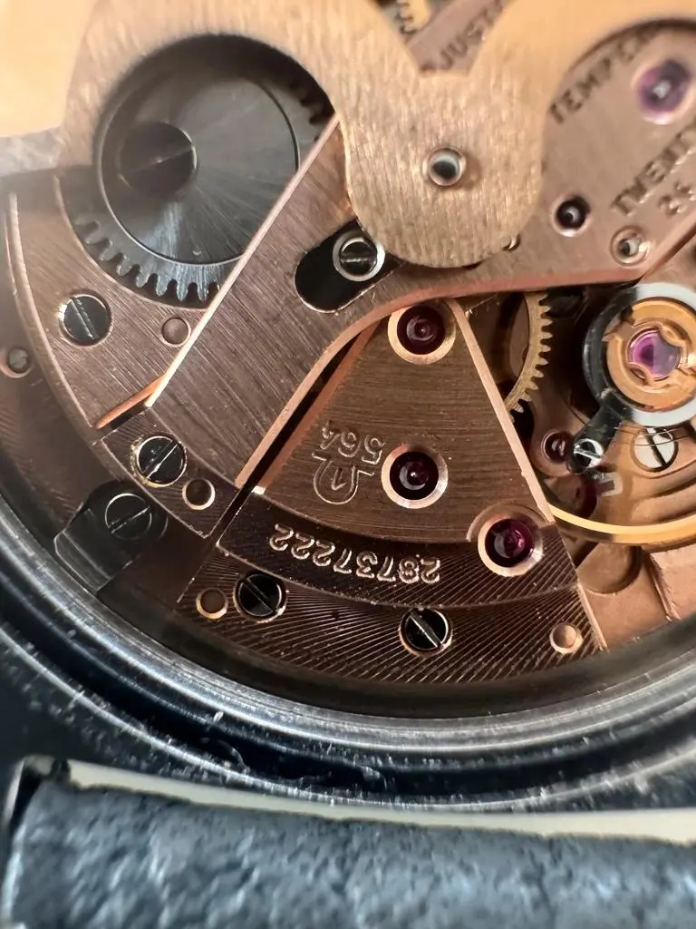

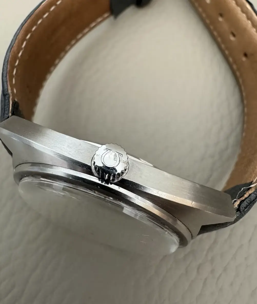

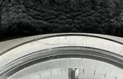

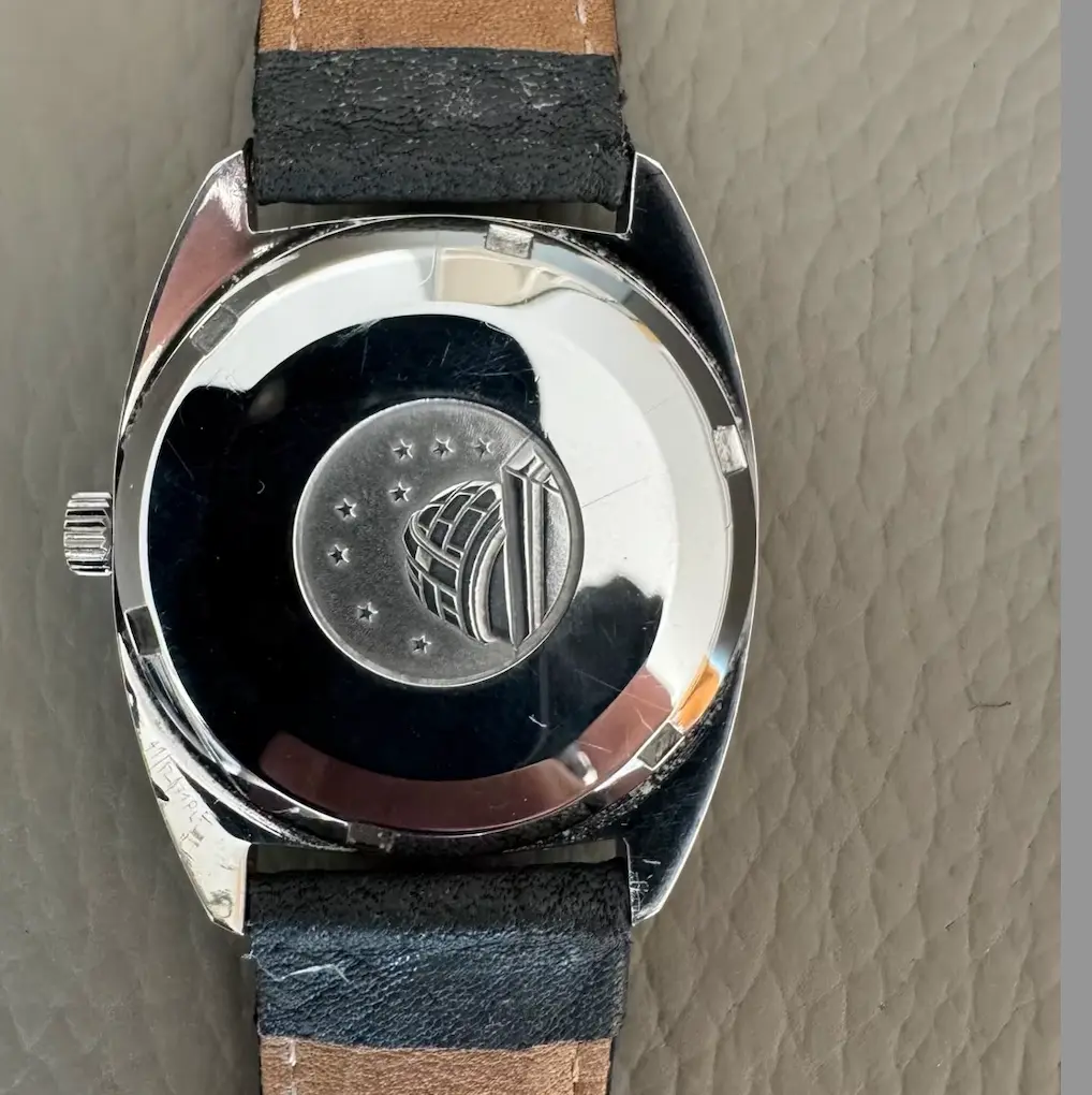

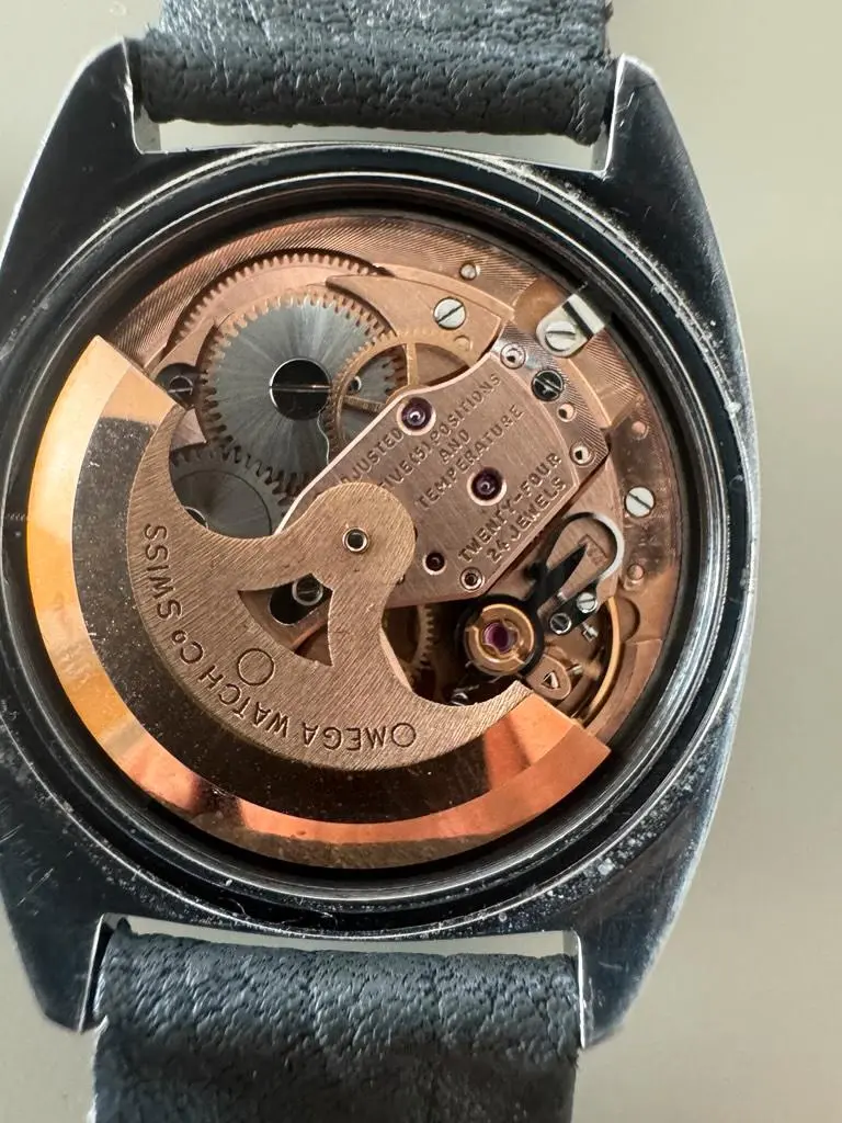

Posts 2,298 Likes 3,155 Passover ·Jul 11, 2025 Hi Utrillo! If you want to inform yourself about the current price situation of a watch check the "Sold" listings on ebay. C Shapes are not rare, the one above has a not so common dial/hands combination which looks quite attractive IMO The movement looks clean and nice. As the regulator is not in the center a service/adjustment could be necessary Crown is a later replacement, the caseback looks a bit too polished, maybe the rest of the case also There is a crack in the bezel as it seems As said above an asking price is required to assess the offer. Happy hunting! Edited: Jul 11, 2025
Posts 2,298 Likes 3,155 Passover ·Jul 11, 2025 Edit: Maybe it's 'only' a scratch, you should ask the seller Edited: Jul 11, 2025
