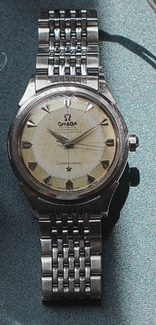

I am looking to buy my first omega vintage. I am interested to purchase a Omega Constellation ref. 2825.
I have some questions:

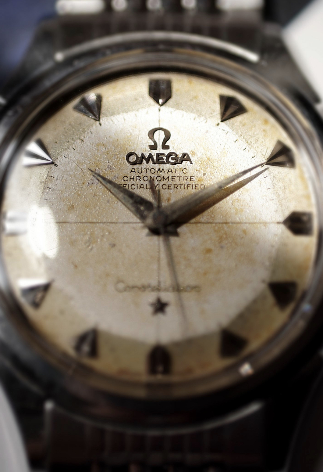

- I am a bit concerned about the excessive patina on dial. What do you think?
- which is right price in your opinion?

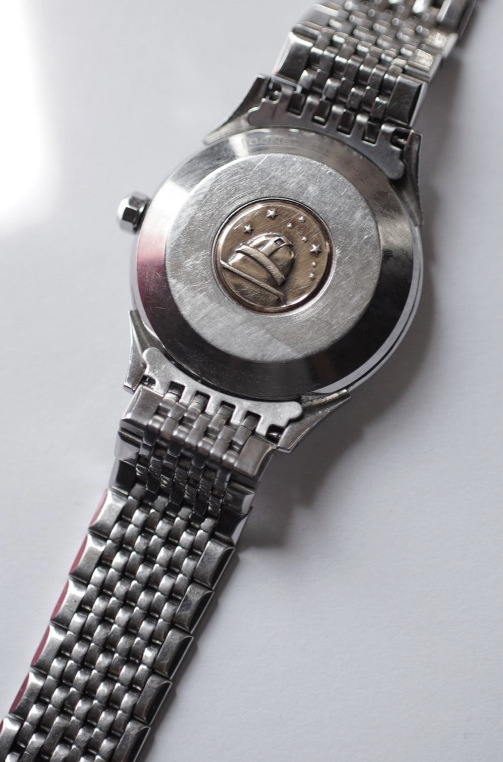

- no papers and no box available. Anything that can help to understand original or fake from pictures?
thanks in advance.

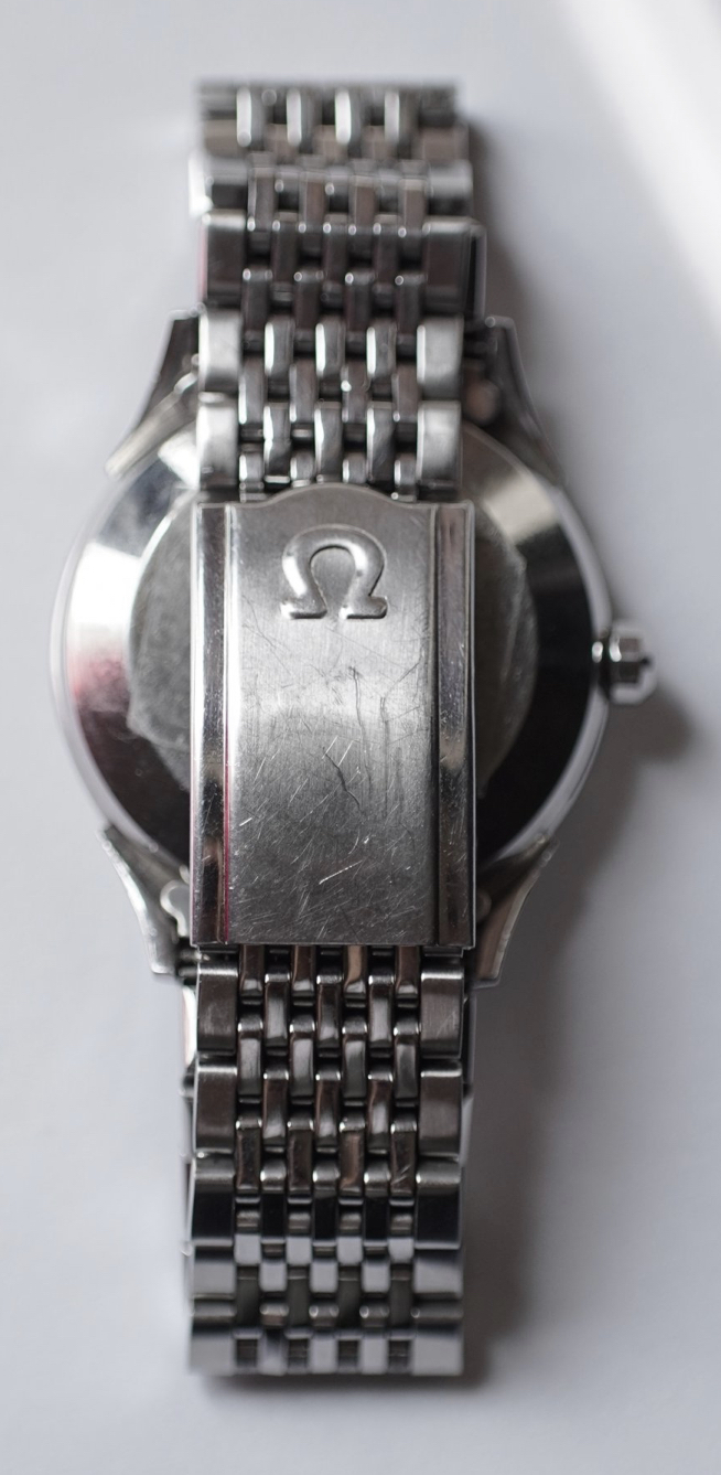

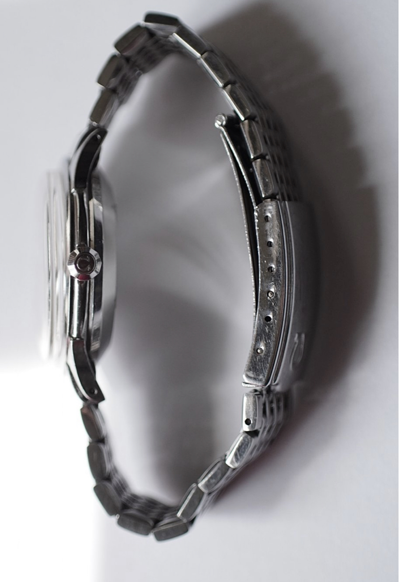

Something to be aware of is that this watch has both patina and light bubbling of the dial. The patina is personal taste, although for me a little heavy here, whereas the bubbling is considered damage and never desirable. The cae looks in decent shape.
With that in mind, plus the bracelet which I think is later than the watch, plus I assume being in need of a service, I'd put the watch at €1-1.2K.
Had the dial not have bubbling then it would have been €1.25- 1.5K

I would pass. There is patina and then there is dial damage. This is damage. Take your time and find a better example.

Thanks so much for your input.
The seller says bracelet and clasp are original.
Patina is quite heavy for me too but thanks for confirming about the damage and bubble. I think I will pass on this watch

As @cristos71 mentioned, the condition of the dial is entirely personal, but that damage will have a significant affect on value.

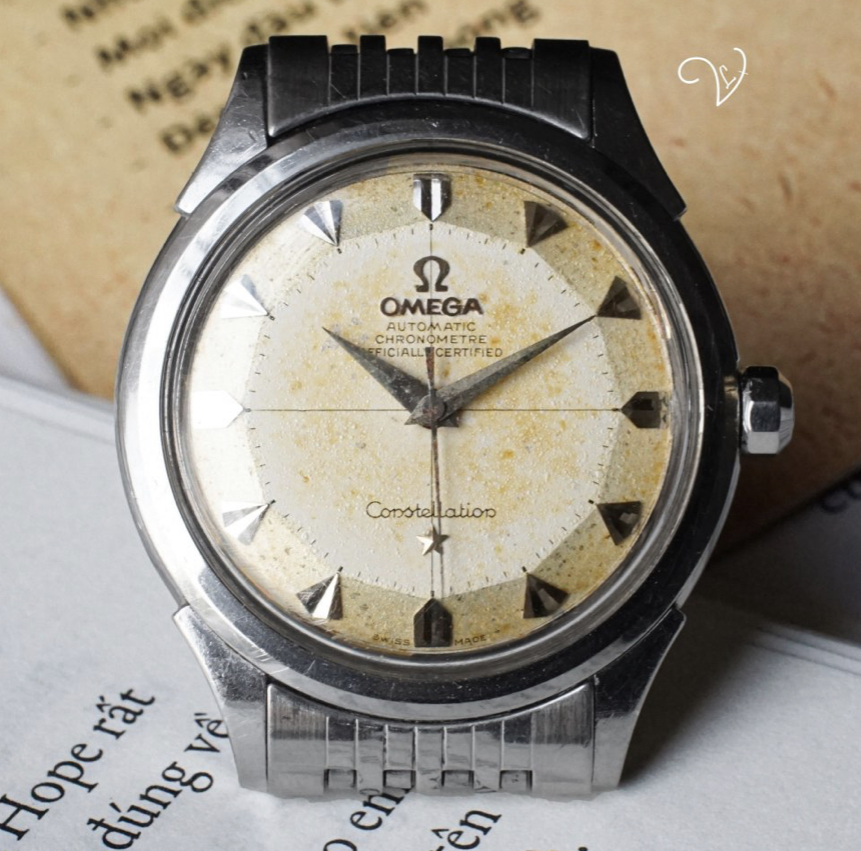

Can’t help as to watch conditons but very curious on Vietnamese characters in photo background 😀

Although the bracelet appears genuine, I would not say it's original. One would expect a five row BOR on this reference, not this later seven row.
