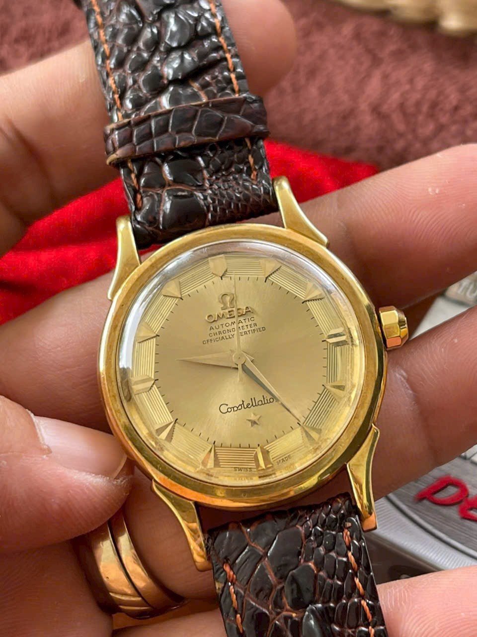

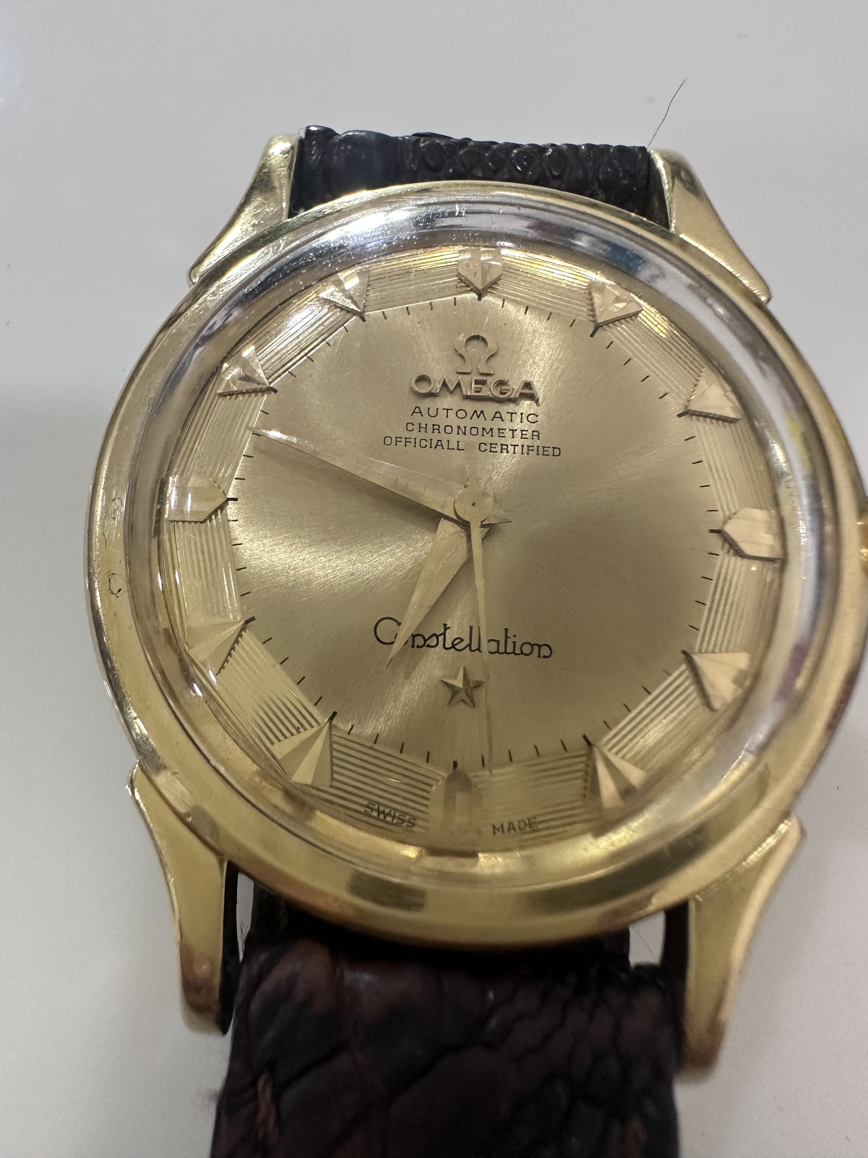

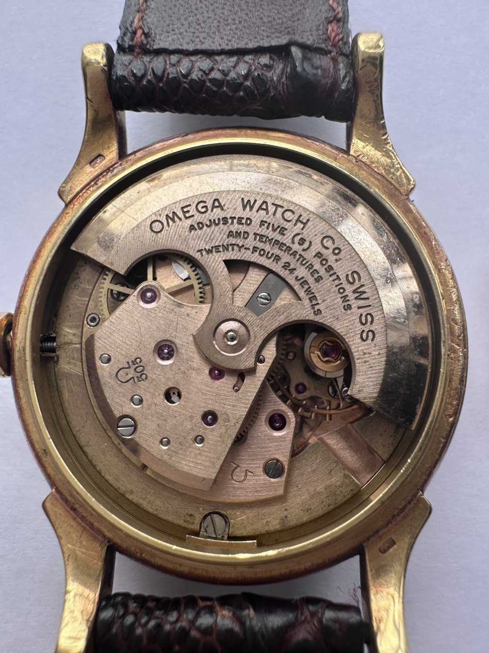

Guys help me see, I find this 18k dial very special, because it has lines from the center going out, it creates small rays like sparkling light.Thank you

A stepped pie pan dial.
Did you have a question?
13,671
19,041
A stepped pie-pan re-dial. Not a good one either.
gatorcpa
What makes it not a good one? That there were no originals like this, craftsmanship, other?
13,491
31,809
The printing is very poor.
13,671
19,041

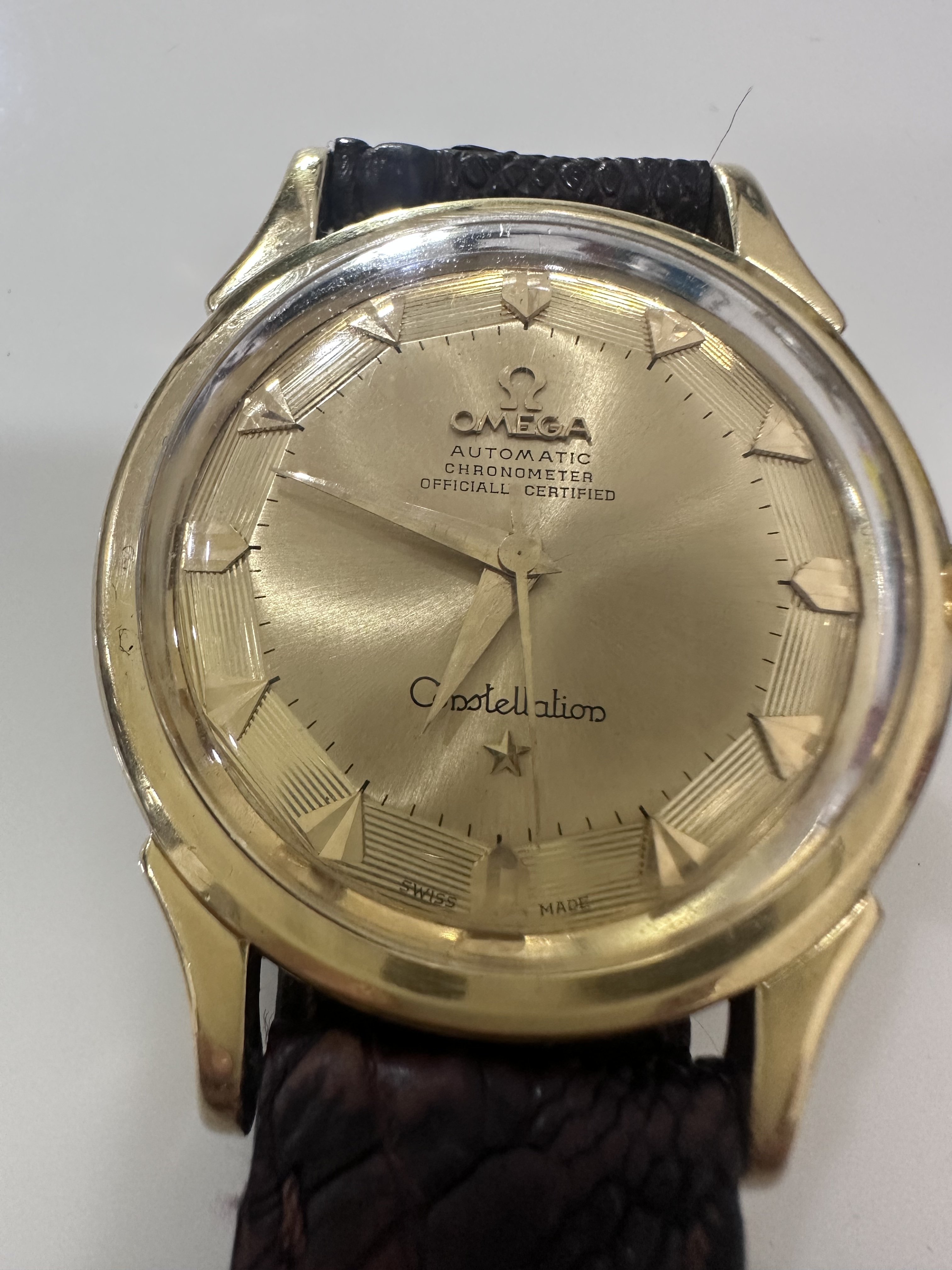

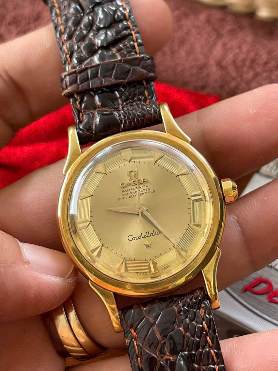

And totally incorrect fonts. Compare with this example.

I can see that now. Thanks!

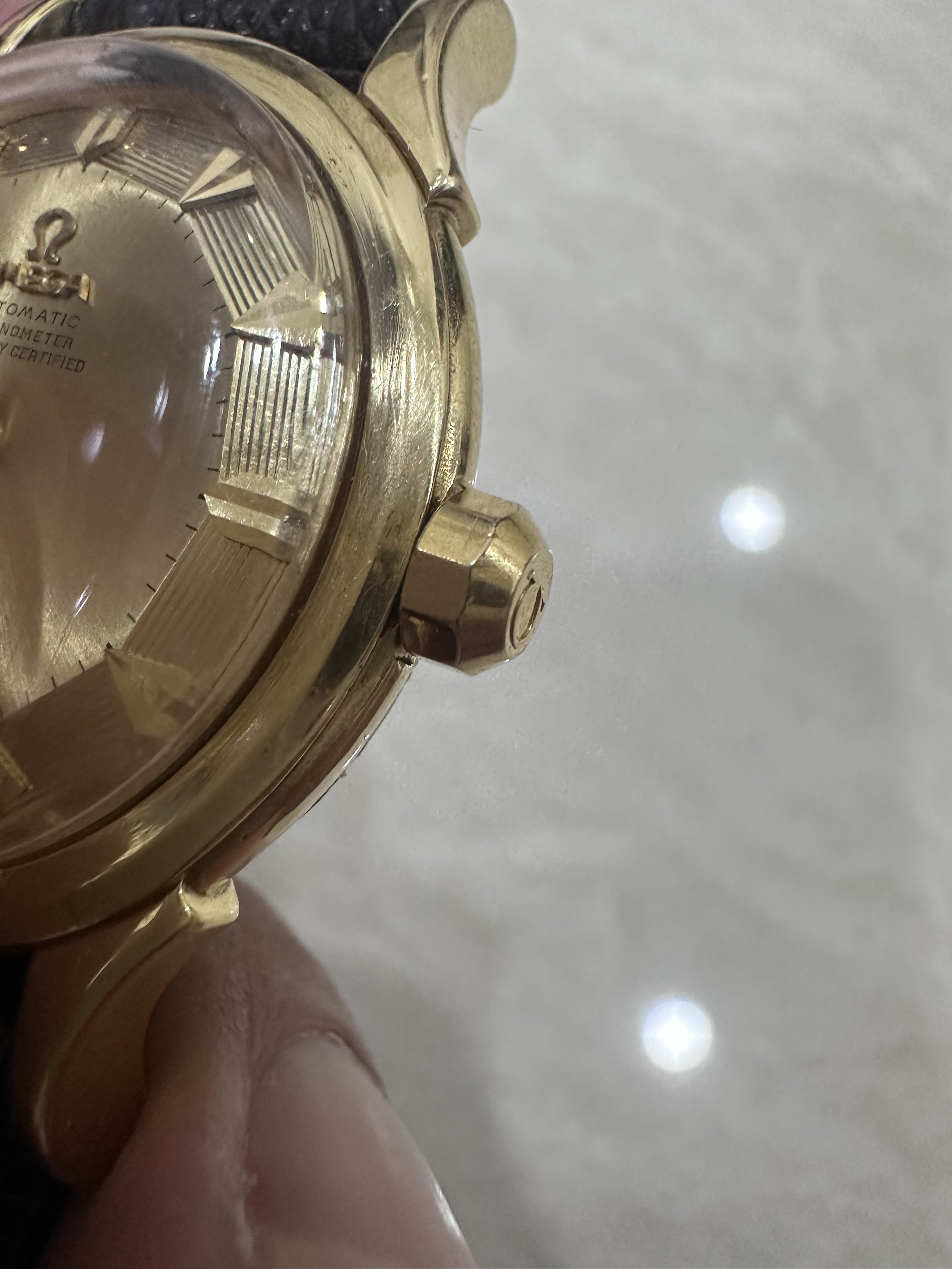

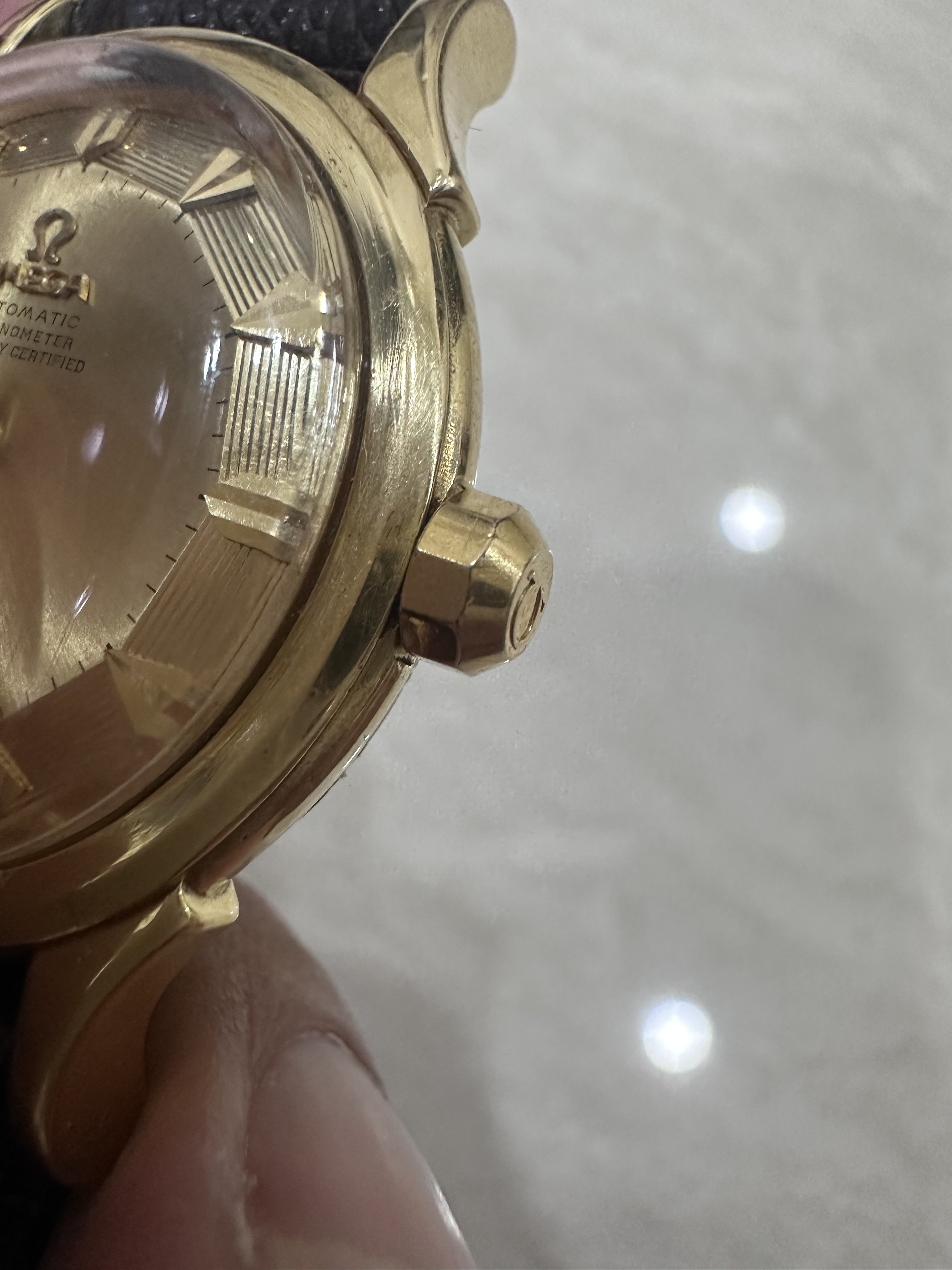

Are the lugs over-polished doglegs?
6,830
10,500
It’s a lyre lug reference.
13,671
19,041
This has lyre lugs. Case is polished, but not terribly.
Doglegs came started around 1962.

I want to sell it for $4000
This was originally a very special and desirable watch for collectors

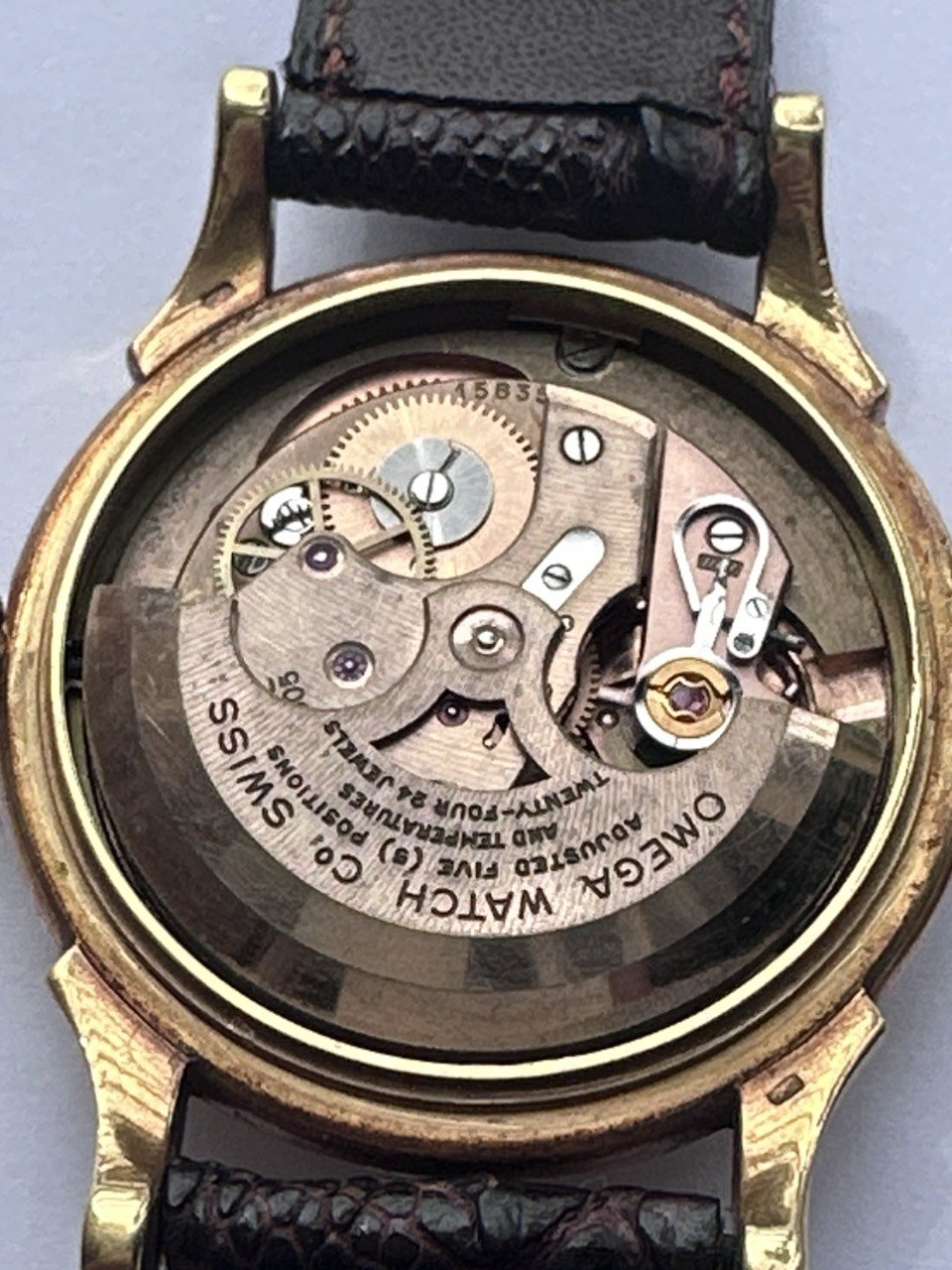

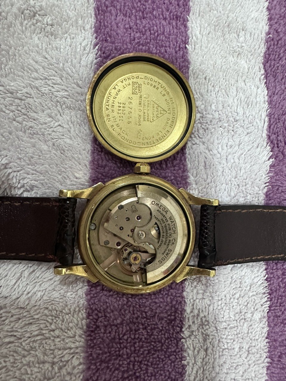

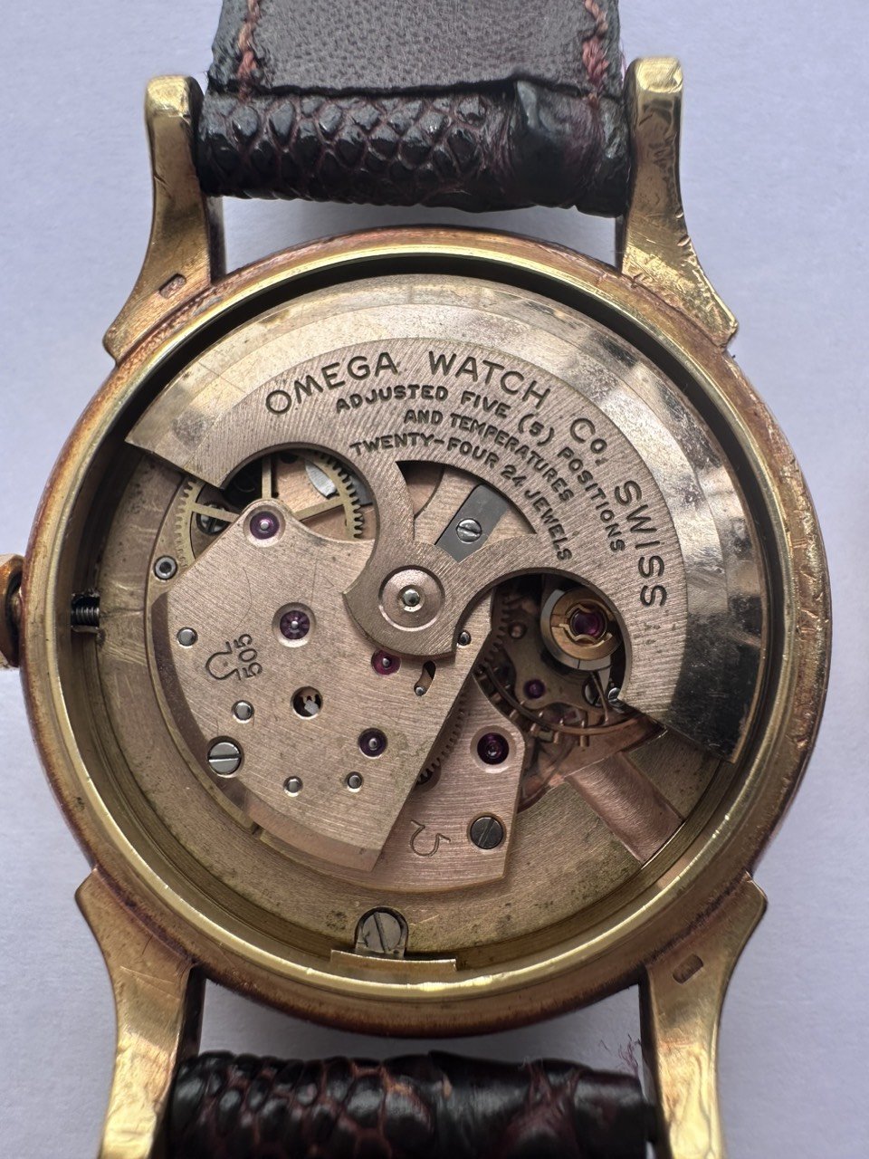

If the dial had been original and the movement and case in good order, you may have been able to sell it for around that figure.
Unfortunately, as it has been redialled with incorrect fonts, and the case is quite soft (polished) and the movement looks to need some care and attention, it is unlikely that you will realise anything near that figure.
Someone may wish to buy it as a 'nice vintage watch with unusual dial' - but I suspect the market value is around half of what you are wanting to sell for.

Can you point out to me what is wrong with the dial and is it not original?
thank you
Compare your dial to the one @gatorcpa kindly posted for you - especially the 'Constellation'
6,830
10,500
Are you talking about this dial?
you posted this dial.
The fonts are incorrect.
