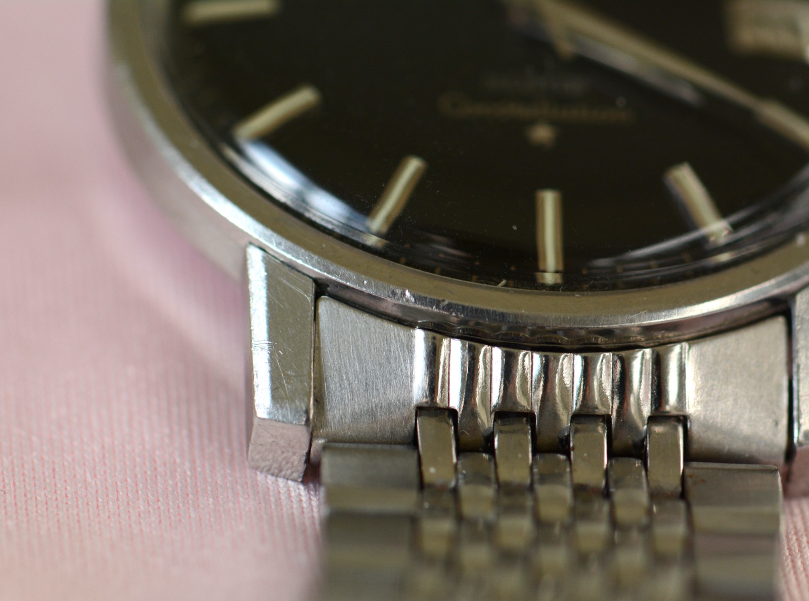

Dear OF,

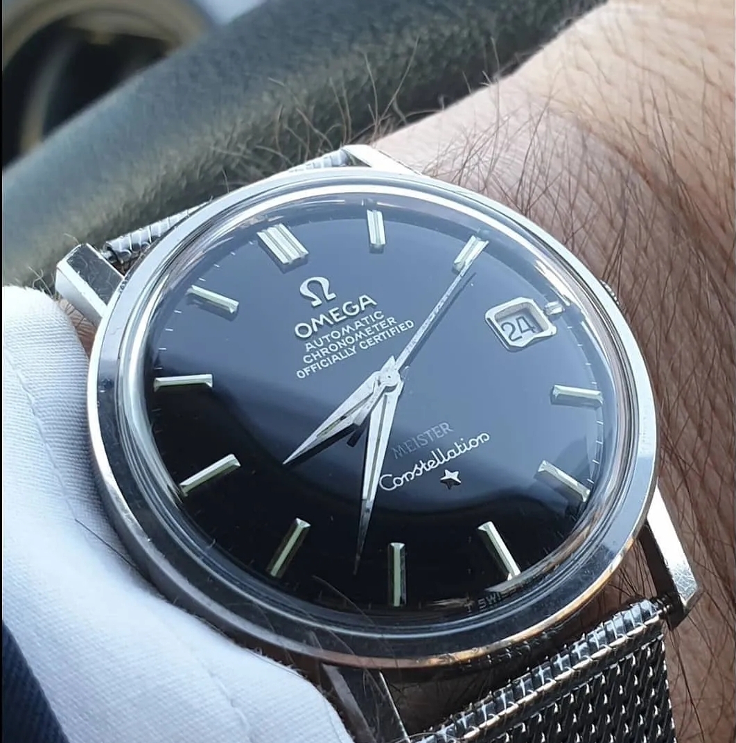

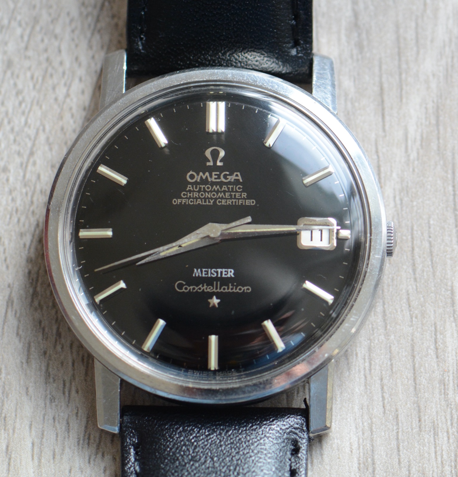

Can you tell me something about this nice Omega Constellation ? I want to buy, but I can’t confirm 100% it’s correct or not. For me the dial looking good and also the hands - but can’t find another one looking like this.
thanks for your answers 😀

I'm not an expert; Looked good to me, very special, and many other one of a kind Omega's out there, it's a good thing

Looks good to me 😀...be quick if the price is right it won't last long!

It looks fine to me, but remember that you are paying for the black dial, the rest of the watch is in mediocre condition. The "Meister" does not usually care much of a premium and the movement looks like it is more than in line for a service. What is the asking price?

Good looking watch.

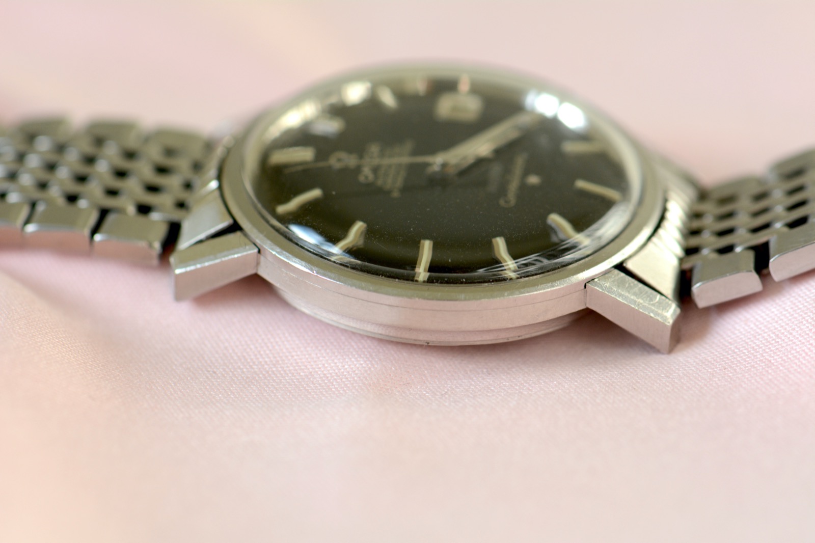

The case has a few dings but is otherwise good and strong with all the facets in place.

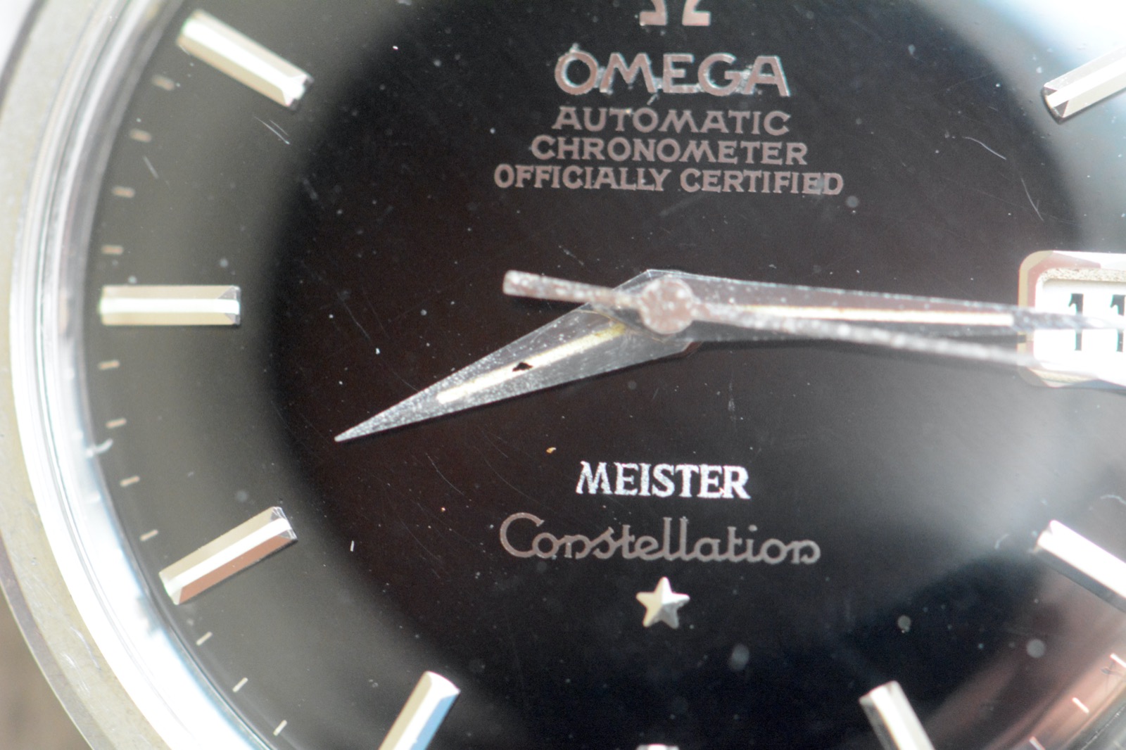

Heavily serifed font on the dial but looks correct.
Minty full-lumed indices are less common but look correct.
If anything, the added ‘MEISTER’ detracts from the watch for me but wouldn’t stop me buying it ( at the right price)

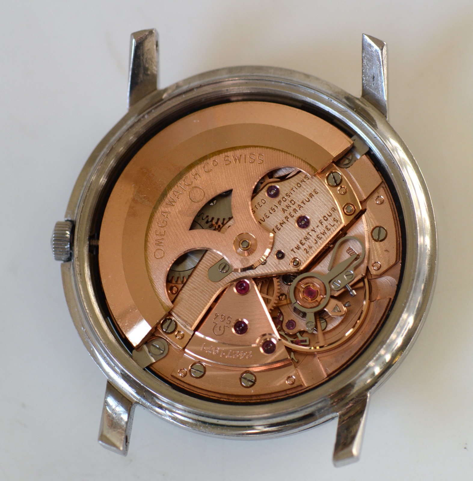

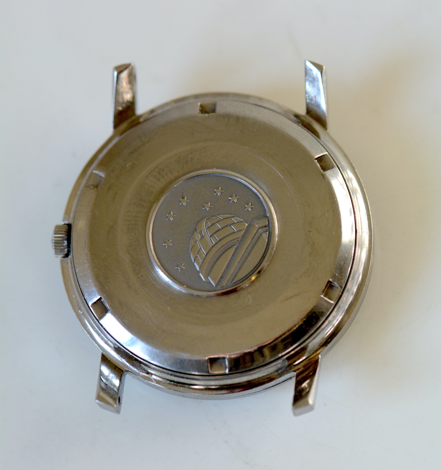

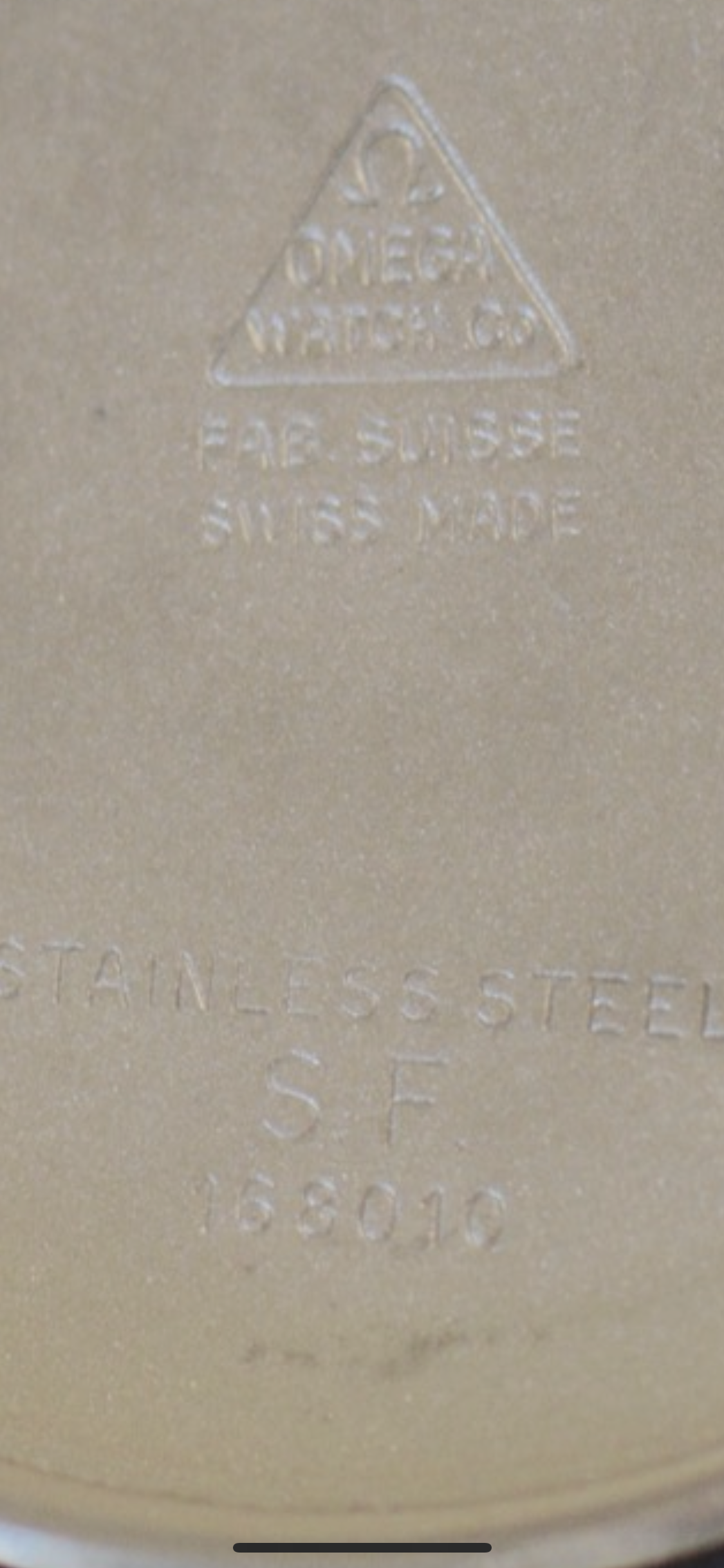

The movt looks like it needs regulating at best but the marked (replacement) rotor has me a little confused as there are no obvious corresponding marks on the case back.
Probably the original crown which is a bonus.
Does it come with the bracelet?
if so, another bonus to have a BOR with 19mm end links.
All in all definitely a watch worth having.

Agreed that the Meister doesnt carry much of a premium, but I find "mediocre" to be possibly a bit harsh, no?
Dial: Seems to be in pretty nice shape, definitely original. Not sure if the small dots are residue on the dial or dust on the plexi - the pictures by @Shabbaz when he sold the watch here looked really nice.
Case: Some dings and scratches all around, but bevels/edges are well intact, medallion sharp. It's the kind of watch that I'd very happily wear and wouldnt be too worried about. It's not great, but very wearable and to my eyes also not mediocre. Original crown too.
Minute lume loss in the hour hand and some degradation on all hands, certainly highlighted by the close-up pictures. Bracelet is a nice bonus. The rotor sure shows wear, not sure if that's a prevailing issue or not, the seller will know. Regulator is a certain sign it hasn't been serviced (well) in a while. That can be taken care of, of course.
The dial is the party piece of the watch, of course. Wouldn't be easy to find another one.

Well, to my mind it takes little wear to detract from the presentation of a dress watch. The dings and scratches on this one makes me take it down a notch or two from the top tier. It is by no means worn out - "mediocre" is fairly accurate, IMO 😀

Understood. Personally, I don’t differentiate massively between tool and dress watches when it comes to my acceptance of wear. There is a category that is fully outside of (mostly) objective measures of condition, though, and that’s attractiveness. A watch might be pretty beaten up and still speak to me. This one does - I guess that (and the reason I’m not generally harsher in judgement on dress watches than on tool watches) led me to feel “mediocre” was a bit harsh.
Which is just to say: no criticism on your statement, even though I’d arrive at a slightly different verdict. 😀

As the current owner of this watch I’ve been following the discussion with interest.
I’m just an average guy, so “mediocre” is my middlename 😁.
As a non-native English speaker I’m in a bad position to argue about semantics in the language of Shakespeare. I can follow the logic that anything between top tier and poor is by definition “mediocre”. As biased as I am I’d go for the euphemism “fair” which would still be fairly accurate imo 😉.

To be honest, I was just trying to do a humoristic play with words. In all seriousness, I’m in the same camp as the previous owner @Shabbaz. It’s definitely not mint or top notch whatever you want to call it. The case is however solid with the original facets clearly visible. I took pictures with a macro lens that reveal more than the human eye can see and the visible dings don’t bother me either. And the dial is just gorgeous. Why I am selling it? I’ve been pondering for some time as it’s my first Omega vintage watch, but I’ve developed a strong aversion towards watches with date function as I rotate my watches on a daily basis and I’m too lazy to set the date correctly (and this one even has a quick set function). So it’s gotten less and less wrist time which is a shame, so I’m ready to let go.
