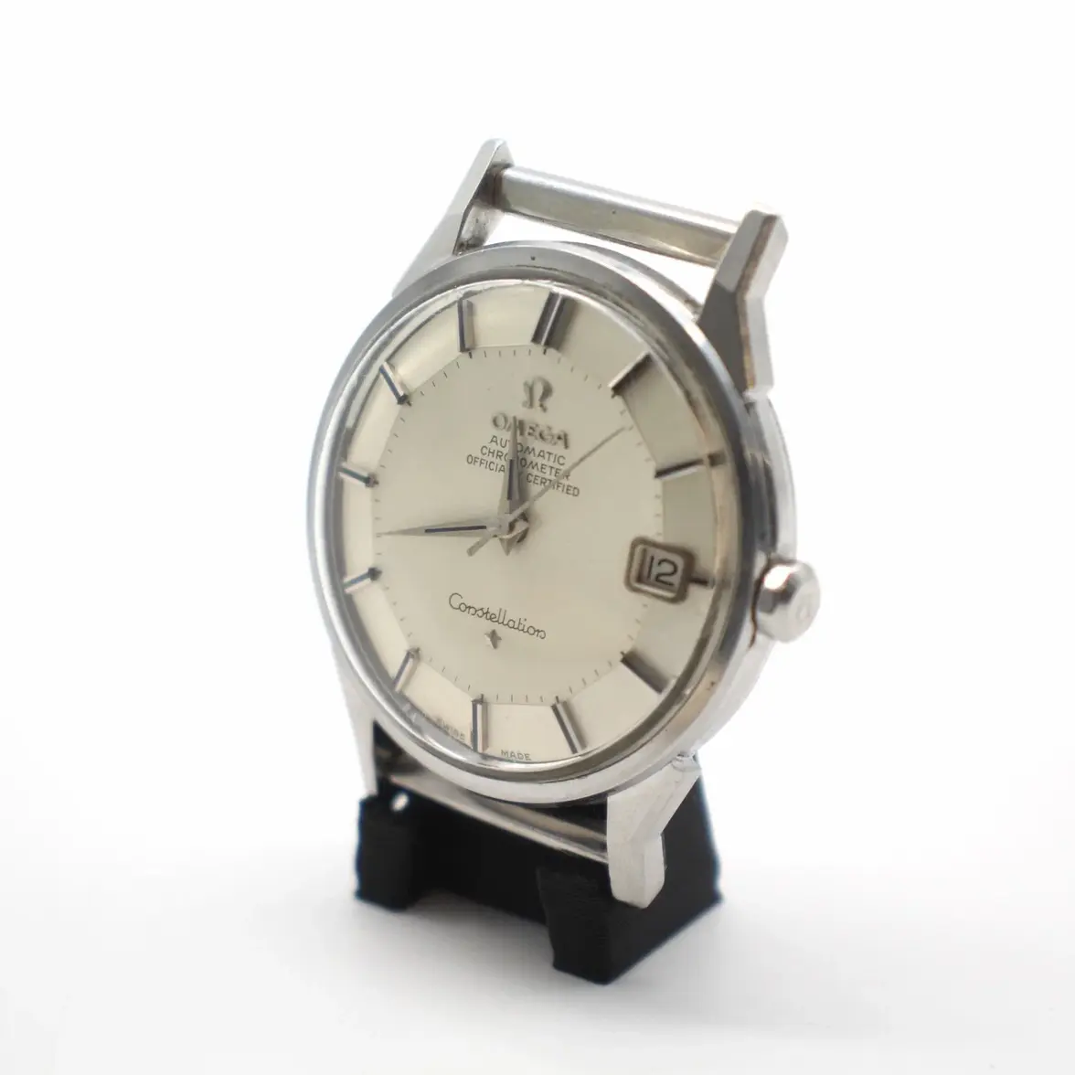

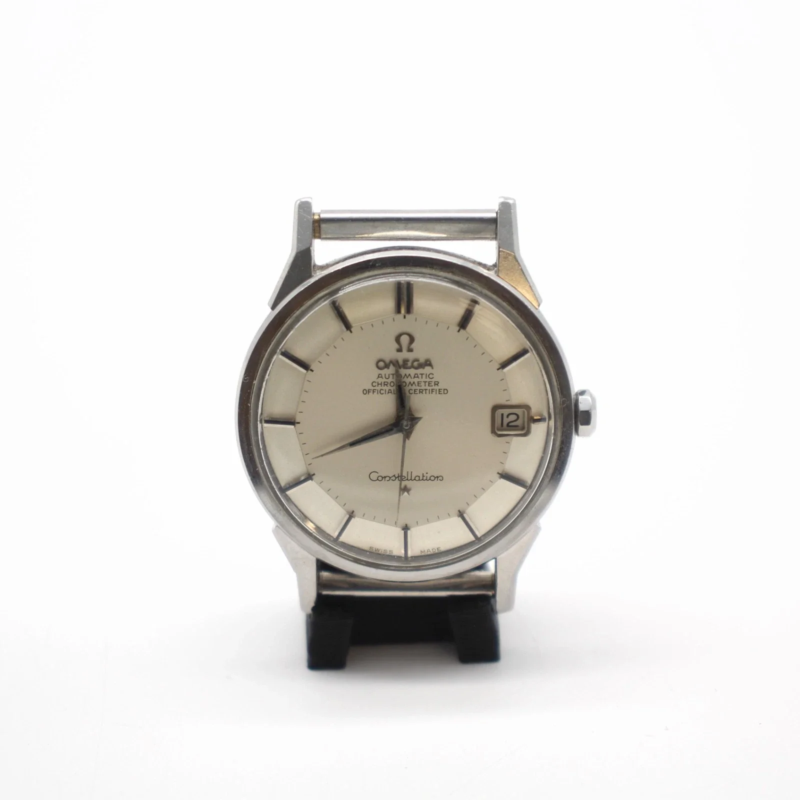

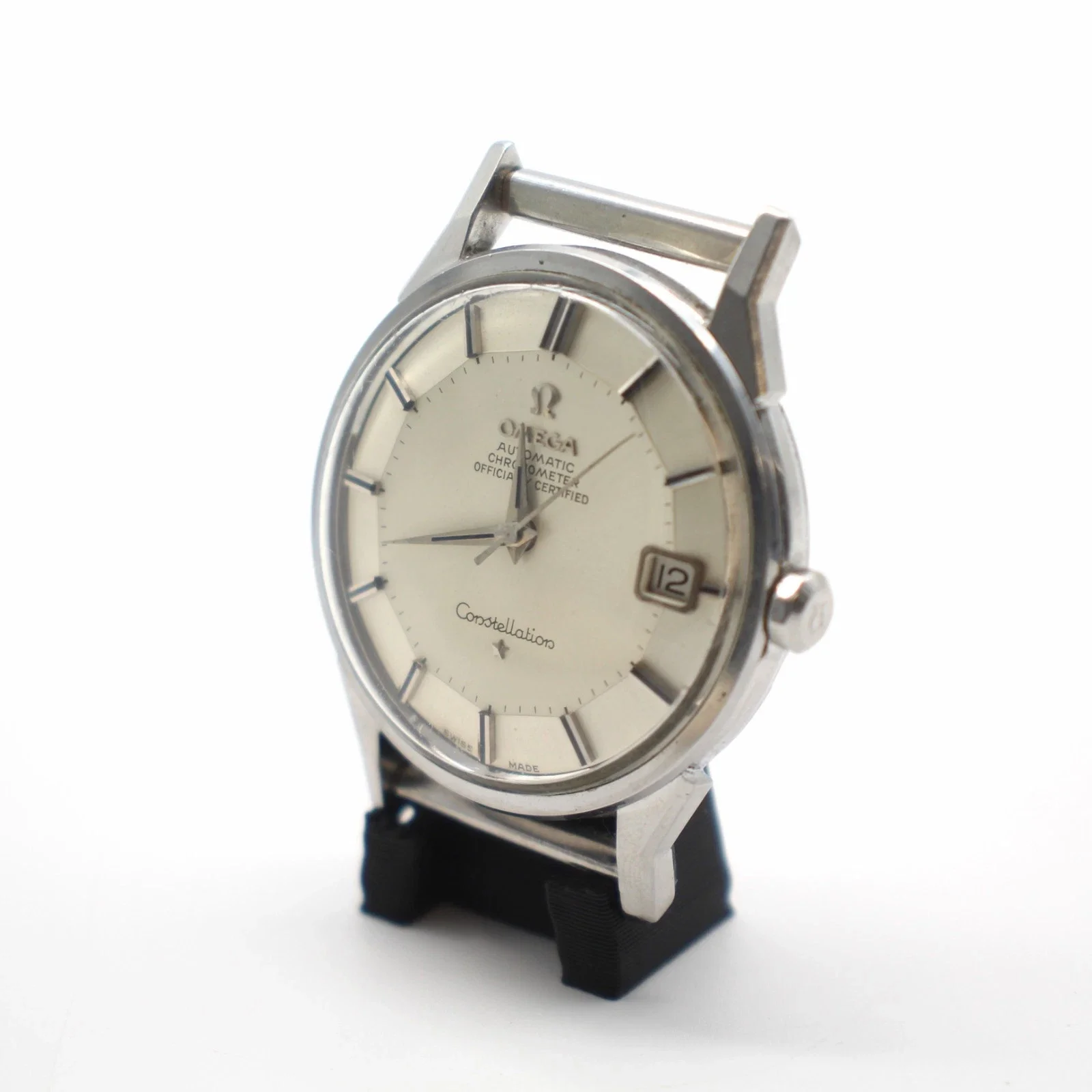

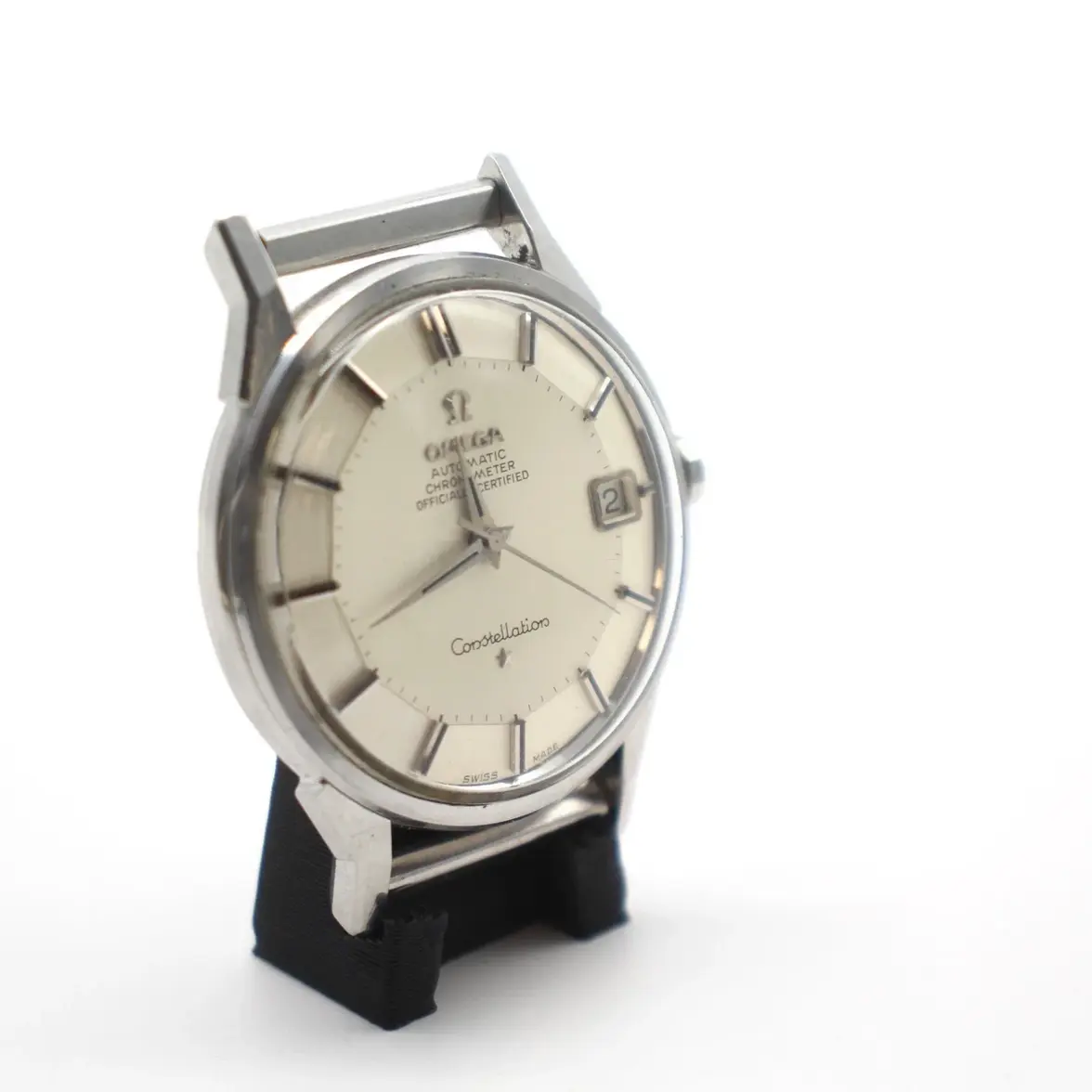

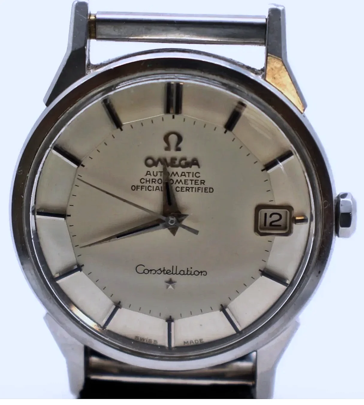

I purchased my first vintage Seamaster 20 years ago and have loved it as my daily watch during all that time. Like many folks I paid my newbie tax to this hobby purchasing a redial. I have never seemed to master spotting them, no matter how much I study this forum they are always obvious when someone else points the tells out.
Anyway have seen this Constellation 168.005 for sale and looks OK to me, although the hands have some pitting yet the dial is looking a little too defect free. Would love a second opinion on this one.
Thank you
Michael

Yea need more high resolution photos from different angles but on the surface it’s a decent dogleg Piepan

Looks good at first glance let’s see more photos

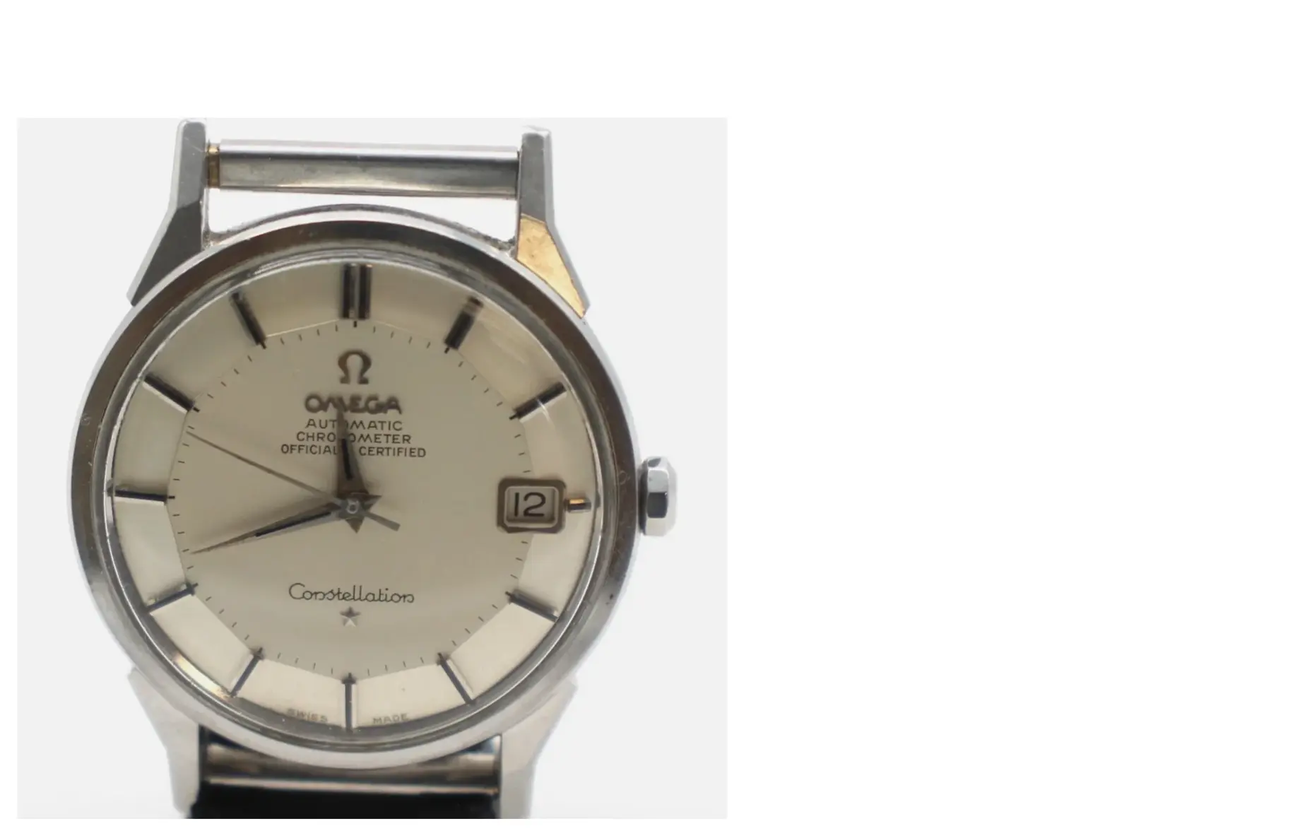

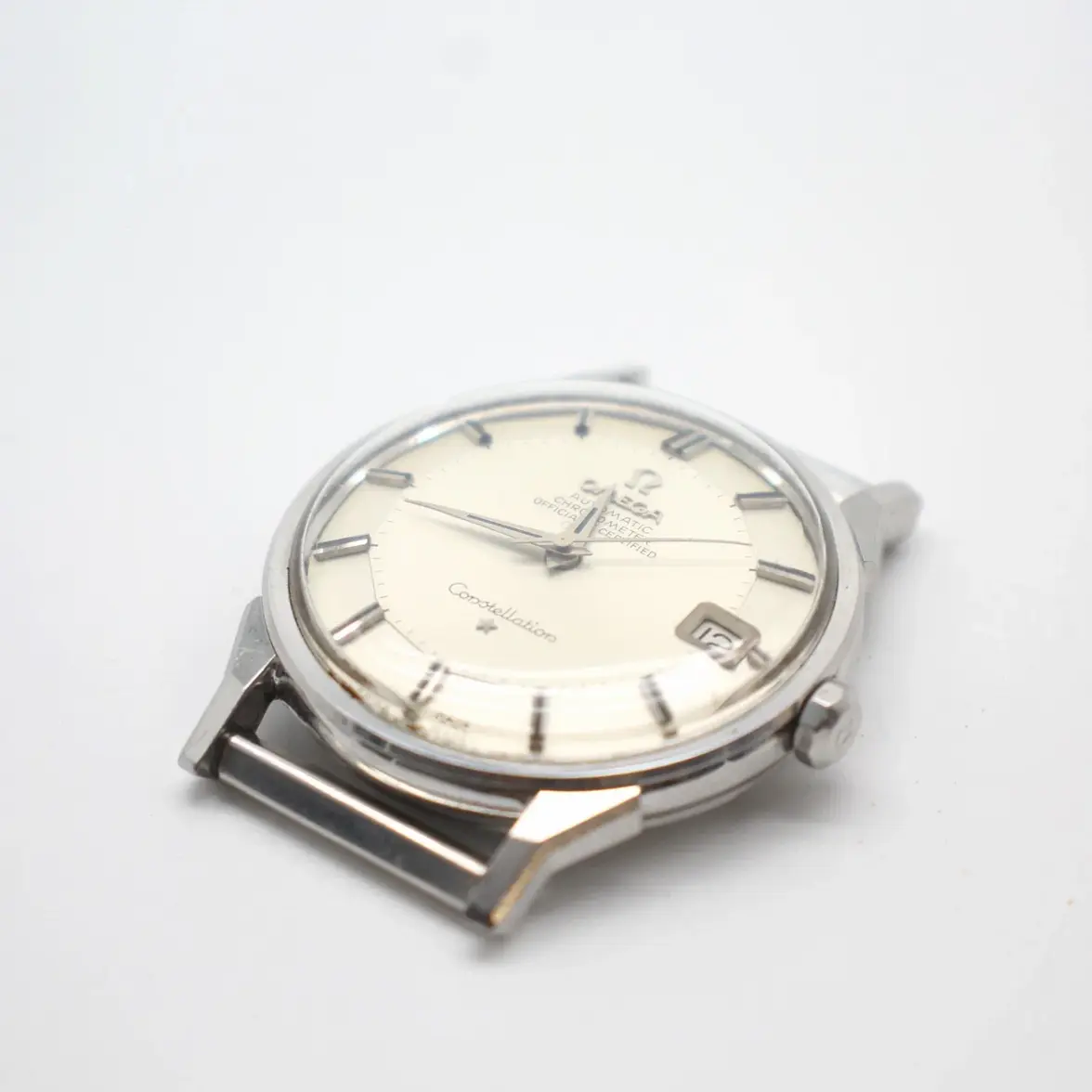

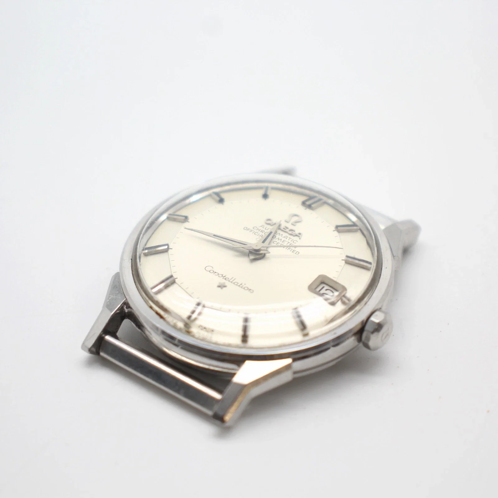

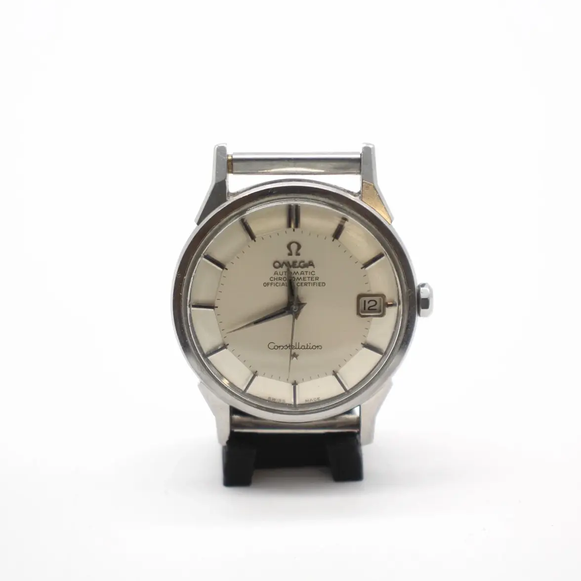

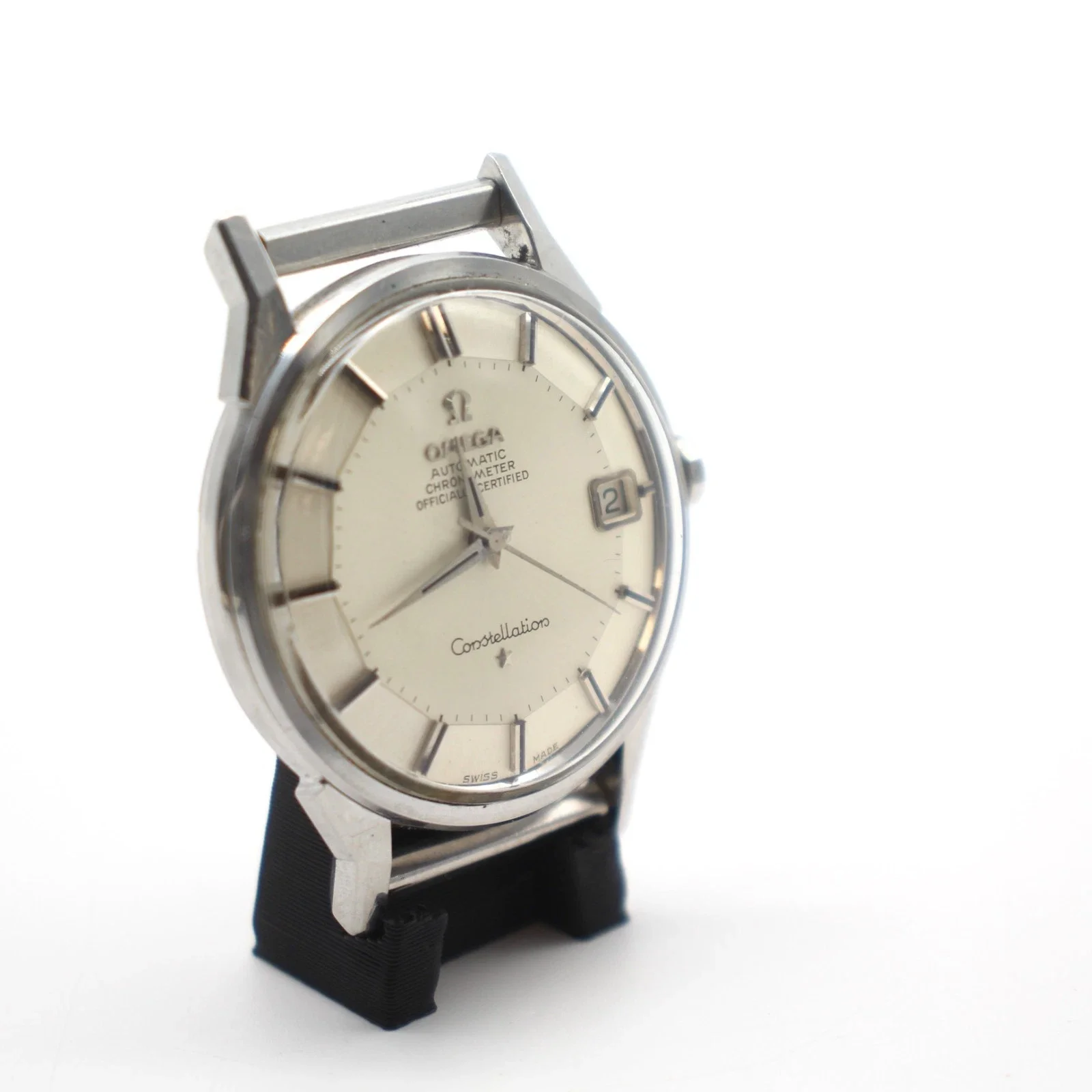

Thank you for taking the time to reply, I have added some additional photos.
My own take it looked a genuine honest watch but needed a little expert reassurance

I too quite liked this one as it looked pretty genuine and not been messed with (I hope!).

Photos are blurry. Case looks pretty sharp. Need focused photos of dial.
Movement and inside Caseback photos also important.
Did you buy it already?

Better photos would include moving the hands so that the writing is visible, the case-back, and the inside.

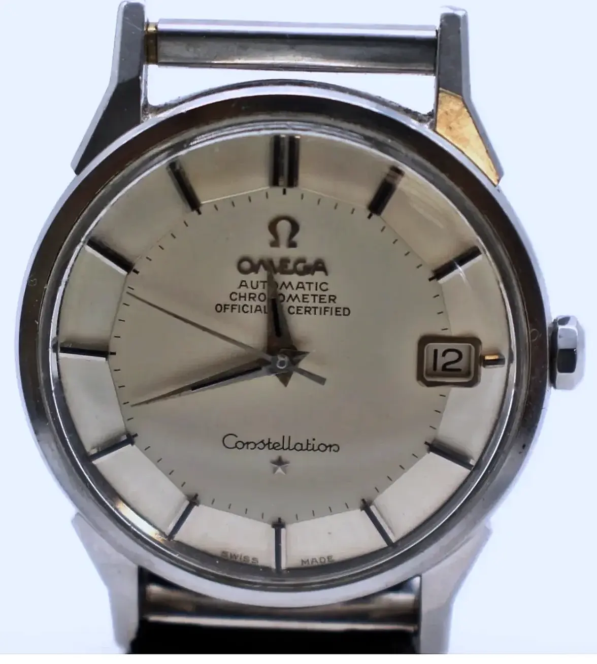

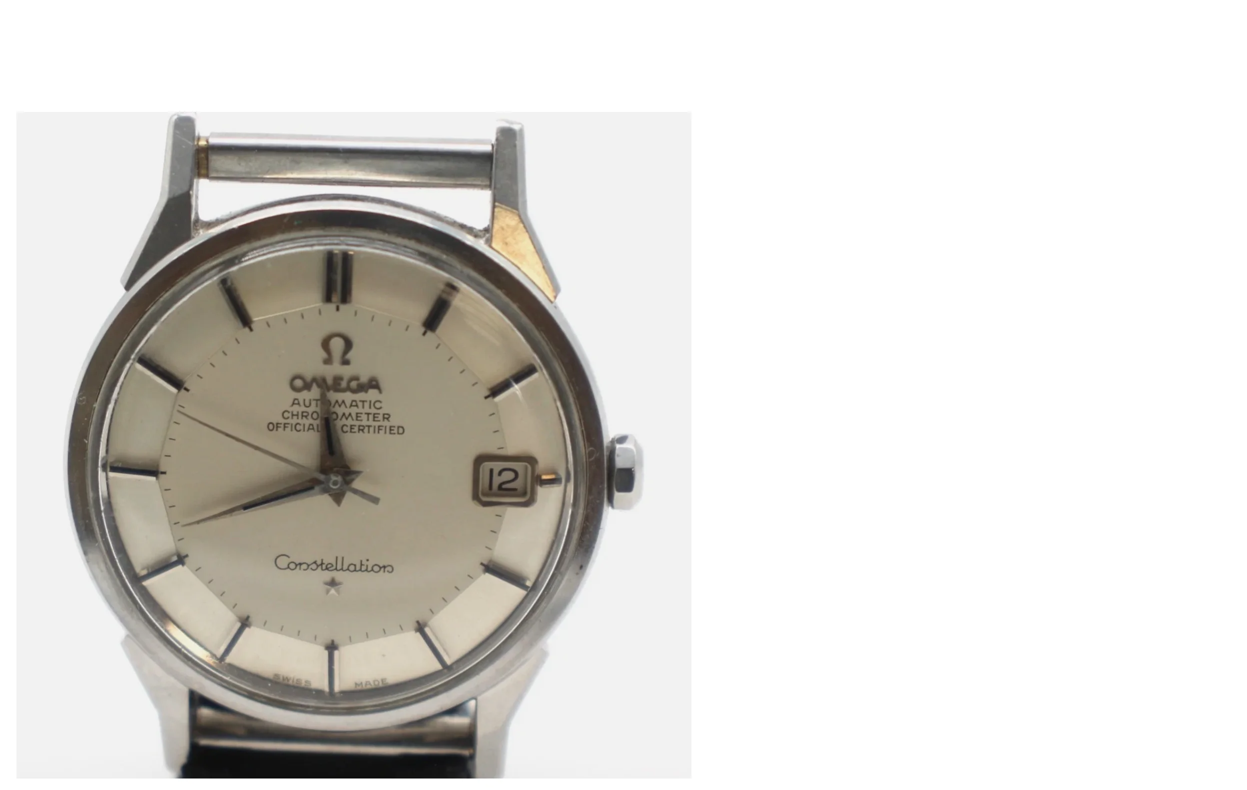

For future reference I wouldn't be fussed about supposed service history. Even if a watch is advertised as 'serviced', it's hard to say what exactly that entailed. Just consider that any watch you purchase will benefit from a service.
As for this one in particular, overall it seemed like a good example. Case retains all original geometry on the dog legs, the dial is clean. Not long ago this kind of watch would've been in the 1-1.5k range, but prices for pie-pans have gone insane. $2K USD doesn't seem outrageous to me.
