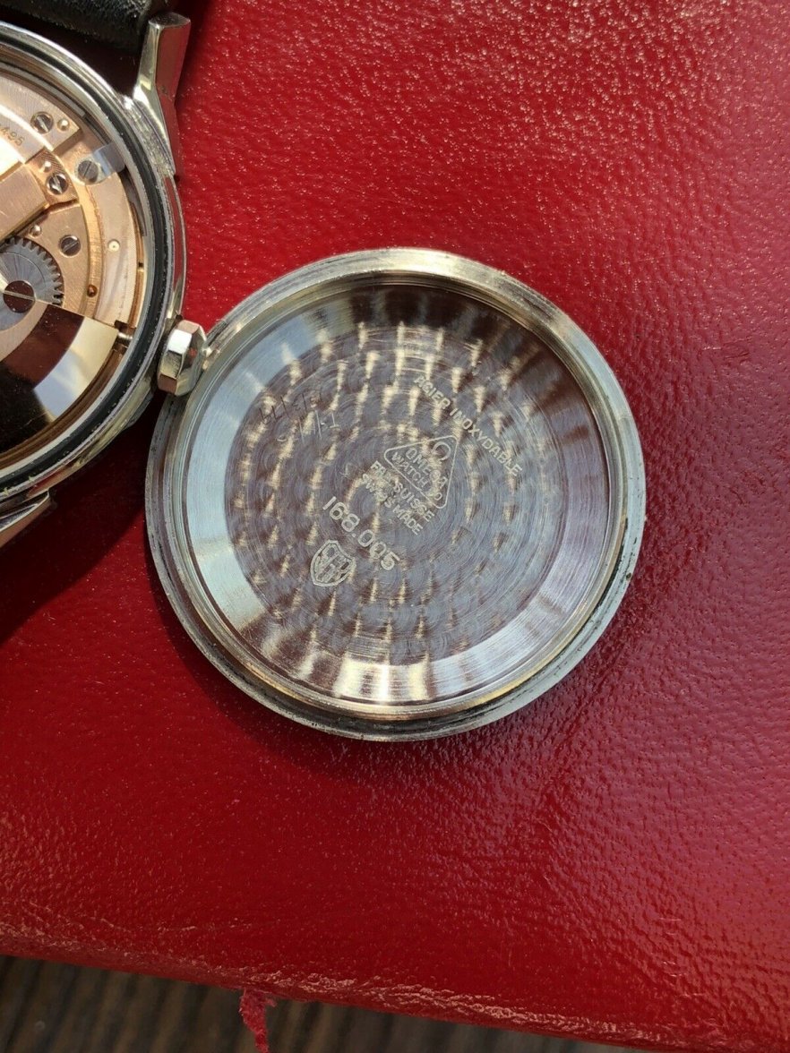

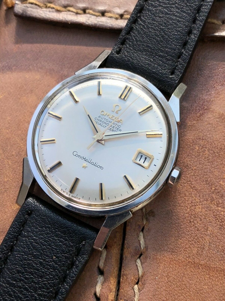

I am interested in a constellation 168.005 and seeking views/advice as it would be my first vintage buy. I am buying to use but don’t want to be stung by making a bad buy.

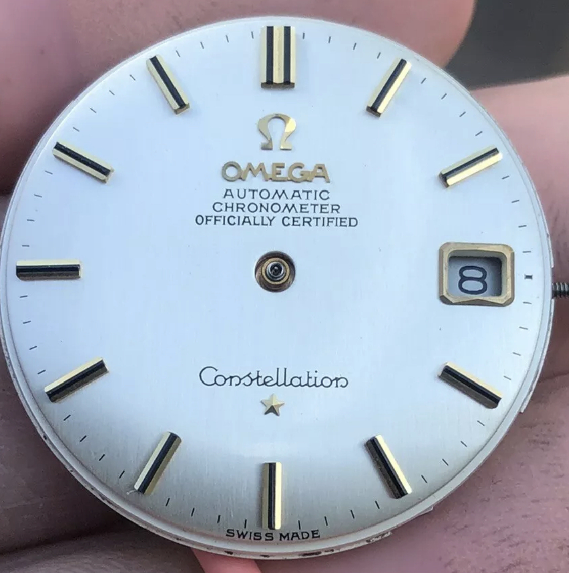

I’ve a bit of research and it looks right to my (untrained) eye, although I wonder if it’s a redial from the condition as it shows so little wear? The only other concern I have, is that the omega data base dates the 168.005 to 1962, but the SN dates the movement to 1966. Should that be a concern or deal breaker?
Thanks in advance for any comments and assistance you can provide.

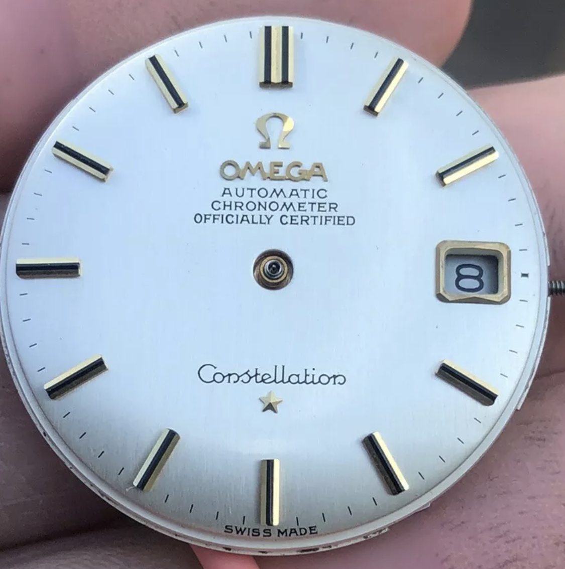

Hi and welcome here!
Good looking watch, dial is original.

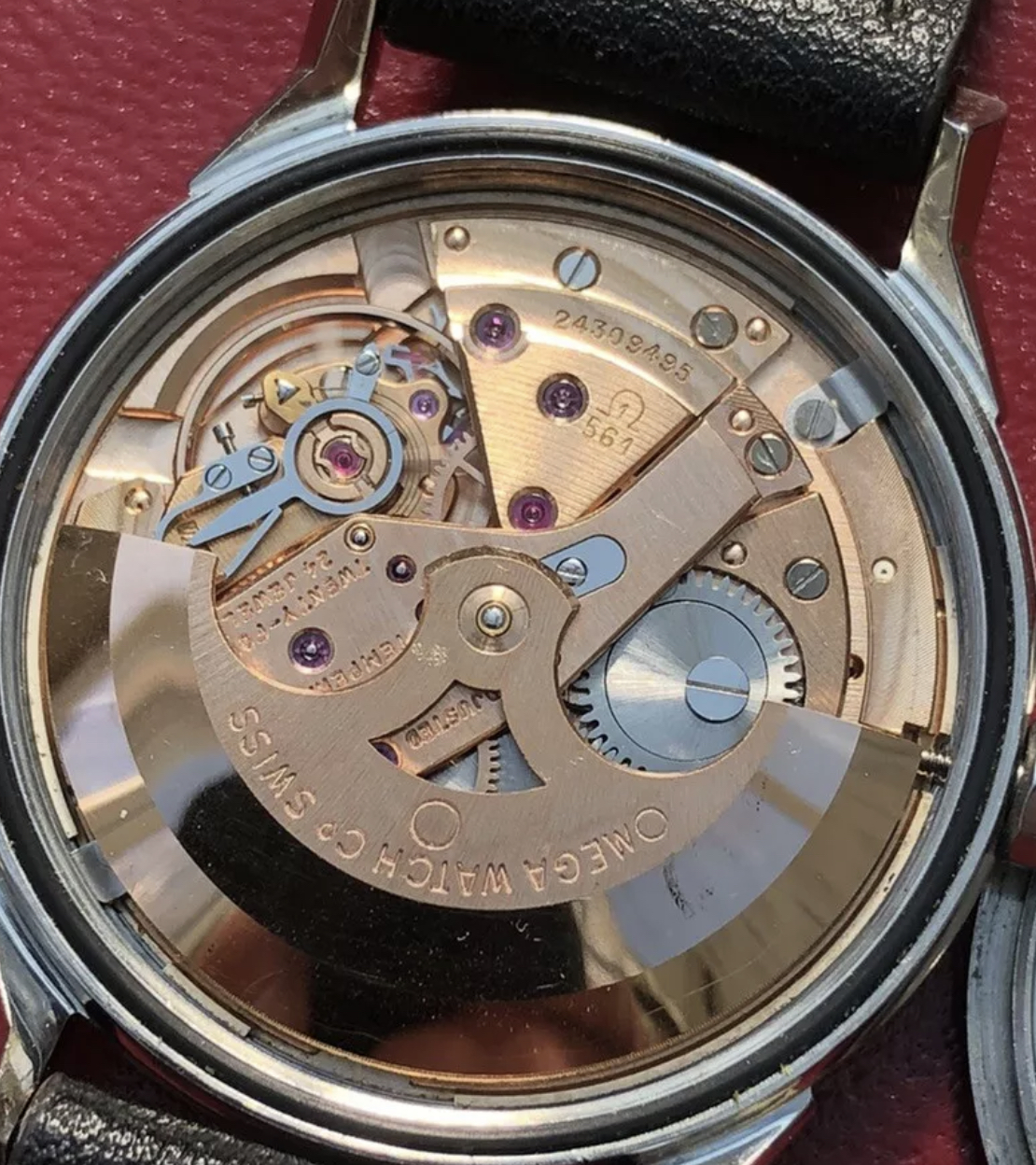

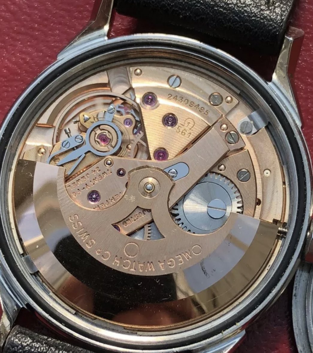

Case looks good, do you have more pictures (complete movement for example)?
168.005 was introduced in 1962 but was still in produciton 1966 so no problem here.
What is the asking price?

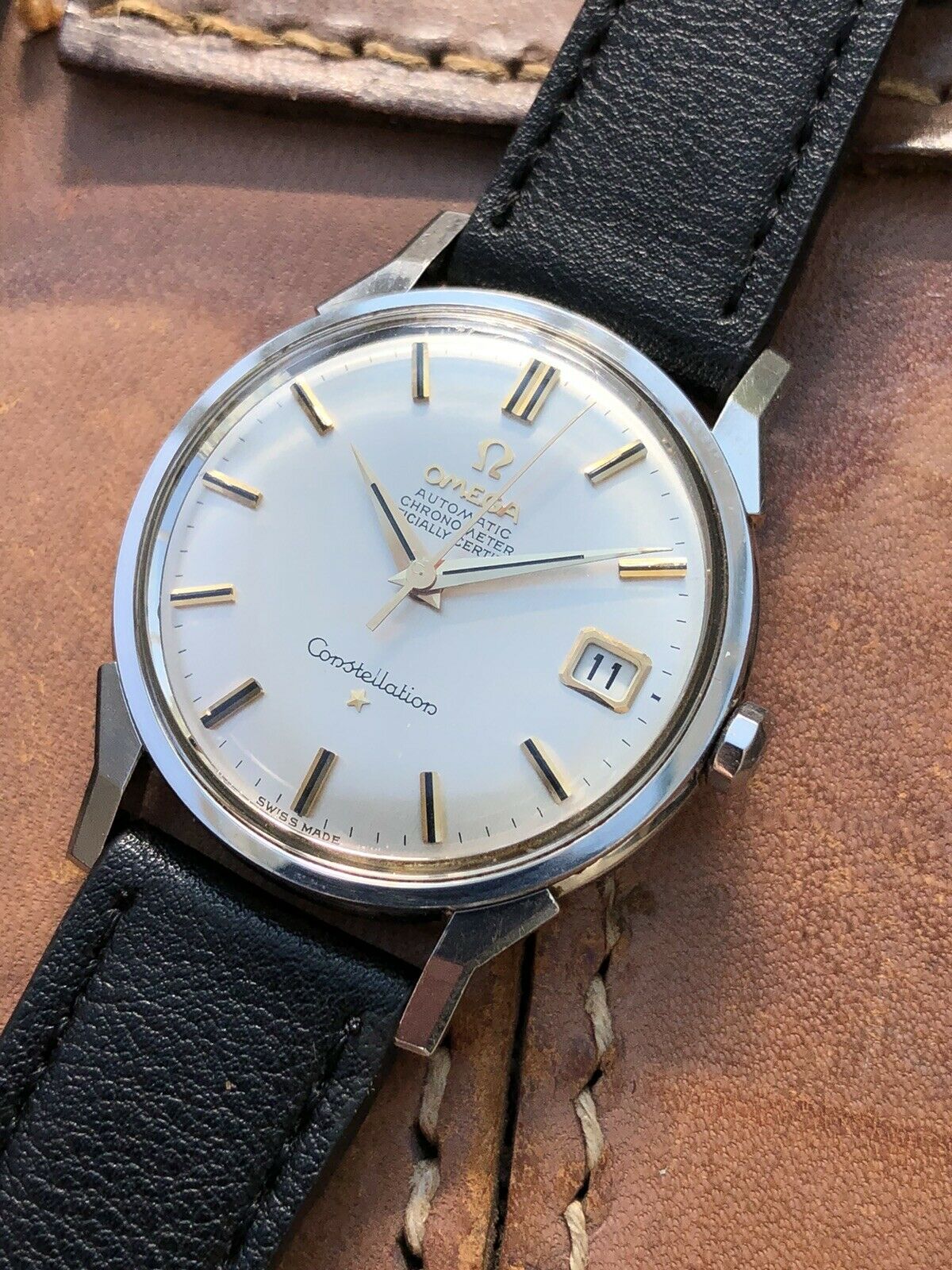

Looks clean and correct, even down to the crown. Definitely one to consider 😀

its in my watch list too -this is a very nice watch -being sold by one of our members. @michael e
It's nice enough that I was actually tempted to put it on the recommended thread.
it's all correct and in good condition, lovely case, late cal 561 (nothing wrong with that), original buckle, -only negative is that the inner tray is missing from the box.
you will wait quite some time to find another quite as nice as this.
BTW we now know that these doglegs were produced into the early 70s and reprised in a slightly different form just before the mid 70s.

A great one in really nice condition ! And as a bonus you have the original buckle !
