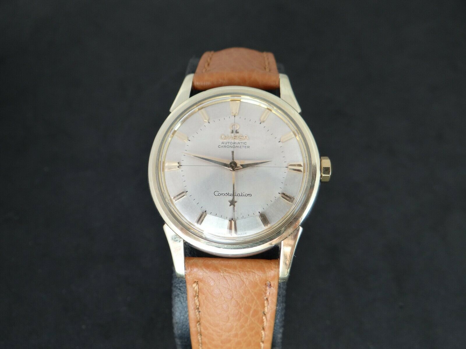

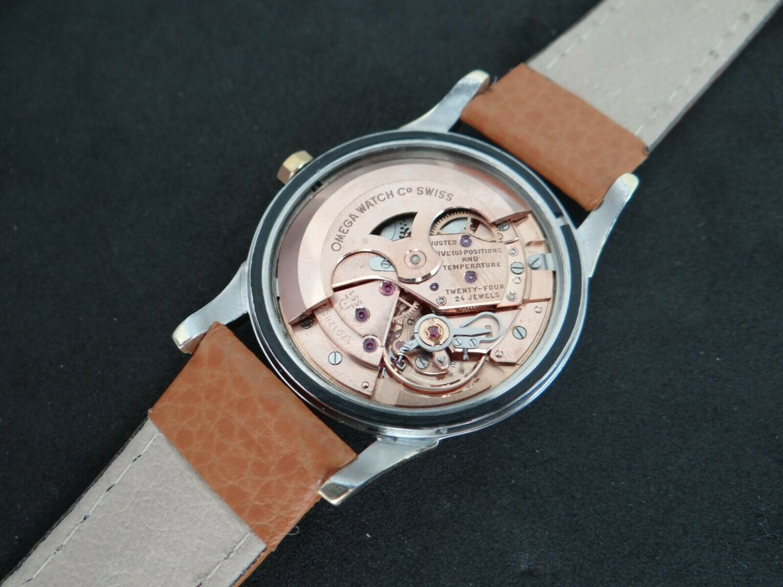

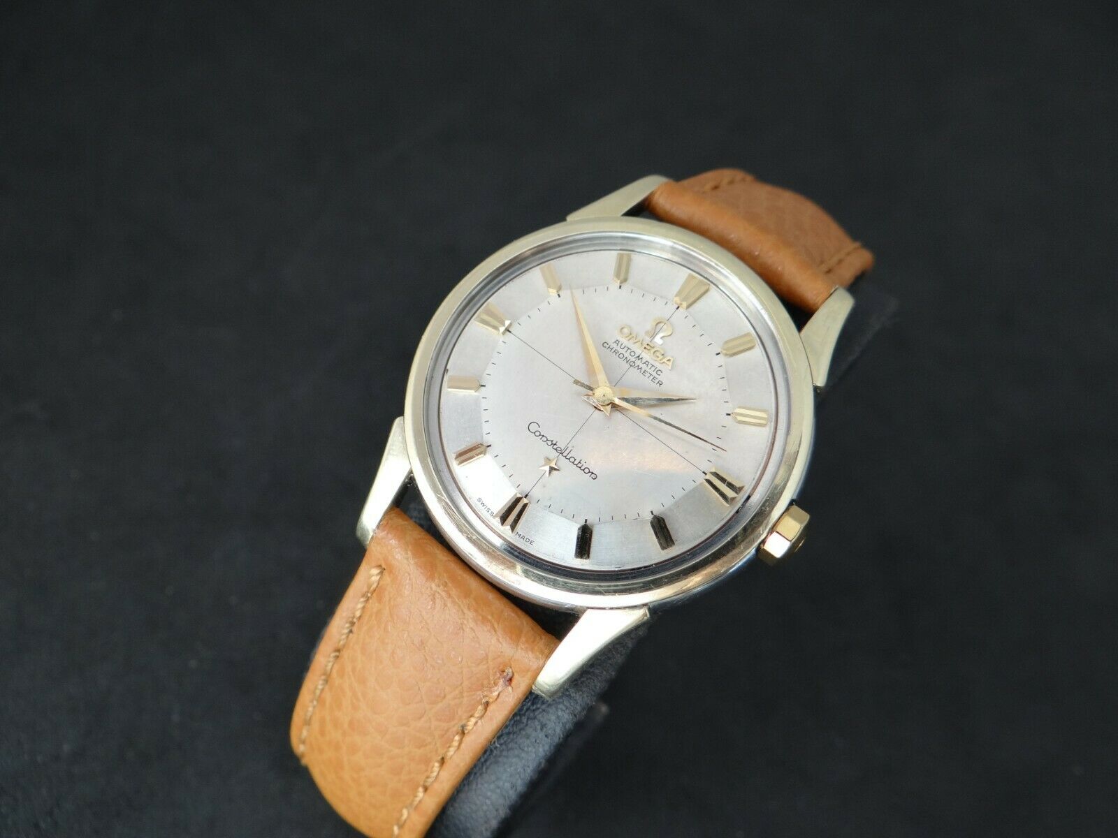

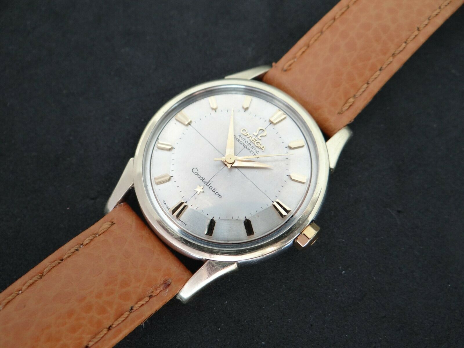

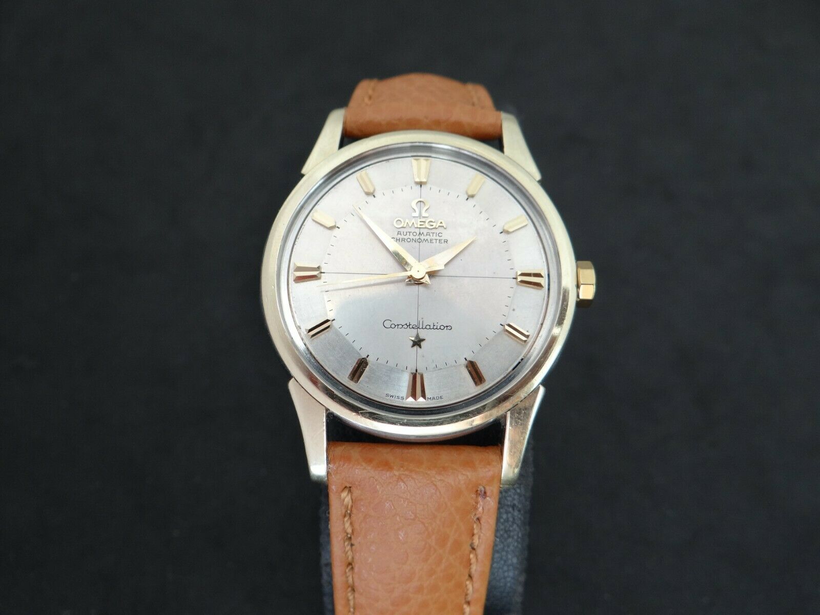

Hi guys! It's been a long time since im hunting to good condition of vintage connie..
I'm about to buying this one but i wonder if this looks original condition to you guys.. I have two doubts about this one..
1. Dial looks original but hands are not

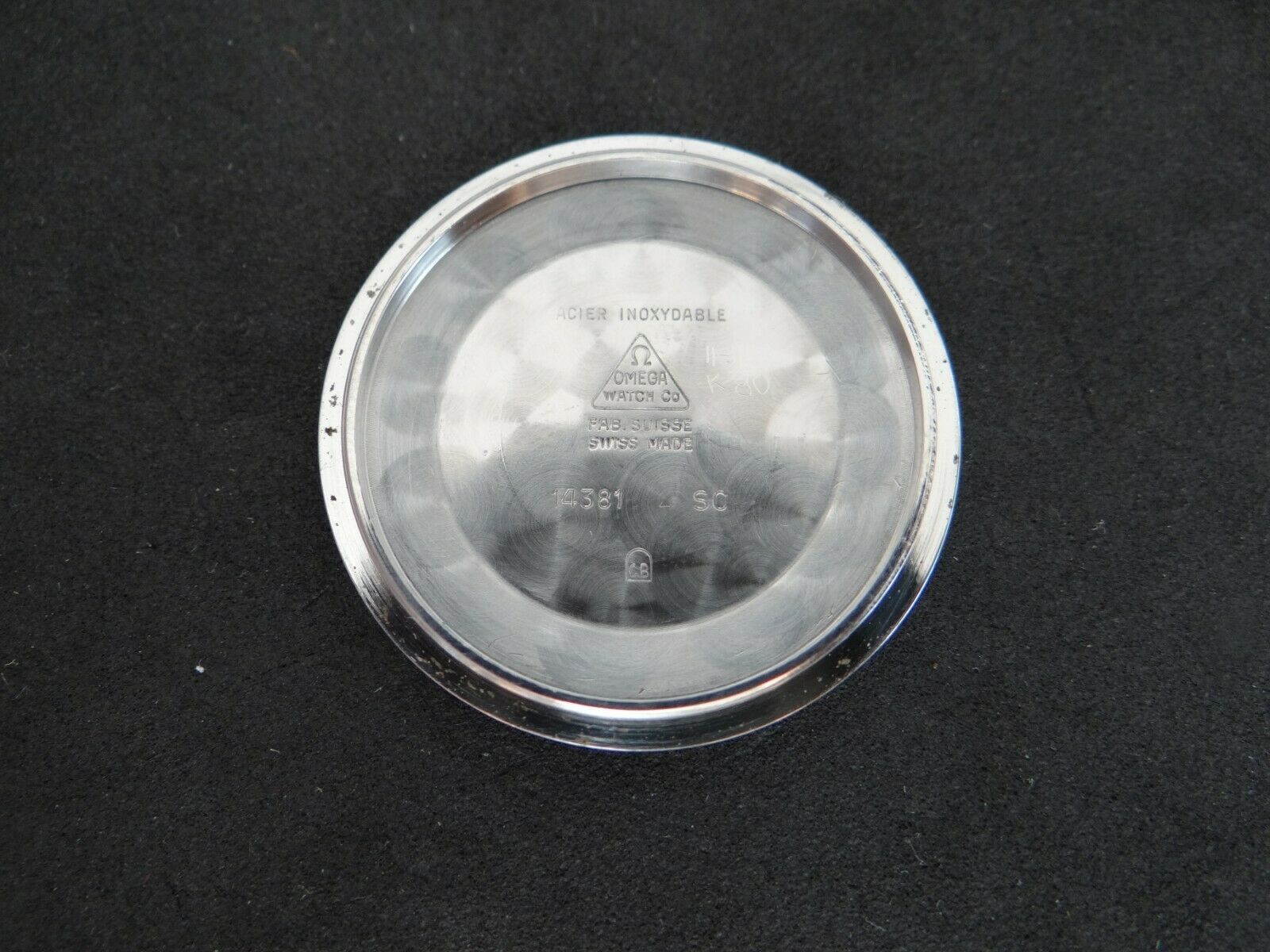

2. back case says its 14381 SC without serial number between 14381 / SC . Isn't it supposed to be 14381 ( number ) SC ?
Any thoughts ?

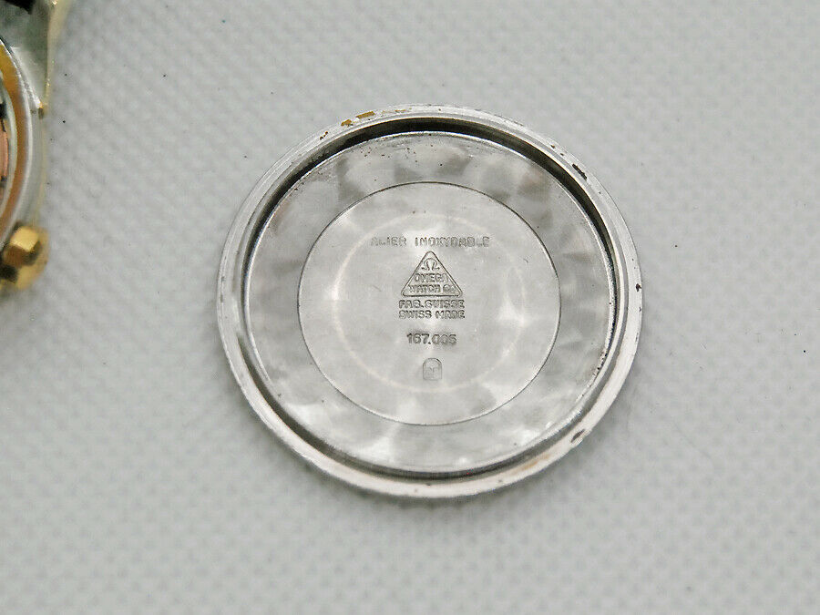

Dial looks ok. As you say the hands are too long. A missing iteration in a caseback just means it’s the first version so nothing to worry about. A picture of a stray dog leg caseback has snuck in too.
