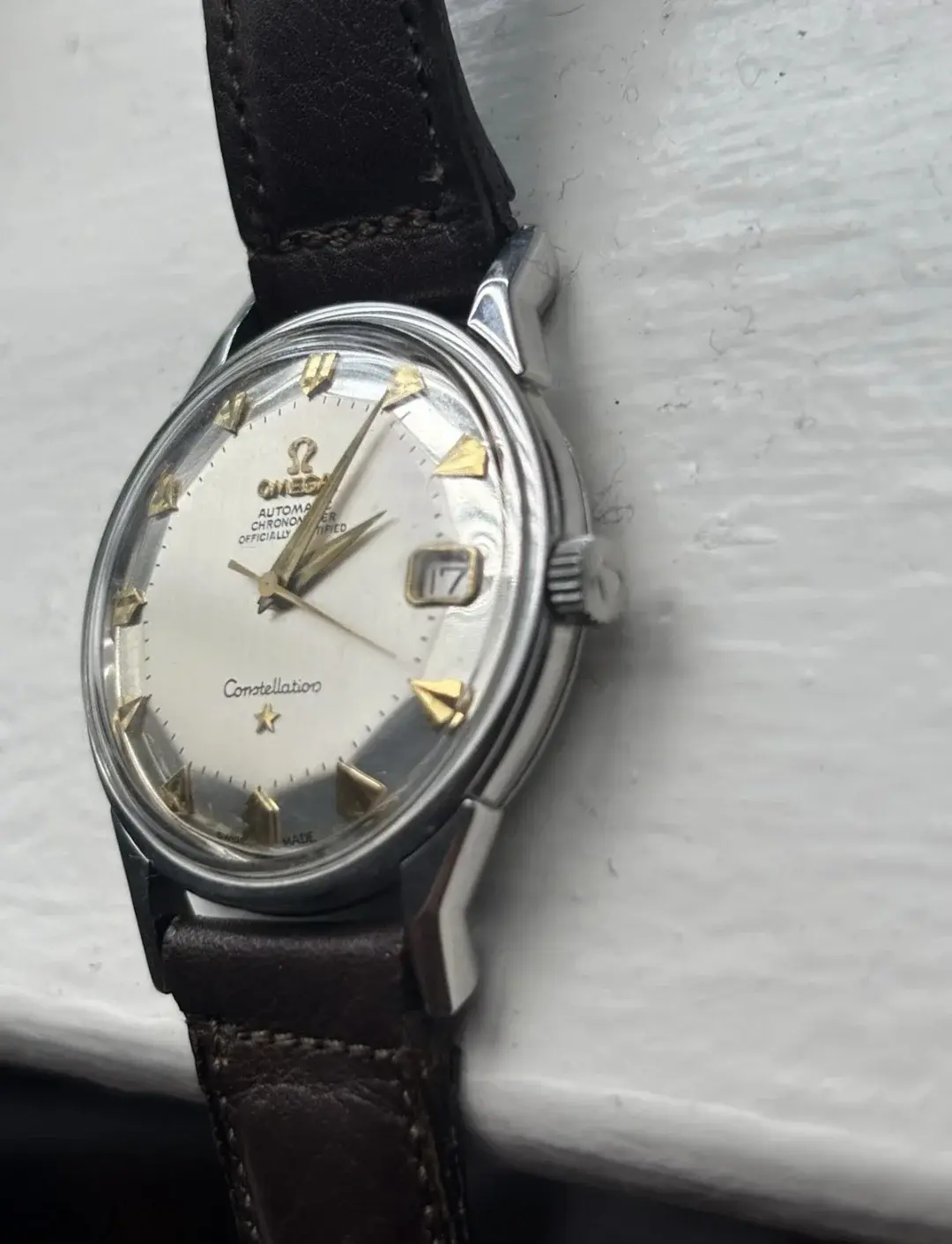

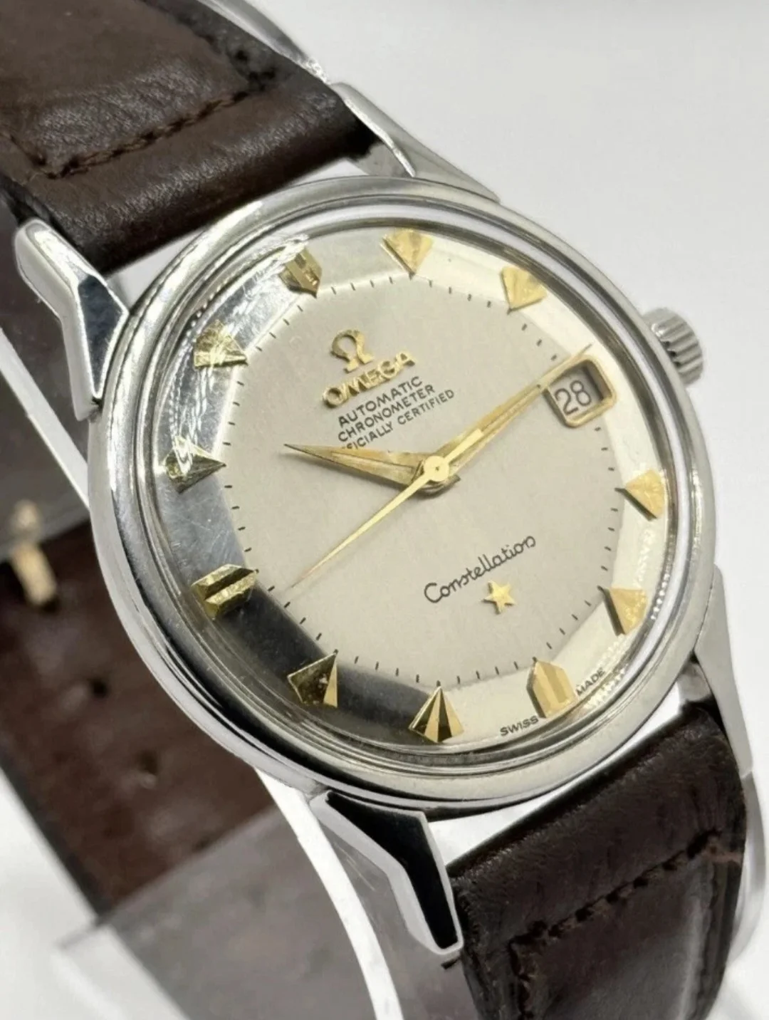

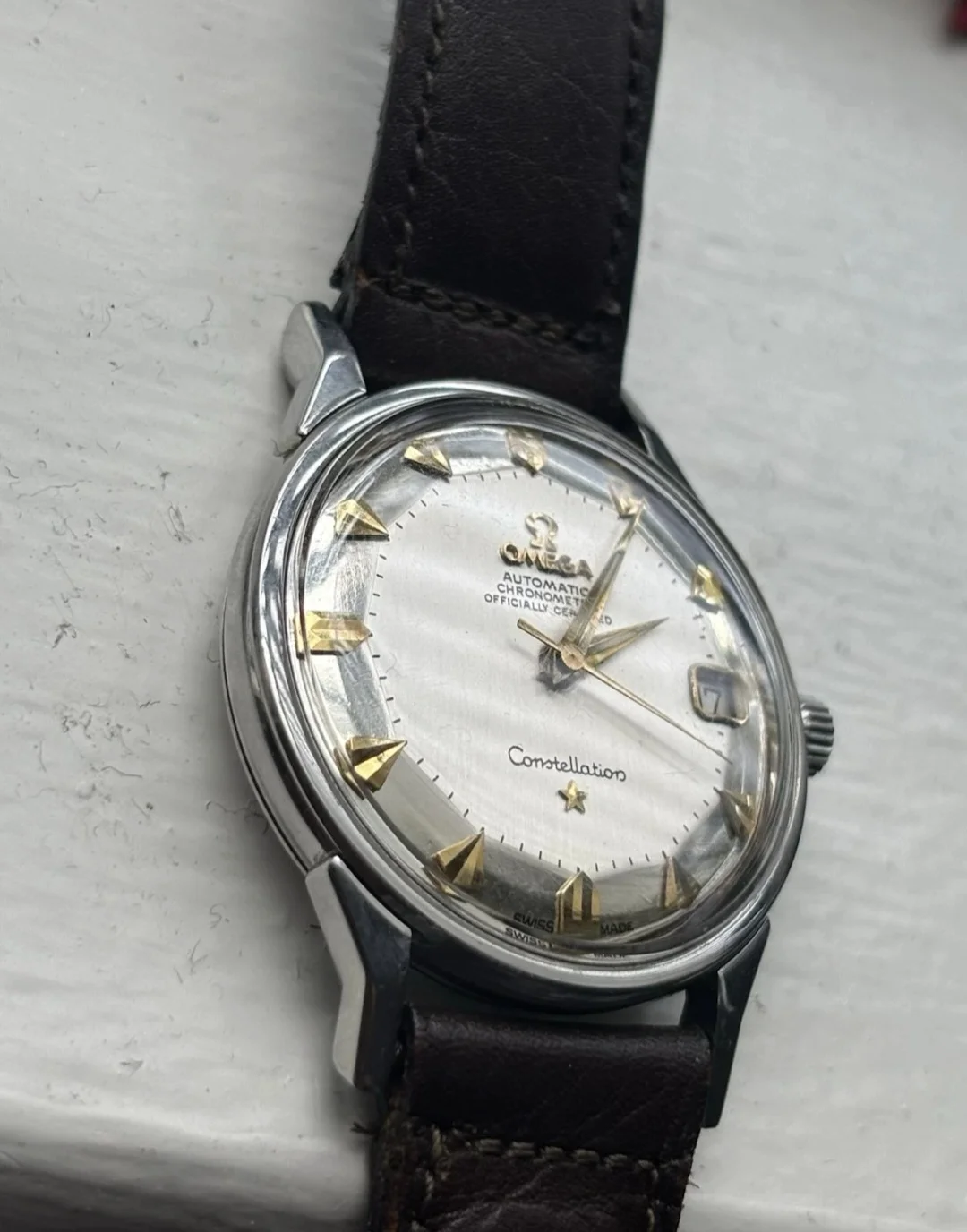

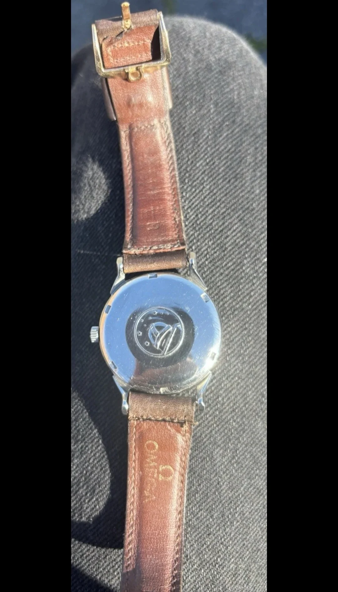

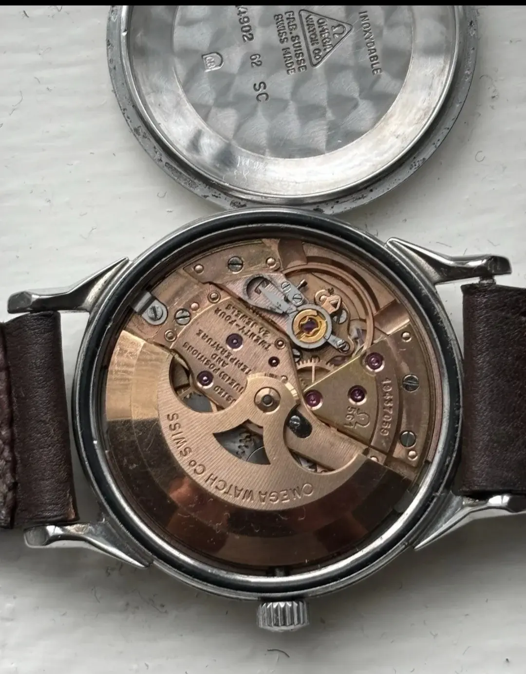

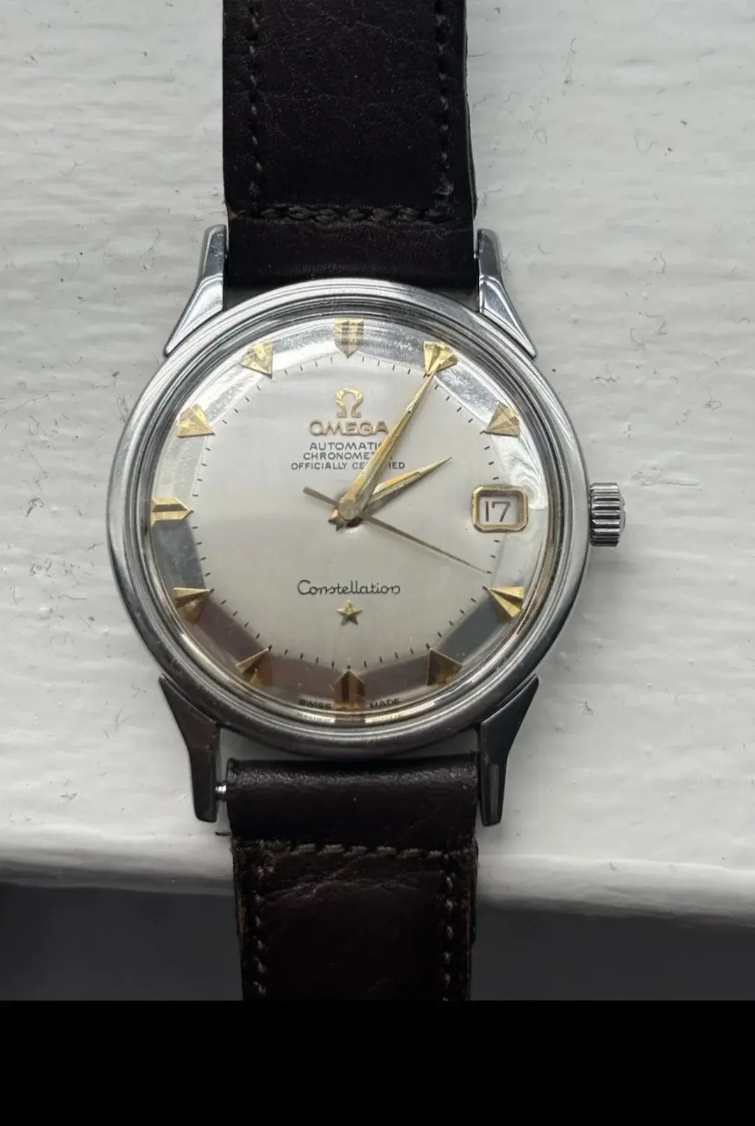

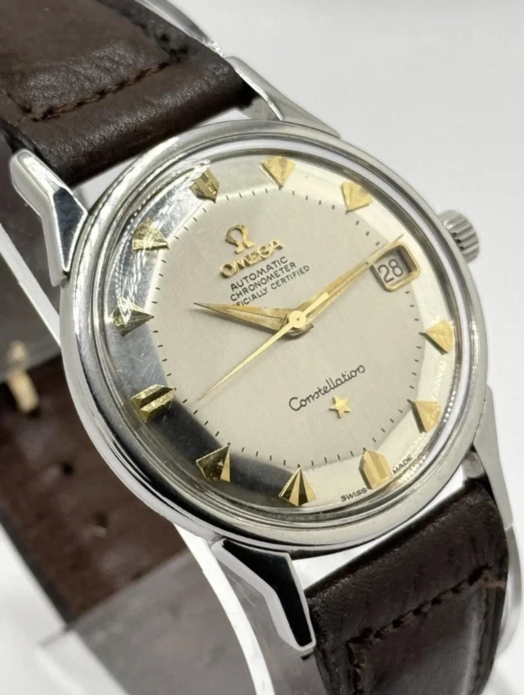

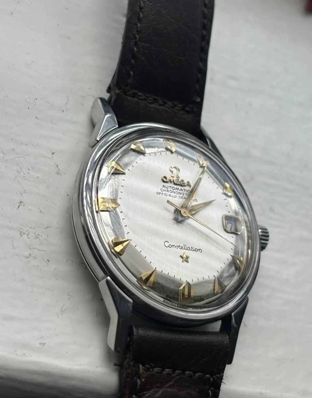

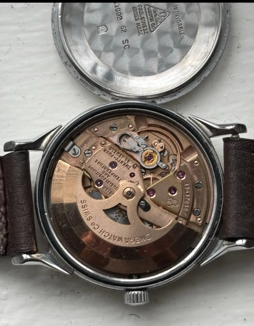

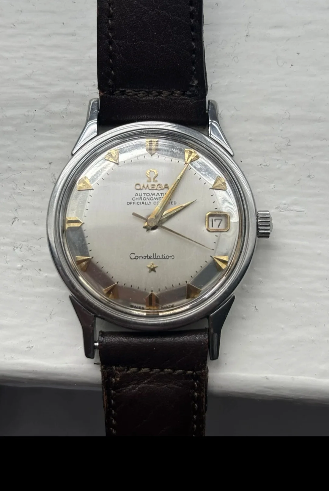

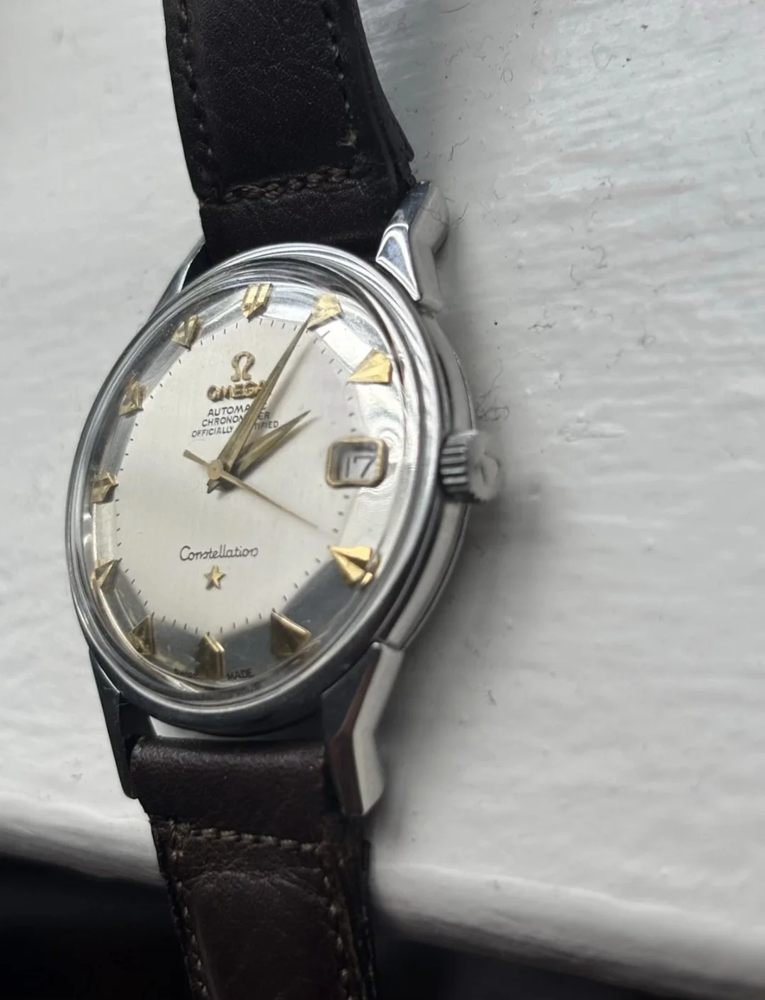

Hi! Looking at this Omega Constellation 14902 62 SC. I have tried doing a bit of research but with so many variables on the models I feel a bit lost. Anything jump out as red flags? What would be a reasonable price for this?

Whilst I completely agree with the above, short answer is, this is a very obvious redial.
210
258

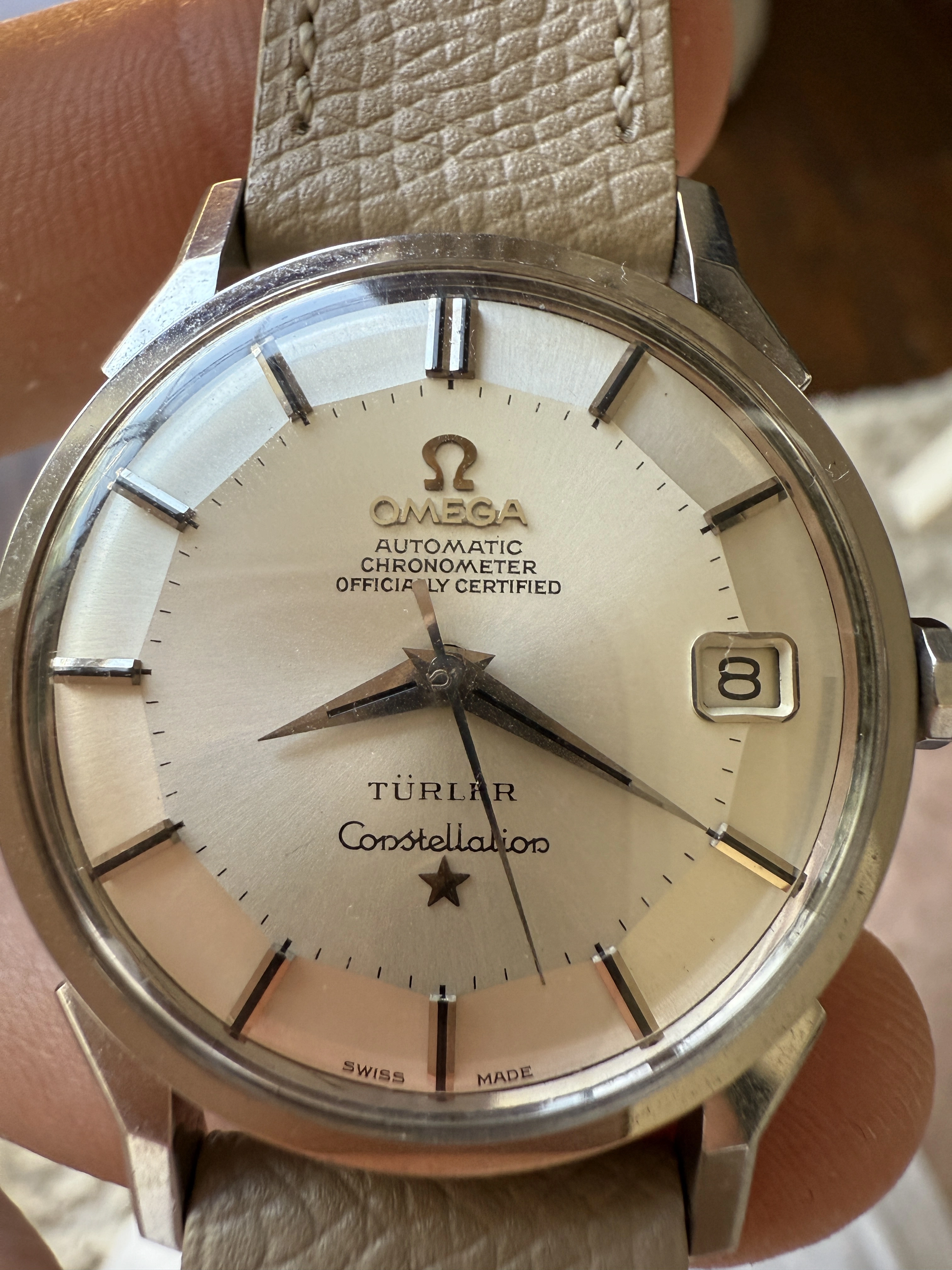

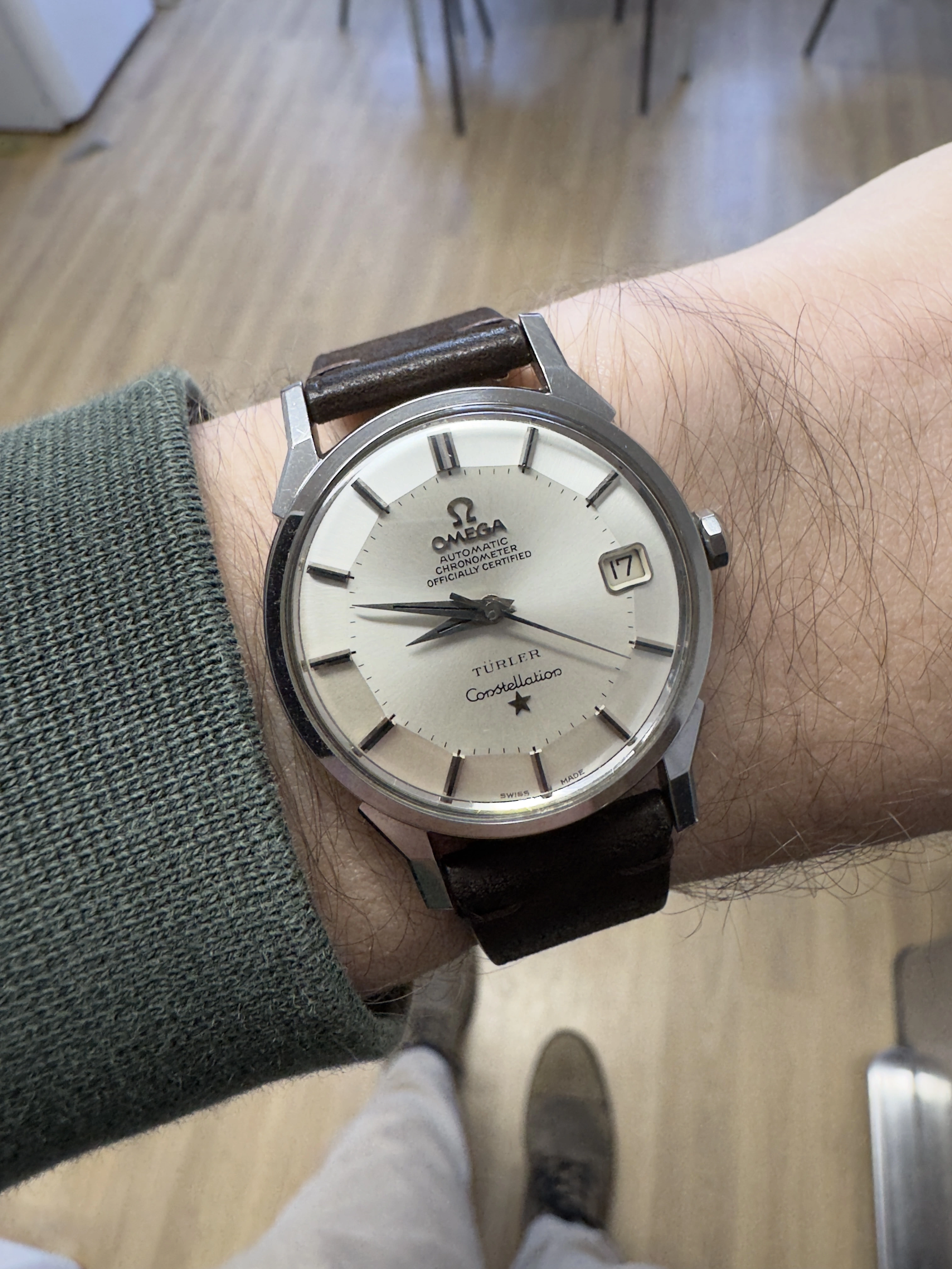

Just to summarise the issues with this one for reference and to help in identifying telltale signs going forward:
The watch is undoubtedly real, not a fake, but…
  • The case is over polished - the lugs edges are rounded off
  • the crown is a replacement. They should be a ten sided item like mine shown below.
  • pie pan dials should have sharp angles. This is soft. You can see someone’s put a thick layer of paint over it. Especially as it dips in near the centre of the dial.
  • in all fairness this isn’t the worst text I’ve seen on a redial but again to a trained eye the fonts just aren’t right.
  • dial paint, the colours off and pie pans generally have a sunburst finish
There may be some I’ve missed

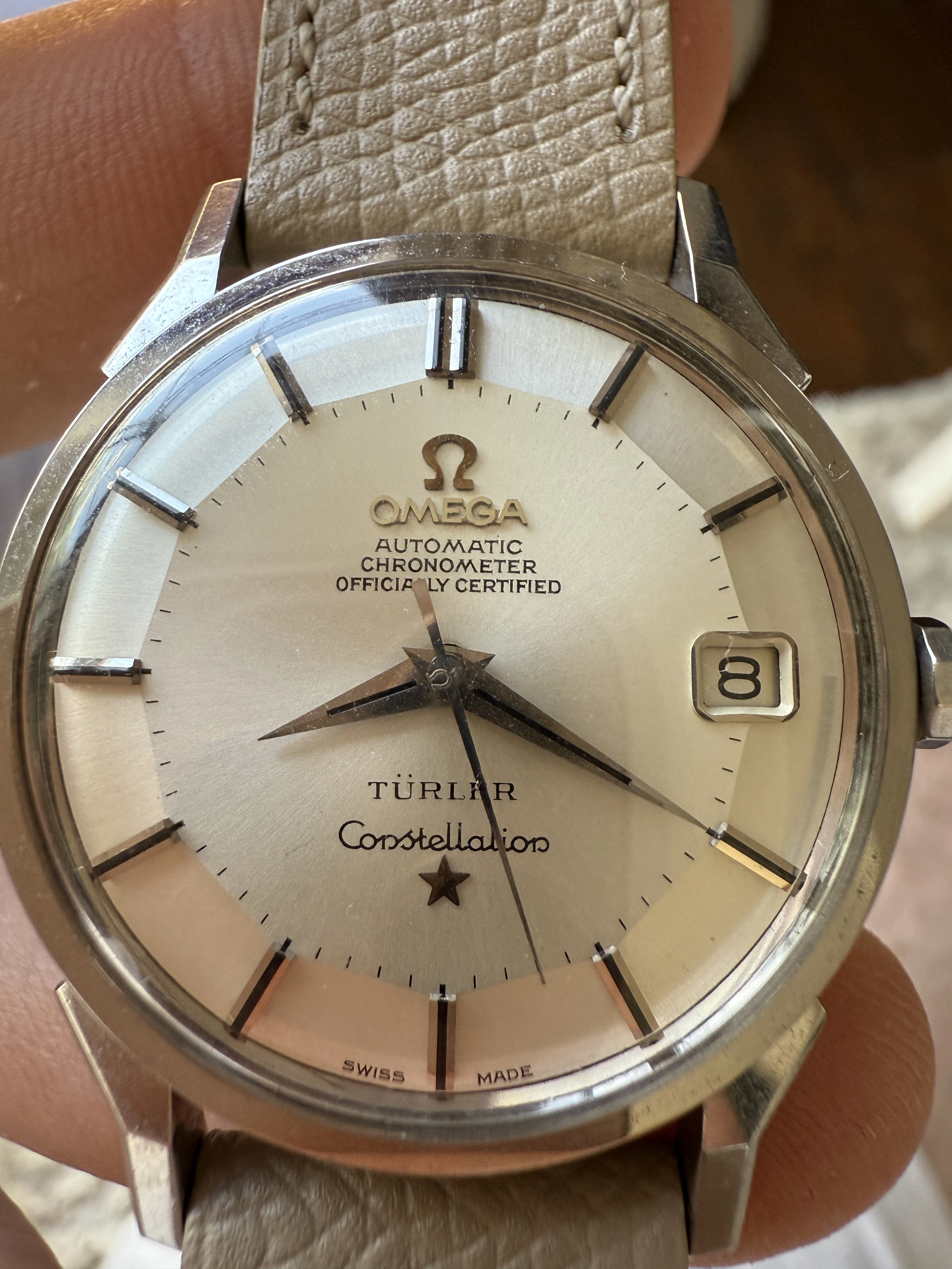

See my genuine example below to compare (not the best photos but will do for now)

As noted already, it's an awful example of a vintage Constellation, across the board. A total dog, and a poster child for what NOT to buy.
