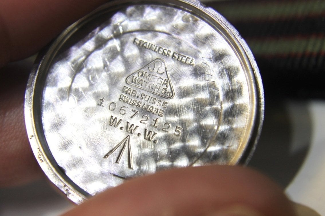

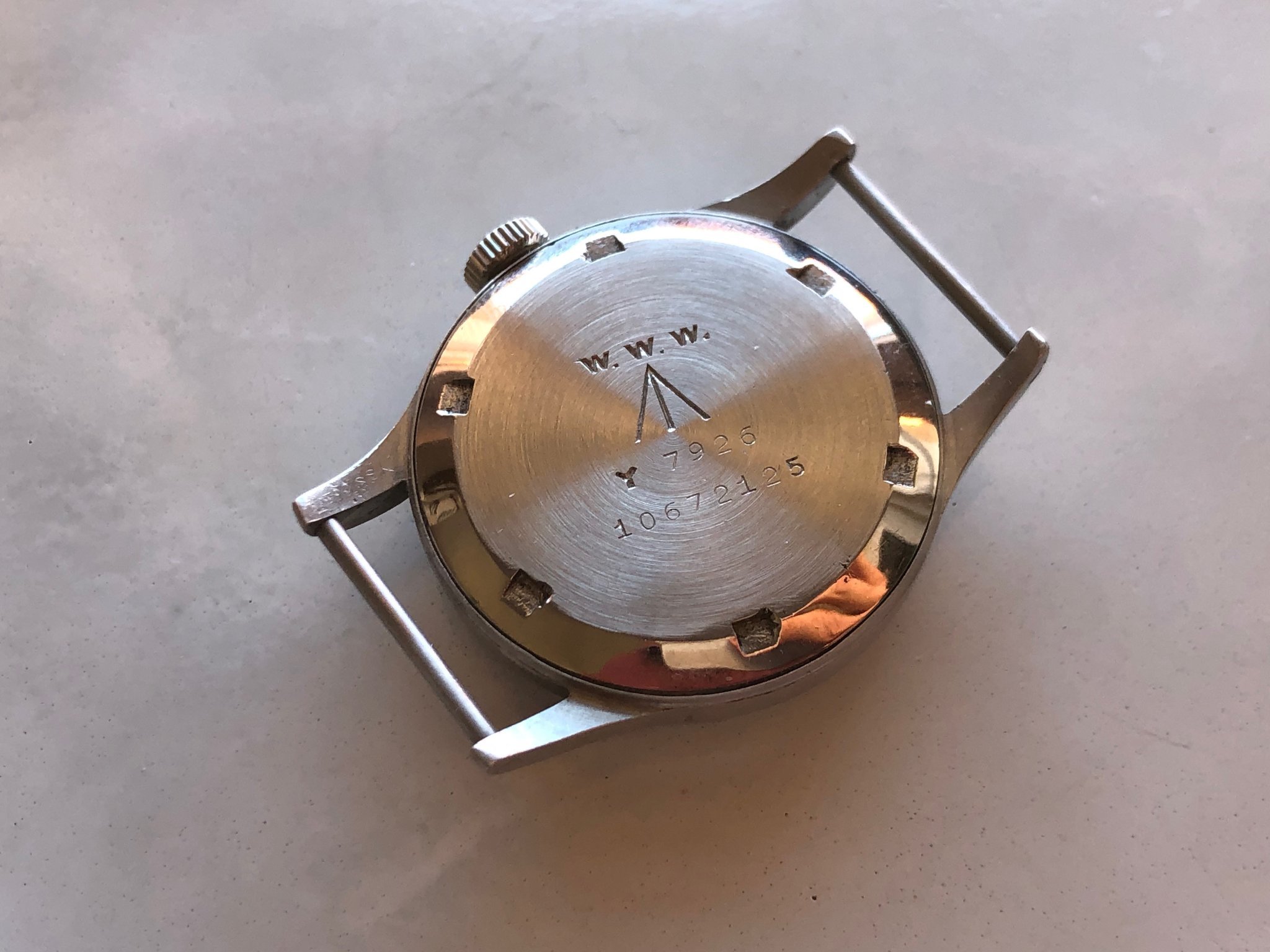

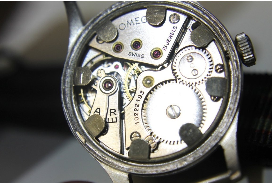

Serial / Identification Numbers
Back Plate Serial Number: 10672125
Movement Serial Number: 10222193
date
From the movement serial number this watch is circa: 1944
1939 Serial numbers start from 9,000,000
1944 Serial numbers start from 10,000,000
1947 Serial numbers start from 11,000,000

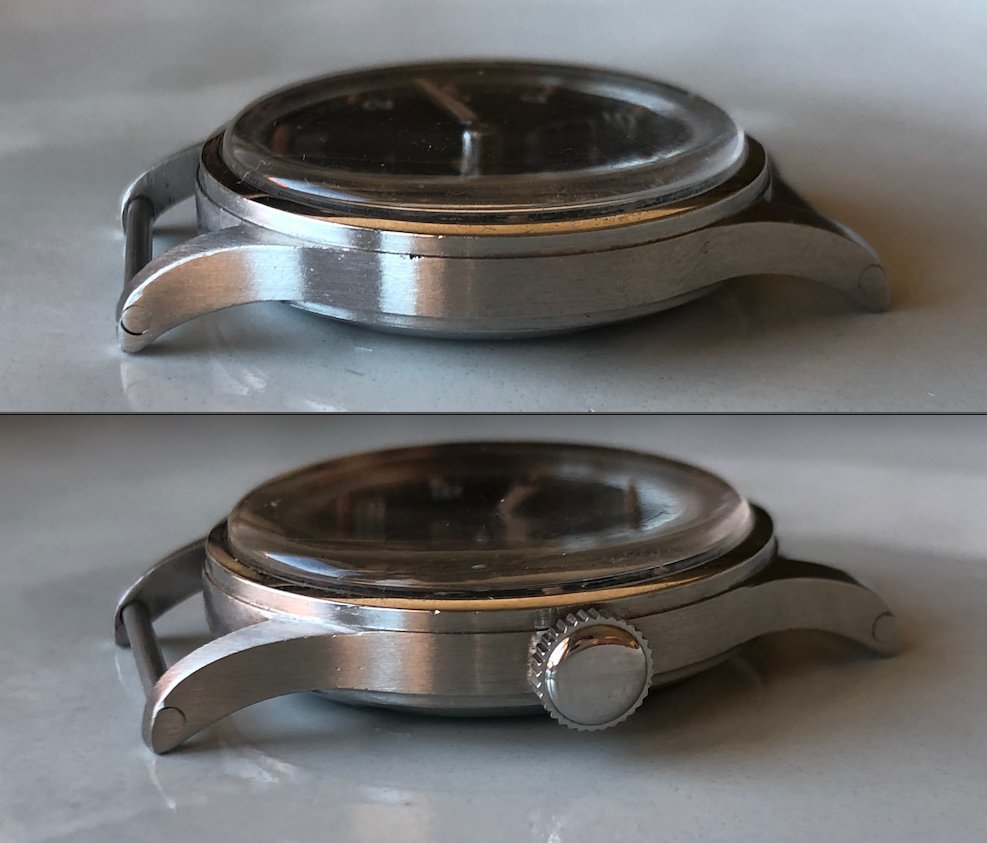

Dimensions:
Width with the Crown: 36.5 mm
Width without the Crown: 33.5 mm
Height without the Lugs: 33.5 mm
Height with the lugs: 45 mm

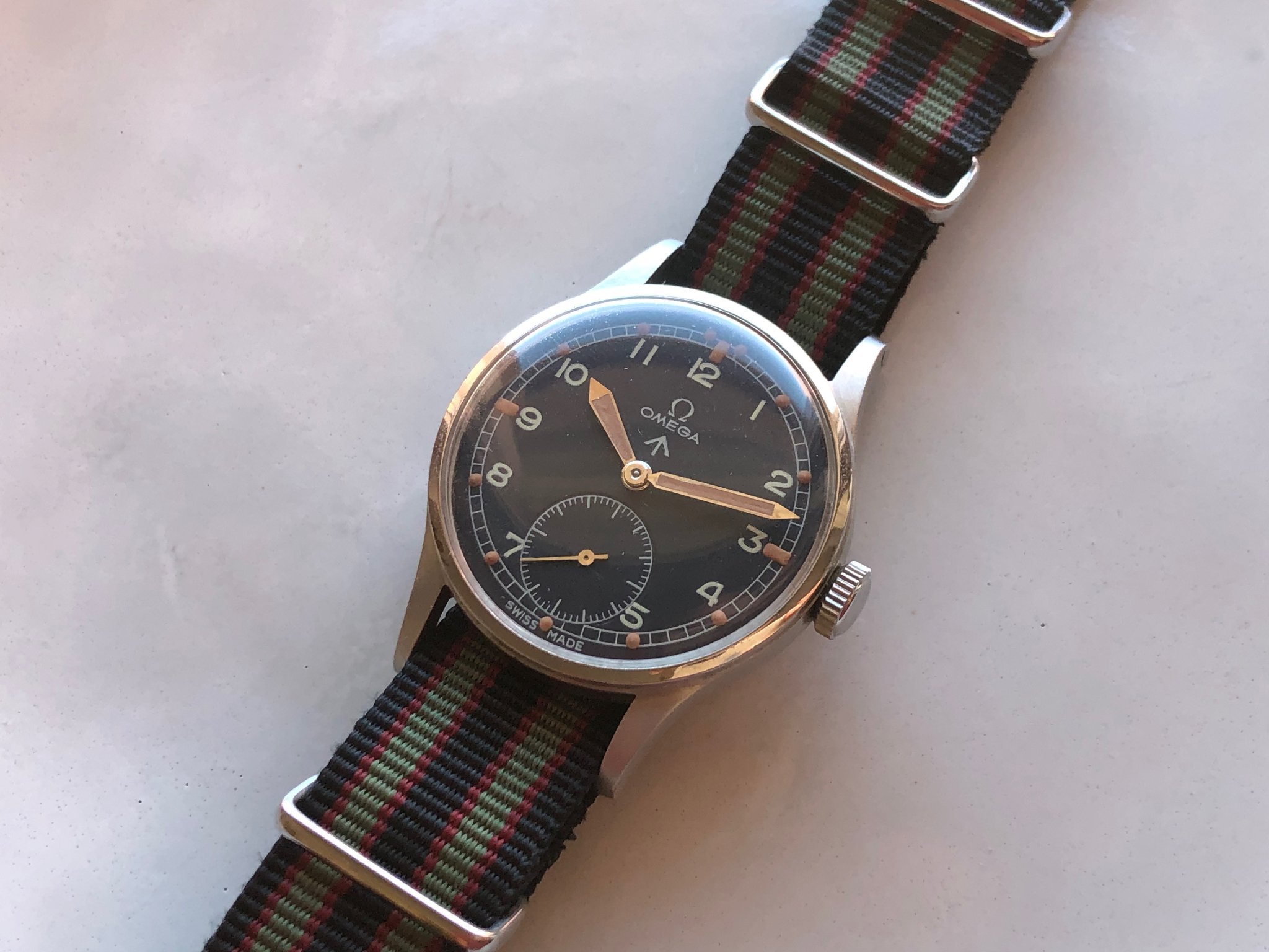

Due to the dial and hands "restoration", I wouldn't really want to buy this watch.

Redial, over polished and wrong crown to start. All WWW watches were delivered in middle to end of 1945.

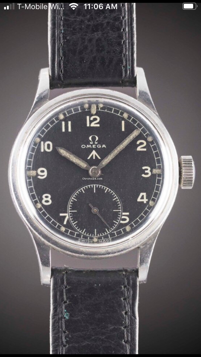

In attempting to fill in here the problems with the restored dial appear to include:
1. The digits for the “12” are too close.
2. The top of the Omega, “A” and 4
are not flat. (Angle of 4 may
confound here.)
3. There are multiple hooked numbers
(Most I have ever seen)
The hooked 7 is “classic for
poor redials or fakes” attributed by
some to the Subcontinent.
4. The “Omega” logo appears
incorrect although this may be due
to magnification issue.
5. The Omega symbol appears
incorrect although this also may be
a magnification issue.
6. The hour and minute hands “appear
period correct” but almost
too perfect.
7. Concur with other concerns above.
Attached is a comparison piece represented as original dial with MOD replaced hands.
Good luck in the decision!
confound here.)
too perfect.
Amazing list of findings. Thanks for your effort!
