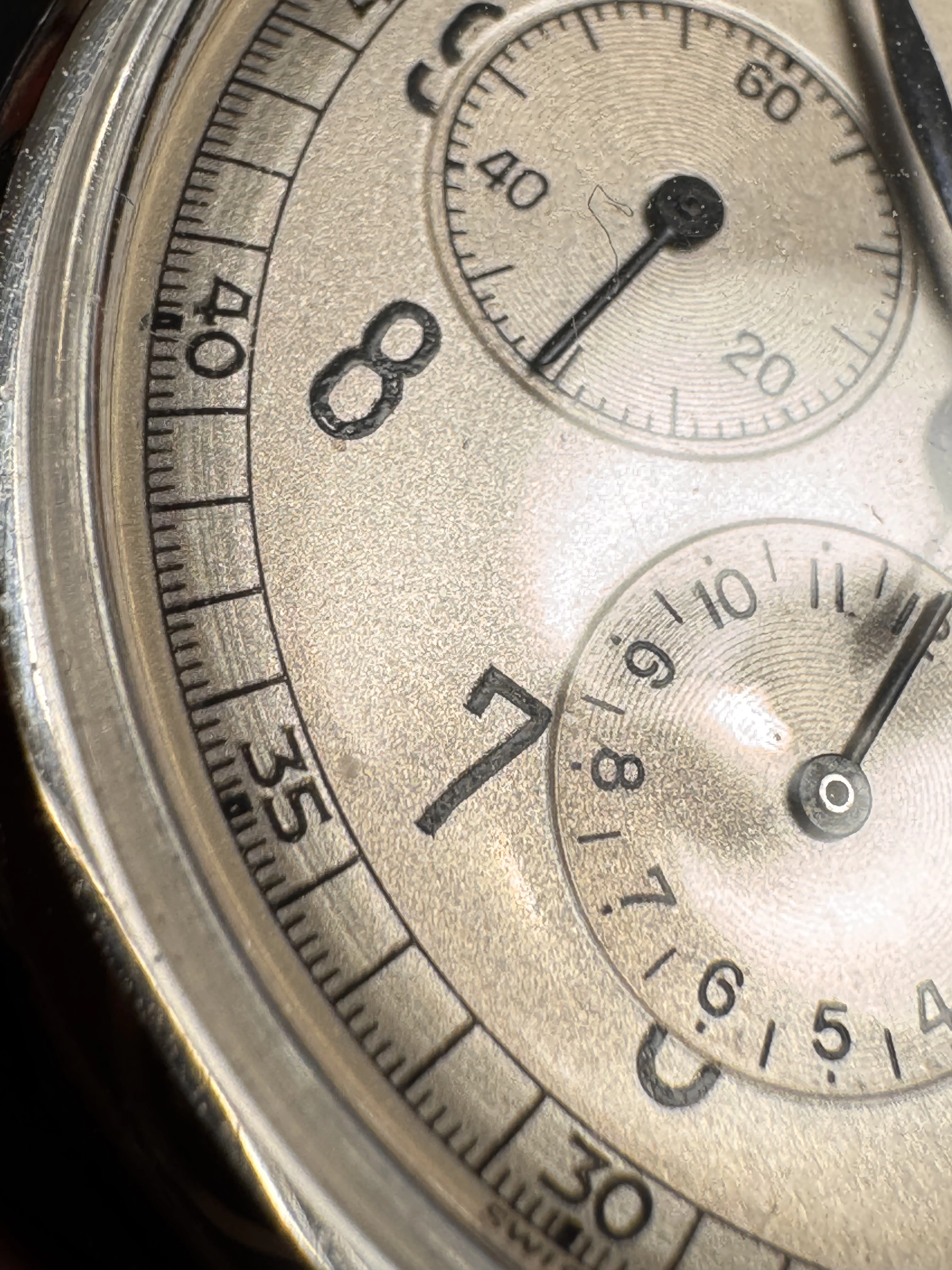

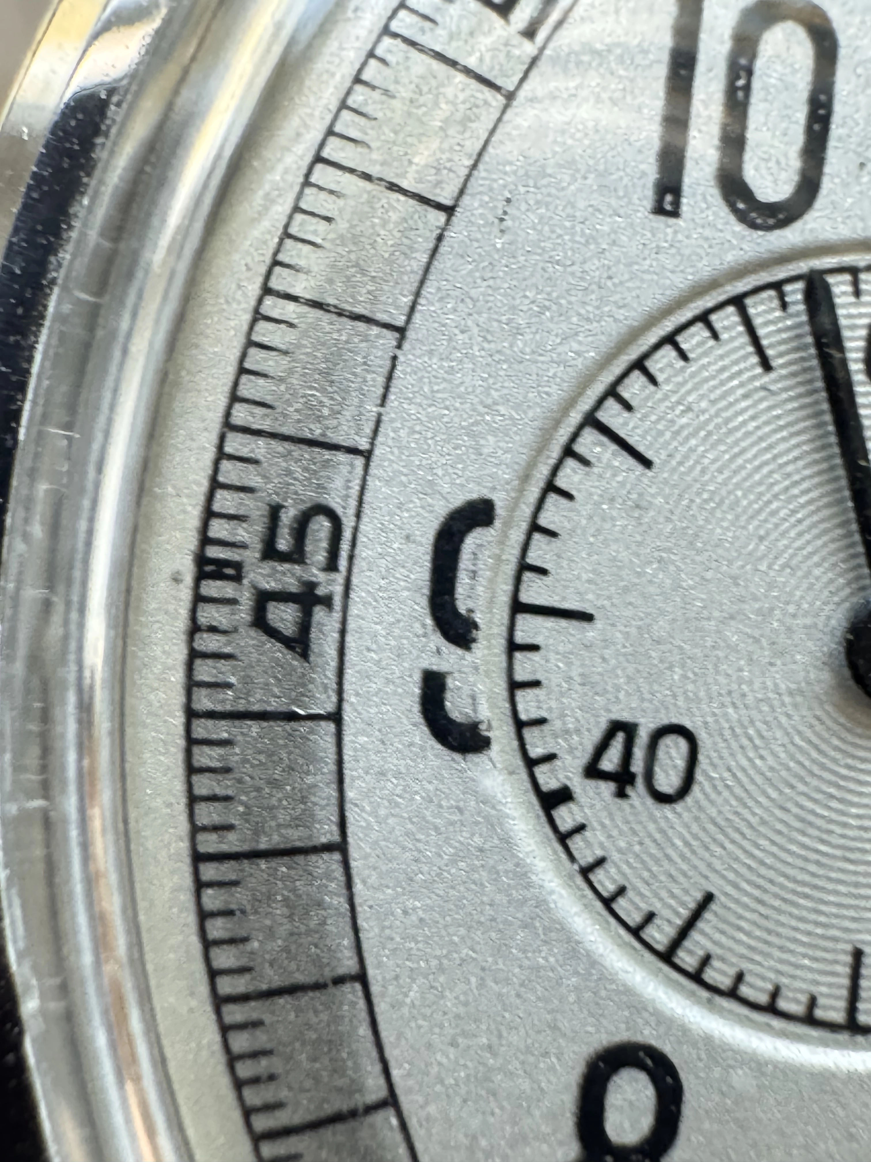

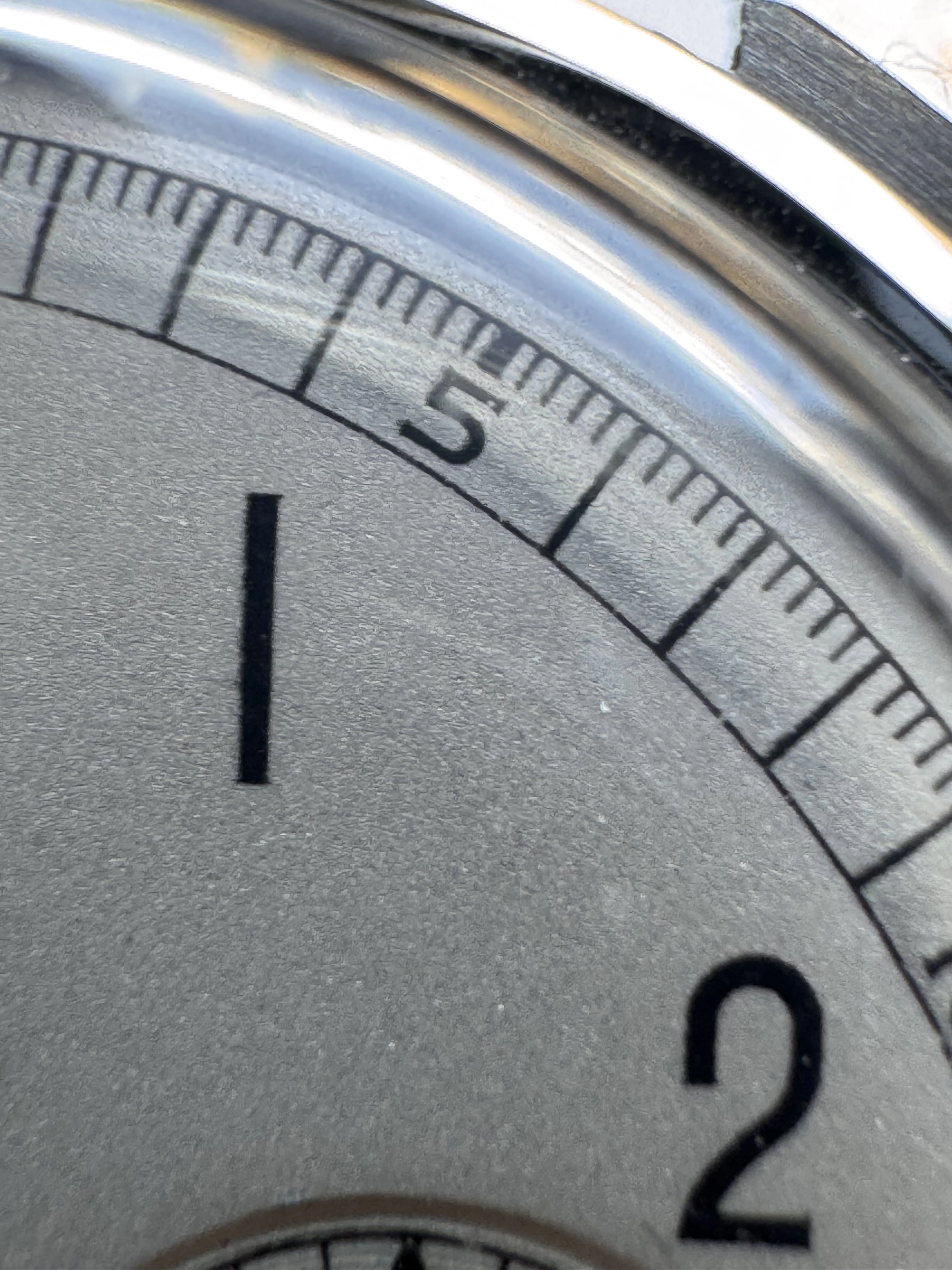

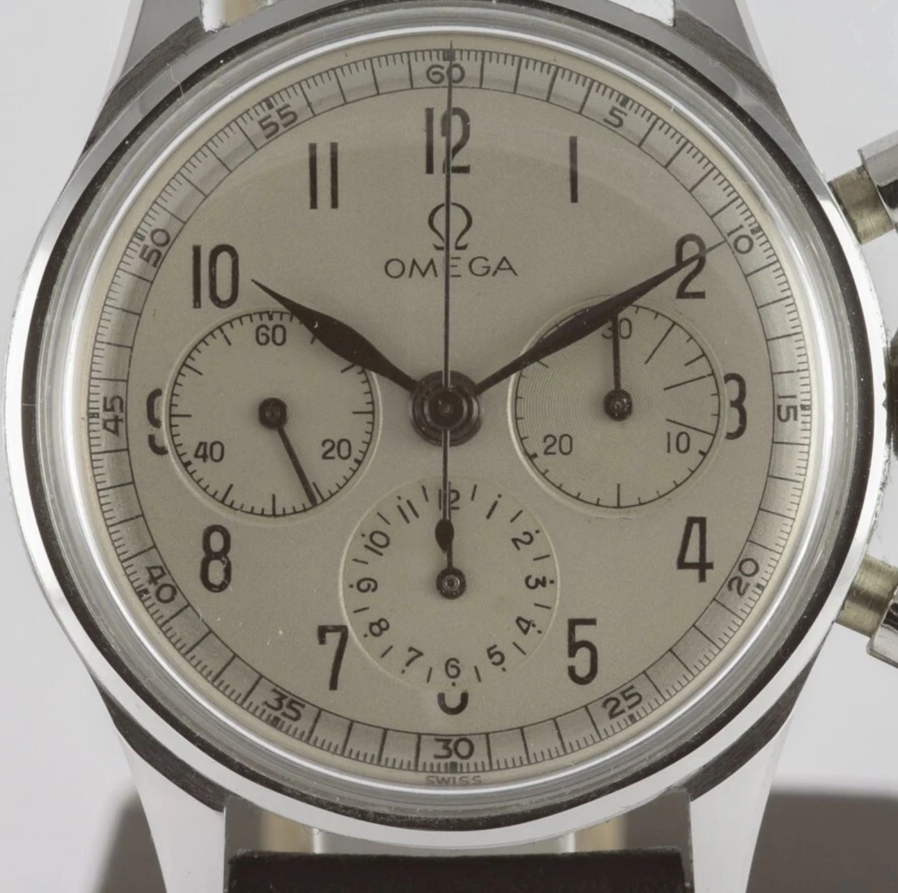

Hello everyone,
I would appreciate your opinions on this Omega CK 2287-1 chronograph.
I am trying to determine whether the dial is original or if it was restored at some point, and if so, approximately when that restoration may have occurred.
Dial details:
  • Marked “SWISS” at 6 o’clock
  • No luminous material on dial or hands
  • Two sub-dials have black accent rings; the lower (small seconds) does not
  • Fine, very detailed outer minute/seconds track
  • Uniform patina and aging consistent with a mid-20th-century watch
  • Fonts and Ω logo appear period-correct to my eye
Questions:
  1. Does the dial appear original to the watch, or are there any indicators of a redial/restoration?
  2. If restored, can the approximate decade of restoration be inferred (e.g. 1960s–70s vs later)?
  3. Is the asymmetrical sub-dial ring design correct for the CK 2287-1?
Photos with macro details are attached.
Any insight or comparison with known original examples would be greatly appreciated.
Thank you in advance.

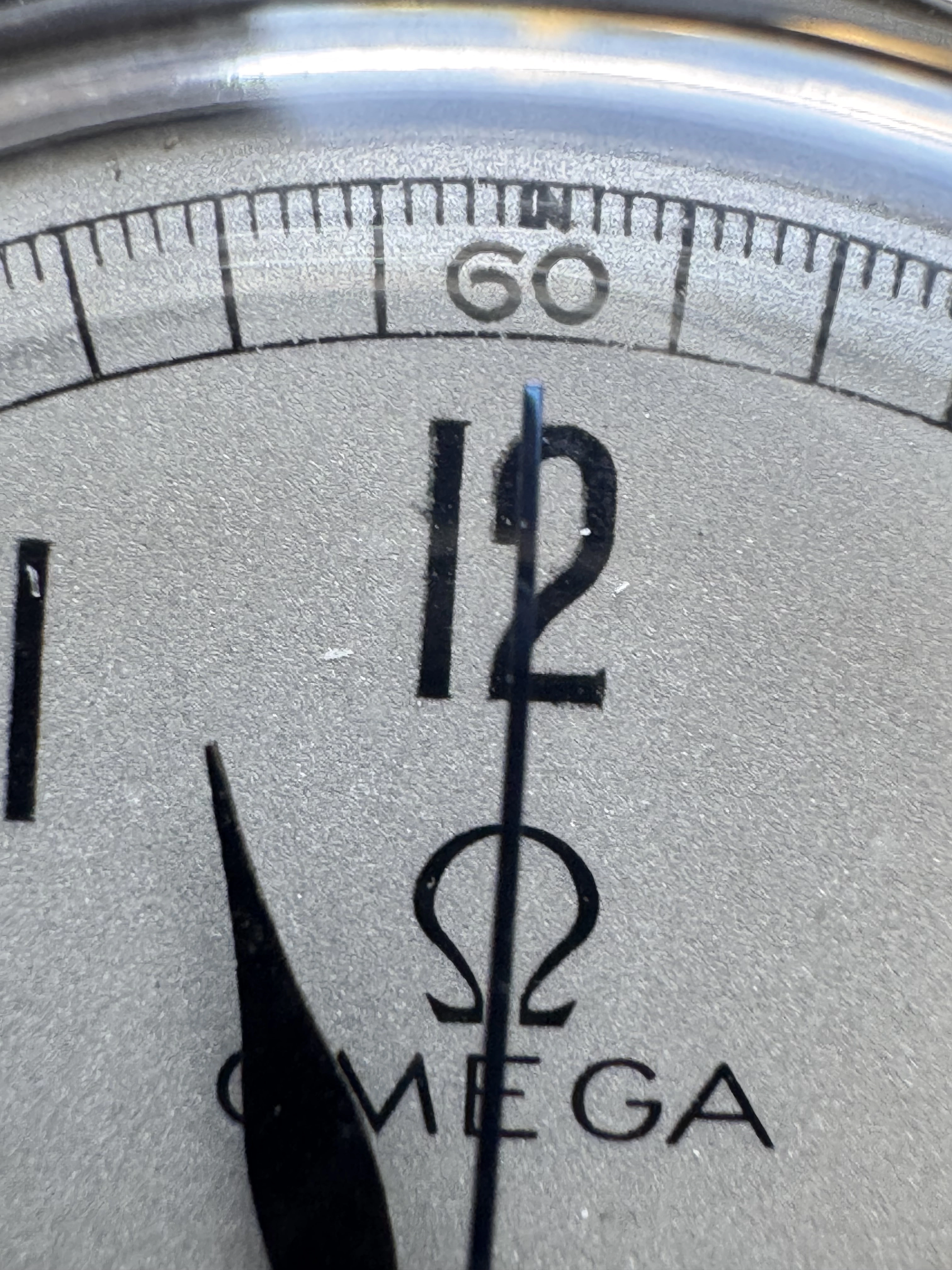

Looks to me like a high quality redial done recently. Maybe even a factory contracted restoration.
Logo is not period correct. “Swiss” on dial for Omega usually (but not always) reserved for watches with US made cases. I don’t think this was done for 1940’s chronographs.
An 80 year old, elaborately printed, chronograph dial in a non-waterproof case would have been likely to have some degree of environmental damage. This one is pristine.
Hope this helps,
gatorcpa

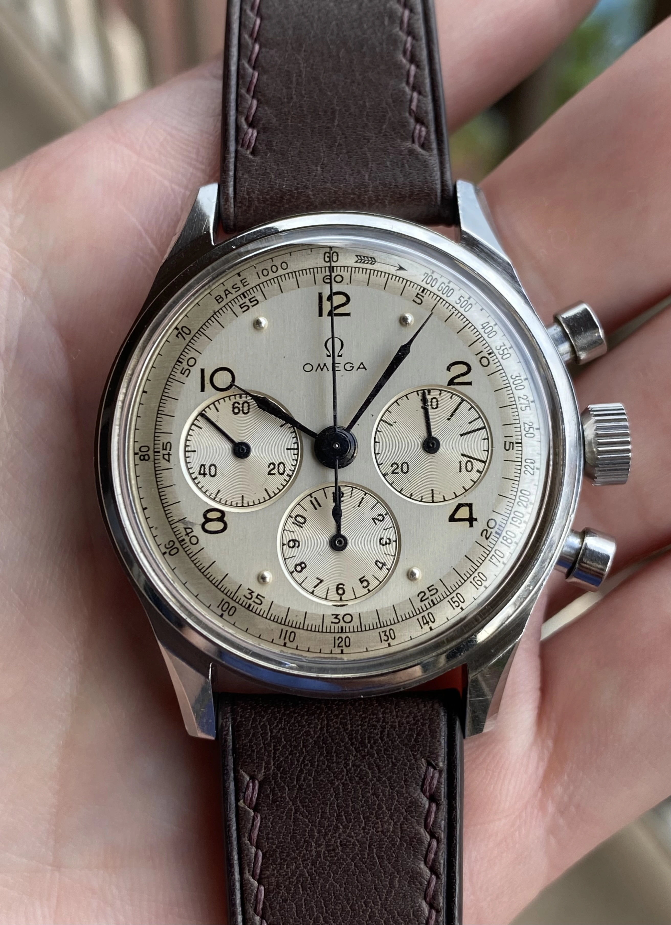

Agree. No patina, odd dial texture for the period, and the complete lack of serifs on Omega throws me off.
Here’s my 2287-1 for reference:
24,375
54,233
When I first saw it, my eye was drawn to the Omega symbol and the font and spacing of OMEGA. Overall it looks well done, but I think that some details are not as I would expect.
29
22
I agree on the redial. I had a similar chrono from the period and much of the print had faded. Very little chance those old material look like that today. But good looking watch!

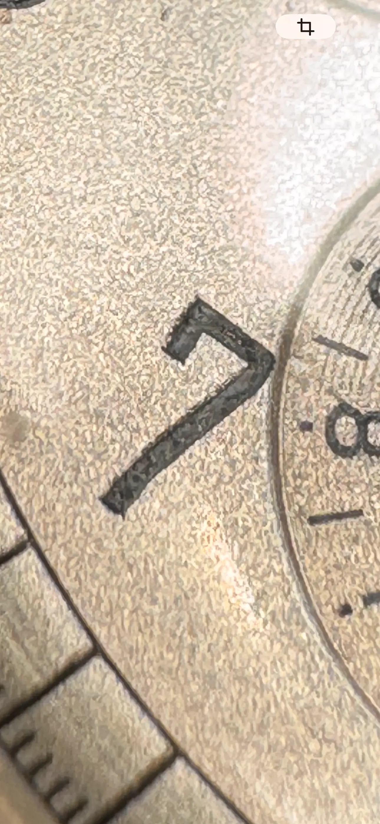

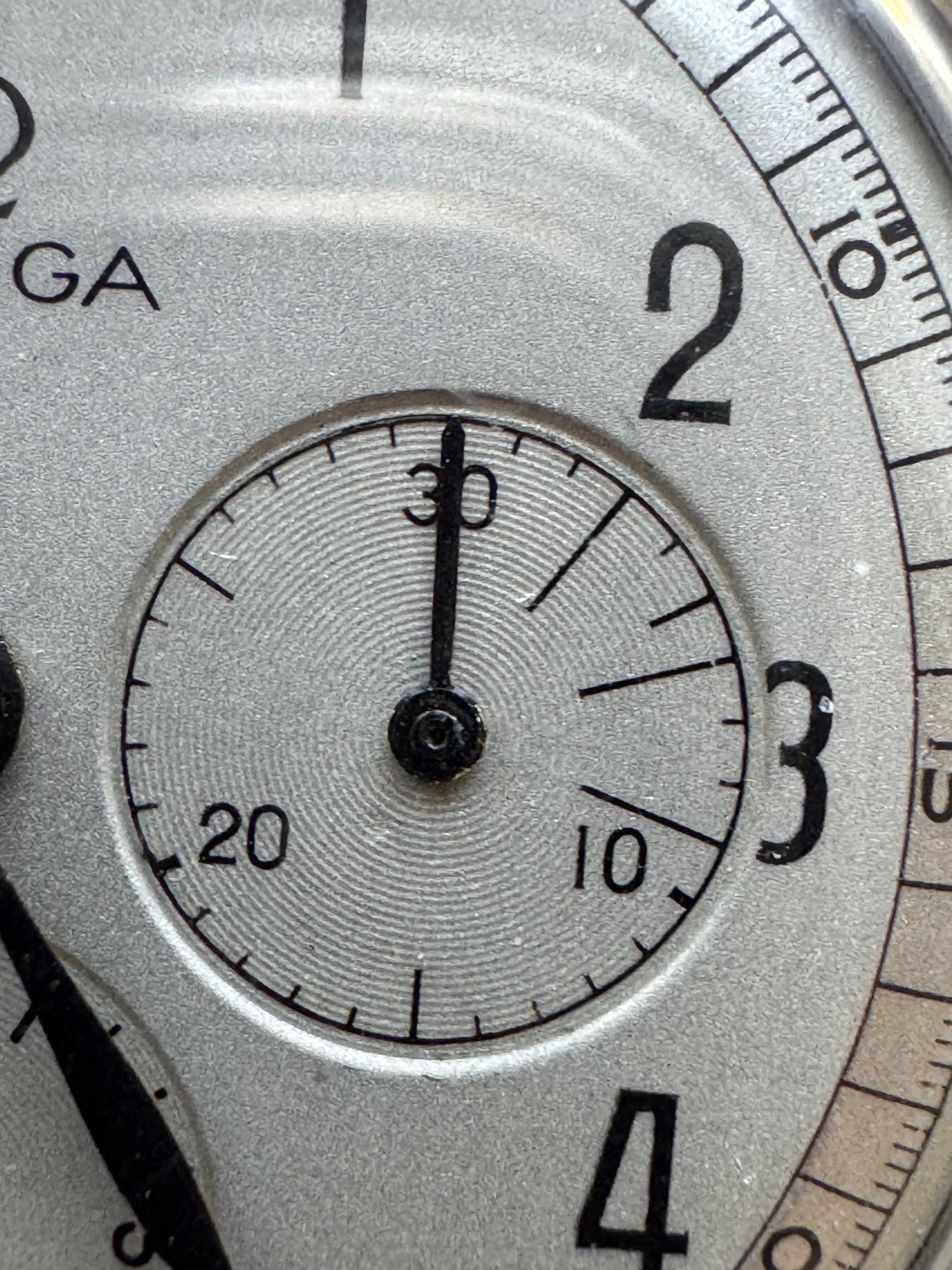

Here is another photo where the texture of the paint can be seen in detail.
