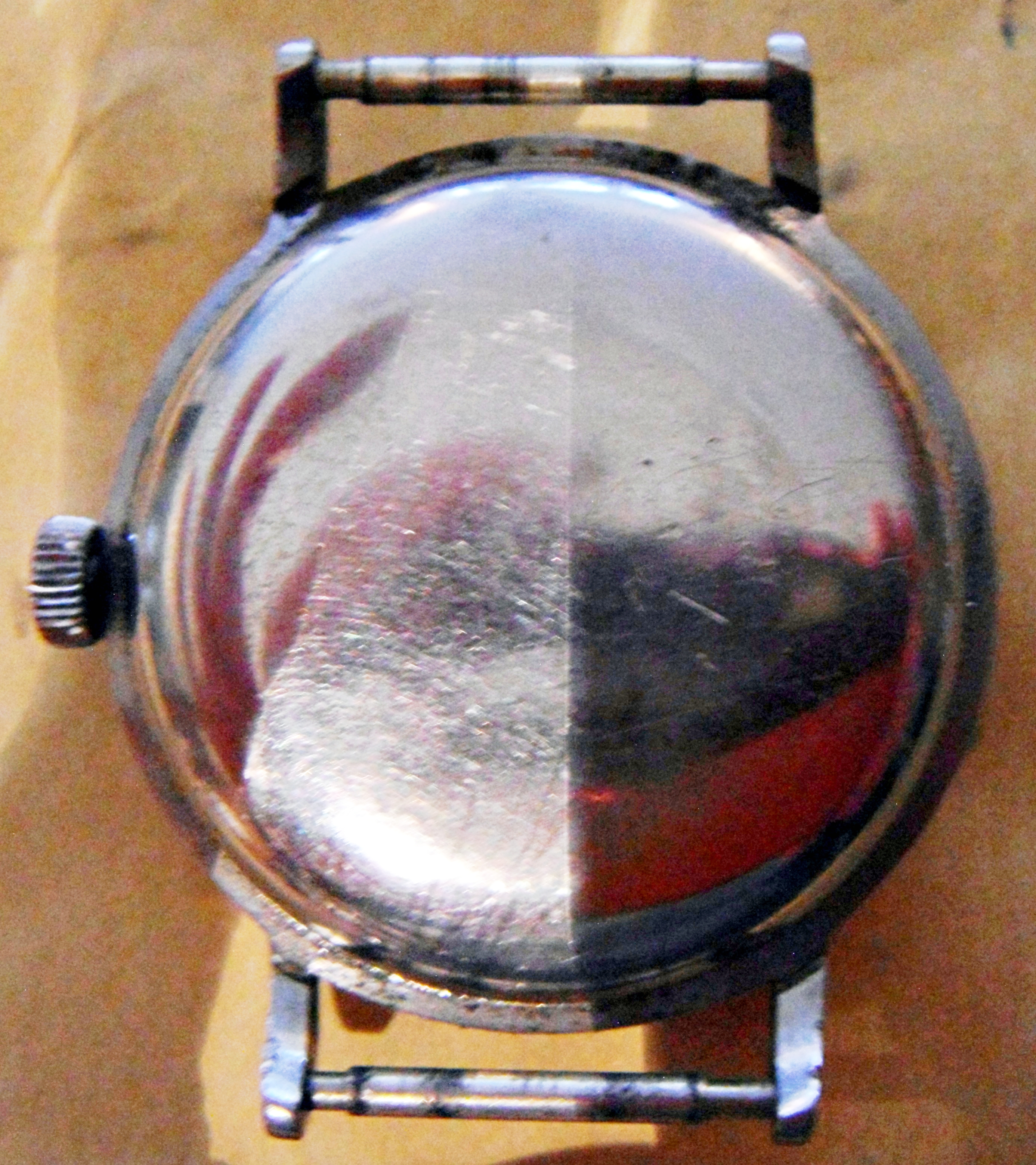

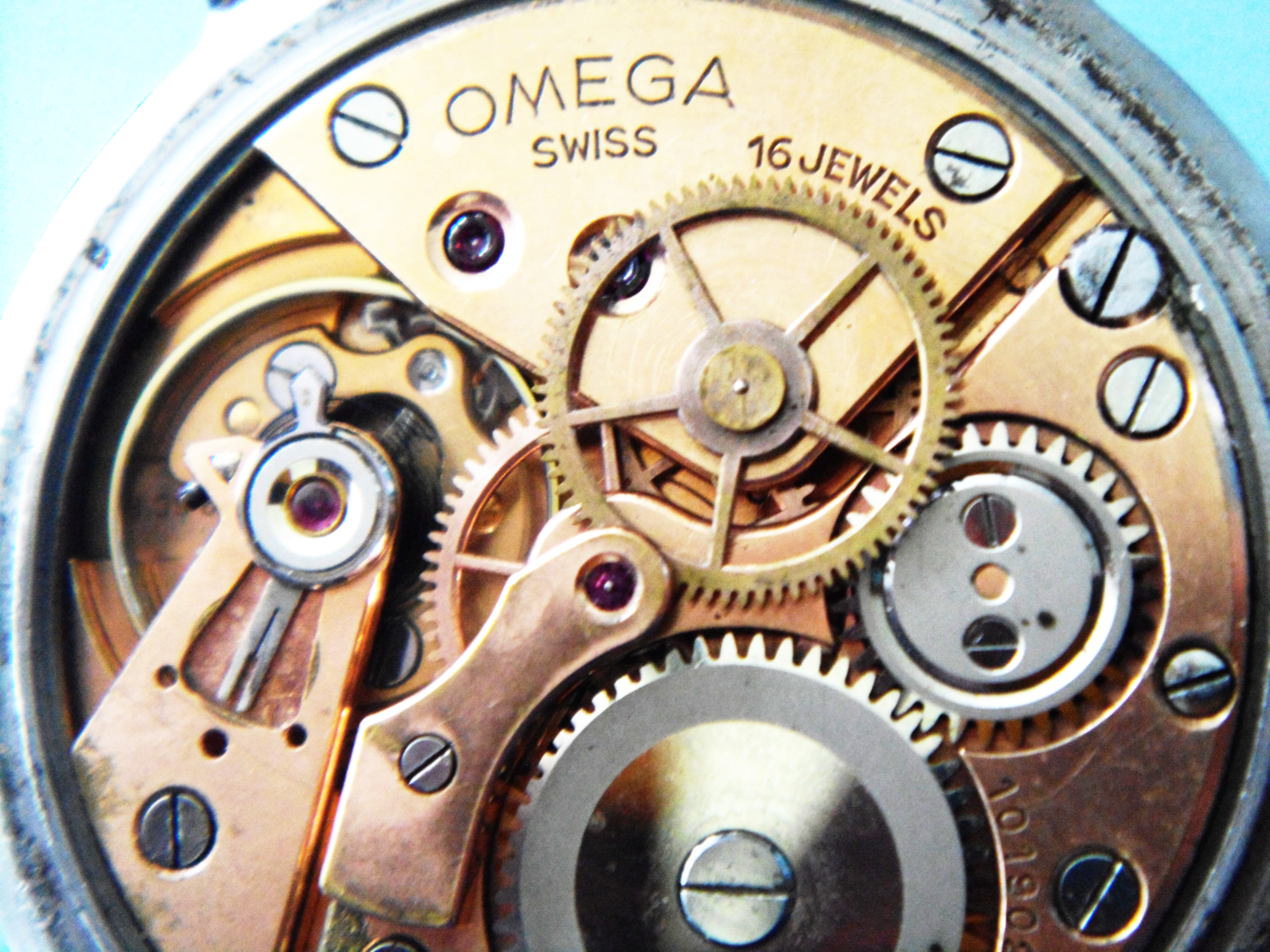

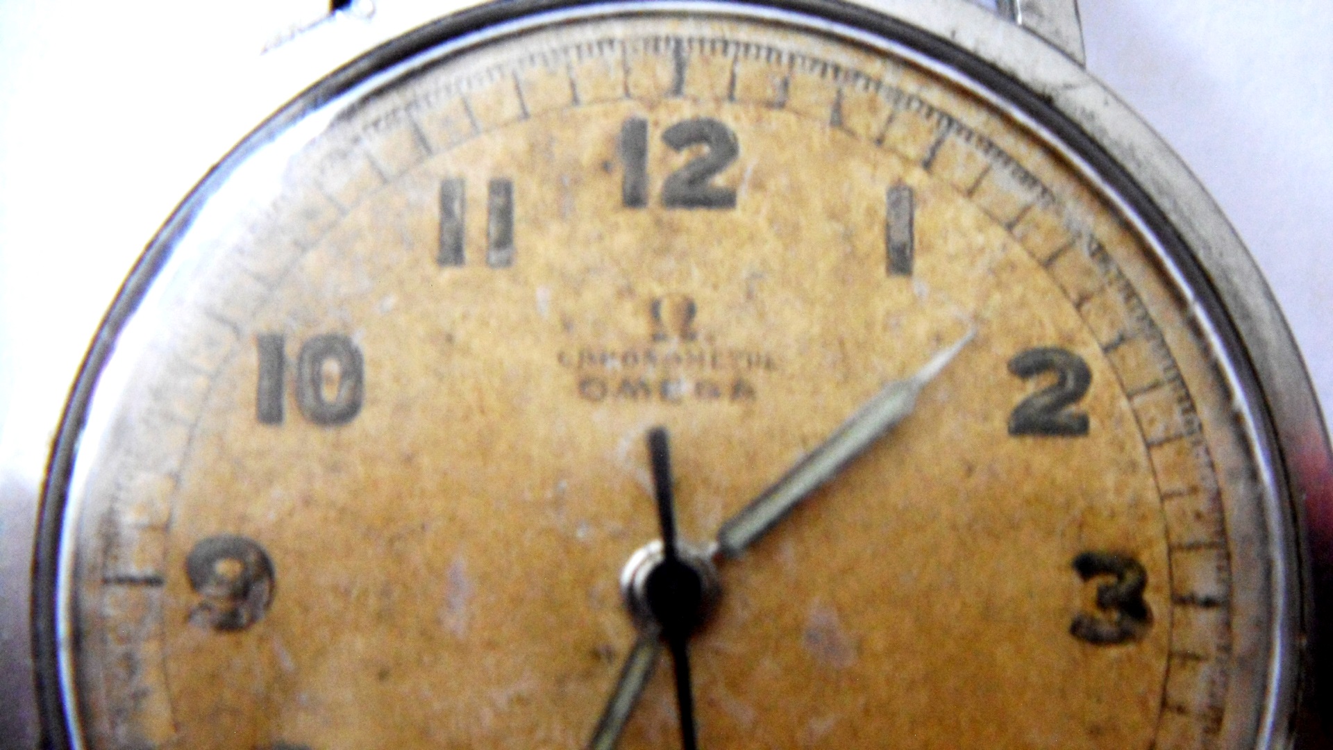

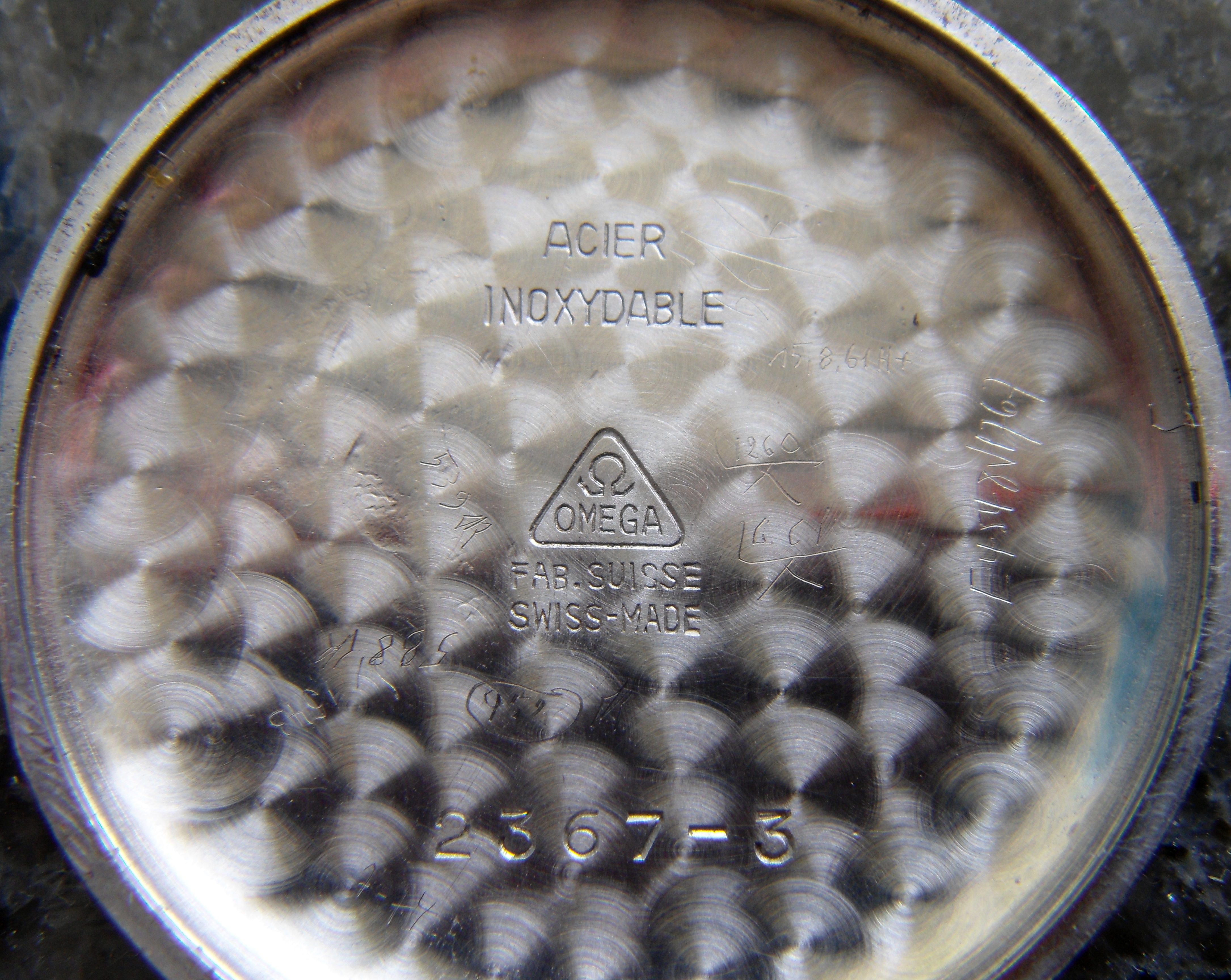

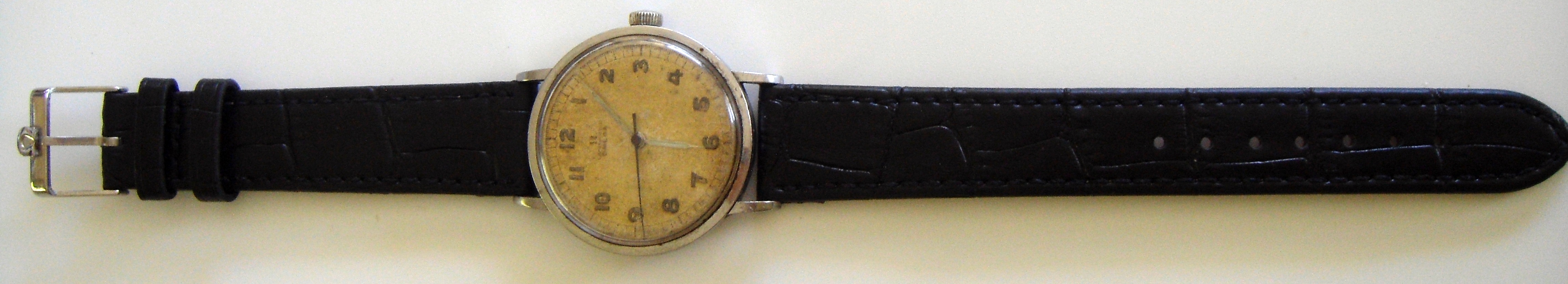

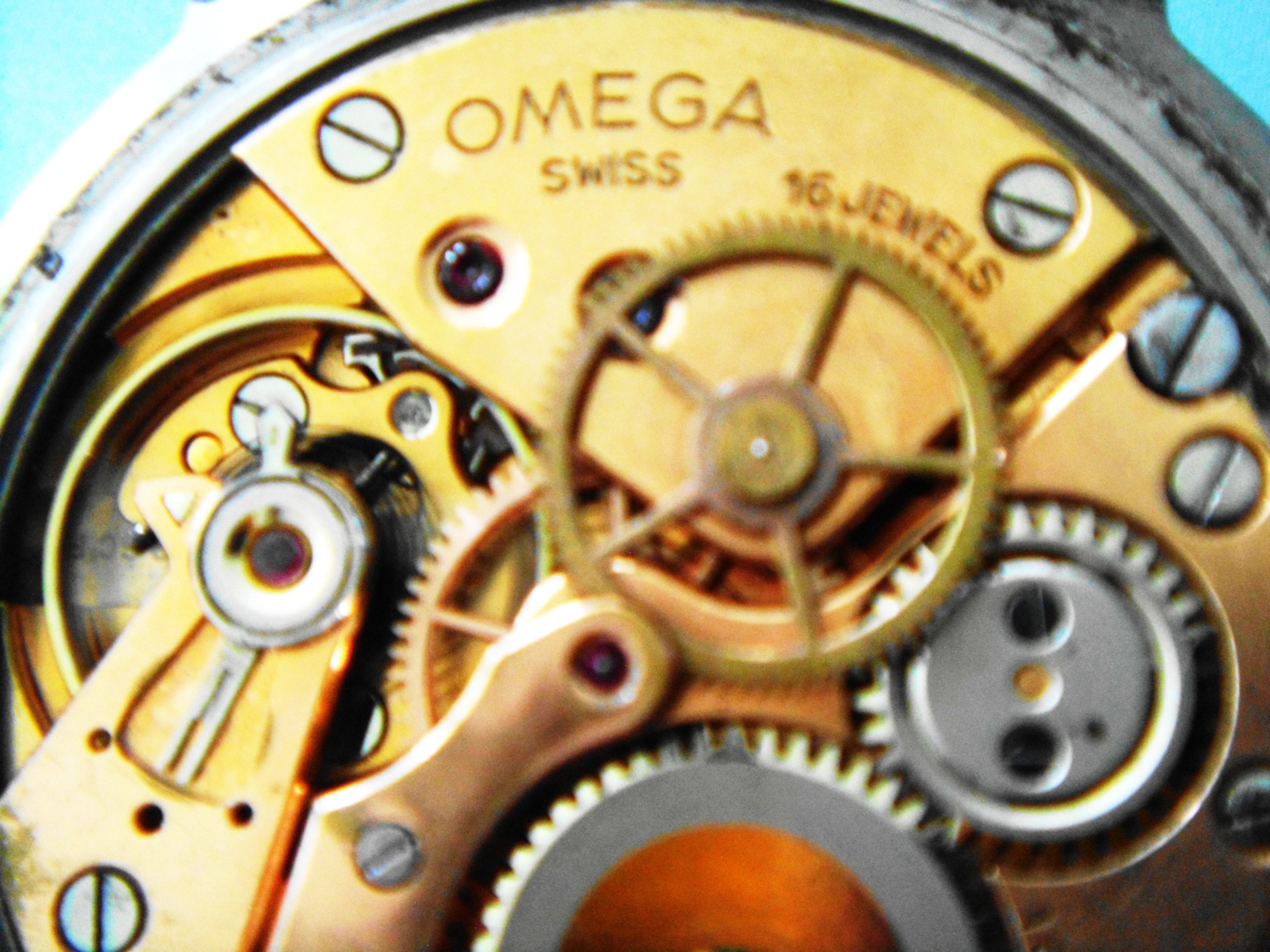

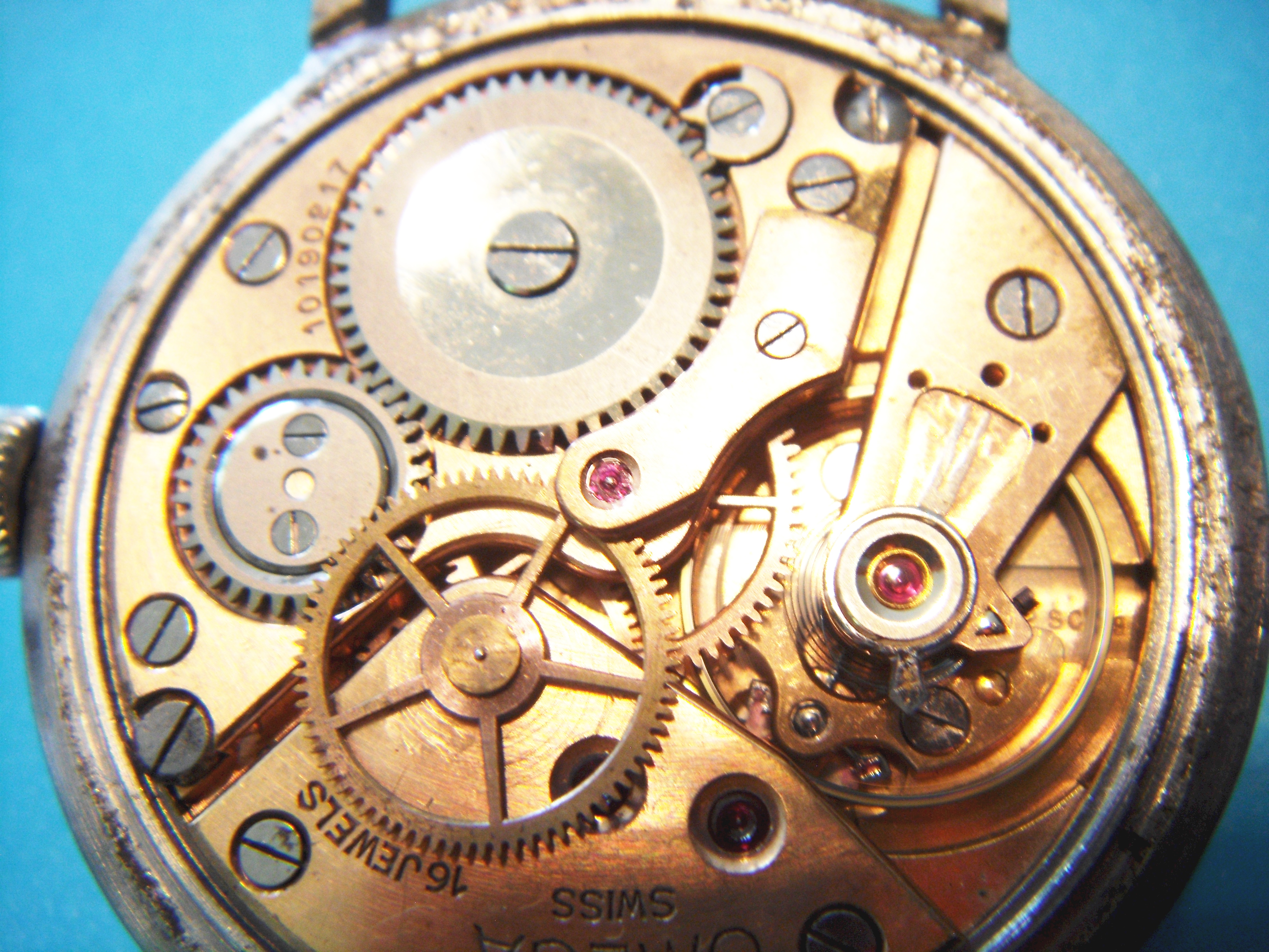

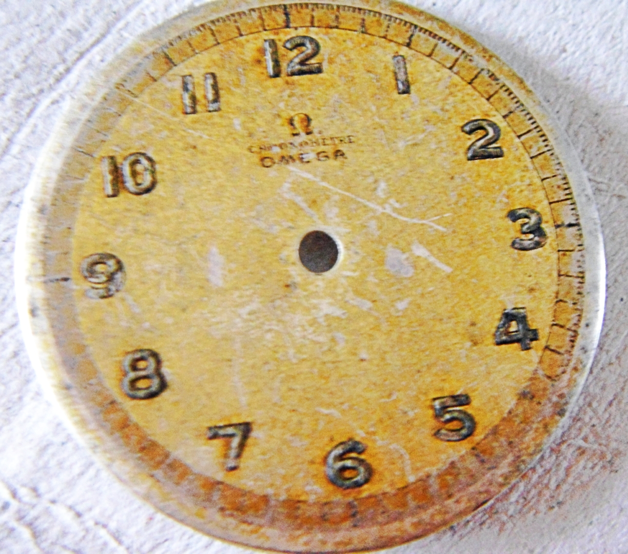

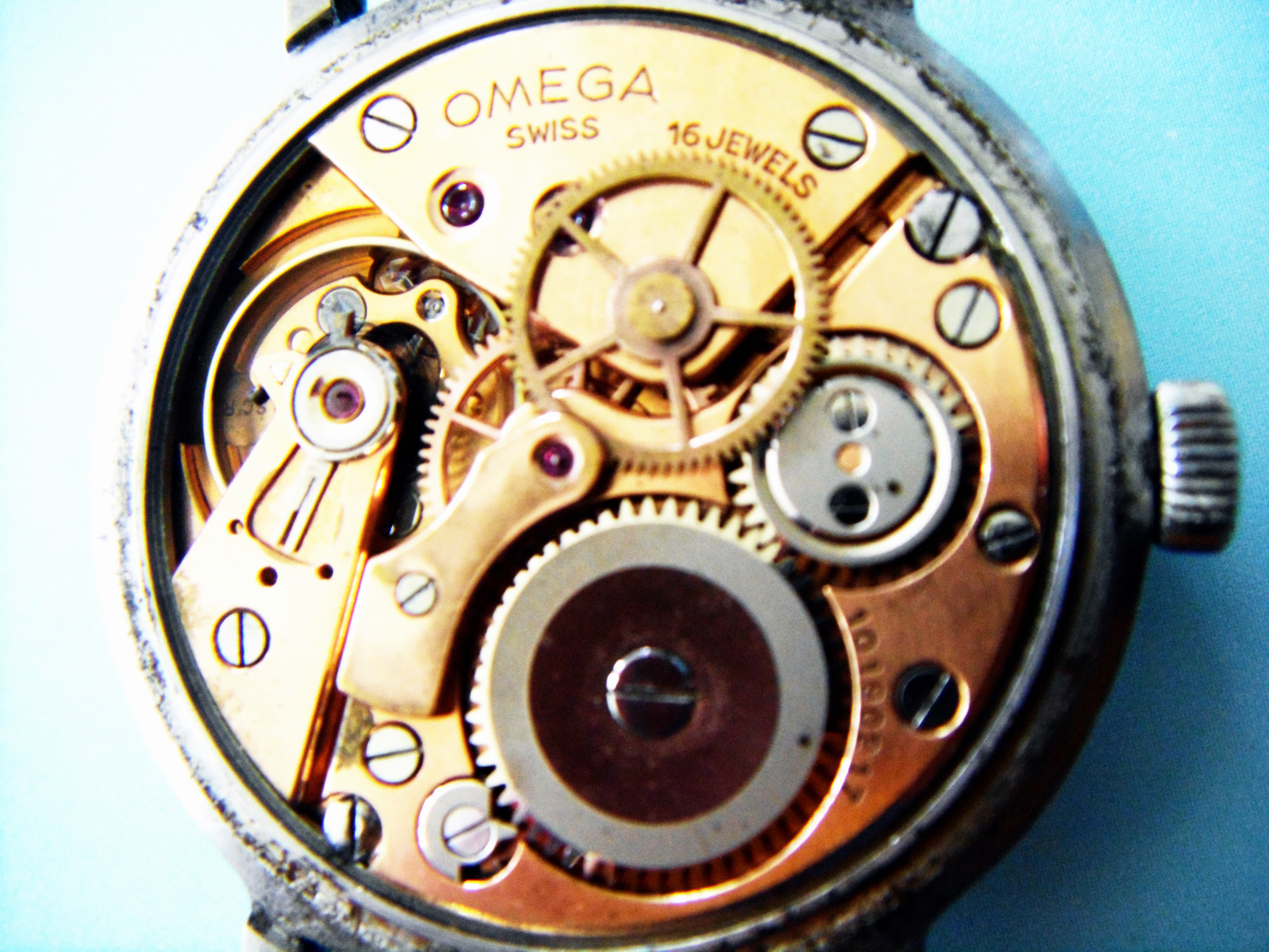

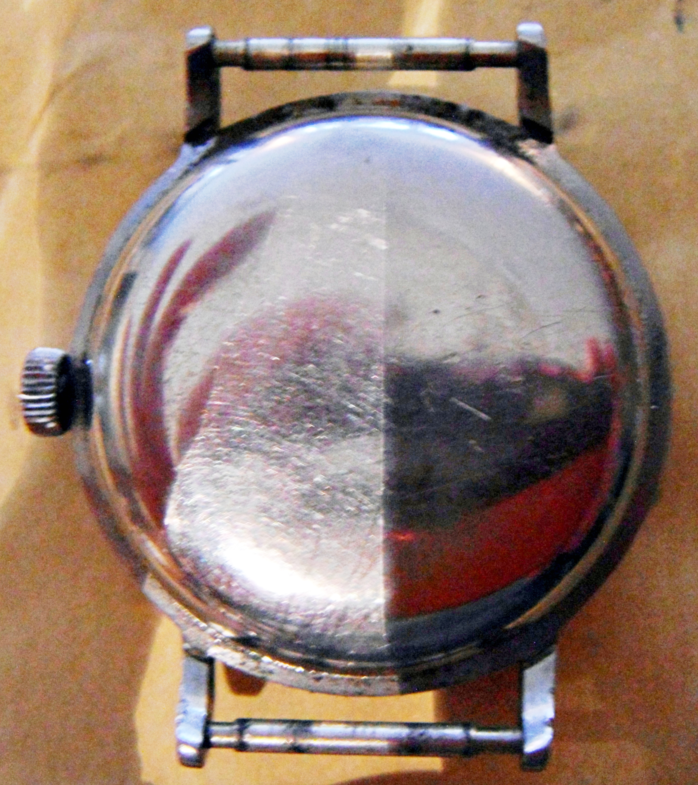

Hello everyone,

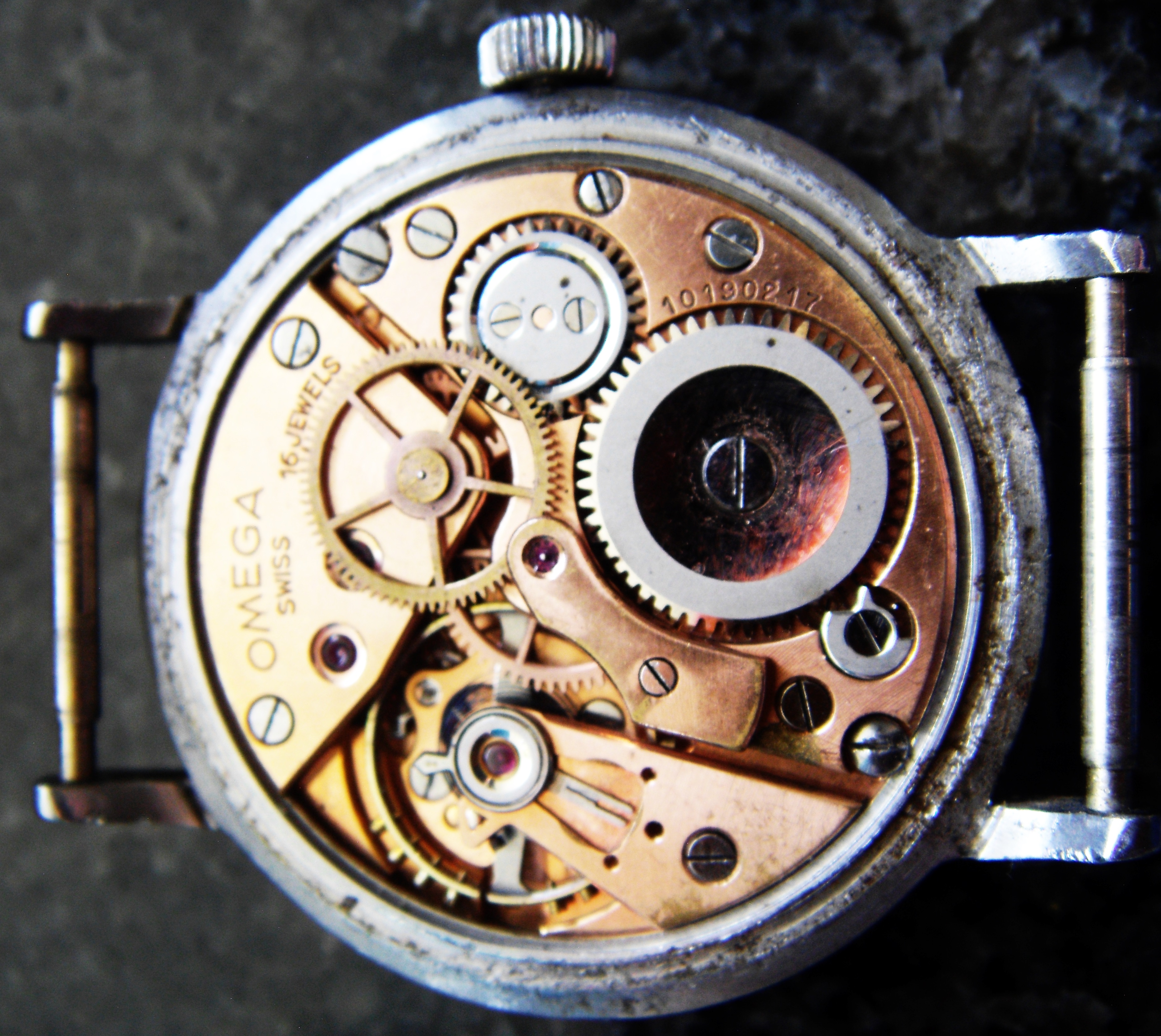

I am a retired watchmaker from Belgium and I possess (from my father who bought it in a second-hand sate to a client a lot of year ago) an Omega Chronomètre 30T2 SC RG that I have revised and works perfectly.
See pictures inserted.
Its diameter is 35,5 mm.
Its hands and arabic numerals are coated with radium.

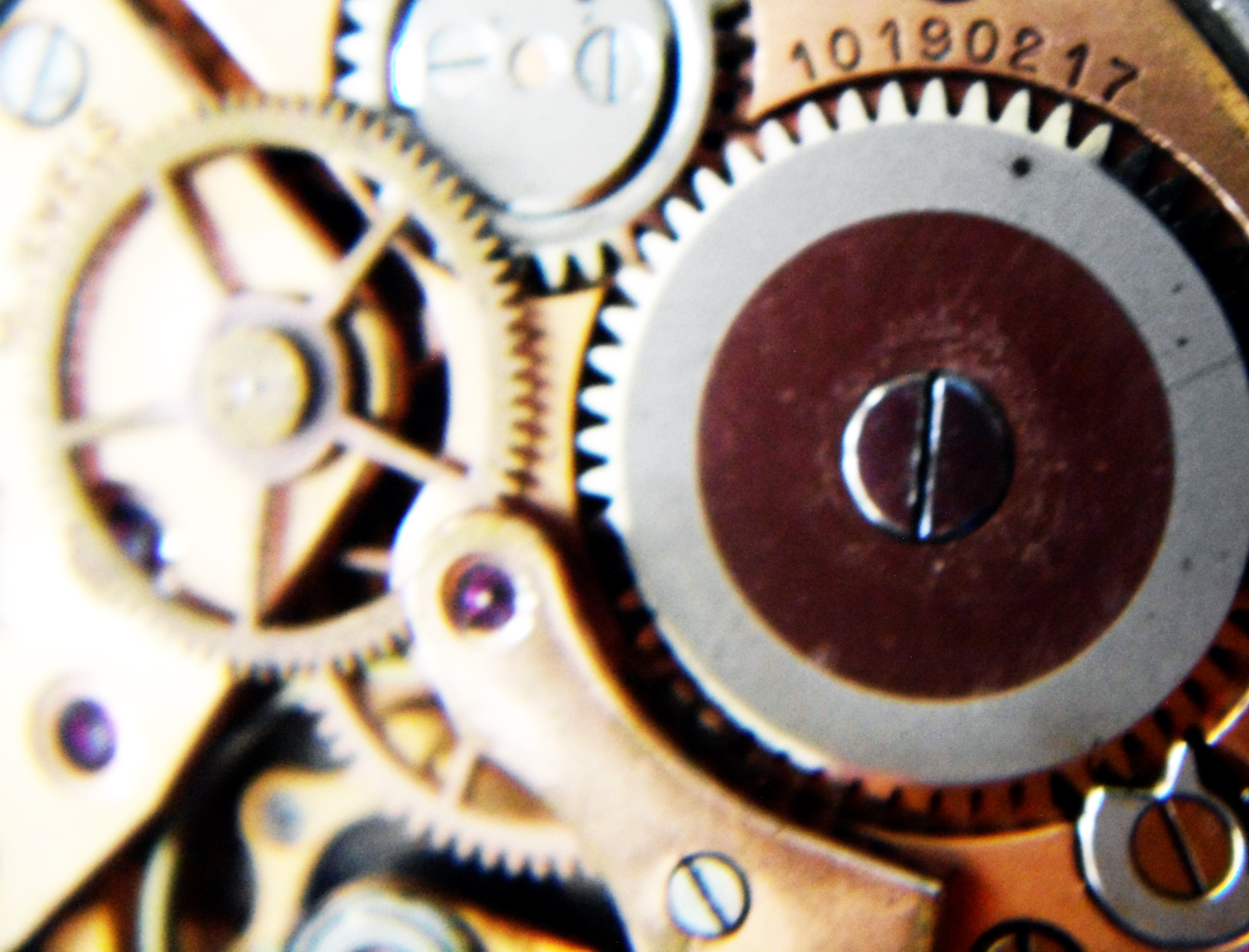

The serial number 10190217 engraved on its 16 jewels movement shows its year of manufacture is 1944.

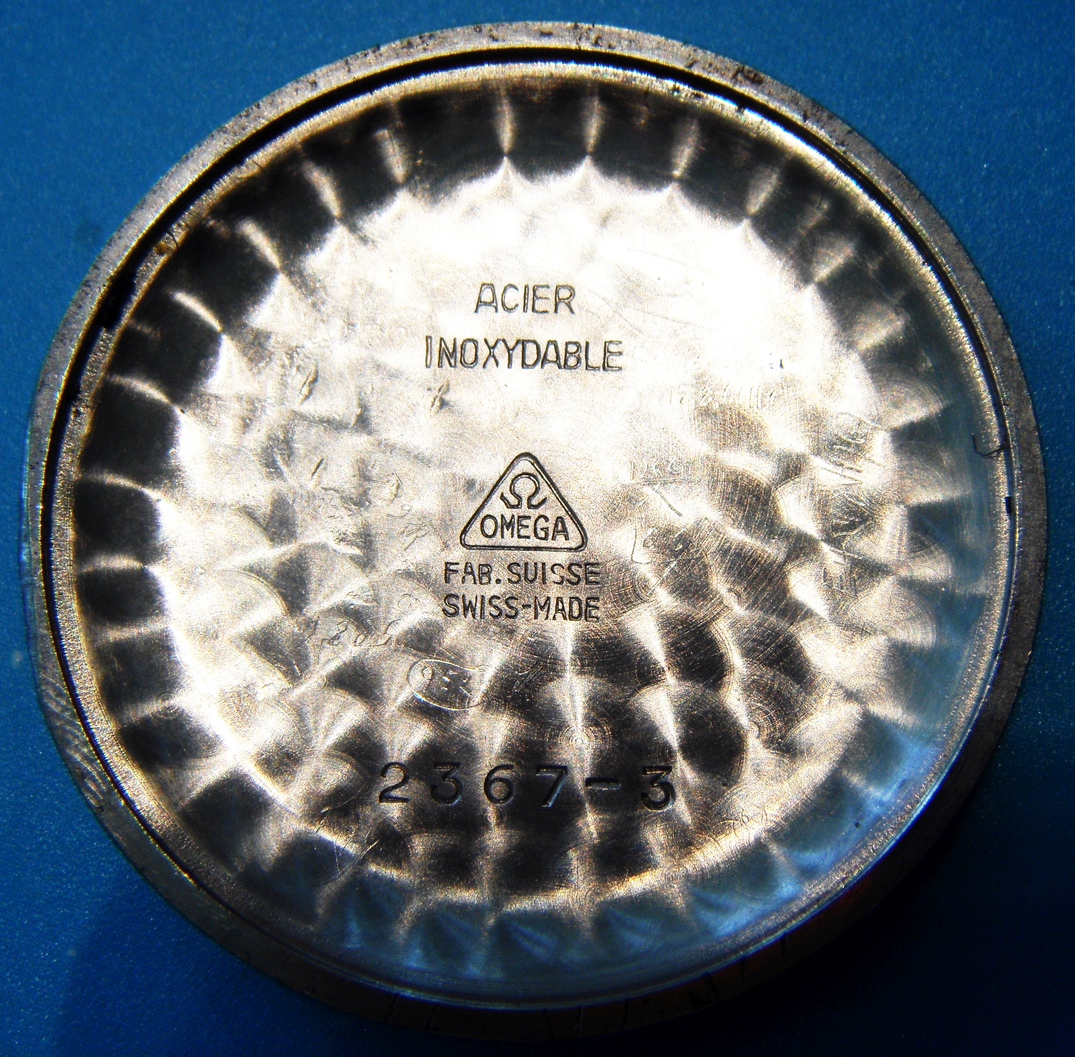

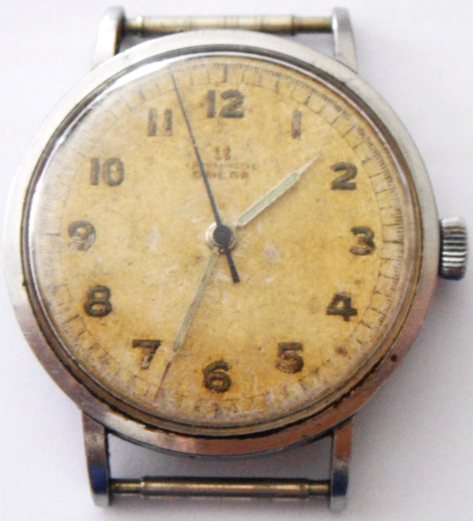

The reference number indicated on its non-screw inox back is 2367-3 but the design of its dial corresponds to the reference 2410(-1 I think, and that has normally a screw back).
So, it seems that it is not its original back.

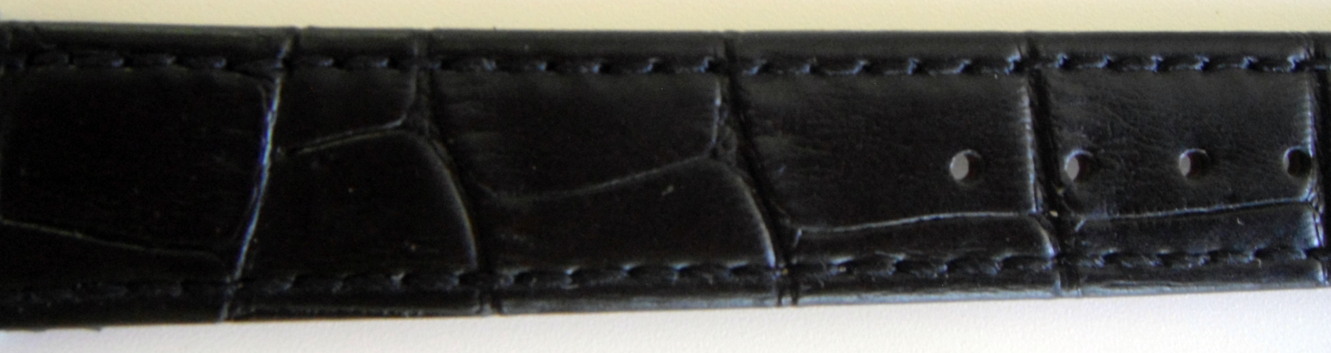

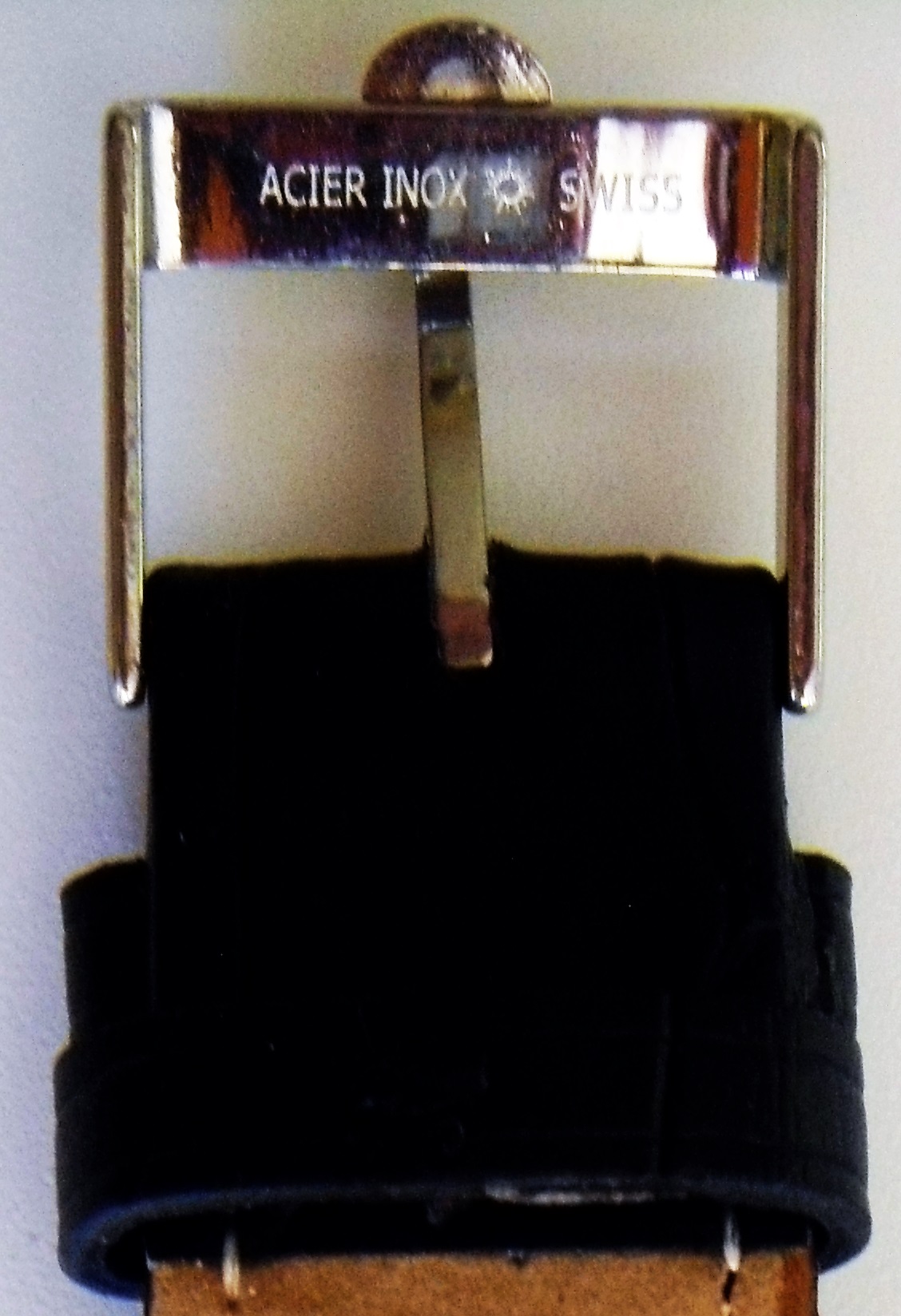

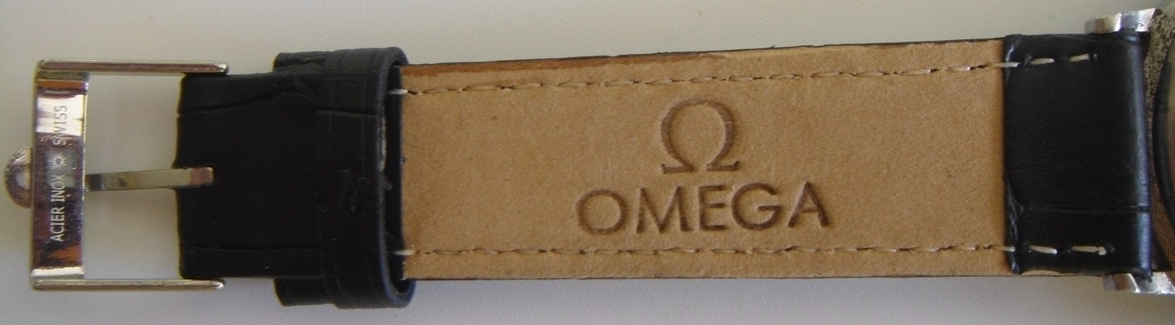

I have found an 18 mm. replacement black (genuine leather with croco style) strap with Omega logos (on the buckle and on reverse side of the leather) to fix on it and make it prettier.

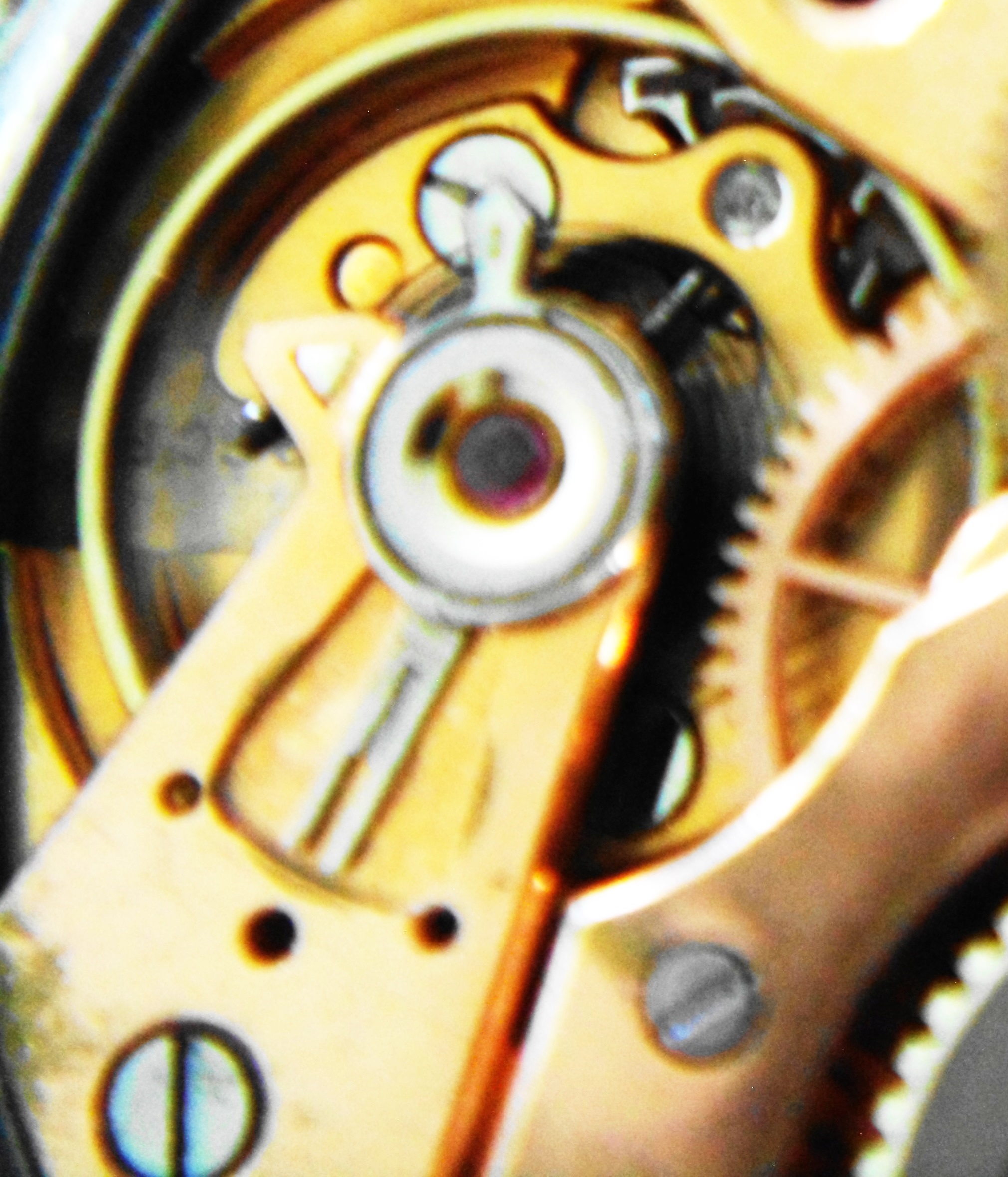

Its micro-regulator system lacks only a piece (the balance cock that has only an esthetical purpose).
On other Omega forums, I have read that the reference 2410 is considered as ultra-rare.
Can anyone confirm its back is not original and tell me what he thinks about its state in general ?
If you have an idea about its actual value, I would also be grateful to you.
And if you know where I could find / buy the lacking pieces (the balance cock and the original back for the reference 2410), please tell it to me.
Thank you in advance for your time and information / comments.

First off its not a 2410 , 2410 as you said is a screwback case ref and its 35 mm in diameter not 35.5..
Your watch is correct , 35.5 steel snapaback 2367. The dial is hard to see , please remove the bezel ... and we can clearly see the dial and how it fits in the case... But I think from the images I see the dial and hands are correct.

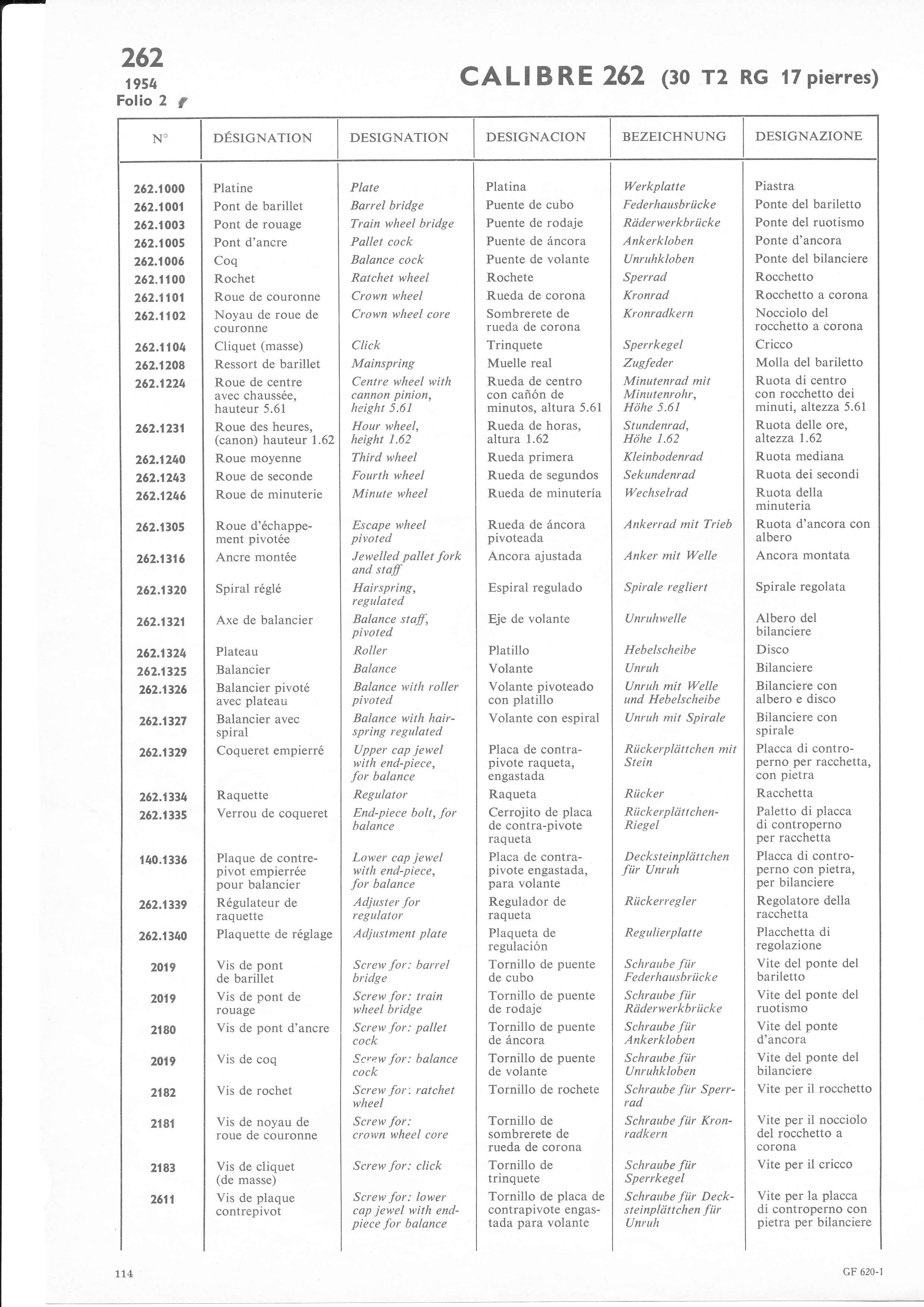

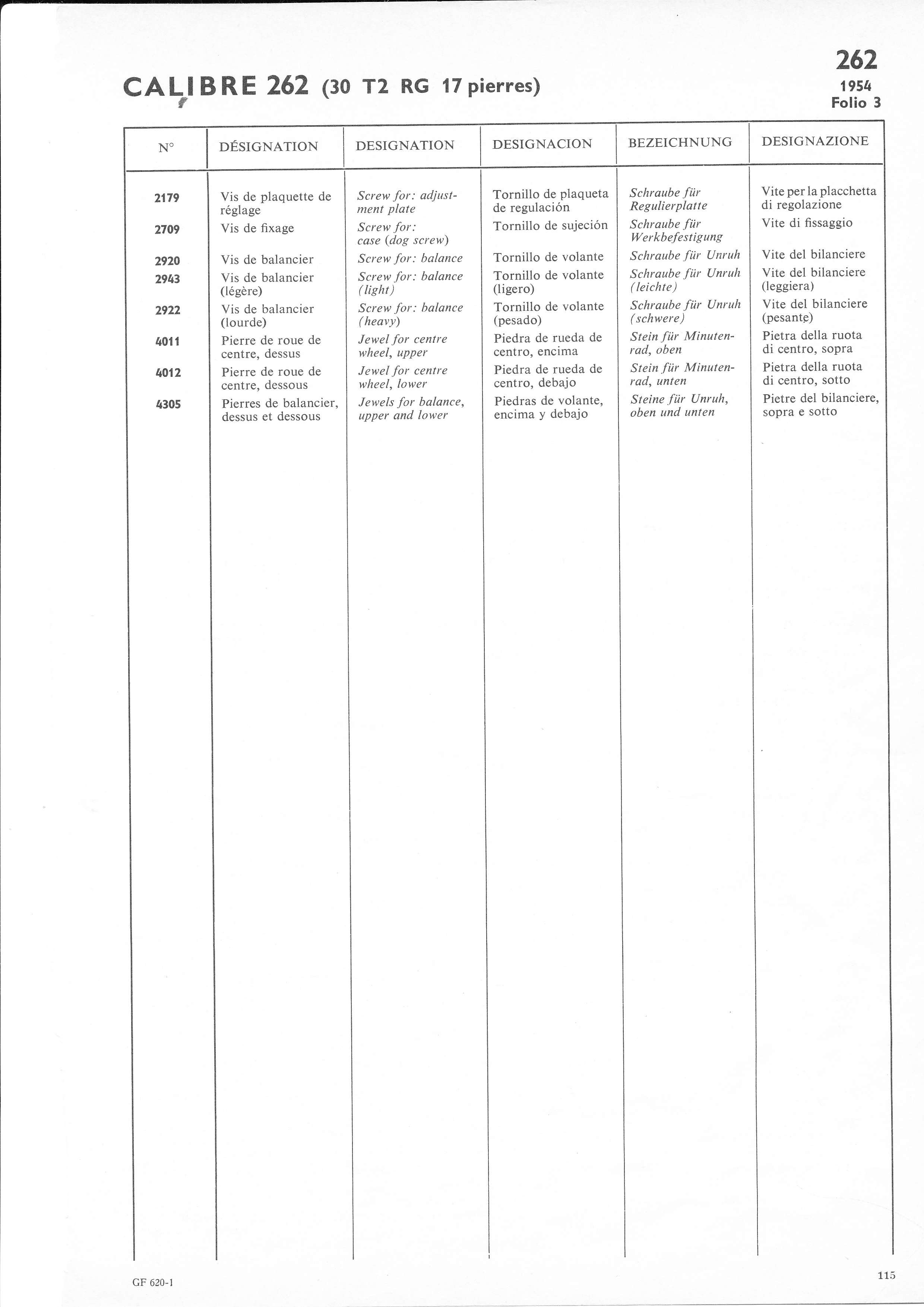

The partS that you are missing are important... for index regulation plus the screw to hold the plate and the index screw cap can tell.... you should check a material sheet for a 262... I will see if I can find one and post it here...
Enjoy your watch
Bill

If I'm reading the OP correctly, he believes that the dial has been transplanted from a 2410 into a 2367 case. I'm not sure why he thinks so, perhaps he has seen photos of a similar dial in a ref 2410.

he actually thought the case back was swapped which can’t be done .
A fully lum dial and hands is more typical of a 2410 but not out of rhe question for a 2367.
That is why I asked if he could remove the front bezel and we can see the dial better .
Bill

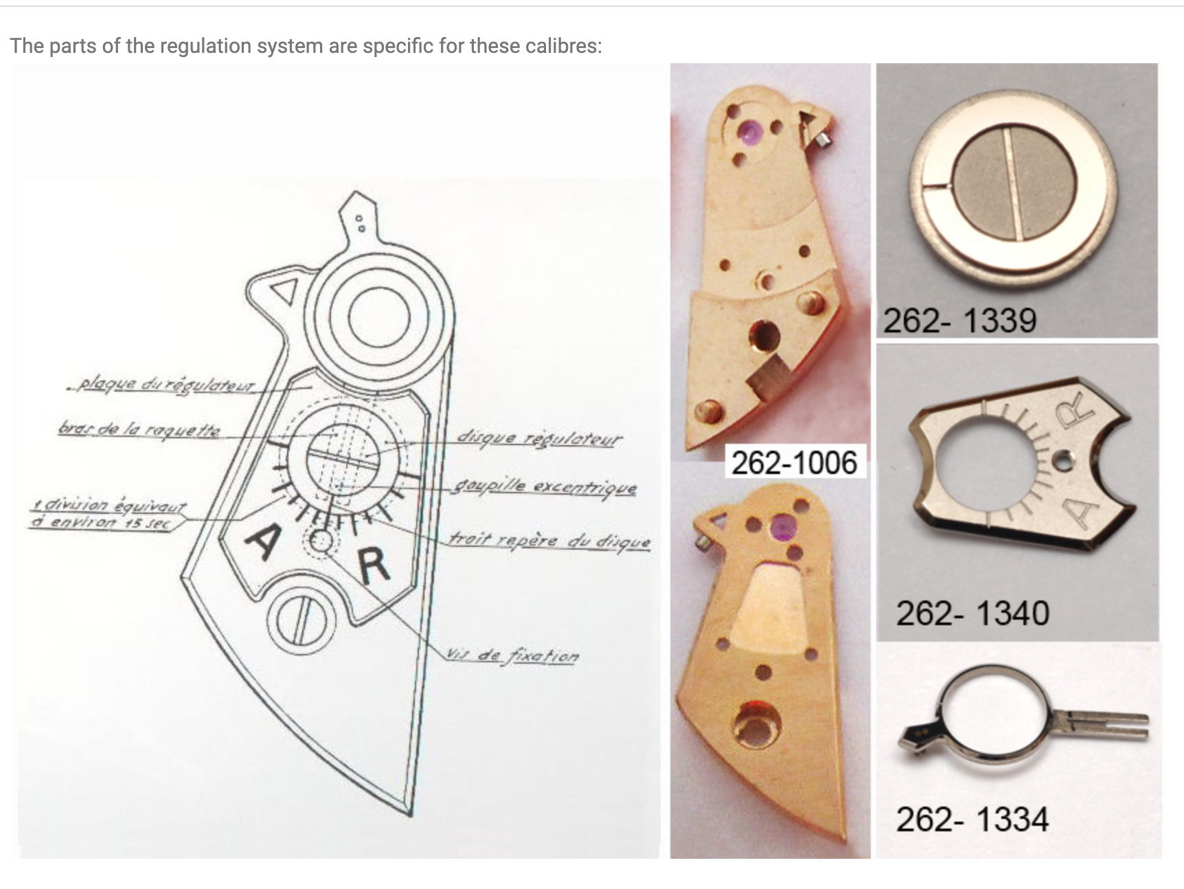

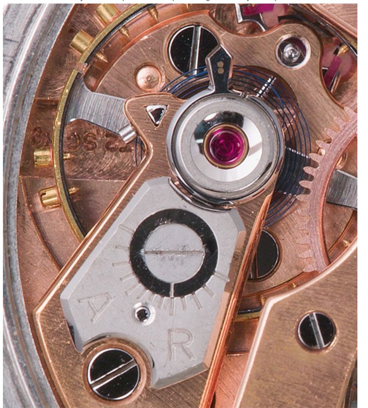

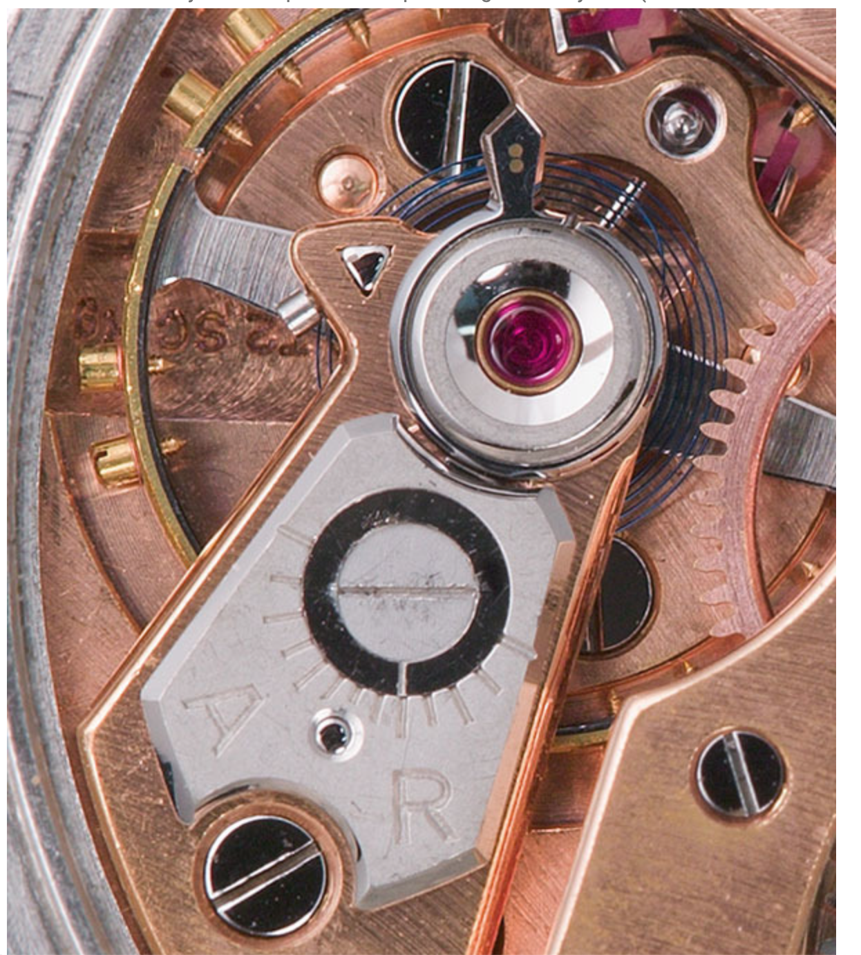

I thank you very much Mr. Bill Sohne and Mr. Dan S for their comments and data. It is now clear that the back of my watch is original. The remaining doubt is about the dial : why does its design (apparently) correspond to a ref. 2410 ref. and not to a ref. 2367 ? To answer that question, I will try soon to disassemble my watch without damaging it, in order to take and post later pictures of the dial without the bezel and also of the intern part of the case (where a number should be engraved, according to Frano's site). What is clear to me is that I need to find and buy the lacking parts/pieces (262-1339, 262-1340 plus the screw, according to the picture published on the Frano's site) of the micro-regulator (= regulation system) to make it complete. So, if someone knows who could have them and sell them to me (with shipping to Belgium), I would be very pleased.

I don’t see why you think the dial is wrong. I assume there were many variations. Maybe @mac_omega knows for sure.
11
Yes, you are right; it is not sure that the dial of my watch is wrong. I only understand (when I look at pictures of dials of ref. 2410 watches on the Frano's site: https://squelettewatches.com/chronometres-30mm/ ) that the design of the dial of my watch seems to correspond more to a ref. 2410 than to a ref. 2367.
I sent directly the same pictures posted on this forum to the e-mail of @mac_omega (Erich Lexer) and he asked me to send him:
1) photo of the dial with bezel/crystal removed
2) movement, where he can also see the rim of the case
and I will do so and also publish it on this post.

hi

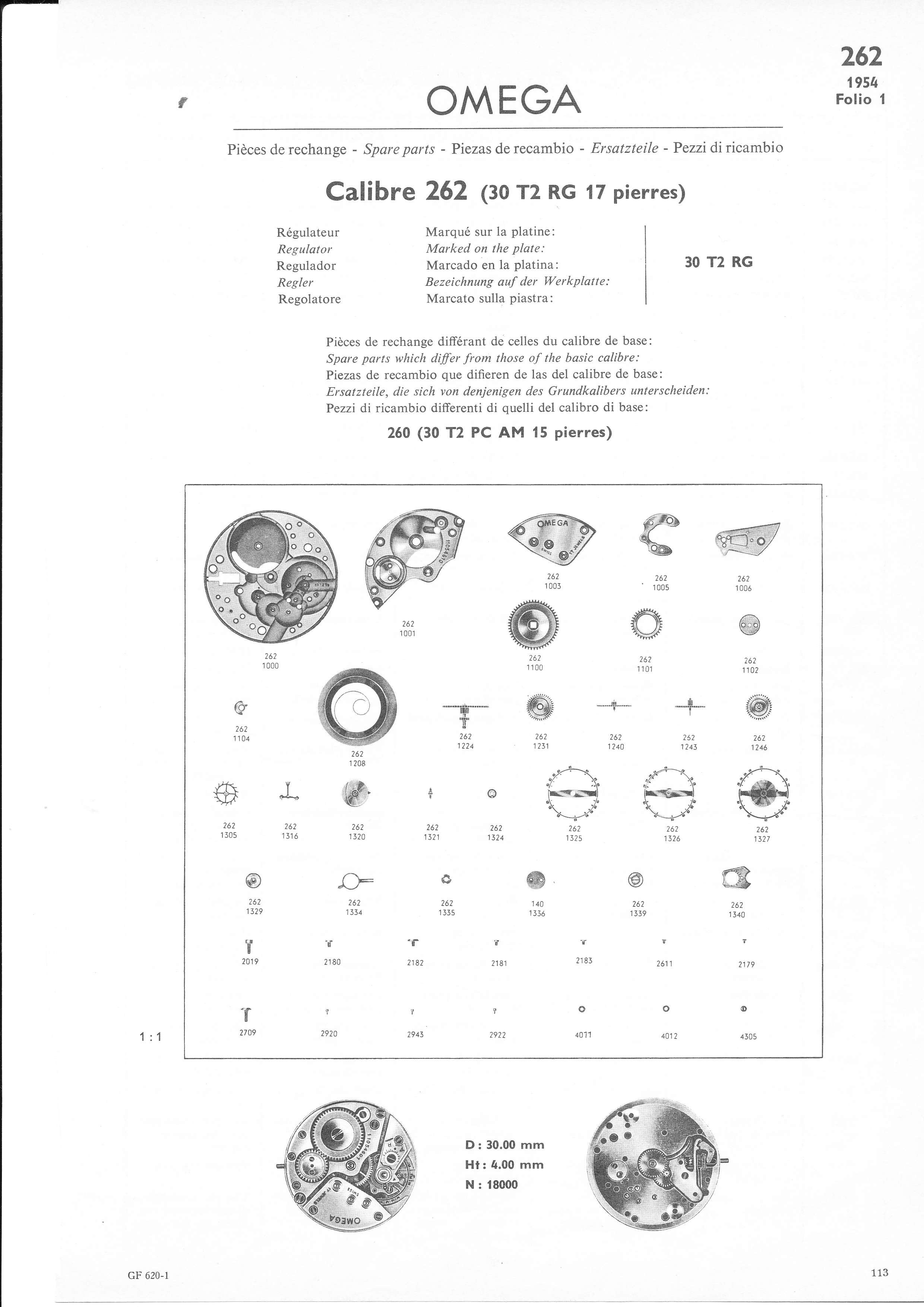

just found my copy of the complete material sheet...
you need screw 2179....

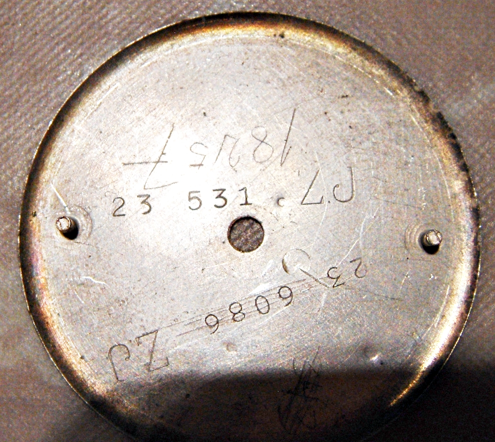

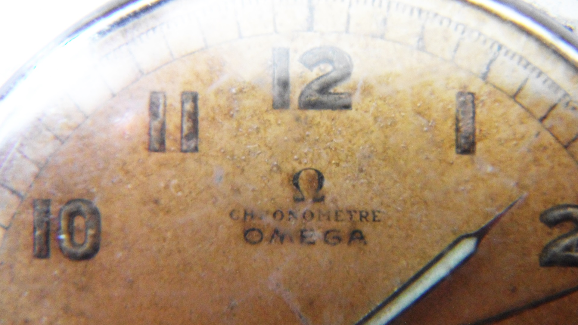

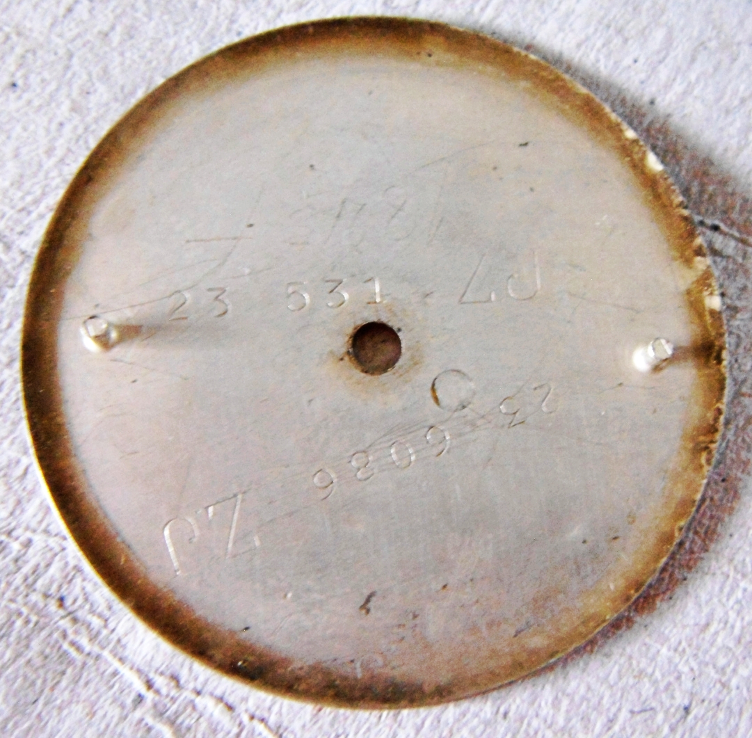

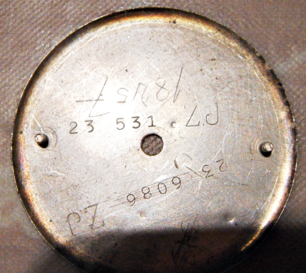

Please look at the pictures of the dial itself (front and back, without the bezel) of my watch below.
On the back face of the dial, the following numbers are engraved:
23 531 + upside down P7 (or PZ ?)
23 6086 ZJ
18257 handwritten
The diameter of the dial alone is 3,2 cm
So, what is your conclusion now ?
Do you think it is the original dial of my watch and does it really correspond to the ref. 2367-3 (and not a ref. 2410) as engraved on its back ?
6,680
11,632
IMO no reason to think the dial isn't original to case ref. 2367.

Now, after having received the answer of @mac_omega (Erich Lexer), I know that both the dial and the case back of my watch are original. If anyone of you could tell me where (or to who) to buy the parts 262-1339 (adjuster for regulator), 1340 (adjustment plate) and 2179 (screw for the adjustment plate) in Europe (with shipping to Belgium), in order to complete the regulation system of my watch, please tell me. Thank you in advance.

Parts are not available...OP will have to rely on the open market, and that will take time, or a donor movement.
