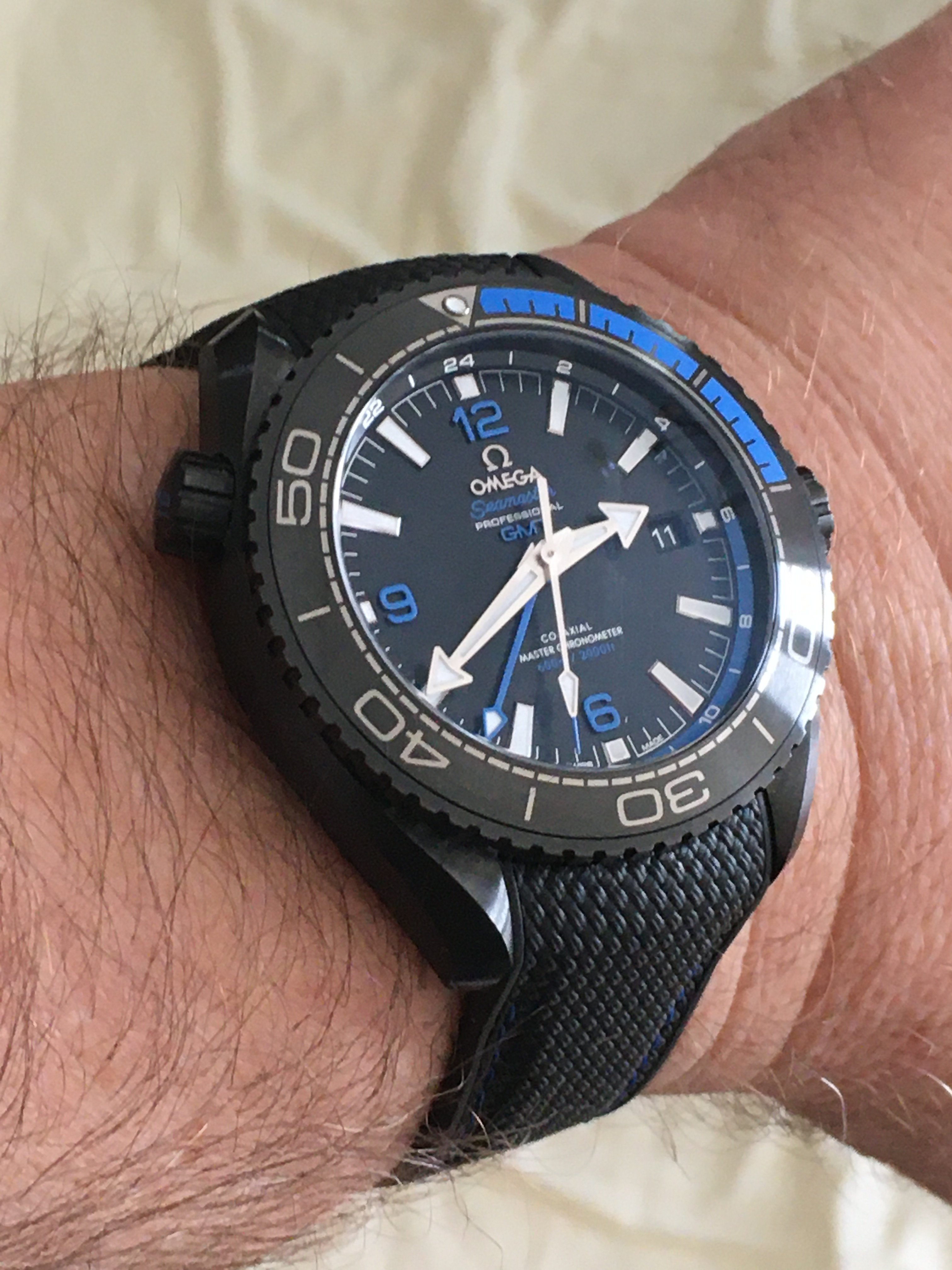

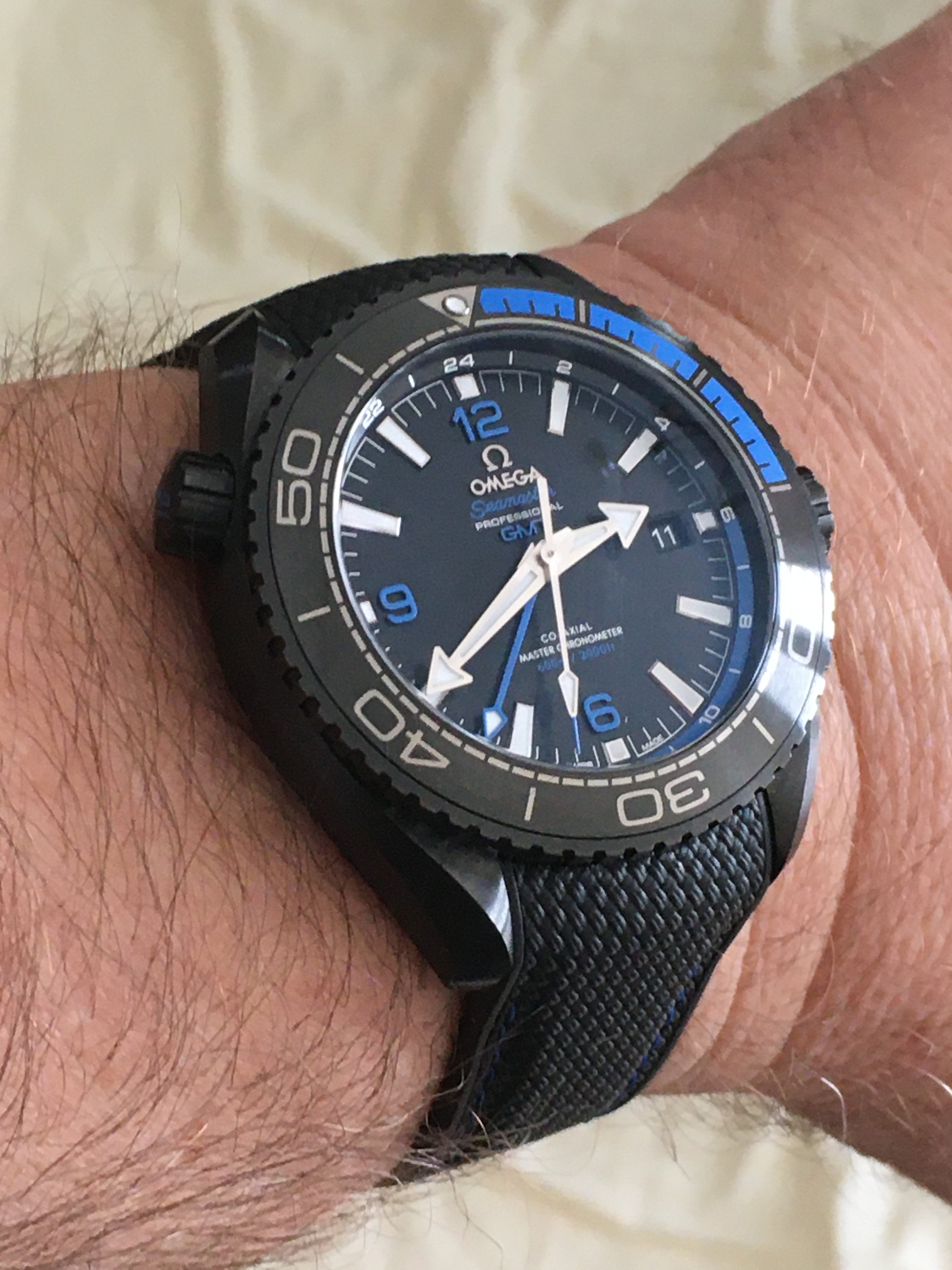

Seeking some more answers, I found Matt Neundorf writing for GearPatrol in 2016 says this:
"Etched stealthily on the dial, just below the post holding its four hands (and again on the lugs) are the letters ZrO2, the symbol for zirconium dioxide. That means that, similar to Omega’s Dark Side of the Moon Speedmaster and IWC’s Top Gun line of pilot watches, the Deep Black’s case material is ceramic. This is not typically a preferred medium for dive watch construction - aside from bezels, really - due largely to its hardness and lack of malleability. Unlike the metals usually employed for bottom time wristwear, such as stainless steel or titanium, ceramic won’t accumulate nicks and dings, though unfortunately certain types do have a propensity to shatter if hit hard enough. This trait is only amplified when the pressures of depth enter into the equation, especially those around the 600m mark.
However, ceramics born of ZrO2 are tougher than most: the phase transformation of zirconium dioxide under stress actually makes it less brittle and highly resistant to fracture, so much so that it has found favor in the dentistry industry, ostensibly for the likes of hockey players. As an added benefit, ZrO2 is extremely resistant to just about everything from acids to alkalis, as well as the oxidizing effects of both fresh and seawater. The crystalline oxide also boasts reduced electronic conductivity which, coupled with Omega’s METAS-certified 15,000 gauss resistance, means the Deep Black is damn near impervious to magnetic fields."
Edit to add this:
Worth knowing:
Properties of Zirconium Oxide (ZrO2)
  • High thermal expansion (α=11 x 10-6/K, similar to some types of steel)
  • Excellent thermal insulation/low thermal conductivity (2.5 to 3 W/mK)
  • Very high resistance to crack propagation, high fracture toughness (6.5 to 8 MPam1/2)

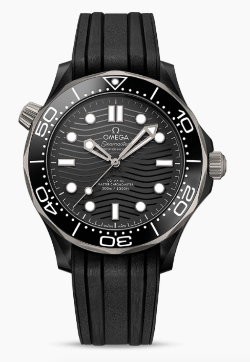

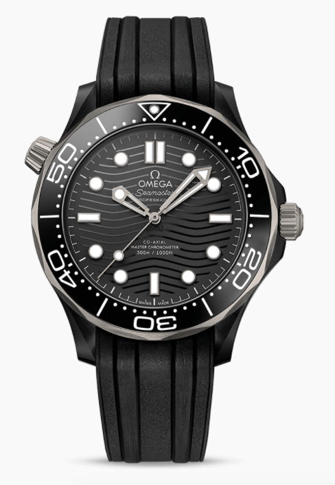

I have the 43.5mm ceramic seamaster 300m and a 44.25 grey side. I feel like the grey side wears smaller than the Seamaster despite being wider and (I think?) thicker.
