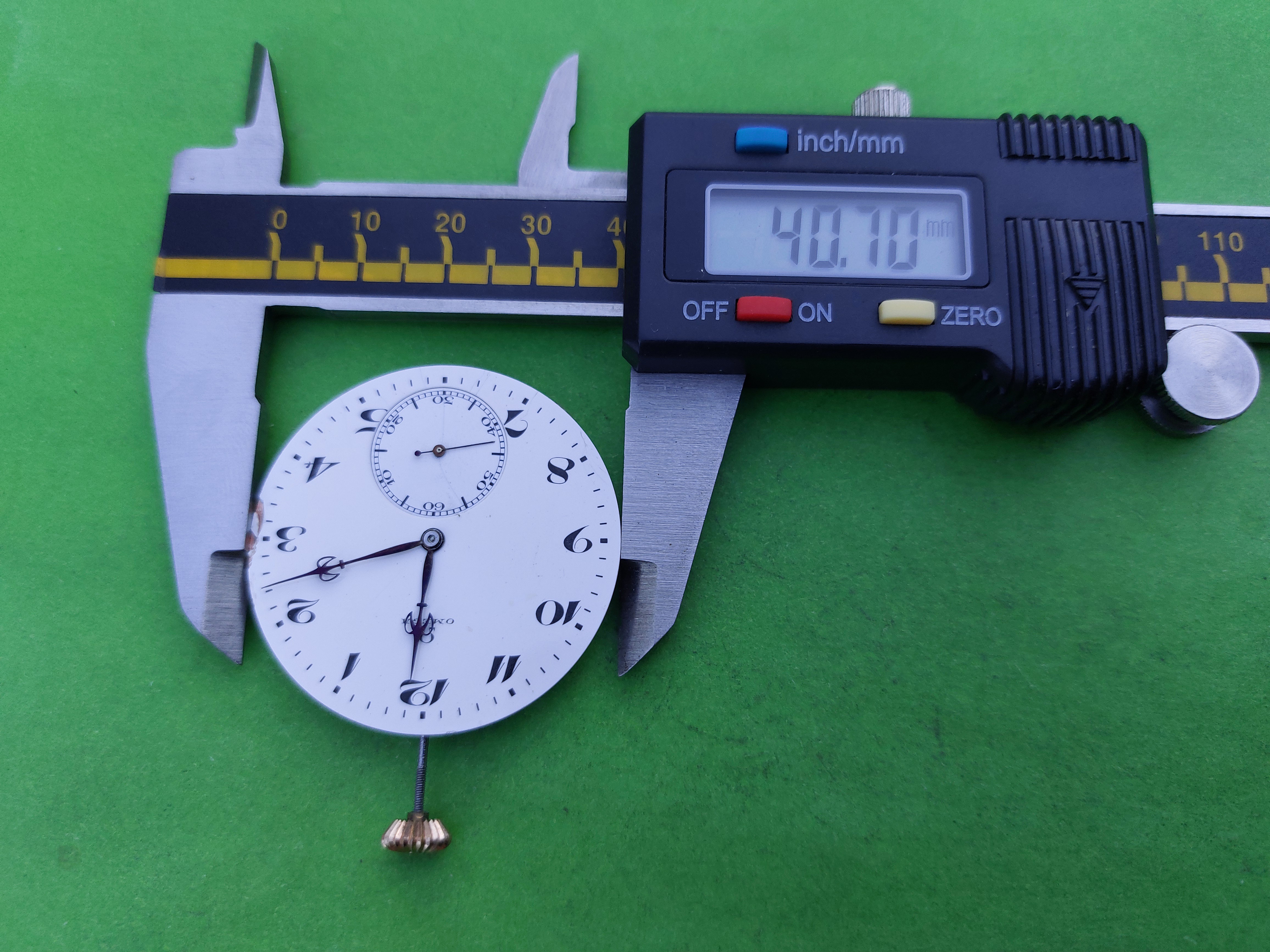

Hi team,
Can someone tell me what Omega caliber this is?
Thank you all in advance...

Hi team,
Seve

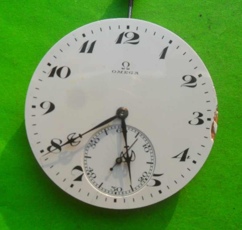

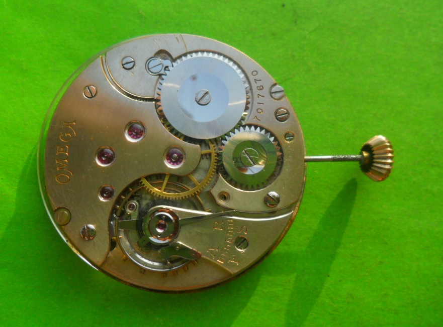

Caliber 39.5 L 17P introduced in 1917.
Serial number dates to about 1920 to 1930 depending on what source is used.
Seems to be missing a screw in the barrel bridge, some of the other bridge screws don't look right either.
