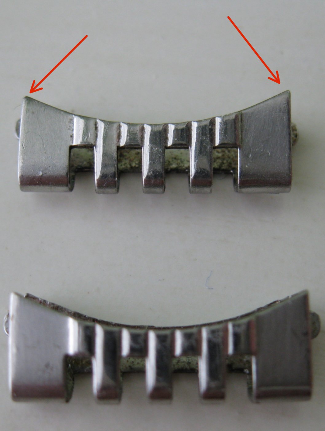

If it's not something funny in the photos, the endlinks may have been modified.

Is there a number on the end links? As Dan said, looks like they were trimmed to fit the Bulova.

570 on the end links
Are you sure? I think 570 endlinks are for 7-row BoR bracelets. In any case, the tips should be pointed, whatever they are.

My photos don't show it, but both end links have the tabs intact.
Not the tabs. Your endlinks have been filed down. Are you sure yours are 570? The example in my pic is a 570.

And they are not #570 endlinks. If those endlinks say 570 on the back, they may be fake.

They look more like 511’s but agree they may have been altered.

Five row should be 11s or 511s.

Agreed. Makes you wonder why the OP indicated 570. 😗

This is incredibly odd. Nevermind the filed off edges, 3 openings for the rows of beads instead of 4 just shouldnt exist on an endlink that's stamped 70/570.
