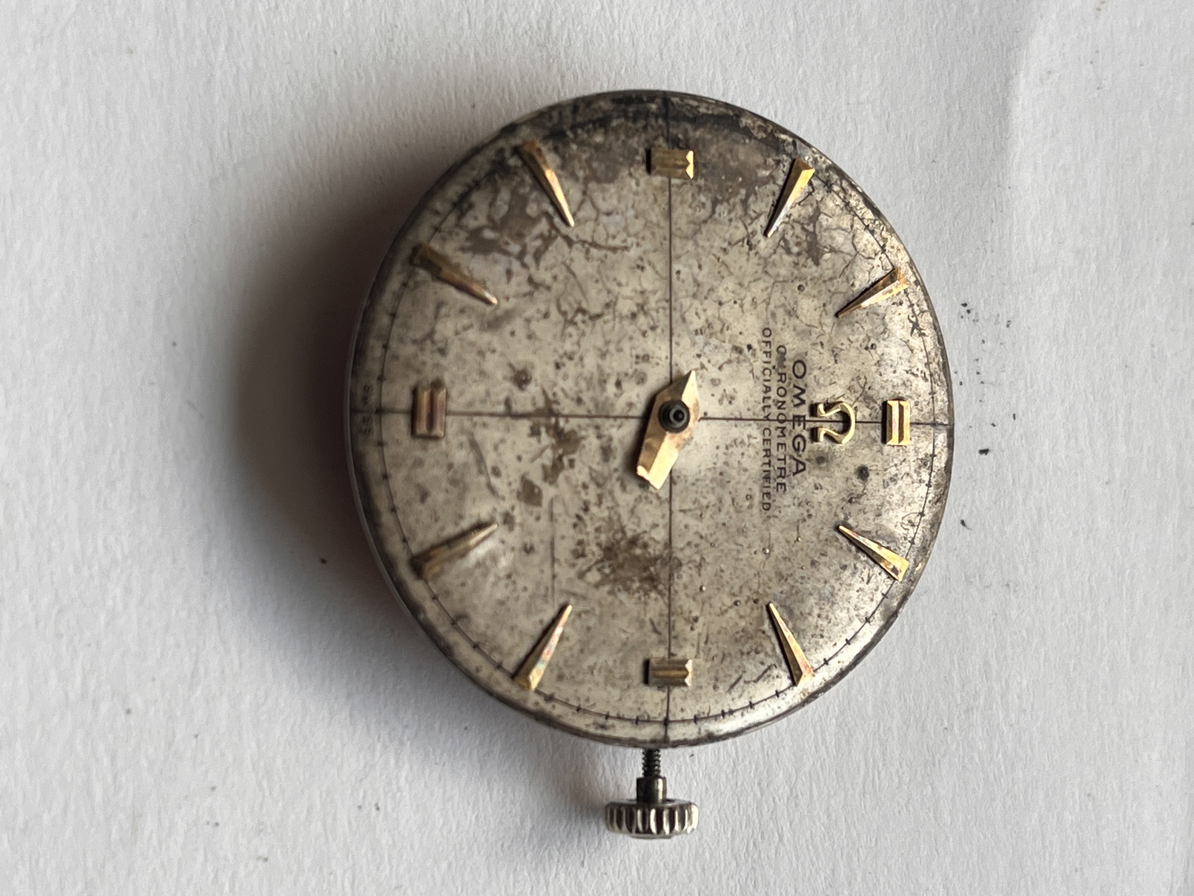

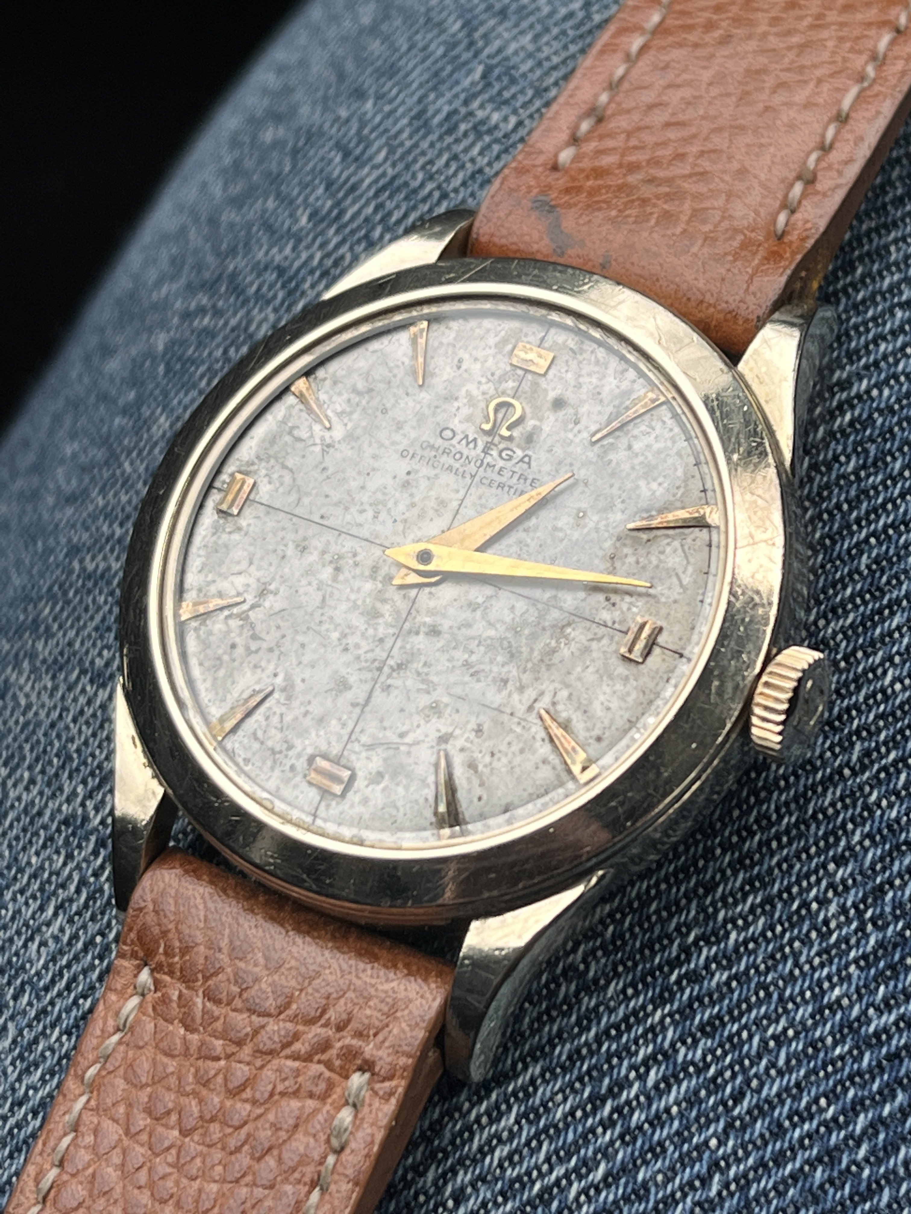

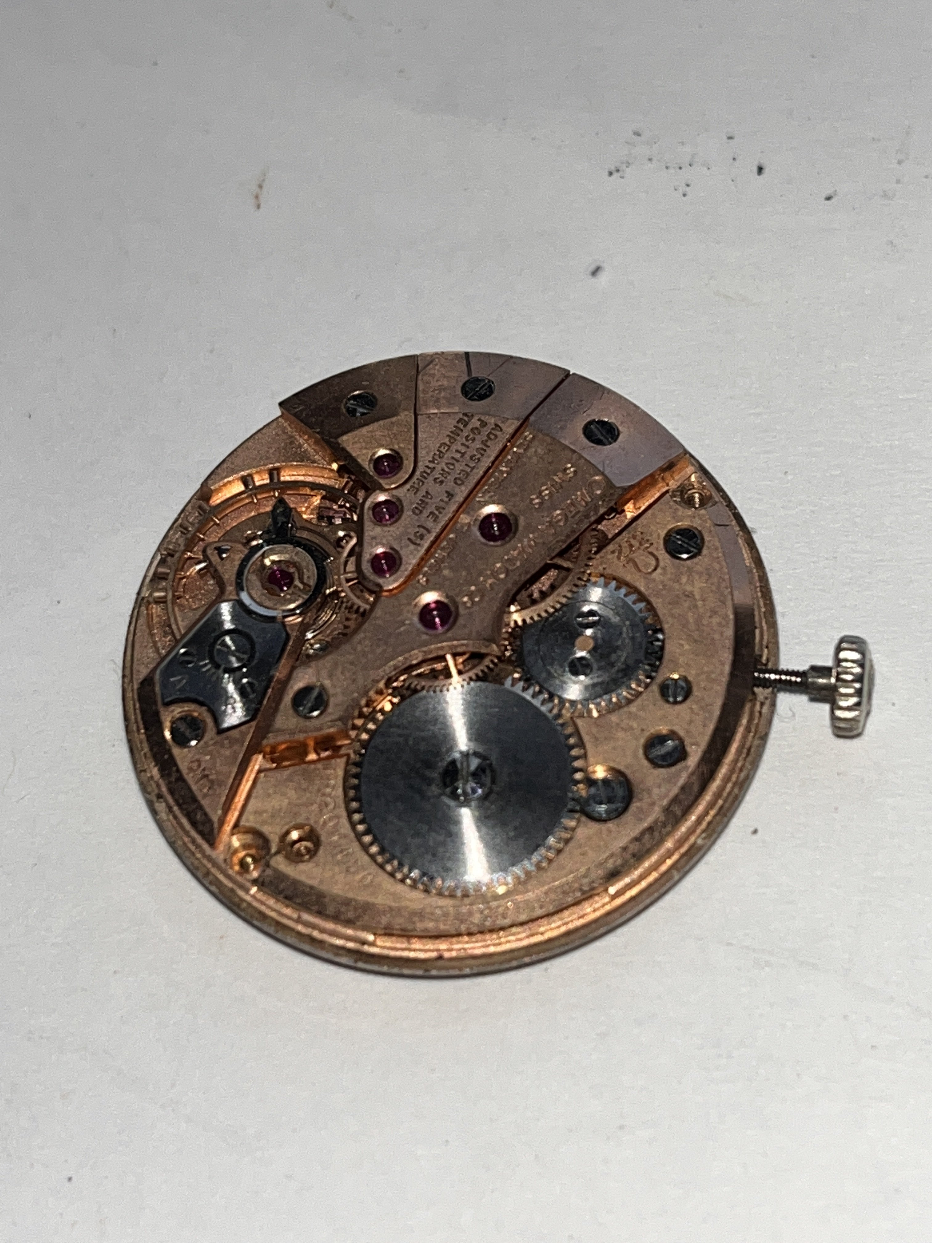

I wasn’t sure if I should post this, but I figure I’ll need help with this one… 2 pics show it as-found, and other pic shows it in its temporary home while I try to find a suitable 18k Omega case. Looking to do a sympathetic restoration to get her fully operational, but I am unsure of things like a dial refinish… this one is definitely in poor condition, but it’s original. The current hour & minute hands came out of my parts stash, but I’ll need to find the sweep seconds hand or have a “correct” one made if possible.
If anyone has an appropriate-looking 1950’s solid 18k Omega case that this movement will fit into, I would be very interested… and ANY restoration advice will be helpful, so thank you in advance!

Very cool, not many of these synchrobeats around. It would be good to pull an extract on it to find out if they have any info on the case or anything else cool like where it was delivered.

That 372 has jumping seconds I believe and would be sweet to see going again! I hope you find a stunning seconds hand.
Good luck, it looks like work.
I personally feel it would look better cleaned up and left original, as-is with the "moon-crater" dial. The watch companies work hard to get dials looking like this!
Cleaned up with shiny markers and proper hands and I bet this looks killer.

I am leaning toward just cleaning the dial & markers… and I’m one who really appreciates originality on my cars, jukeboxes & watches. Amazingly the movement is running strong and actually keeps good time after a quick clean & oil, but the seconds function isn’t working as far as I can tell. It appears to be all there, but something is preventing it from ticking properly.

Hi, would you mind sharing the serial# ? It can´t be read in the photo.
