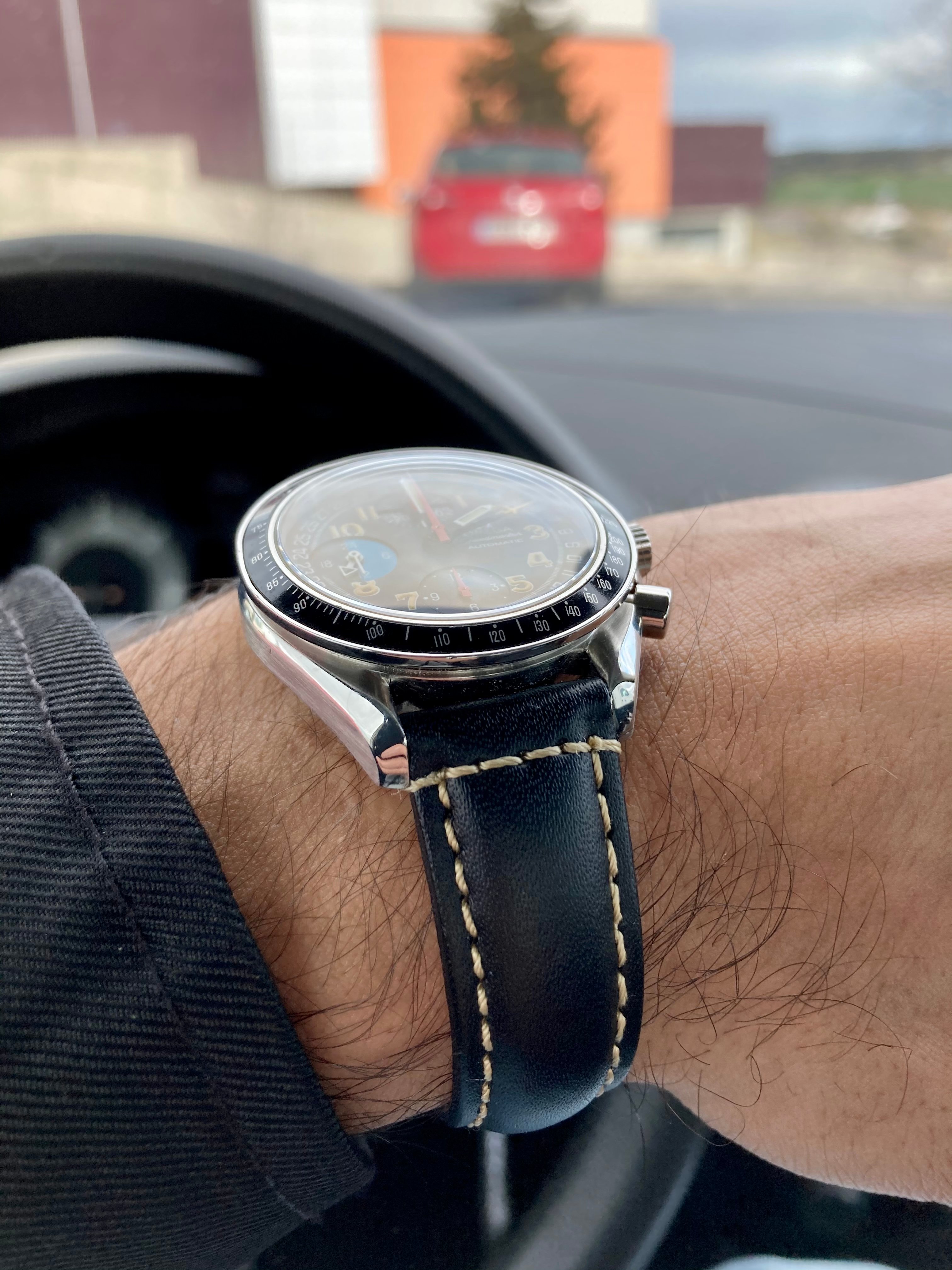

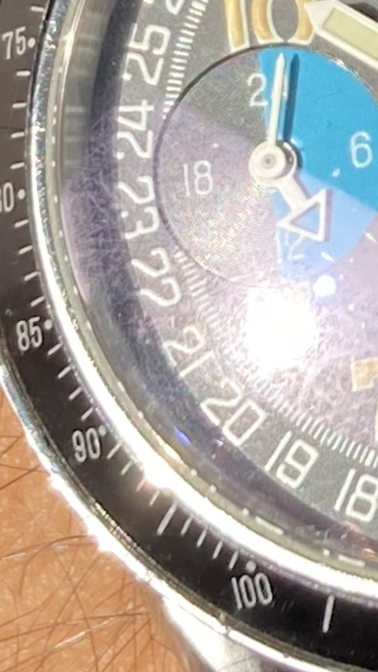

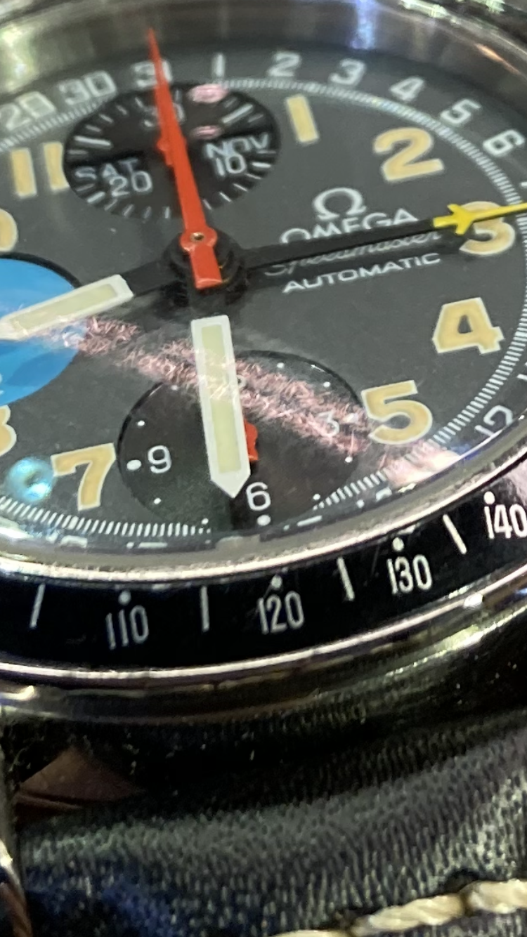

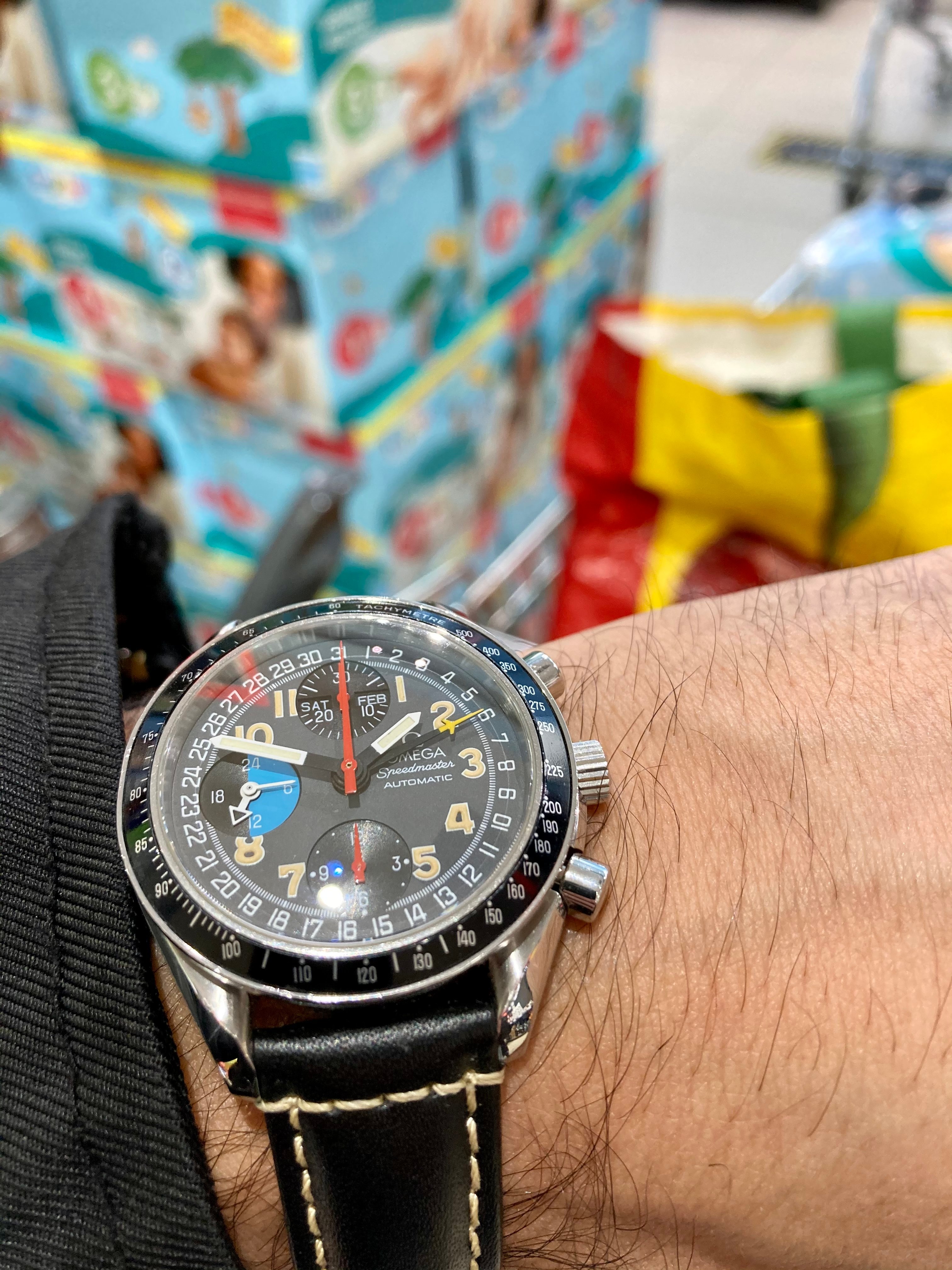

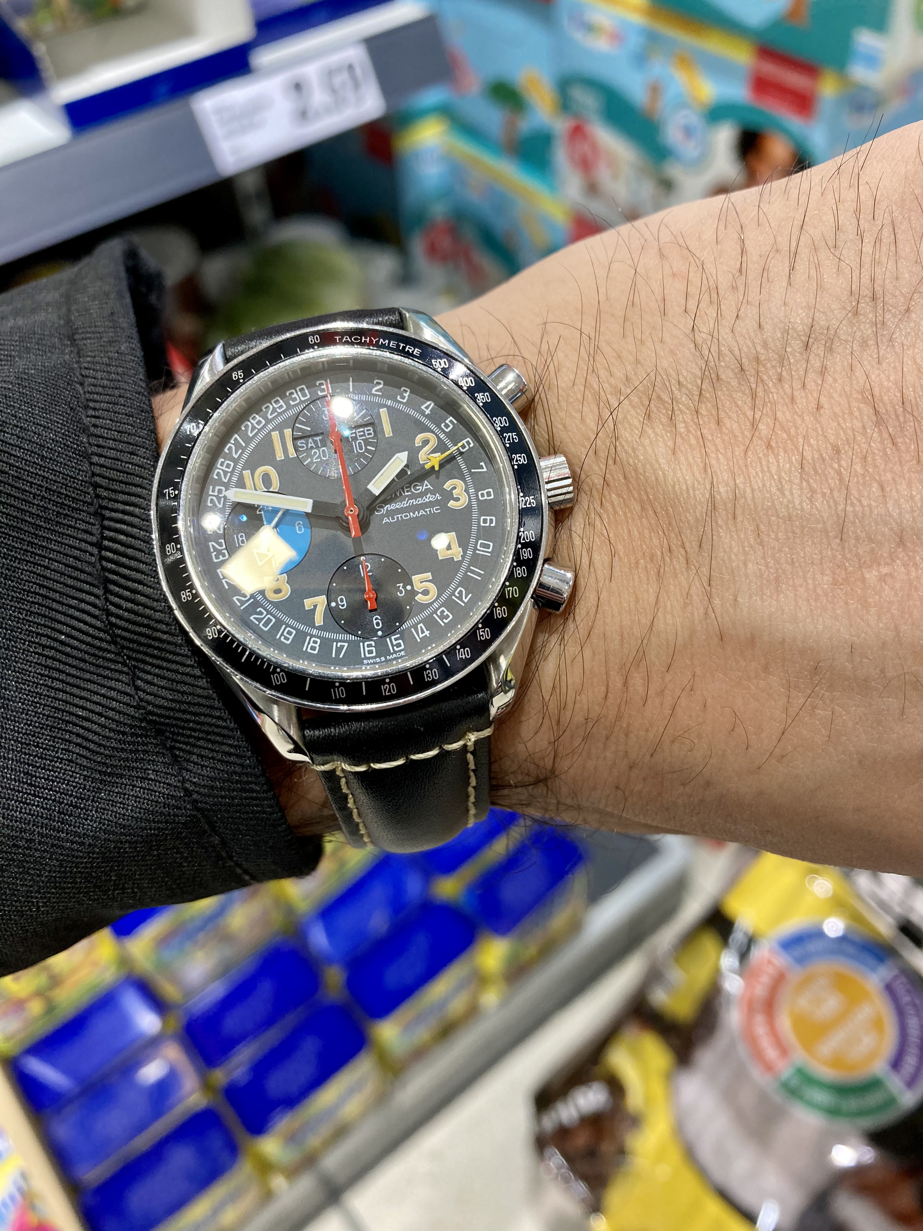

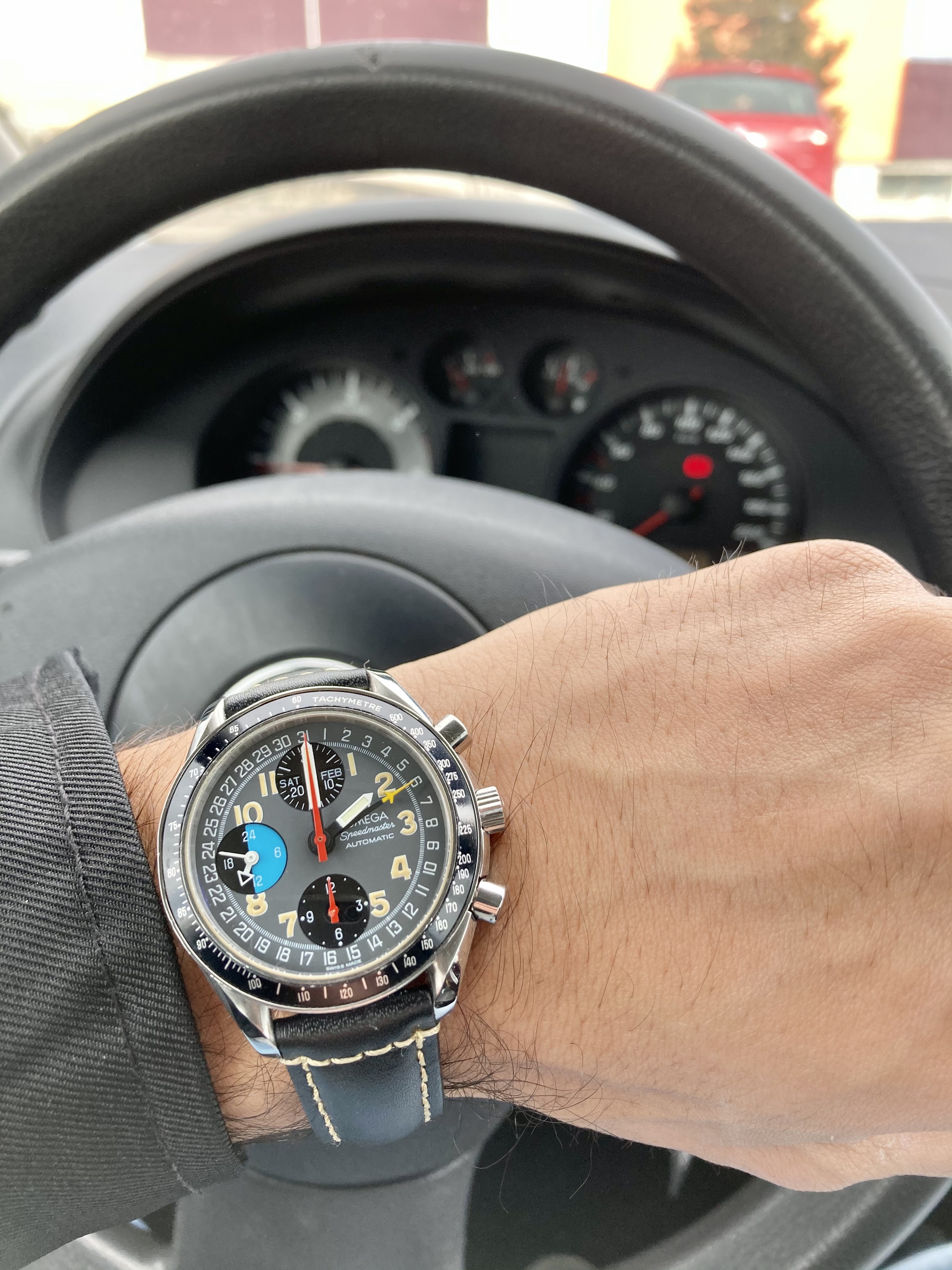

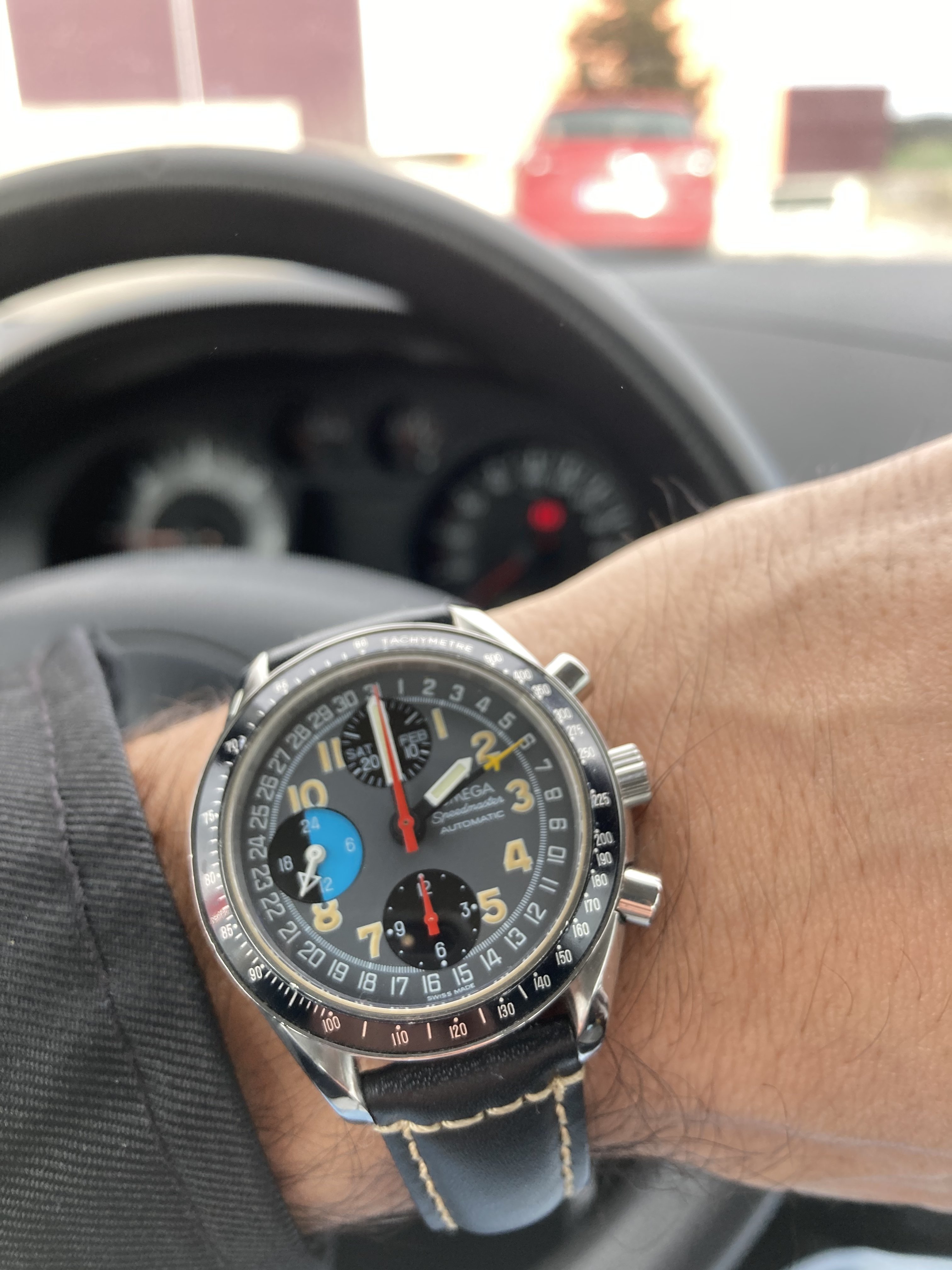

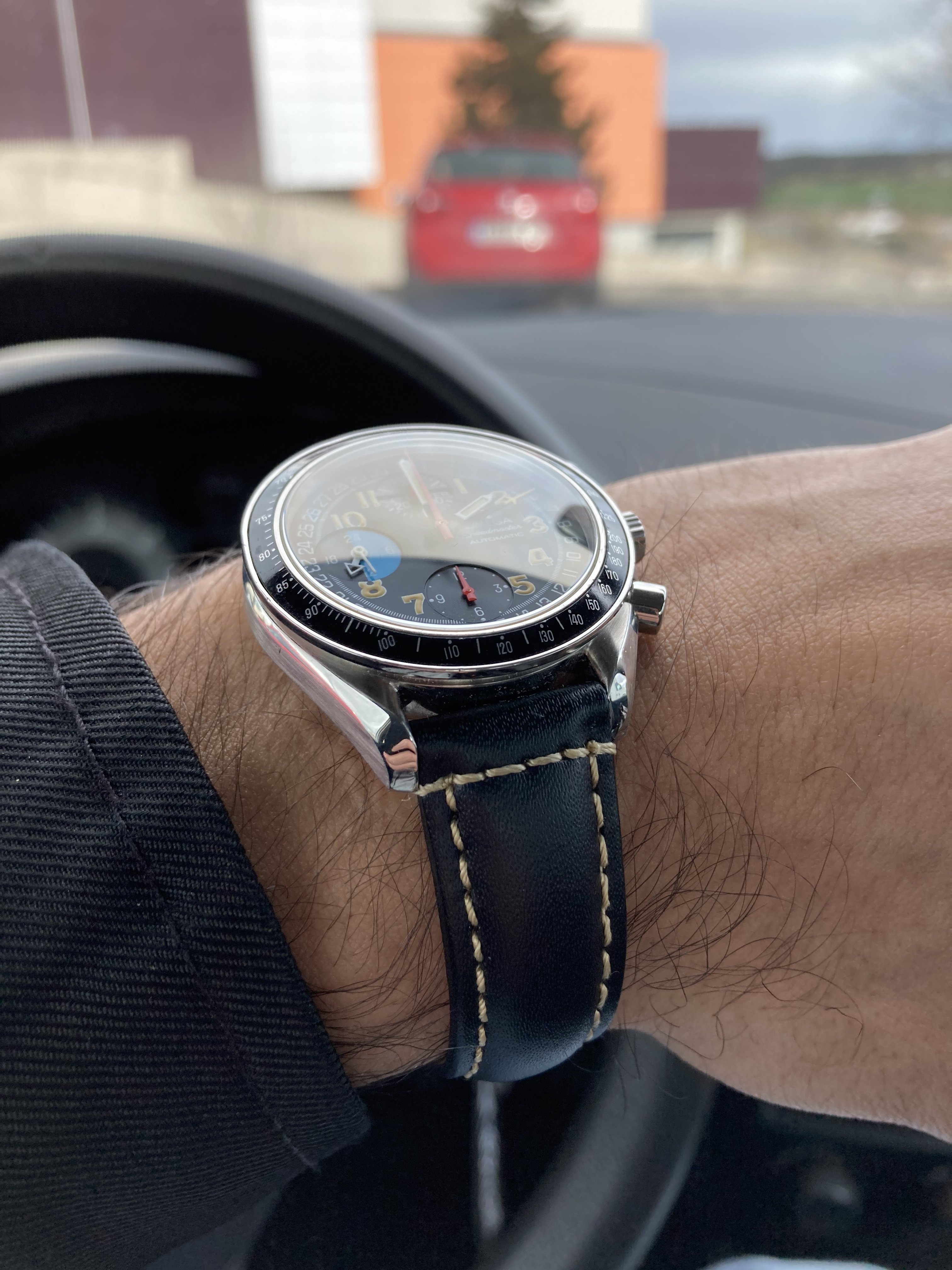

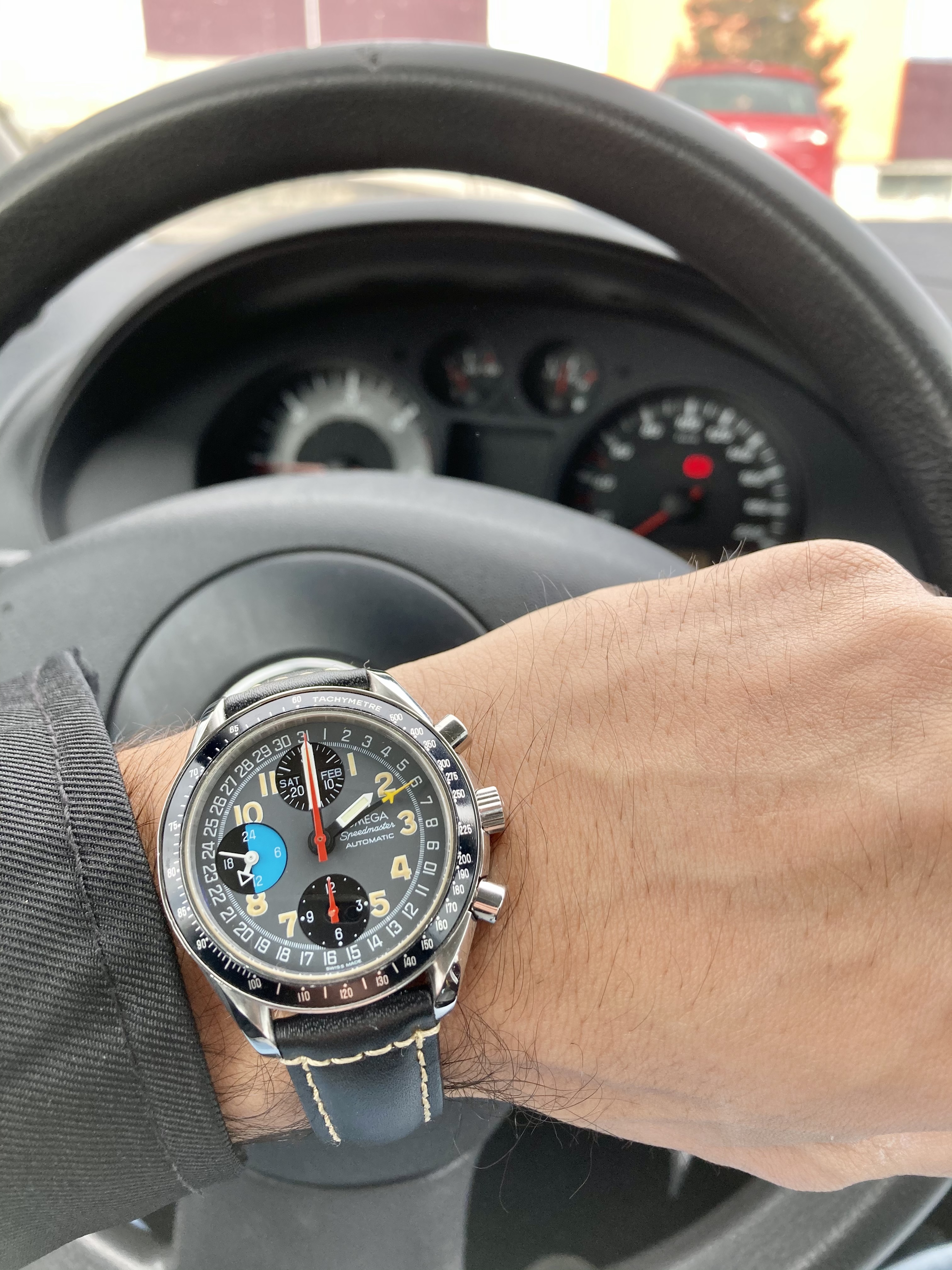

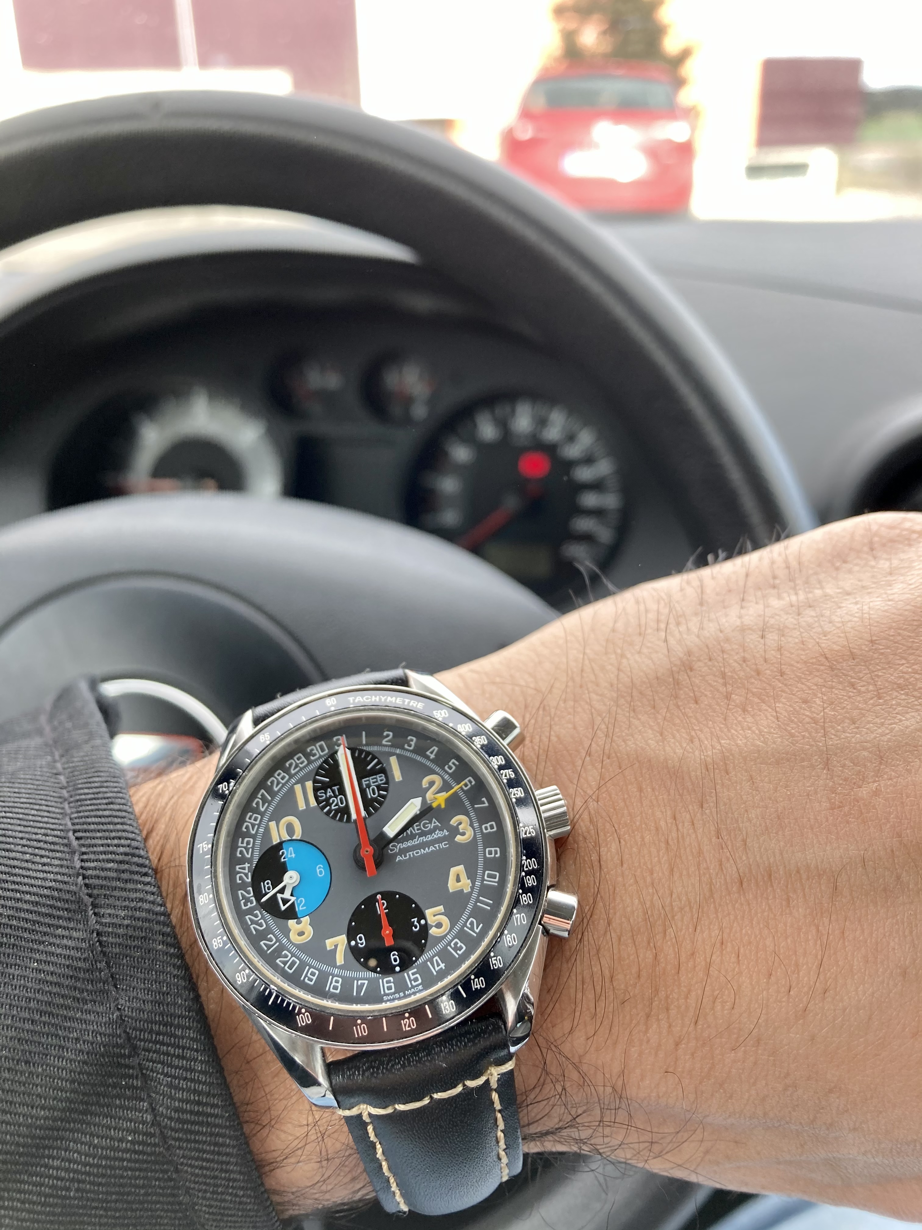

Hi everyone, I bought my first omega last week a very nice omega speedmaster day date (MK40) I love it!
However the AR coating was scratch and it was annoying me, so I took my dremel and very carefully, in low rpm, I polished the sapphire glass.
I managed to accomplish my goal, and the glass was polished and no more AR scratch, however now the reflections are getting on my nerves..I know, there is never a win win situation. 馃檨
To be honest I鈥檓 not sure what to do, if it鈥檚 just a matter of time, for me to get use to it.. or if I should buy a new sapphire glass. I looked around at the aftermarket and they are not very expensive, I鈥檓 just not sure if they come with AR coating on both sides?!
or even if there is a product, like defogging spray, that we can apply into the sapphire to mitigate the reflection.. any ideas?Any anti glare tricks ?

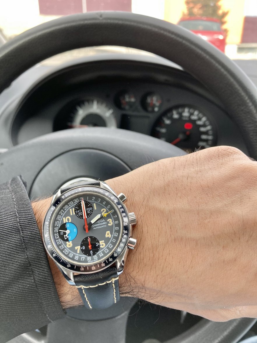

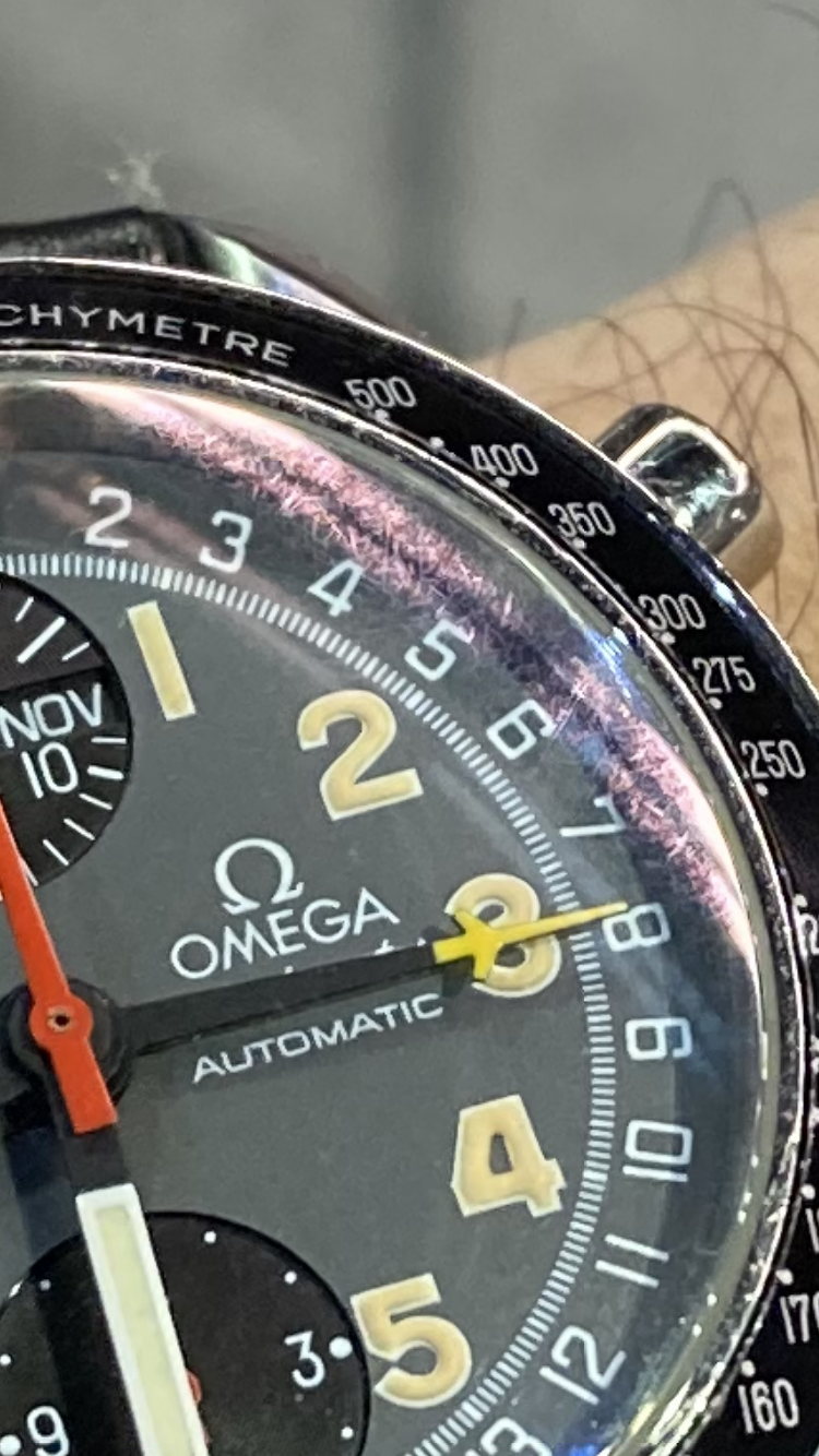

With AR:
30,276
78,129

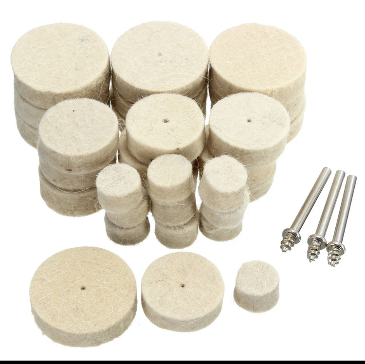

Honestly, you seem to have achieved a very hard task, so congratulations on that, I have a dremel too, I'd appreciate a photo of which head you used - and maybe a representative photo of how you masked the bezel etc.

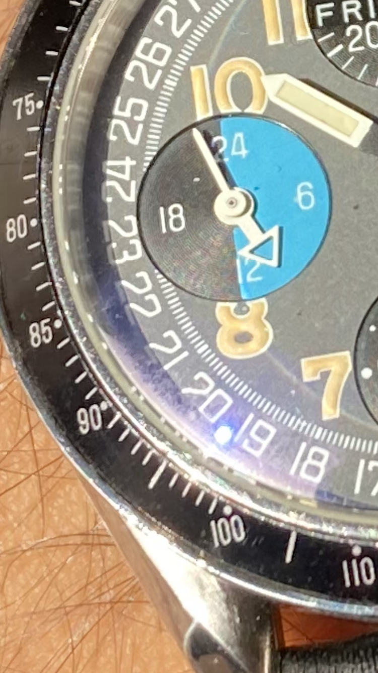

Yes there is/was 2 AR coating, I still can see the inside one.

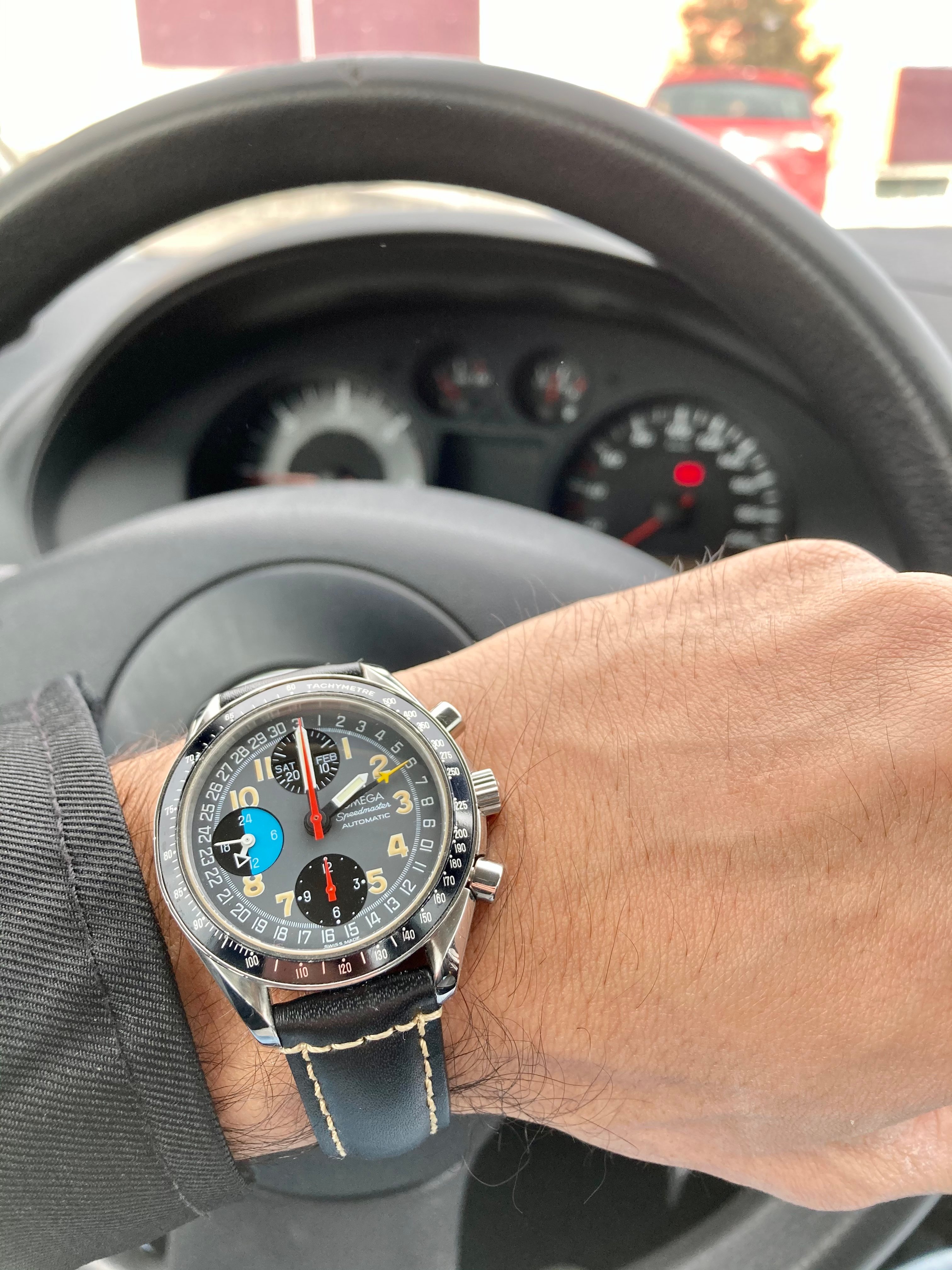

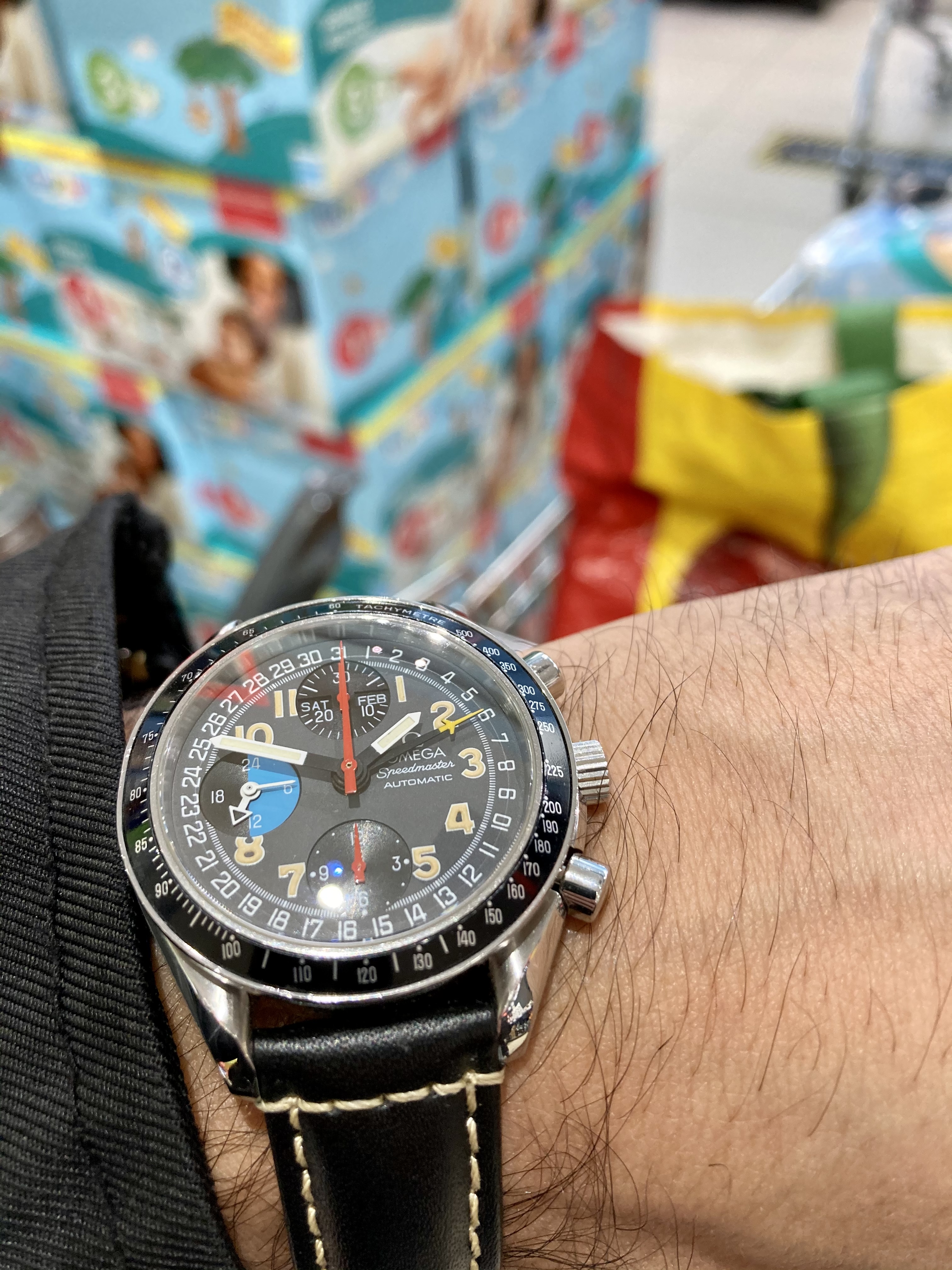

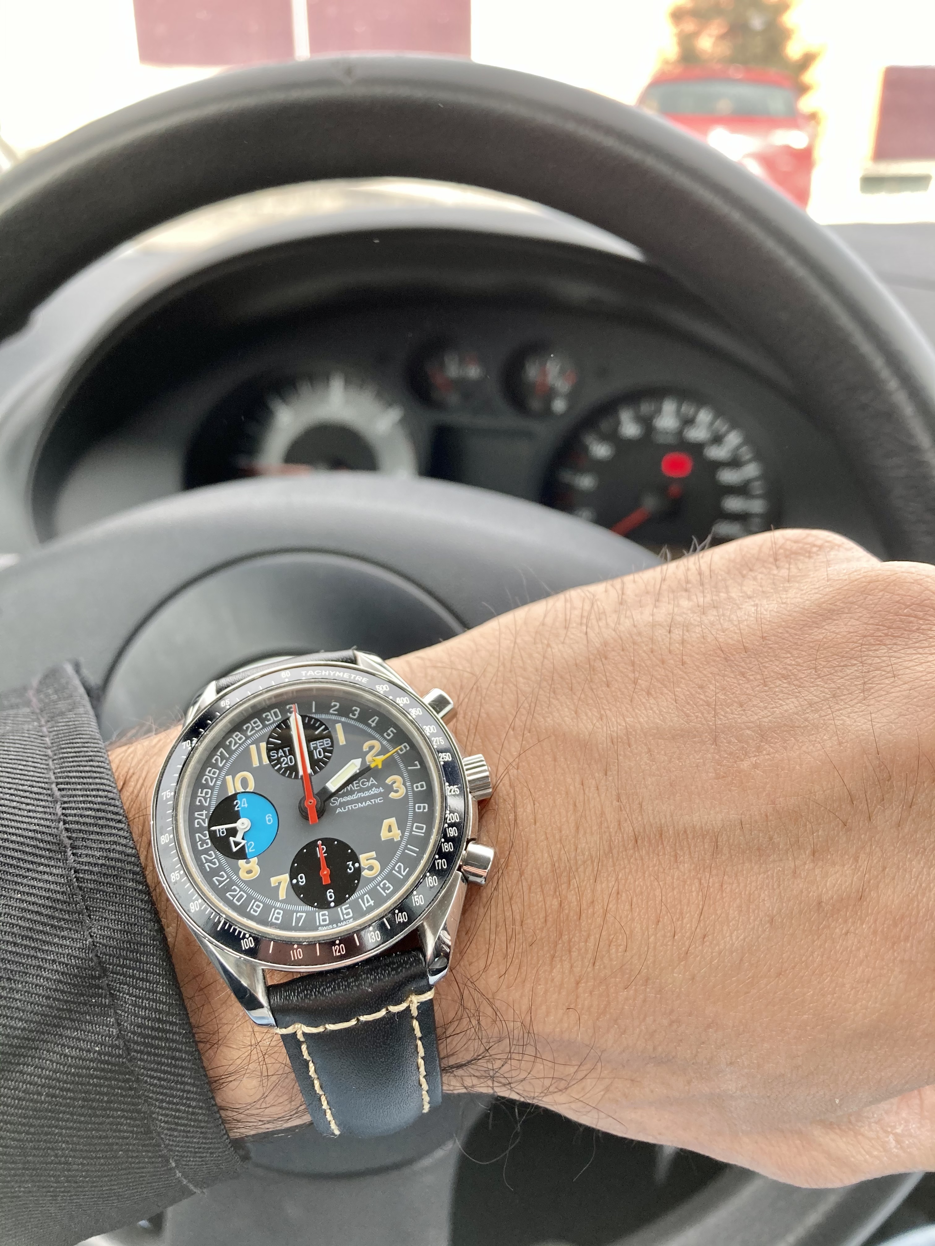

regarding the procedure that I did, I kind of followed this YouTube video:
let me know if you need me to share more details, however the video is pretty accurate. I used paper/masking tape ( lightly adhesive) to cover the watch and bezel.
41
24
I bought soft felt polish buffing wheels in AliExpress, for 2.5 euros. I used the smaller buffing with enough poly watch.
