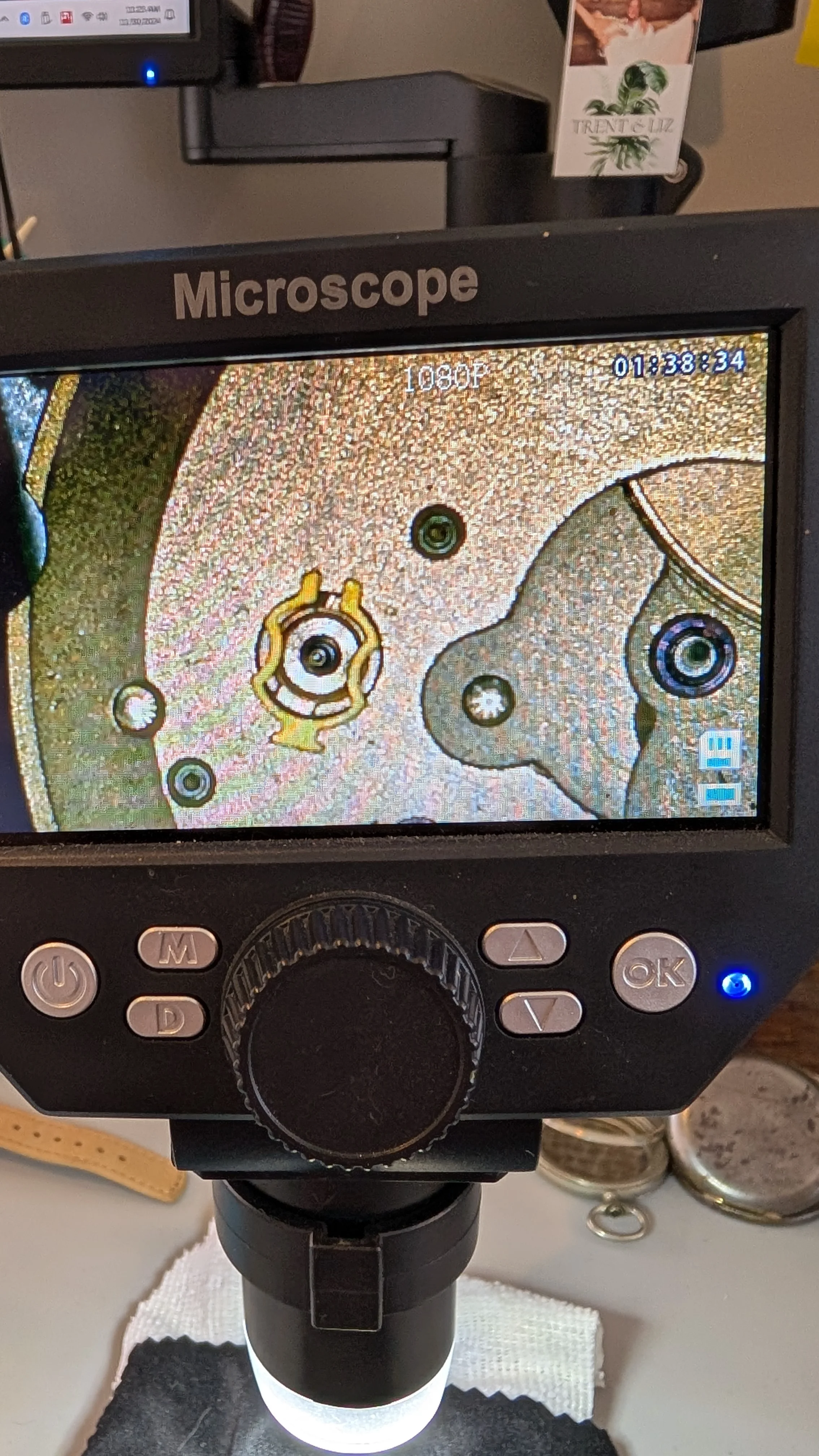

The lower balance jewel shock spring was broken and the jewel is missing. Not by me, arrived this way, which is why I think it was 30 bucks! So, good deal, also horrible deal. Does anyone have a line on the shock spring and the jewel? Part number or one laying around i can purchase?
I ordered these:
https://www.ebay.com/itm/374501445884
But they are too big, but look exactly like what I needed. So, I've spent hours googling and cannot seem to come up with a part number for this very tiny watch. Th jewel I ordered is also too big! Its an 18mm watch I was fixing up for my missus.
If you need pictures I'll post, but it's just going to be an empty spot!

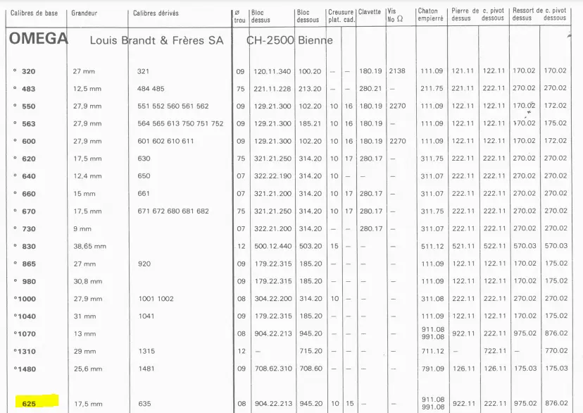

The incabloc springs are pretty standard.
I have re-posted the charts here a few times. This recent post comes up when I search 'incabloc chart'
https://omegaforums.net/threads/los...stone-are-these-standard.178390/#post-2420230
Sometimes it is worth getting junk assortments of non name watches just for the shock absorbers.
Otto Frei sells assortments of 'practice' incabloc settings. Which is probably your best bet. No one wants to go through the old material and sort it. Other material houses have similar things.
Another option is the Bestfit catalogs and cross reference guides. These can be bit tricky to find, since the copyrights were clawed back by one of the material houses in further efforts to stifle competition and restrict trade.
This is also were we mourn sites like ranfft. I grabbed what I could from archive.org. There is a successor site, which was done by someone who wanted to pin down some website design experience. Sadly they are not watchmakers and the database is hard to navigate.

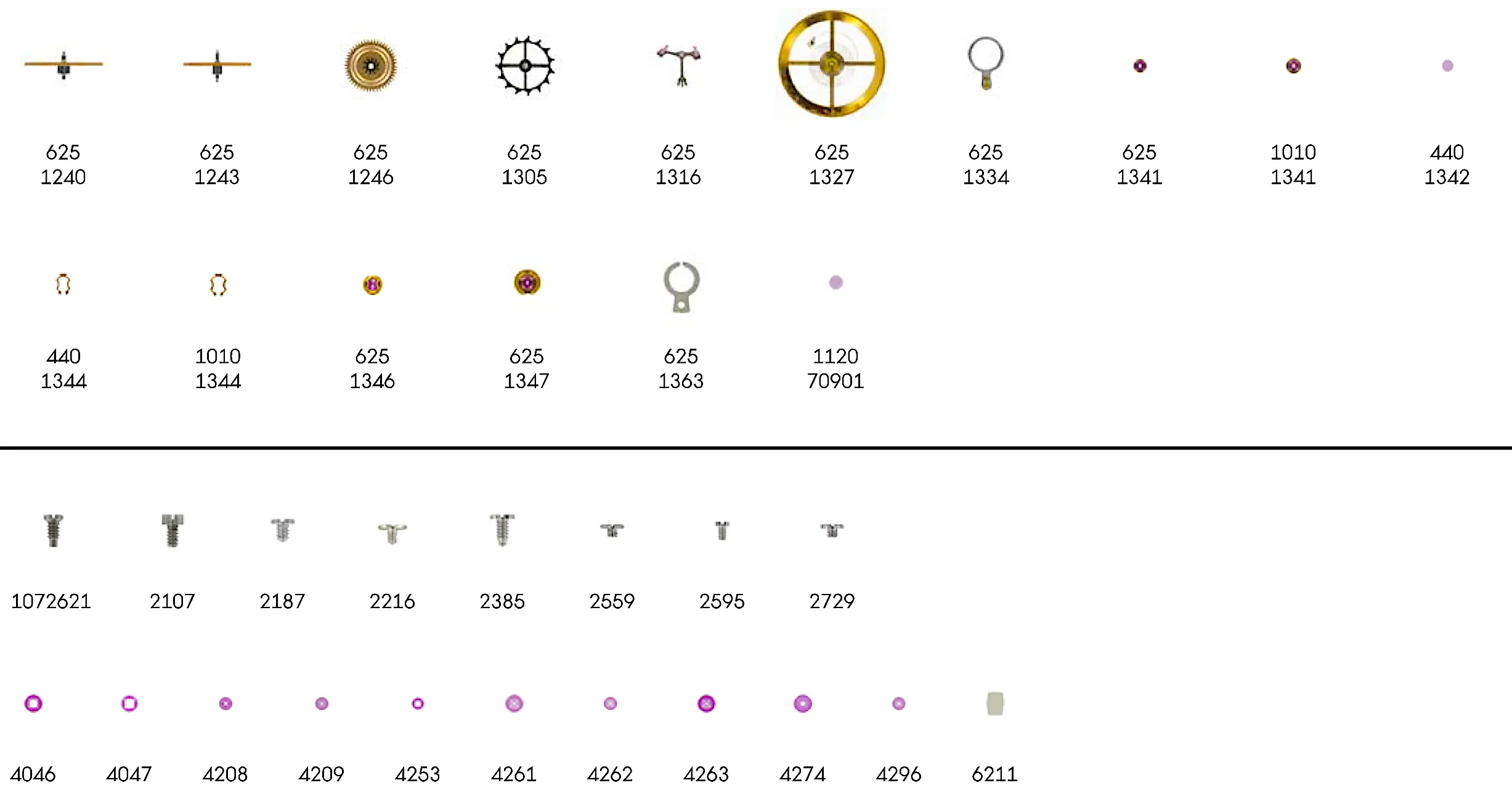

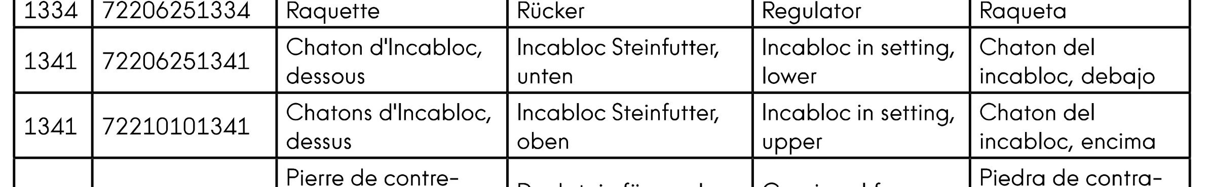

The upper and lower seem to be different sizes on the 625. I tend to work more with the 620 and some times get them mixed up.
@JimInOz chart above says the lower shock is from a ca440. I think this is the common oval ladies movement. The upper one is listed as a 1010 base caliber, which is one of the cost saving notaquartz movements from the same era.

Sorry for the delay, Life took over. Yes I agree that this was difficult to research and I appreciate you guys tapping into your knowledge. I'm still learning and compiling all the sites you guys have and use. I appreciate you guys very much! I'm going to research the Lower Shock ca440 to get this part replaced. Then I have to practice installing it! I'll update you guys, and thank you again.
*edit @JimInOz nailed it! 15 dollars to find a single replacement, but I have the link now! It's on order and I hope i'll be able to install it! Thank you!!
