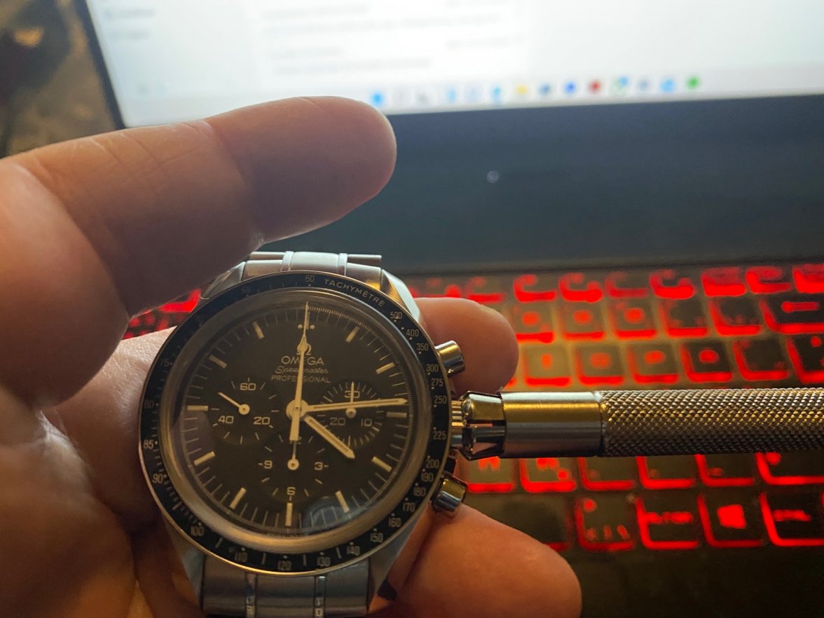

I hav bougth this to help wind my 1863 SS Speedy. Since I have arthrities in the finger I use to wind. They come in different sizes, but I can totally see it leaving marks if your uncareful.
Winds like a charm. But I think the larges Bergeon makes is 5-7mm and I hear the new speedys has a sightly bigger crown than the 1863 movement speedmasters.
