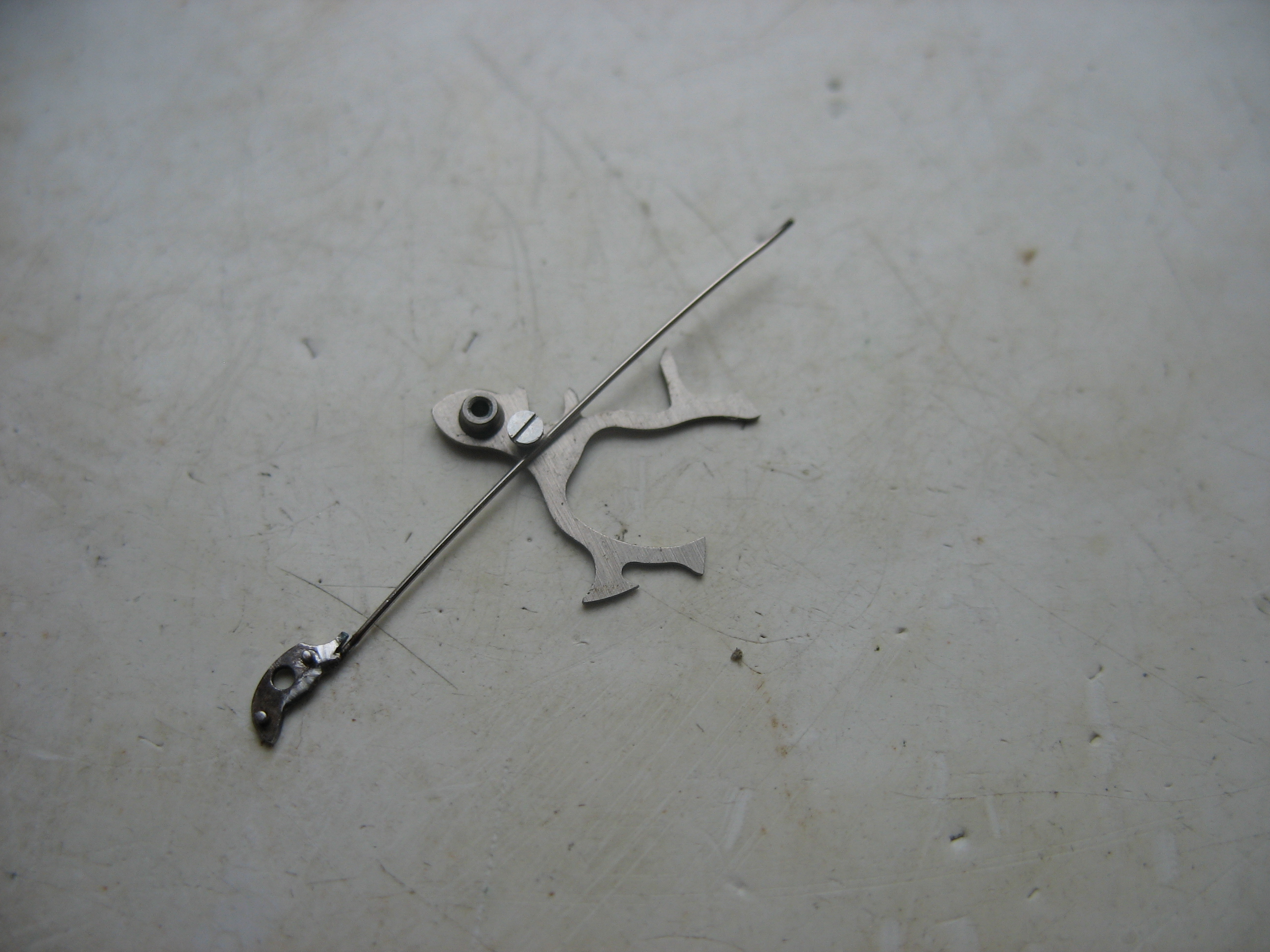

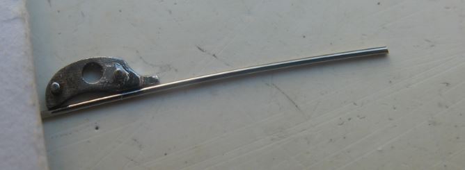

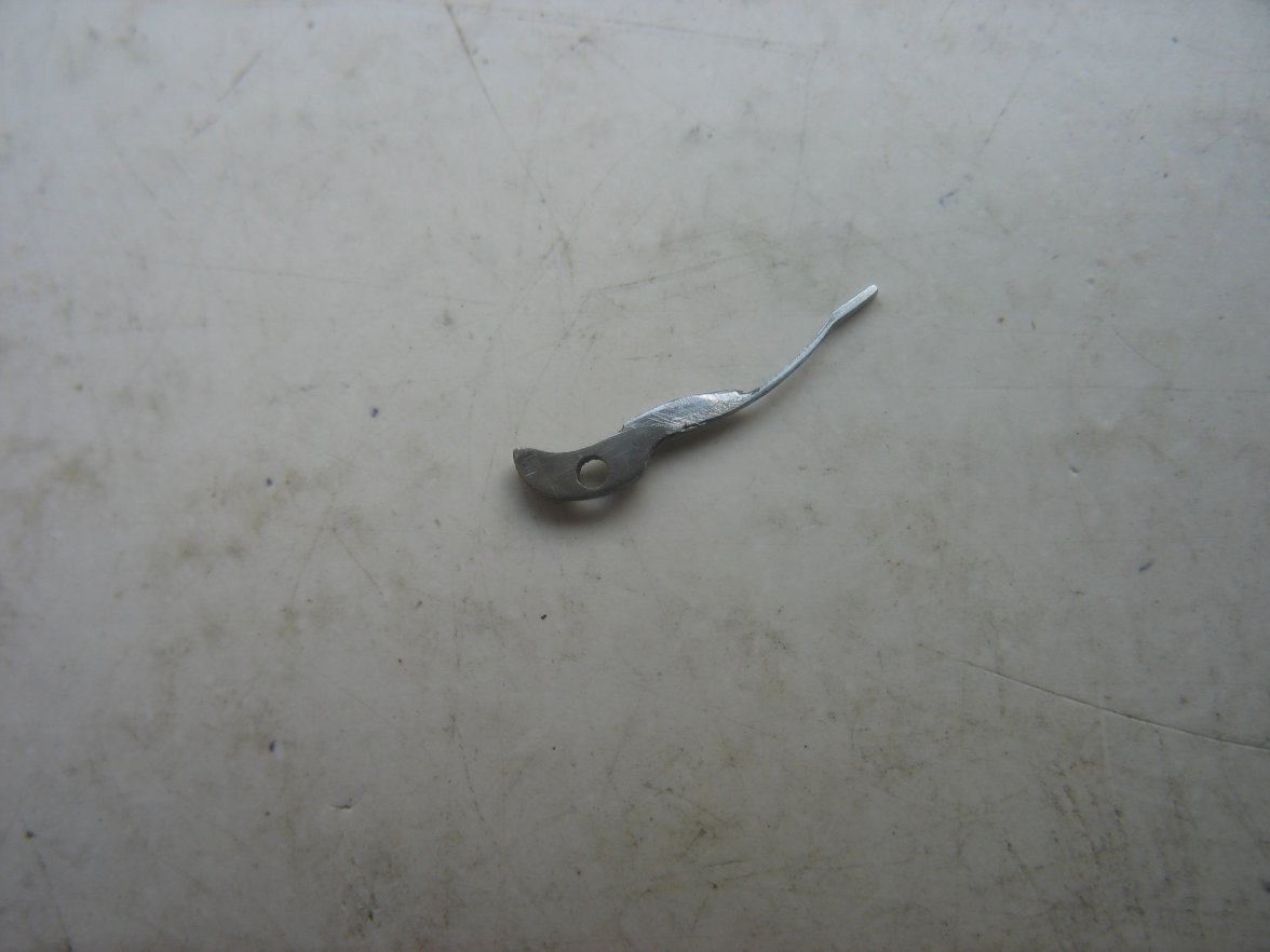

Well....maybe I've got the solution for those who don't have access to original Omega parts....and especially the famous 320.1734 hammer spring. Which is quite impossible to find in the free market.
My watchguy his nephew works at a dental lab and he was asked if he could recreate/repair my broken spring.
Well; as we speak I just got my Speedy back home and he fixed it! De reset function works again. The guy took the broken hammer spring and laser welded a spring onto the broken part. Initially the hammer spring was soldered earlier but at the first test it brike down immediately. The laser welded part works....so far. We have to wait and see what the future brings

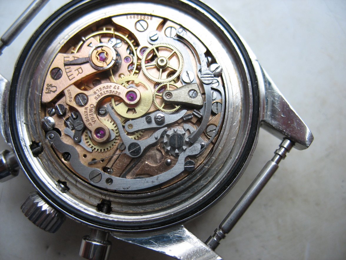

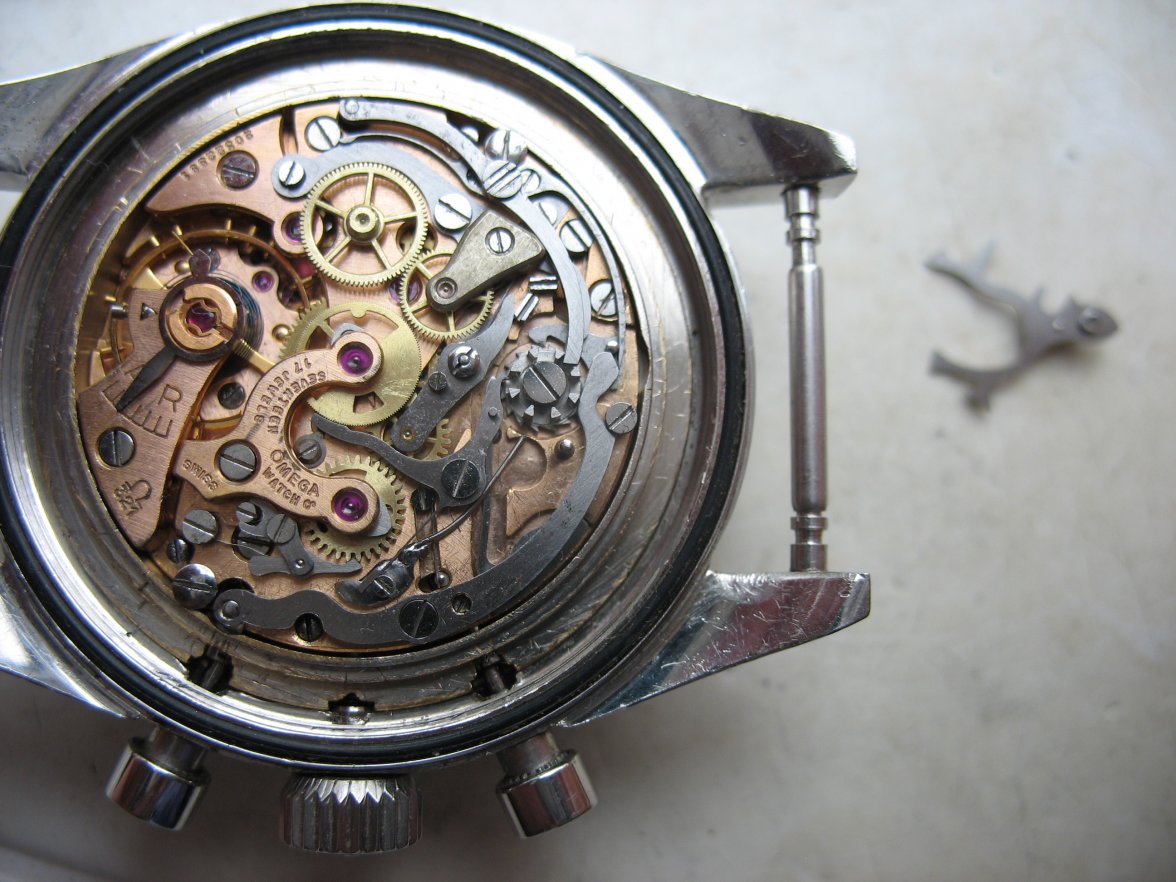

I show you some pictures so you can see the hammer spring as it looks now.
Let's say my beloved EW '63 had quite some surgery and is very happy with this "bypass" or "drain".

Creative, and resourceful, but I would enjoy hearing what our resident watchmakers have to say about it.
29,224
75,515
Not pretty would be an understatement, but if it works and you can't find an original, I guess "it is what it is" as the saying goes...
I don't own the watch, but if I did this would be a temporary fix until I found the correct part.

That's what is Archer. Hopefully it holds until I find a spare hammer spring.

The old lady has returned today and working well. And yes; the "ugly" solution works fine. That beeing said....I absolutely feel no difference with an original hammer spring as I push the reset pusher. And in the meantime I will continue the search for the original part of course 😀
