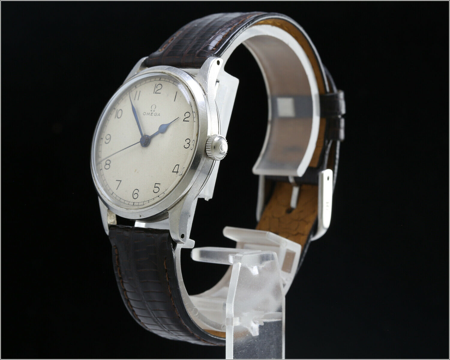

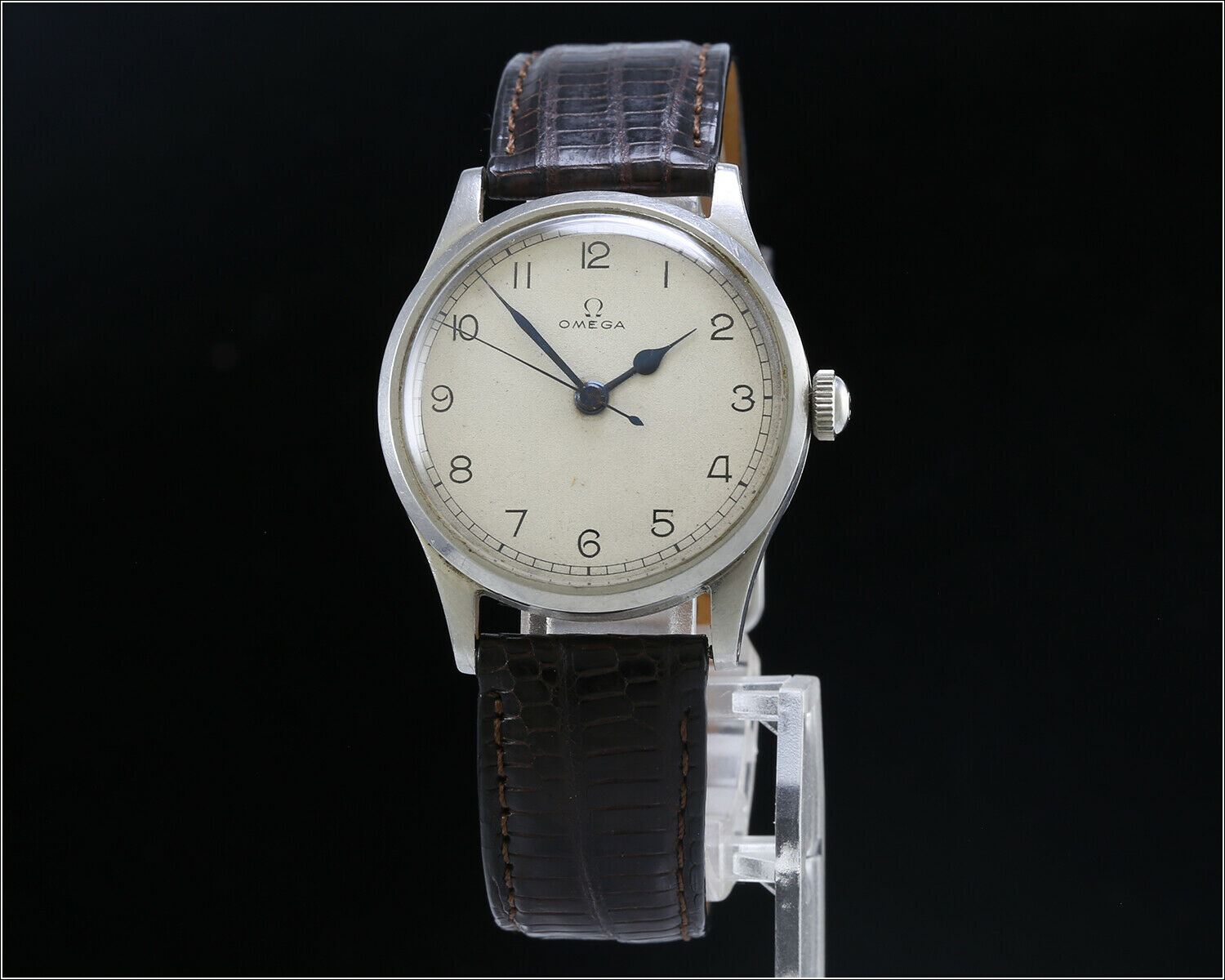

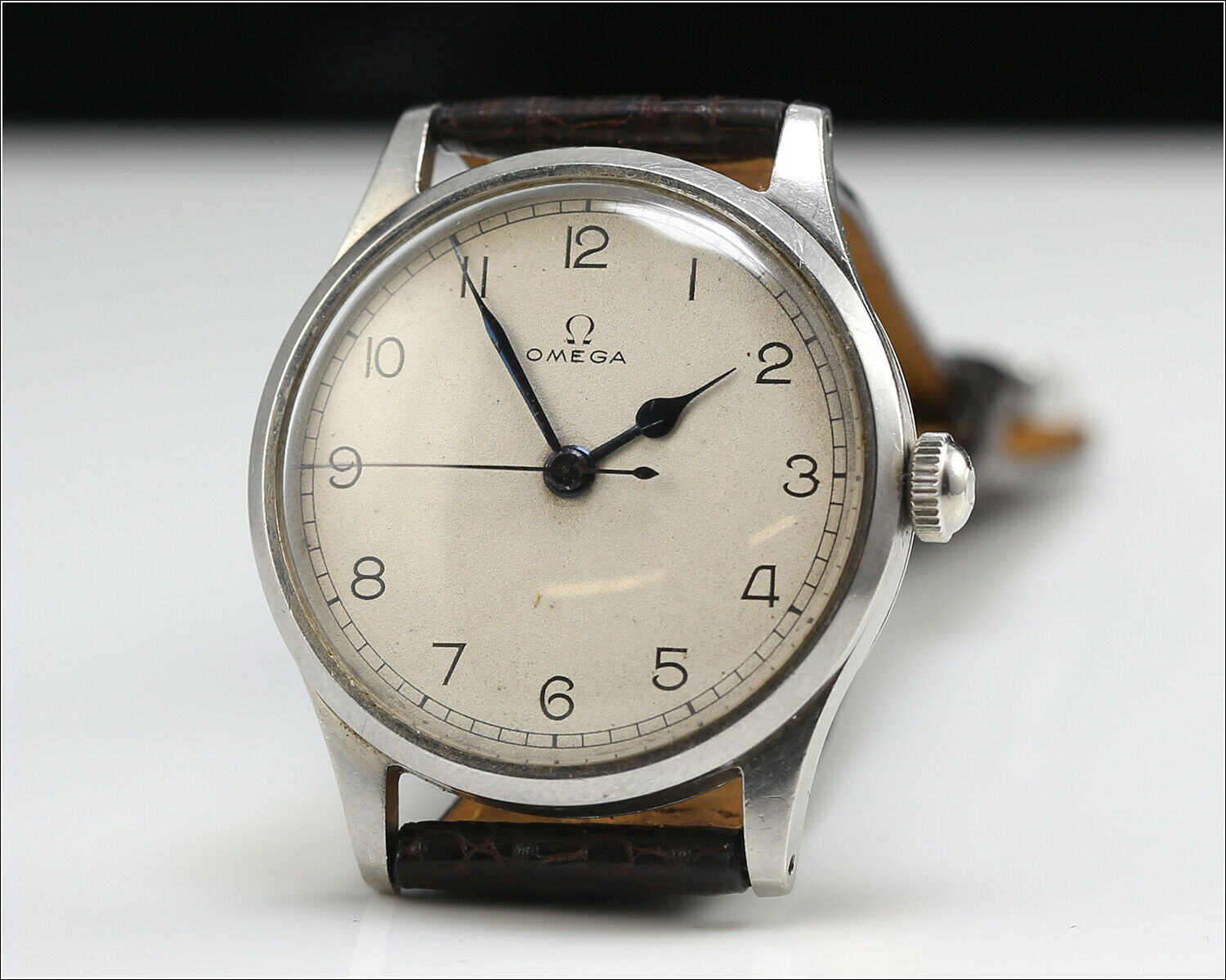

Hey OF,
I have an opportunity to purchase this watch.... well, to be realistic, I've already purchased it 馃槈. What do you guys think? I consider myself a pretty proficient "fisher," but, I'd like some input from you guys. I don't know why, but I have a funny feeling about this piece being a franken. Maybe not, but that's why you fine people are here! Let me know if I made a dumb decision. Don't worry, I have thick skin.
Thanks!
5,727
9,512

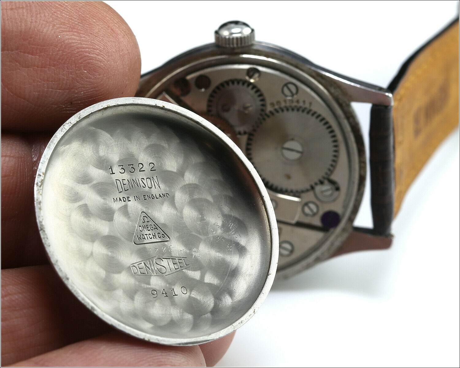

Why do you ask ? Civil omega. Looks nice. Mvmt. from around 1943 . Recased in a civil Dennison steel case. Do you see any problems? Let us know. Kind regards. Achim
I don't necessarily see many problems, I guess some of the inconsistencies of the dial markers had me nervous. However, I also think this may be just the age of the watch and part of the "patina." 馃槈
Thanks for your info.

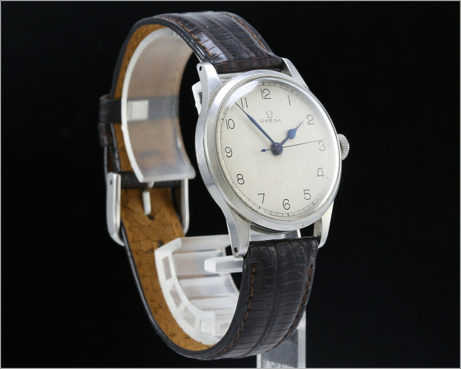

Looks quite honest to me at first glance.
That's what I like to hear. Good deal, thank you.

If you ask about a value, max. $600 unserviced, my guess.
I'm at $700, so slightly over. Not too concerned about it because this will be a daily for me.

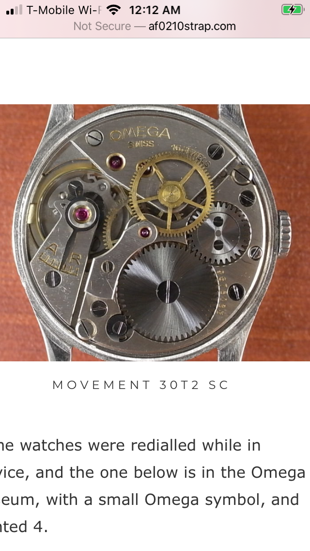

32
8

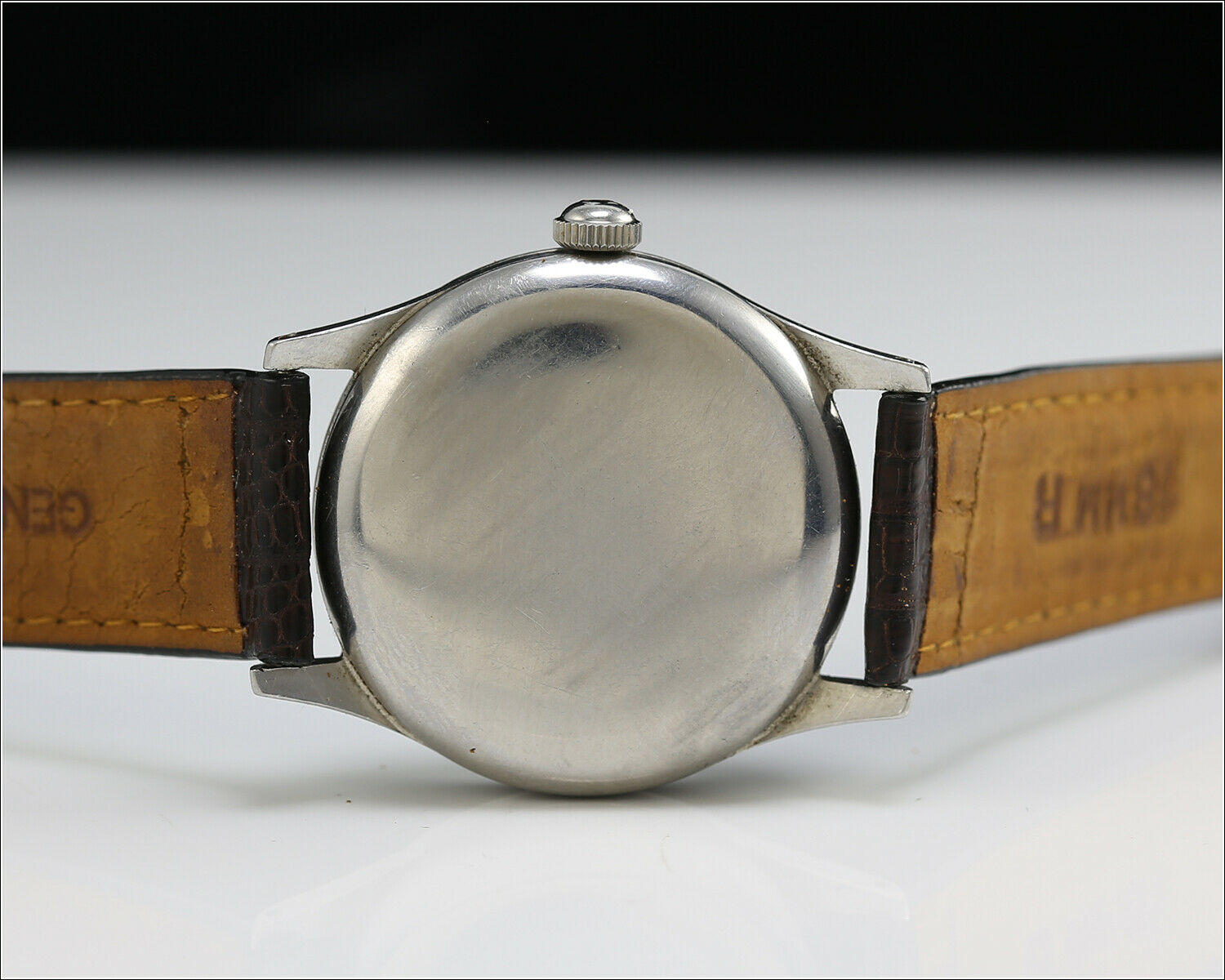

Movement case screws are incorrect

According to this Forum signed crowns began later-after SC and 11,7 serial.

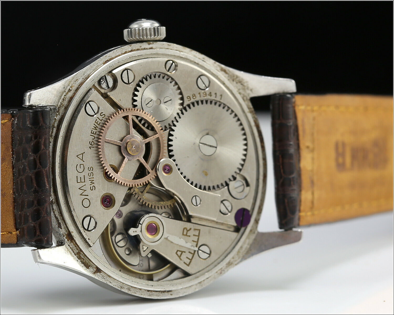

Sorry, may be a sensor issue but what is the purple area?
Probably like the hands are, a blued screw.
Blued screw? In 1943?
Achim-possible?
Nonetheless, very attractive watch!
Achim-possible?
These are the case screws thats needed. Flat with tapered edges
Achim-possible?
Looks like a replacement, and yes, the technology of blueing was well known in the 40麓s.
An example with the screws as noted above and crown.

Sorry, attribution as noted above picture.
Sorry, I think I鈥檓 misunderstanding you鈥攕o both the case screws and crown are incorrect? Also, from my research I鈥檝e seen lots of 30 T2 SC mvmts w/ the blued screw; in bed currently but will link in the morning.

So, we talk about buying/not buying / liking/not liking a watch, because 2 case screws a' $ 5 should be replaced? What happened to reality? Kind regards. Achim
