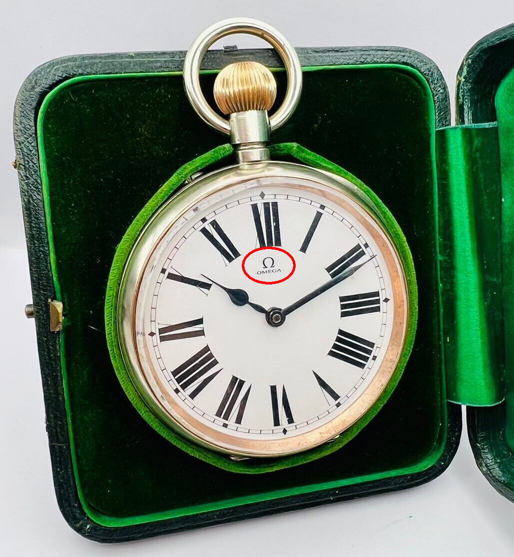

This post is offered for those who are interested in the old ‘Goliath’ pocket watches - a bit big for the typical pocket, but at least for display.
An eBay seller named watchcollector83, who gives his location as Lviv Ukraine, is offering a watch which he describes as being an ‘Antique Omega 8 days Goliath Pocket Watch’:
https://www.ebay.com/sch/i.html?_fr...e+Omega+8+days+Goliath+Pocket+Watch.&_sacat=0

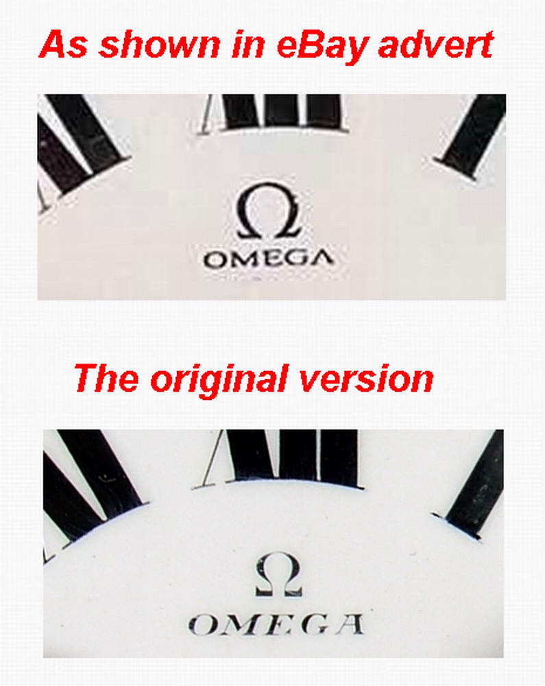

The watch shown is an Omega 30’’’ which will date 1906. The seller shows a catalogue extract (which has been copied from a different eBay seller in UK called sixpips1 - a shame he doesn’t give credit, so I’ll do it for him).
Only the very late Omega 30’’’ Goliaths were signed ‘OMEGA’ on the dial - and furthermore with a different font. The Omega on this dial has been added ‘aftermarket’. I am not accusing the seller of this addition - he may not even be aware of this - but it will not be original.

It could be worth a gamble if it's only ink, and not fired on, easy to return to original.
But then again, it could be a paper dial, who knows?
572
1,461
It’ll be an enamel dial and the OMEGA could be removed with some spirit - easily returning it to original. My post was merely to inform those who might be ‘taken in’!
