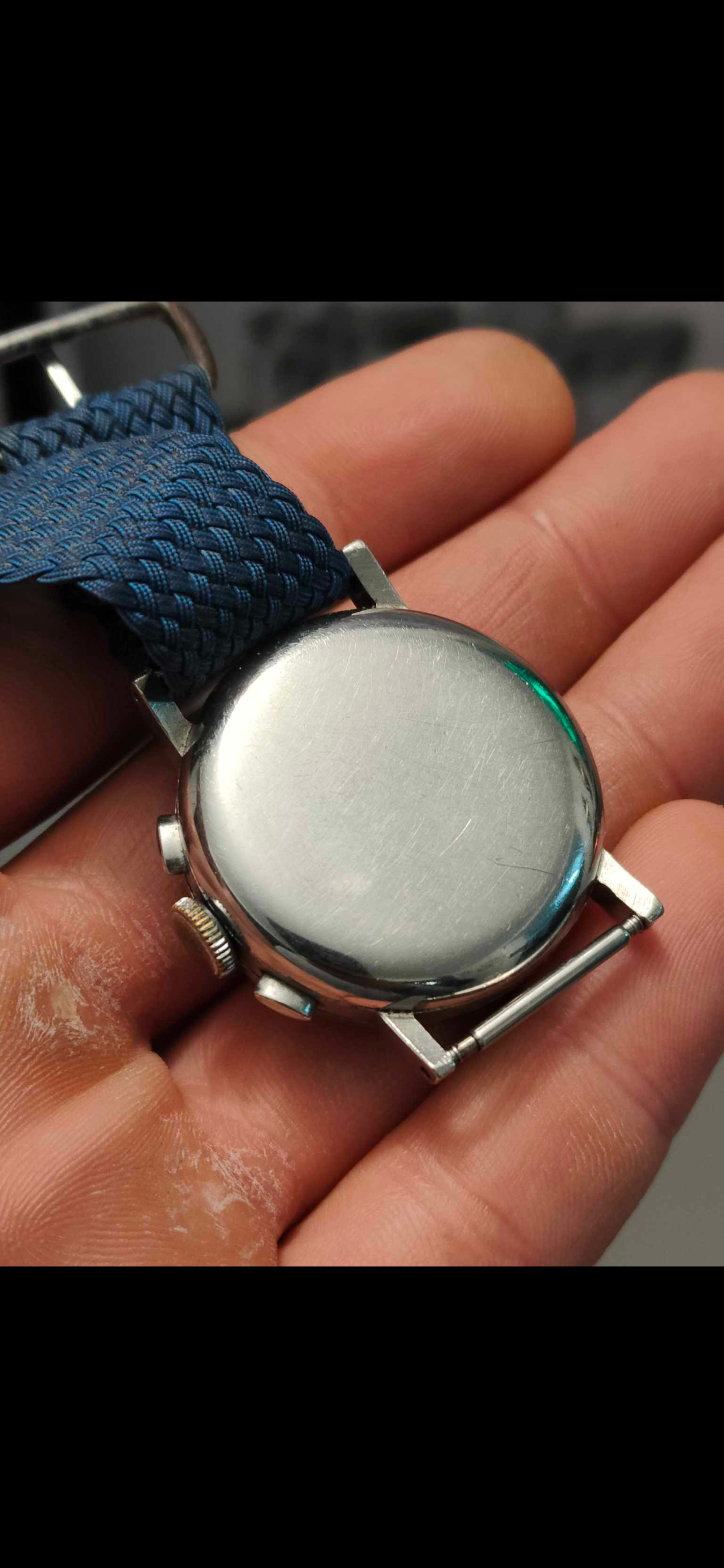

Omega 28.9 CHRO T2 identification and dial
7

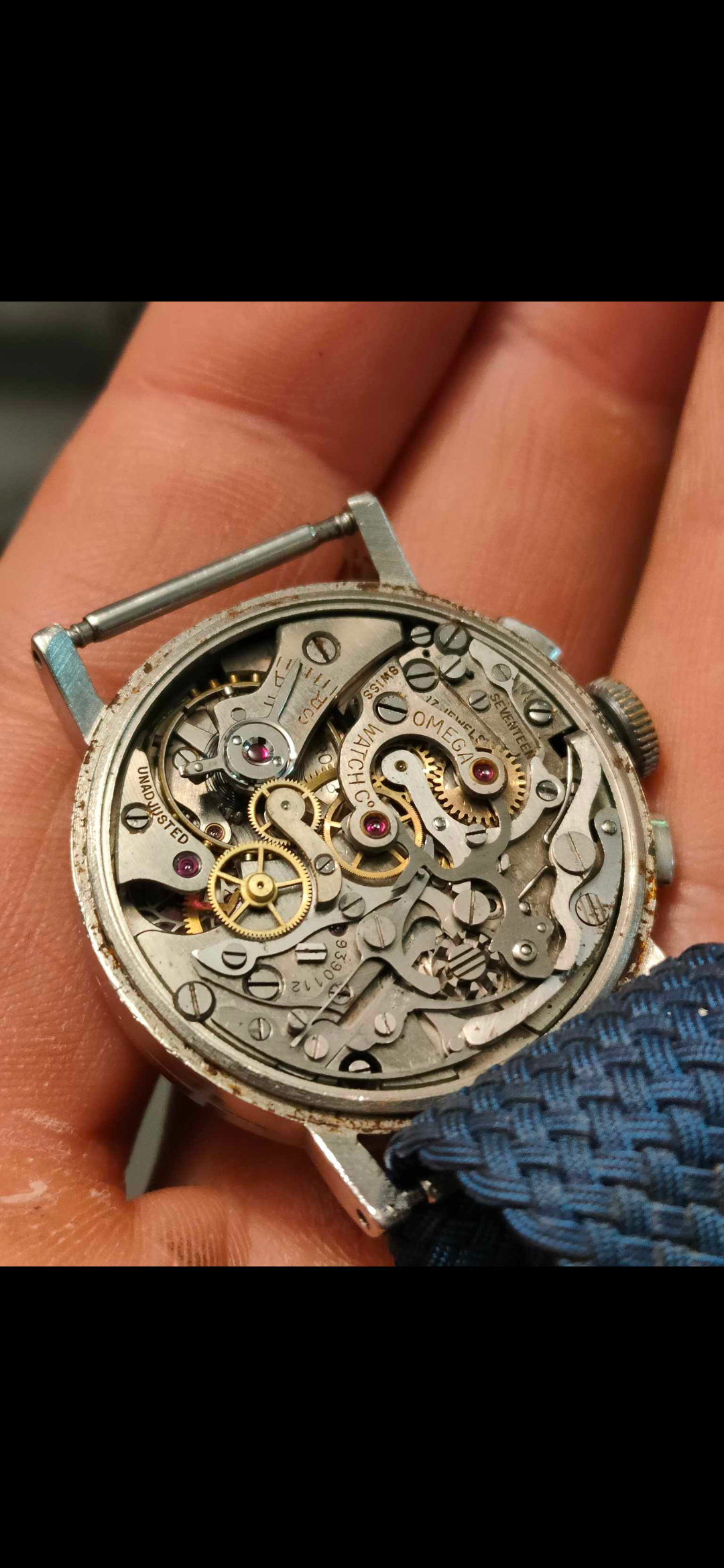

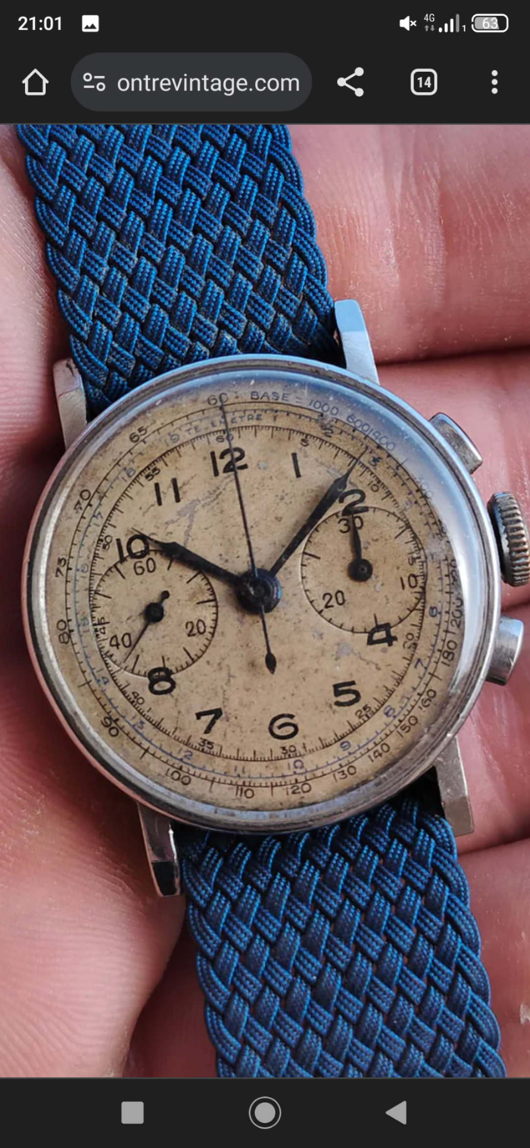

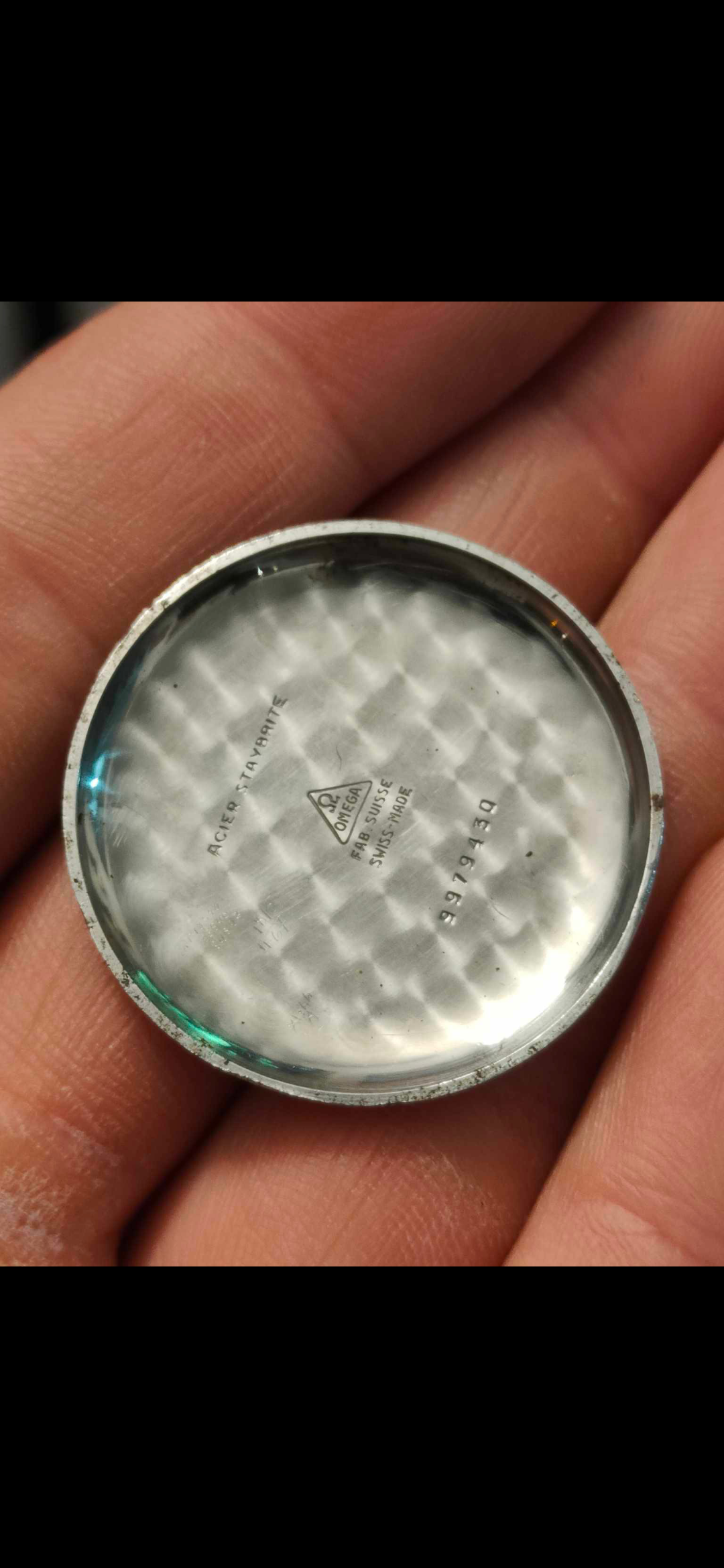

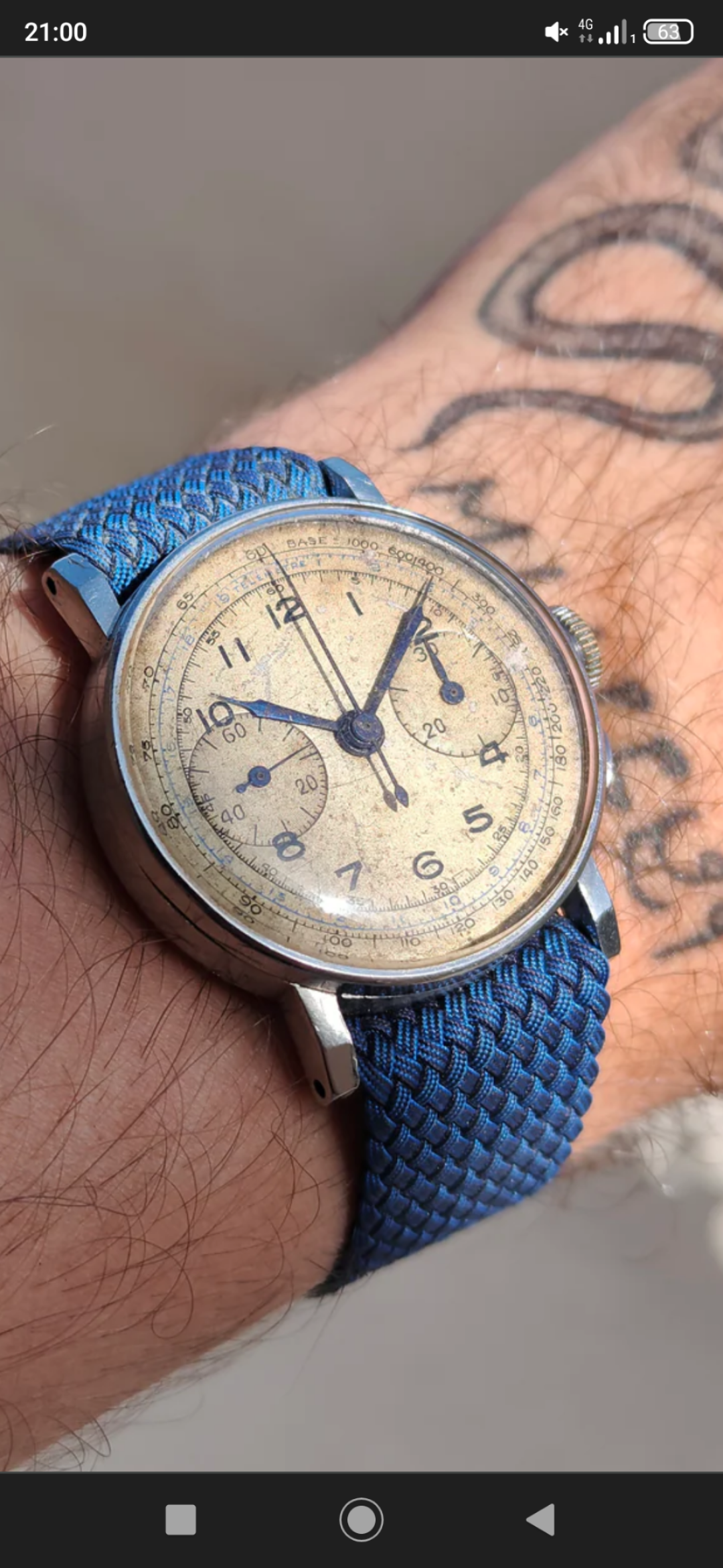

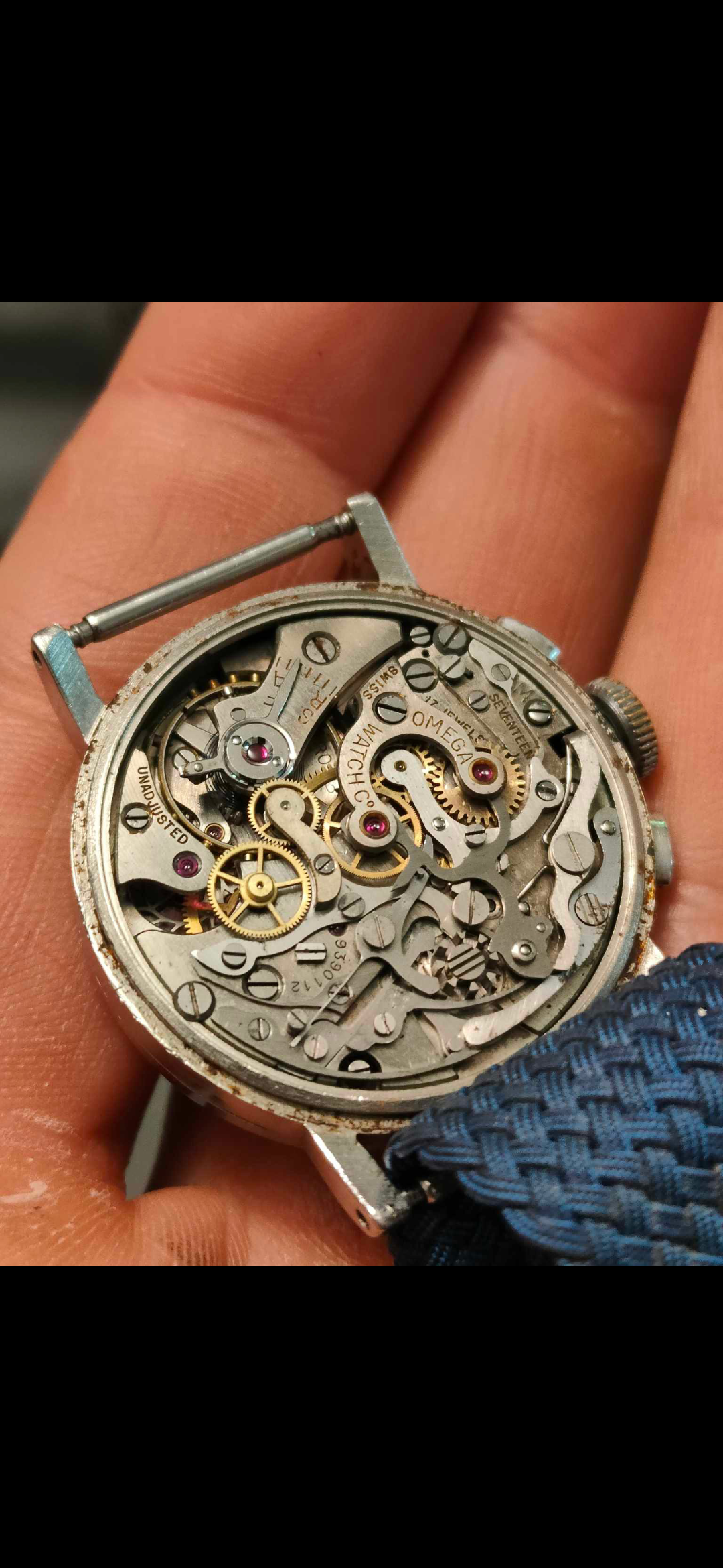

Hello there
I need help from Omega's lovers !

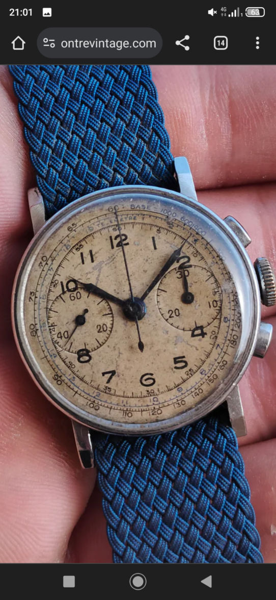

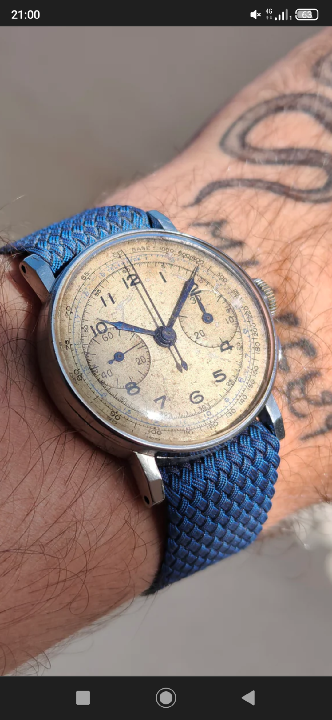

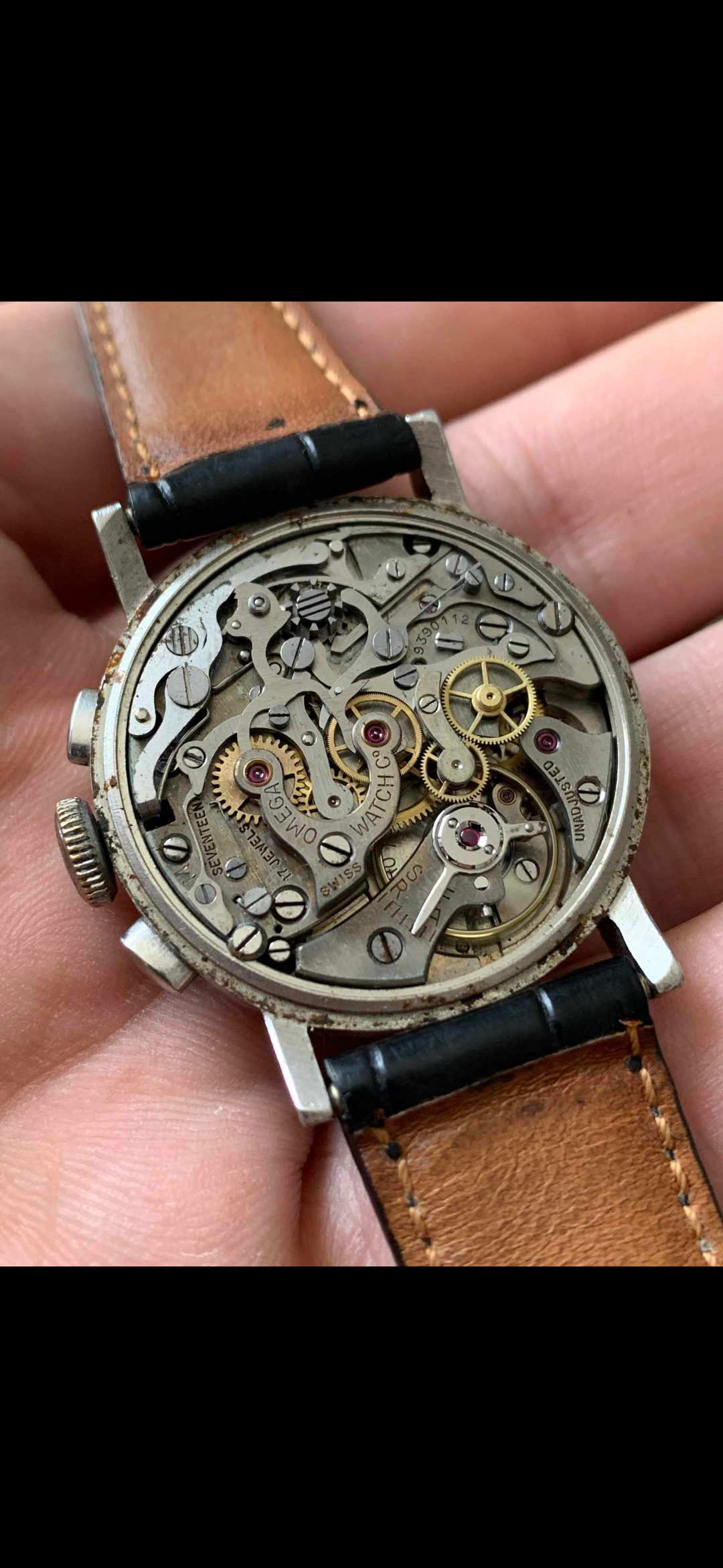

I recently buy an Omega chronograph, and i think IS a 28.9 CHRO T2.
But the dial IS passed...
So, what do you think about the watch and the dial ? Is it ok ?
And where Can i find a dial for it ?
Thank you for your advices,
Lucas

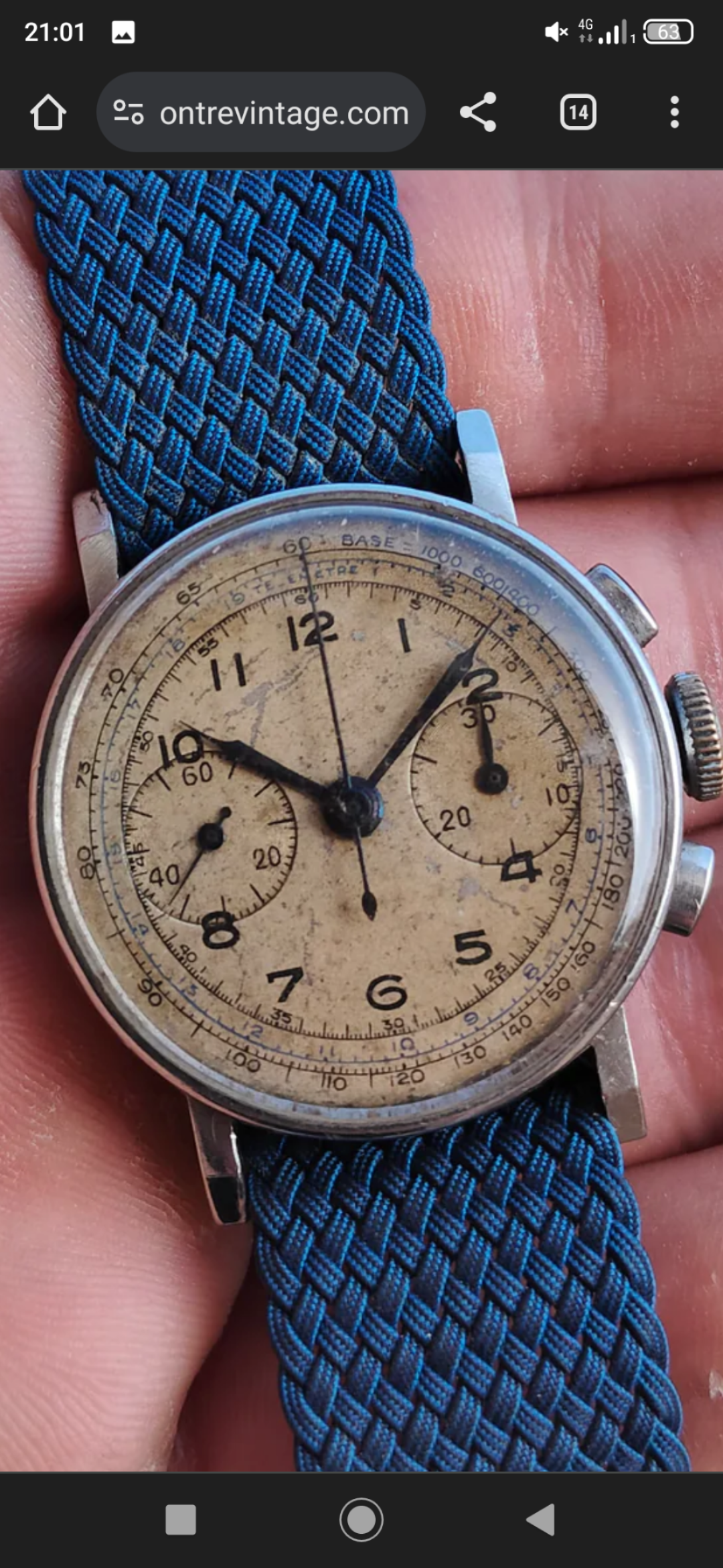

Dial looks good to me.
You may wait indefinitely unless you get lucky with a donor dial from a damaged watch.
these do not grow on trees

thank you for your reply.
even if it is not (or no longer) signed "omega", in your opinion can it be original?
Not in this case.
The numerals 2, 4, 8, and 10 should not be printed inside the subdials.

Not in this case.

I think a high res picture of this dial would show a lot more problems!
