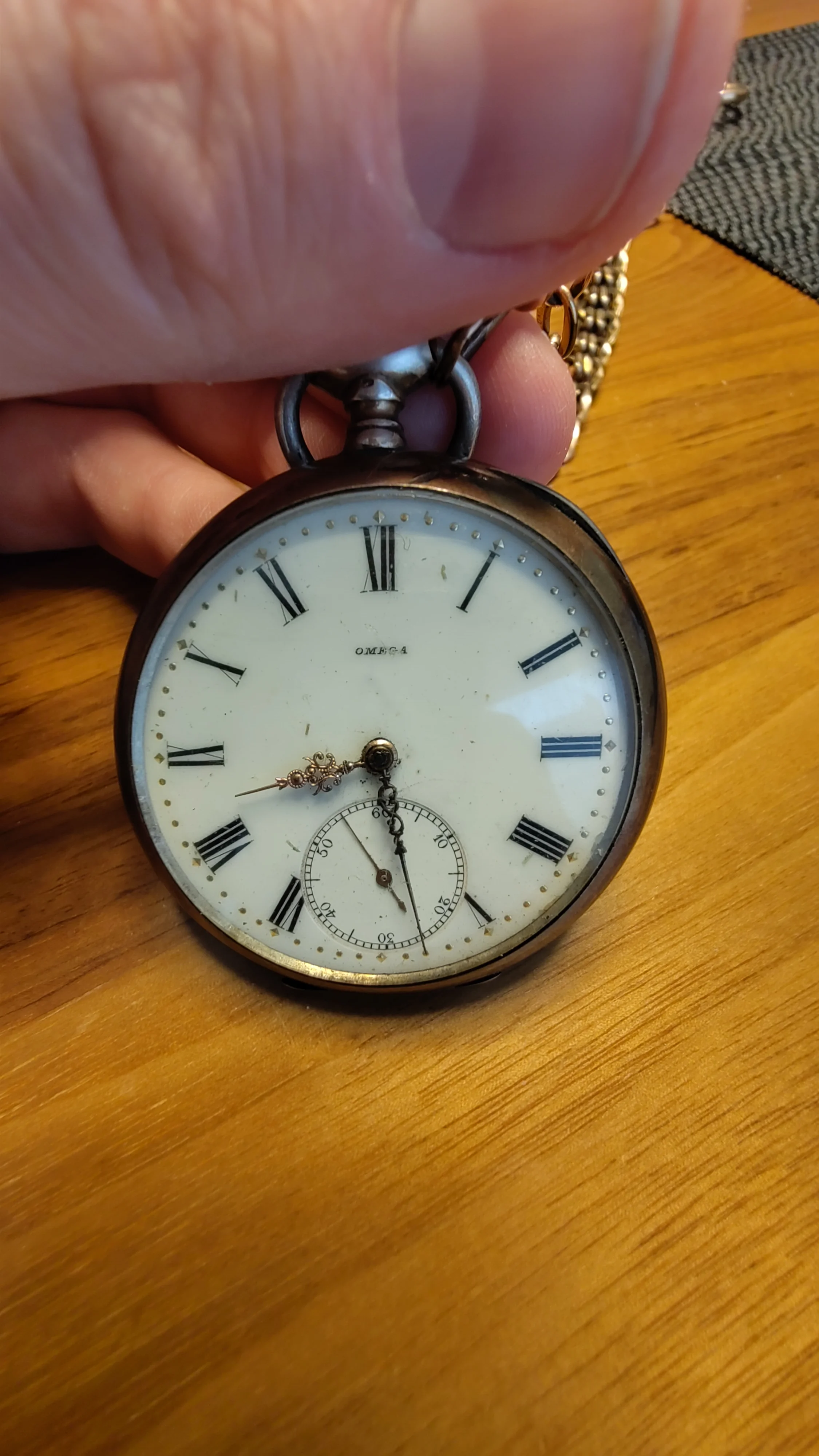

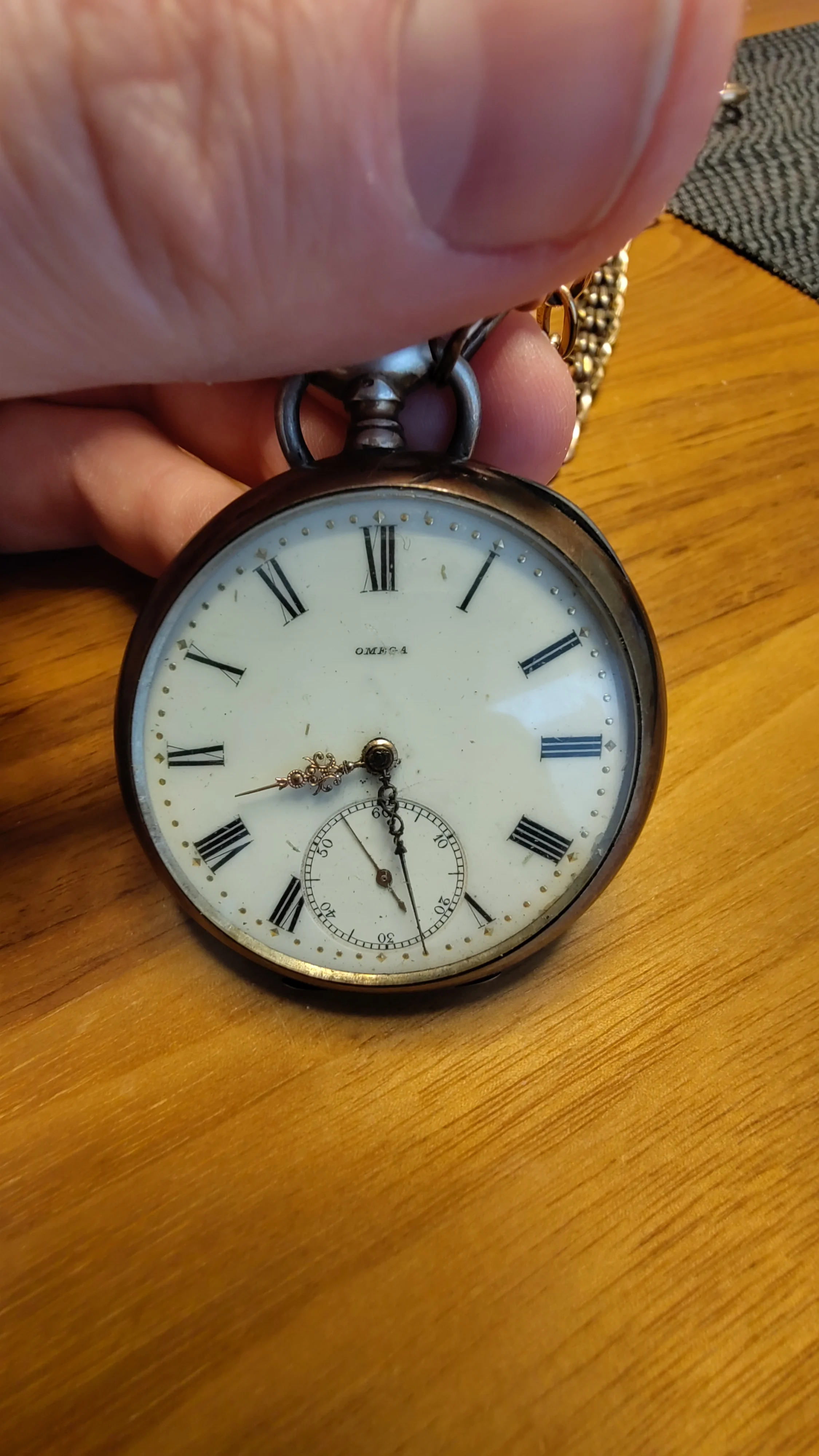

Clockface with what looks like enamel and little gold pyramids as the minute indicators, I could not find another example online of this design.
There is some grease smudges and dust in it, but I could not open the front with just my fingernail and did not want to use a tool

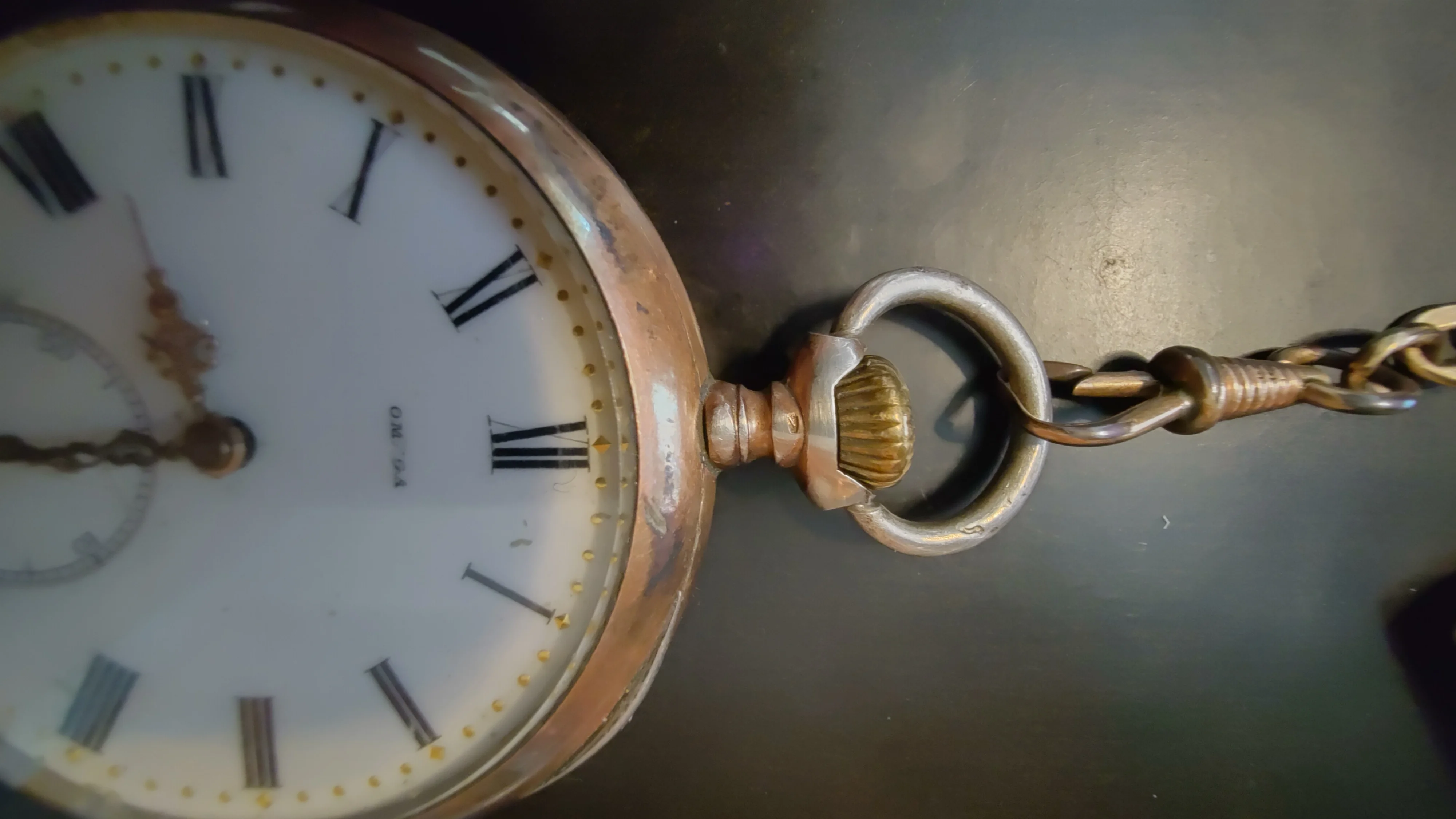

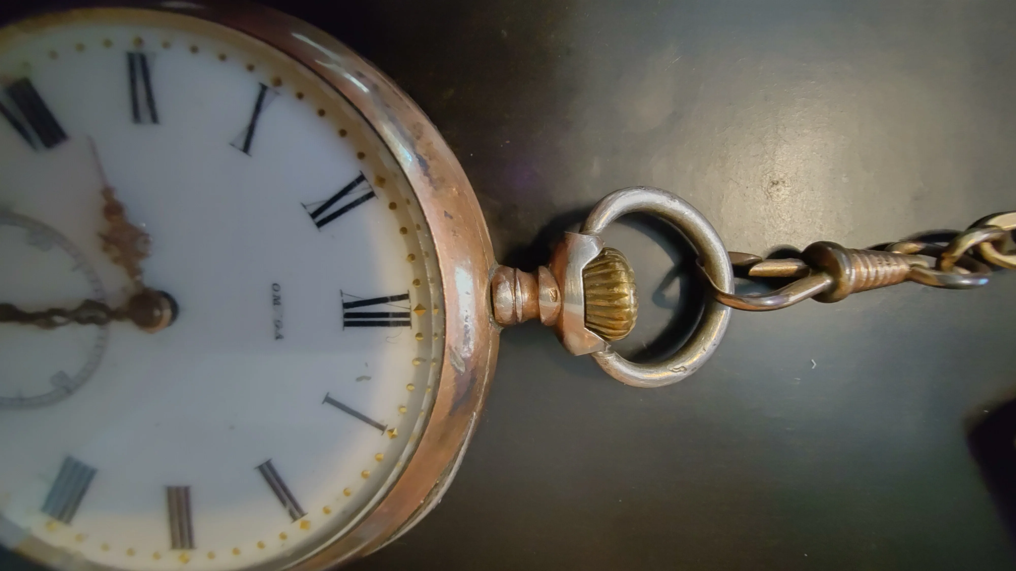

Crown with a small mark I could not further identify also with a looking glass.

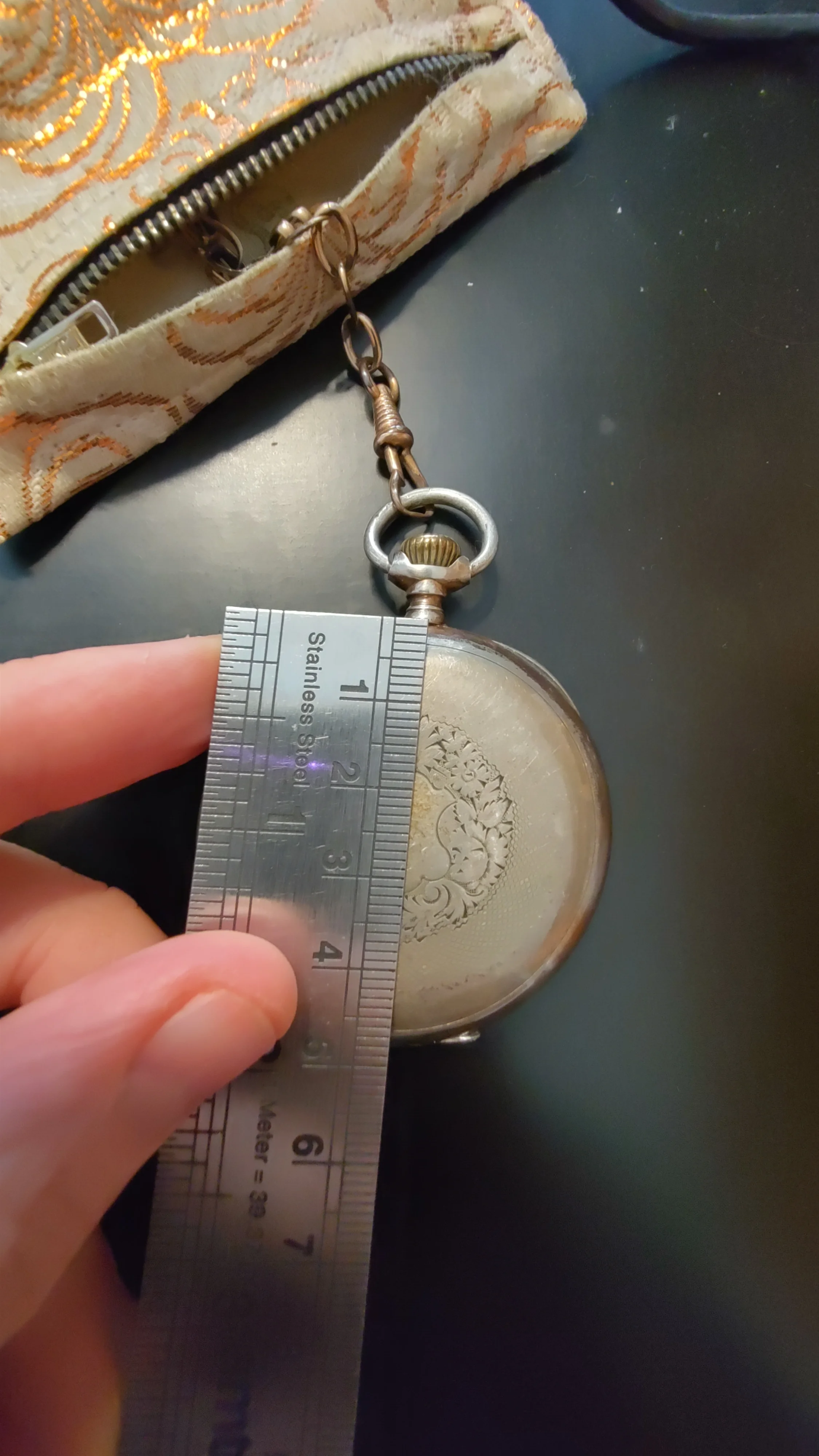

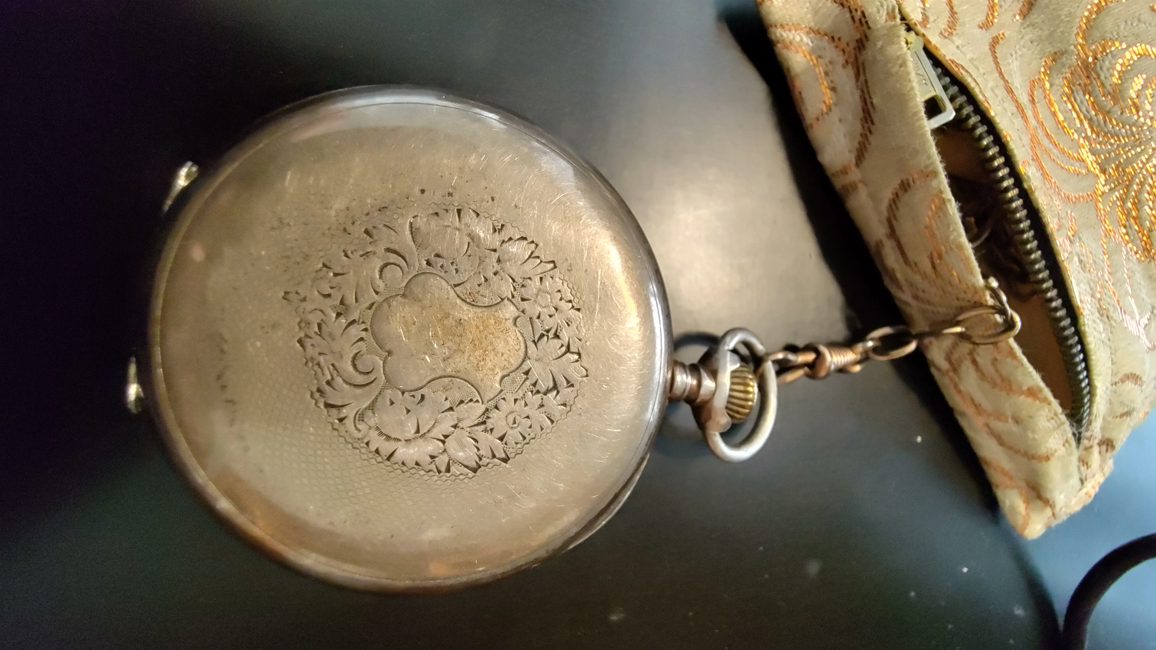

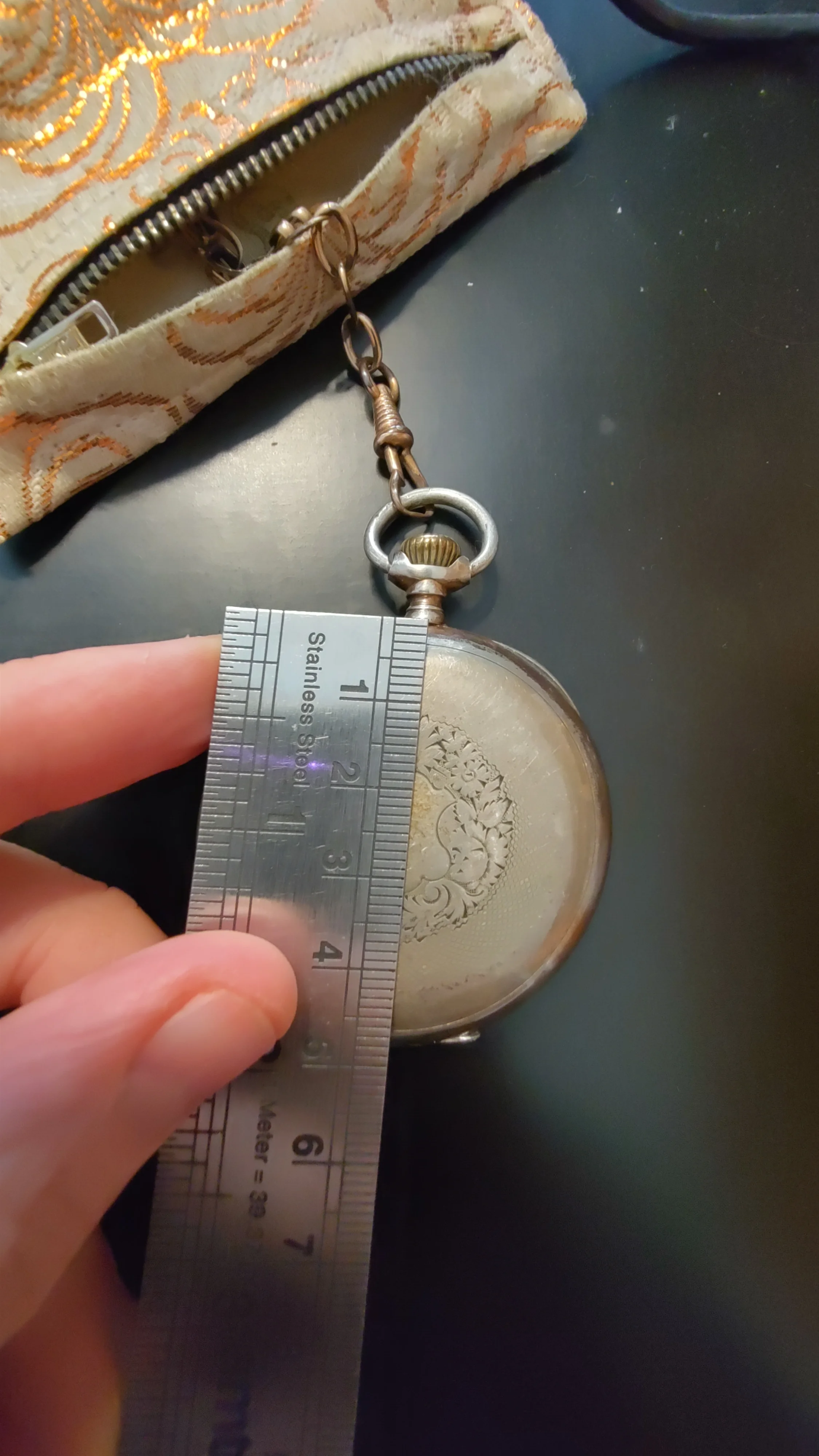

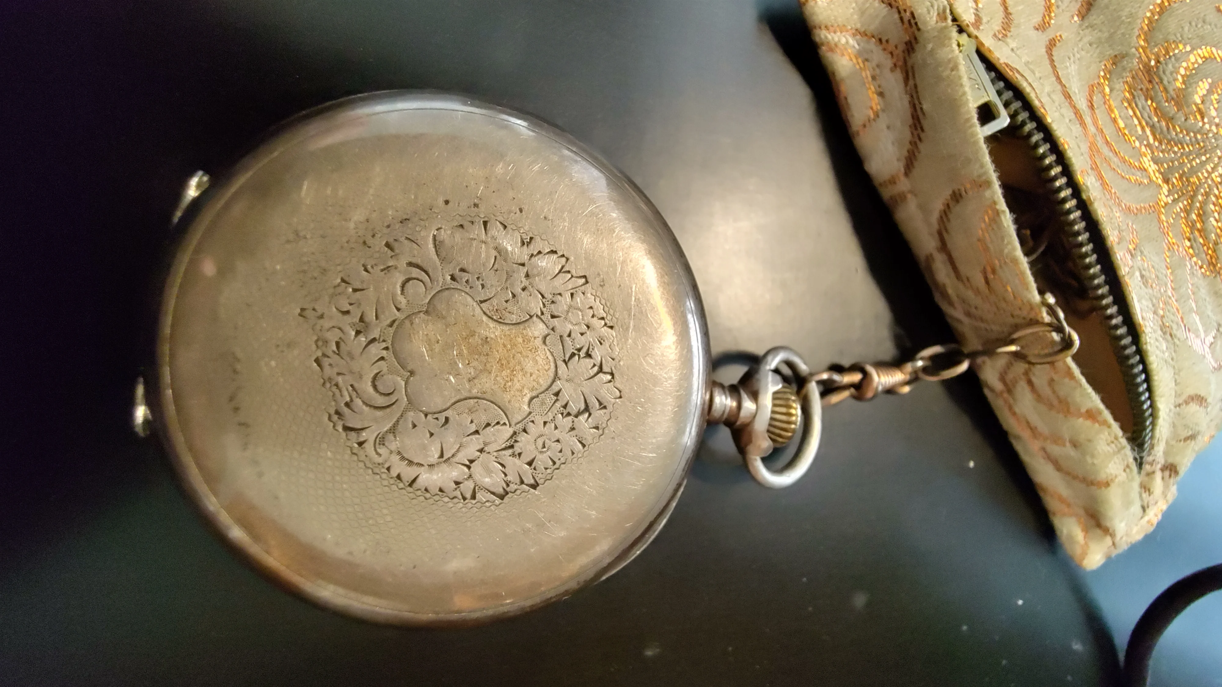

Back of the watch, the main body is roughly 50mm, the pattern around the coat of arms is nearly completely rubbed off.

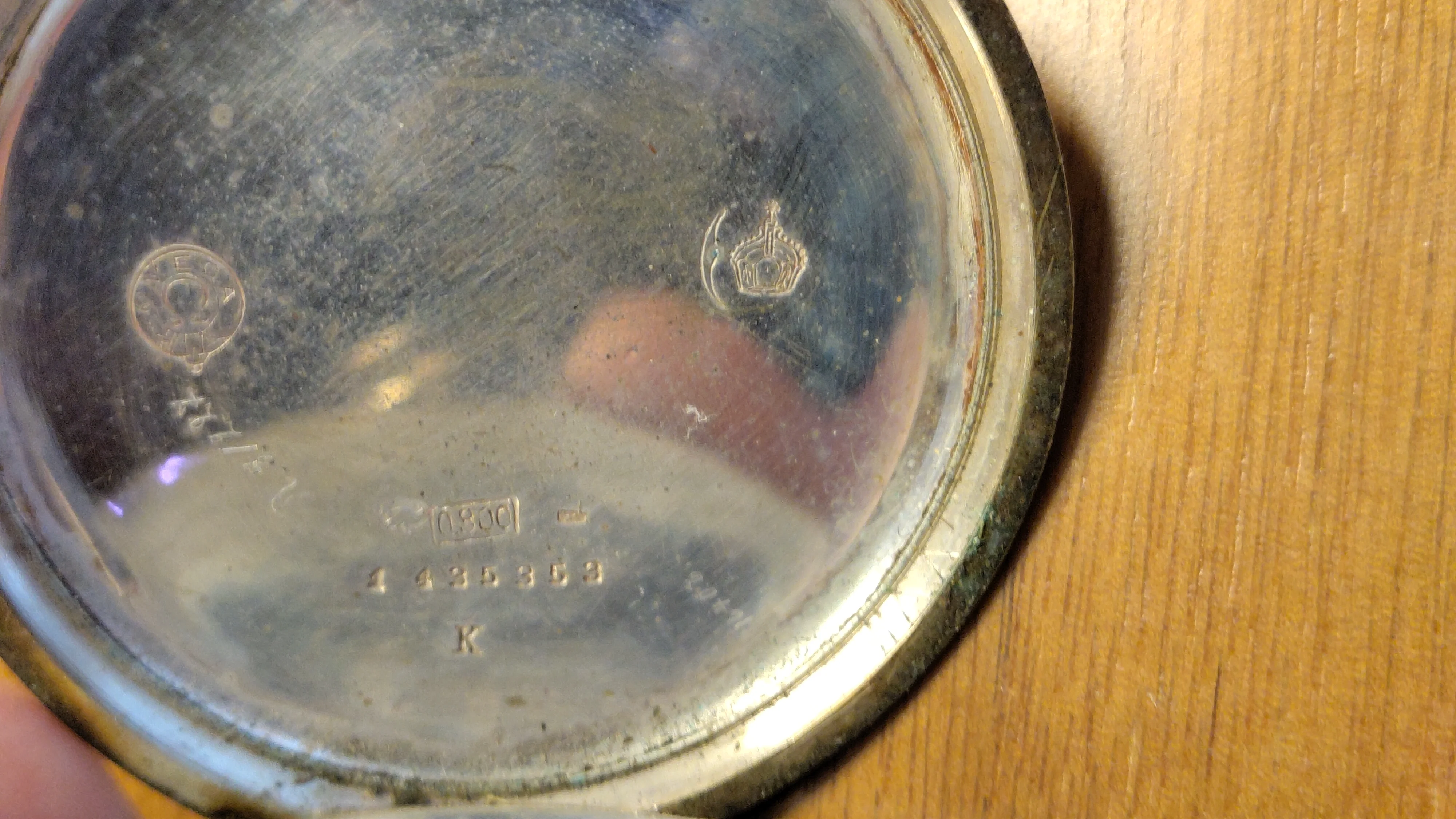

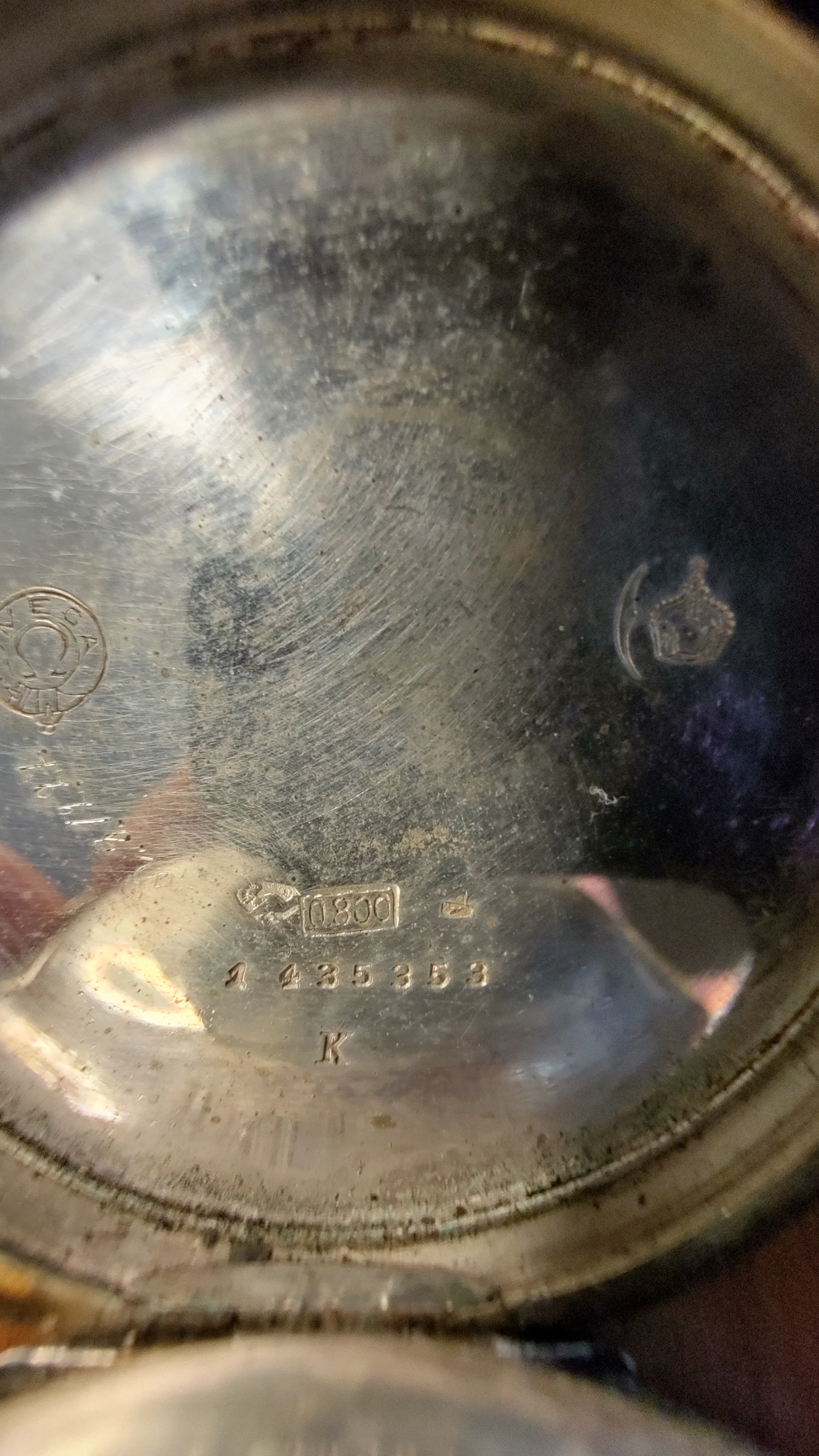

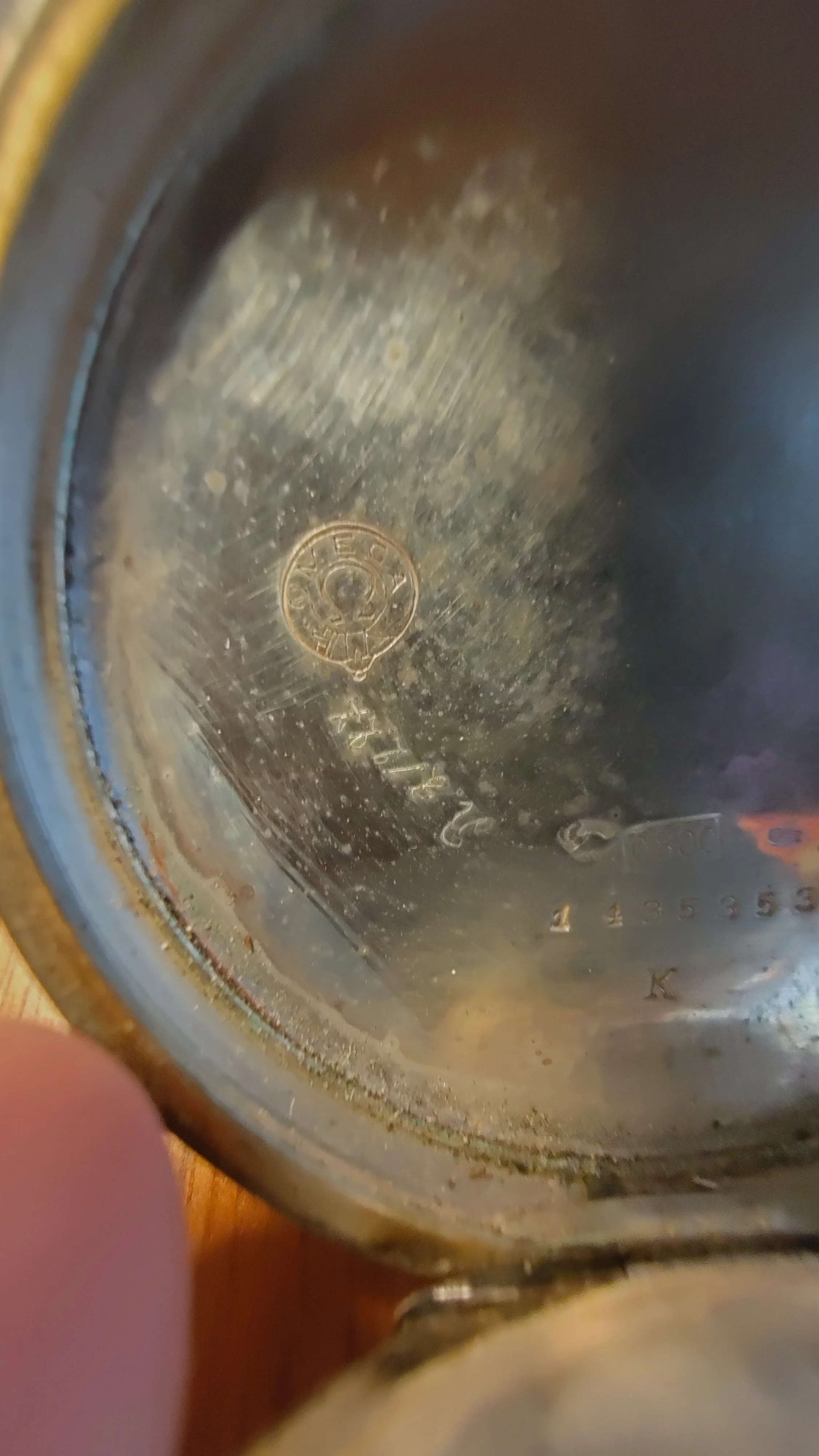

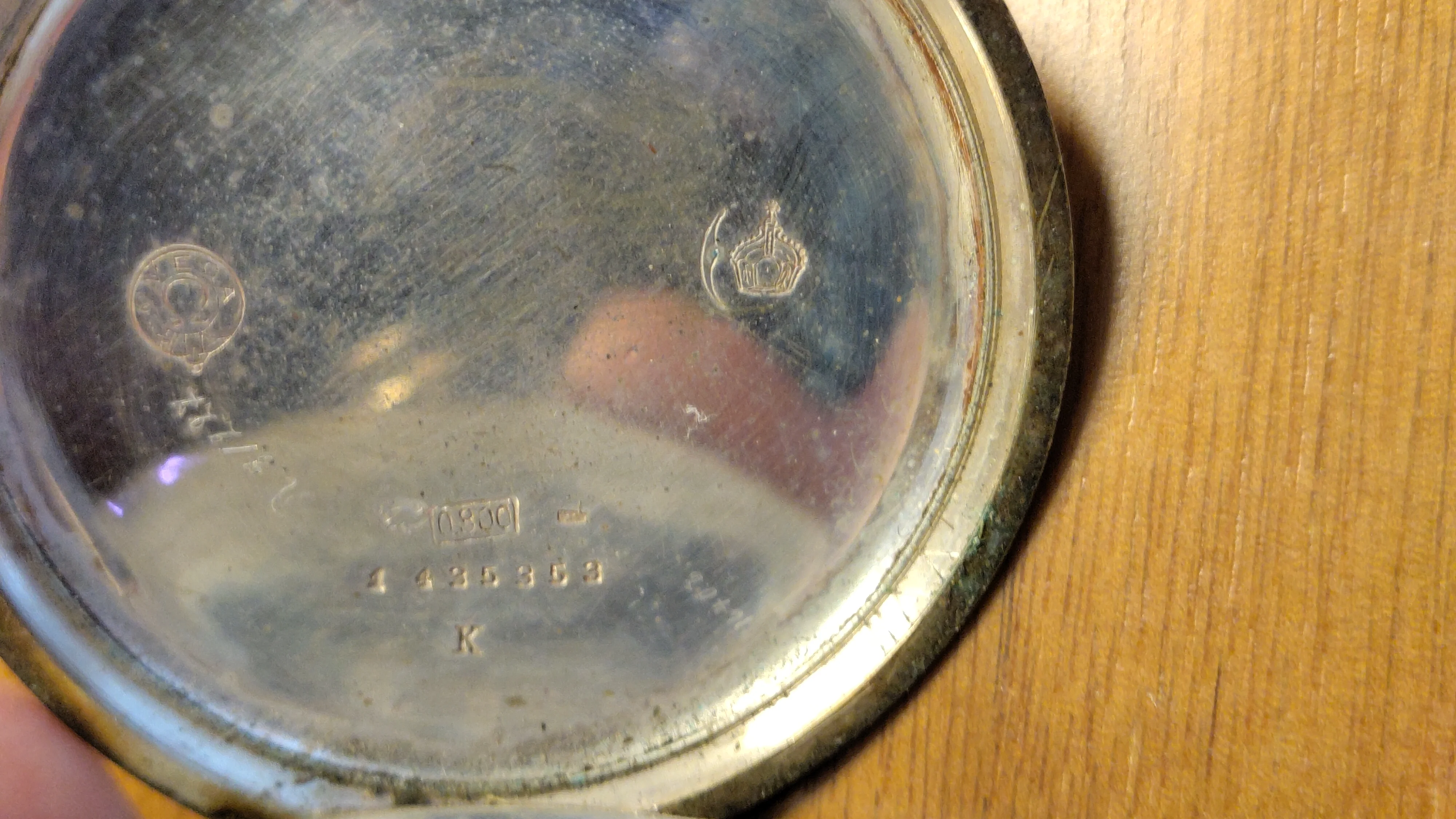

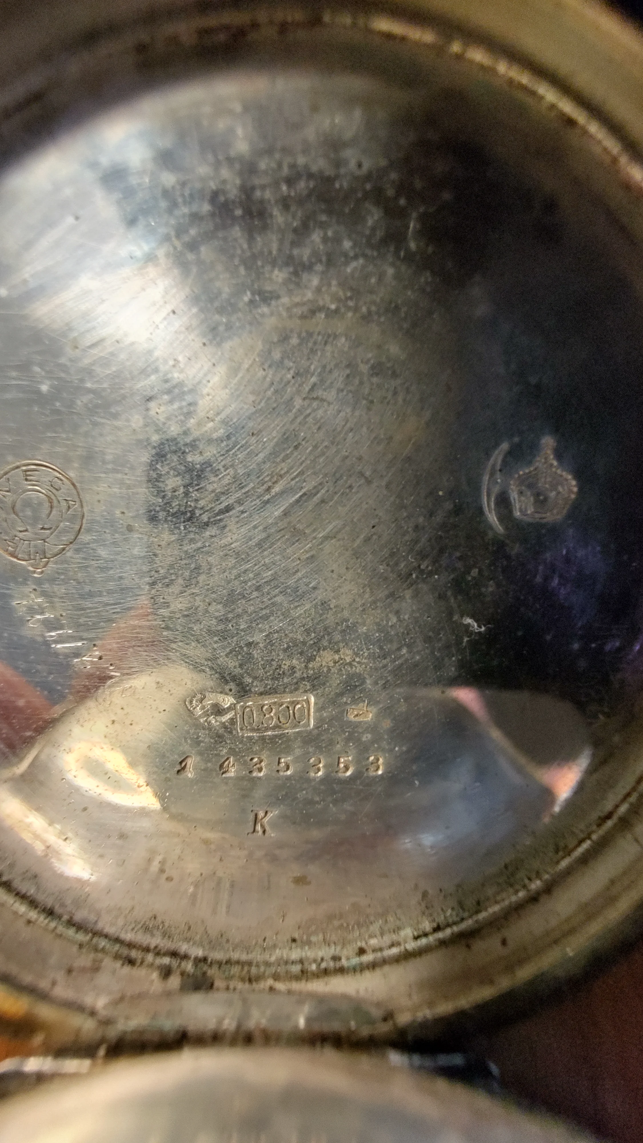

Insides of the back: from what I gather the 0.800 silver mark plus the German silver mark (Half Moon and Crown).

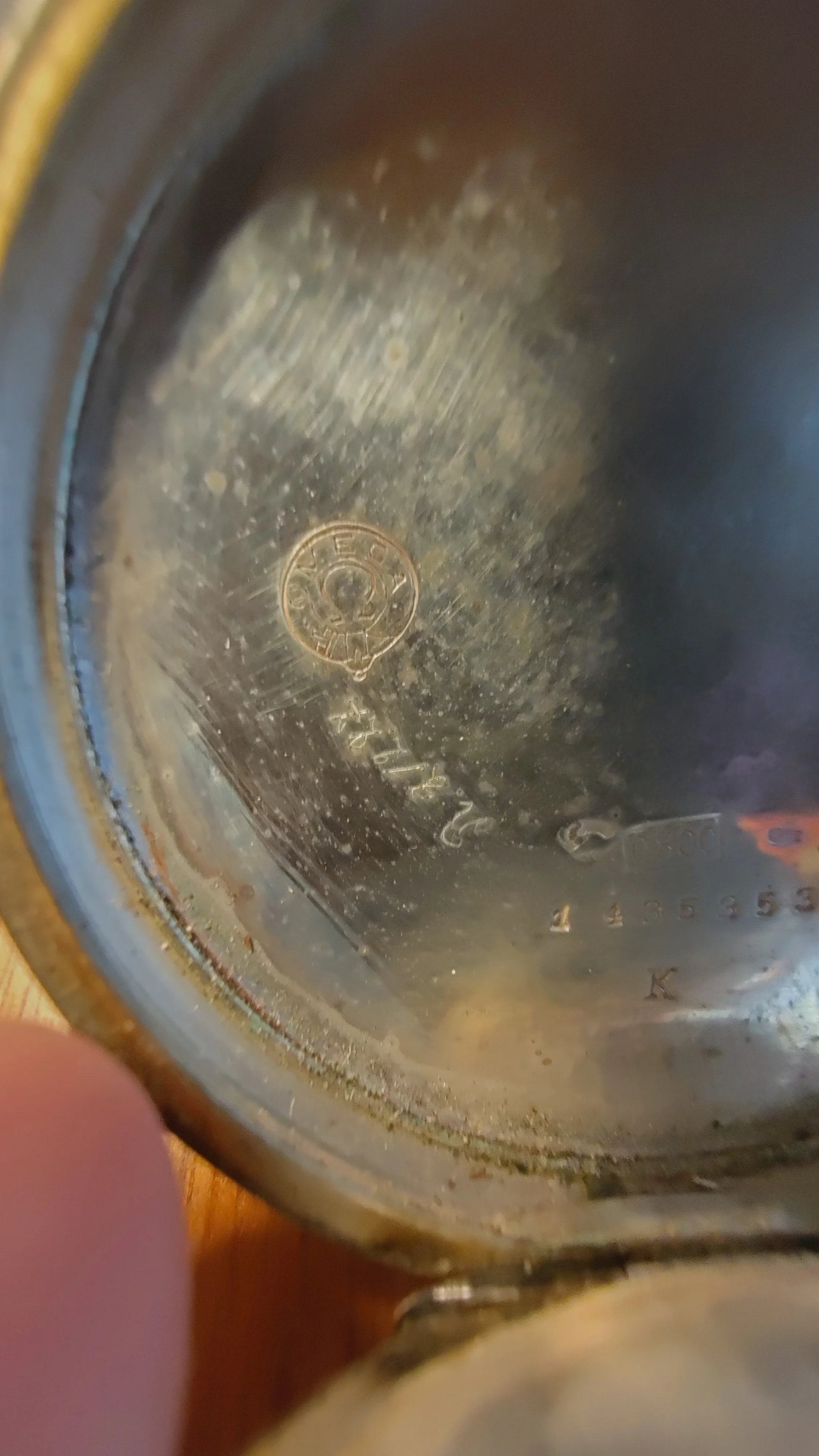

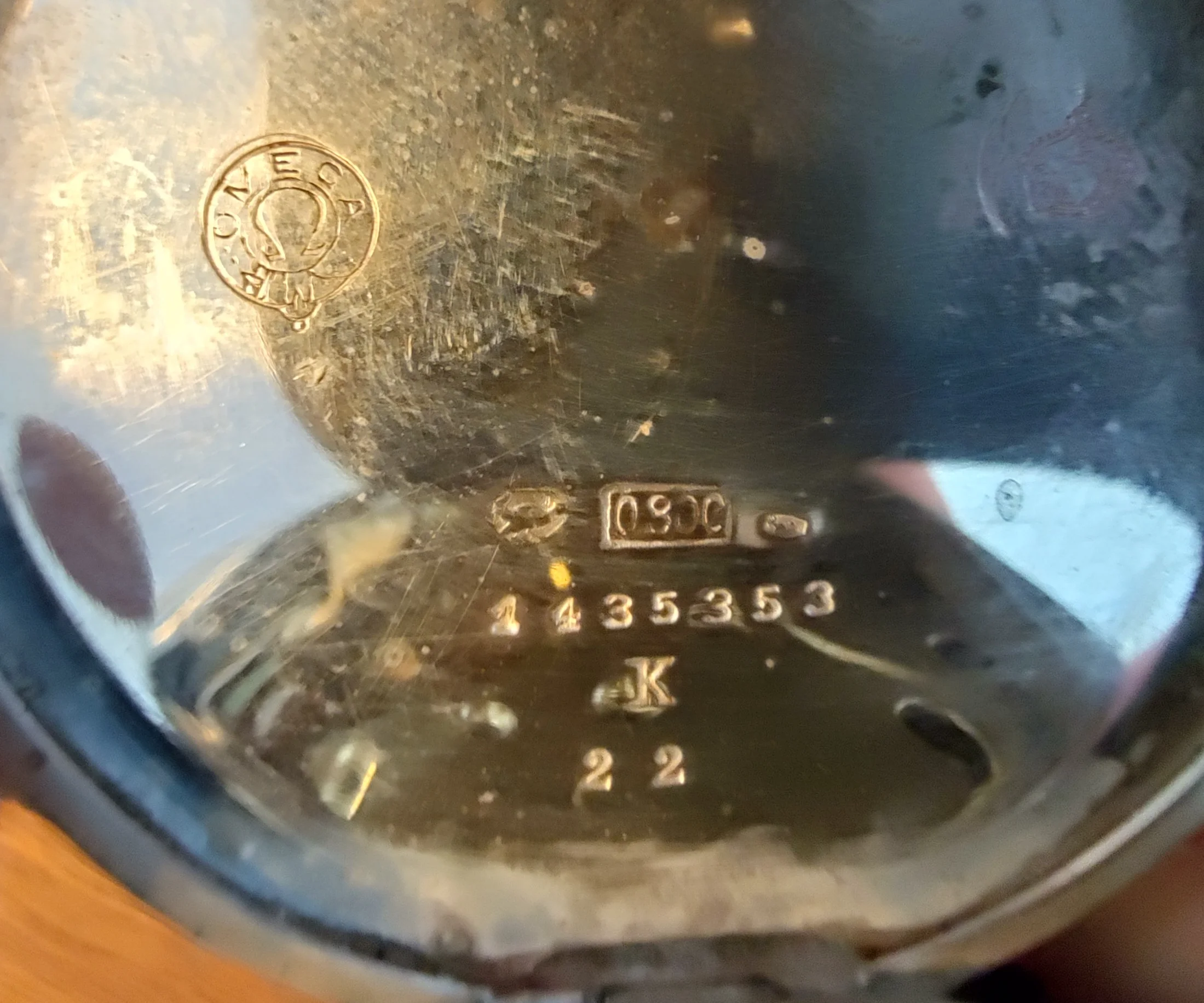

The Serial Number is 1435353 with the letter K below it - when you open the second lid which houses the movement, there's an additional 22 stamped below that. There are multiple thin, handcarved numbers which I assume are from revisions.

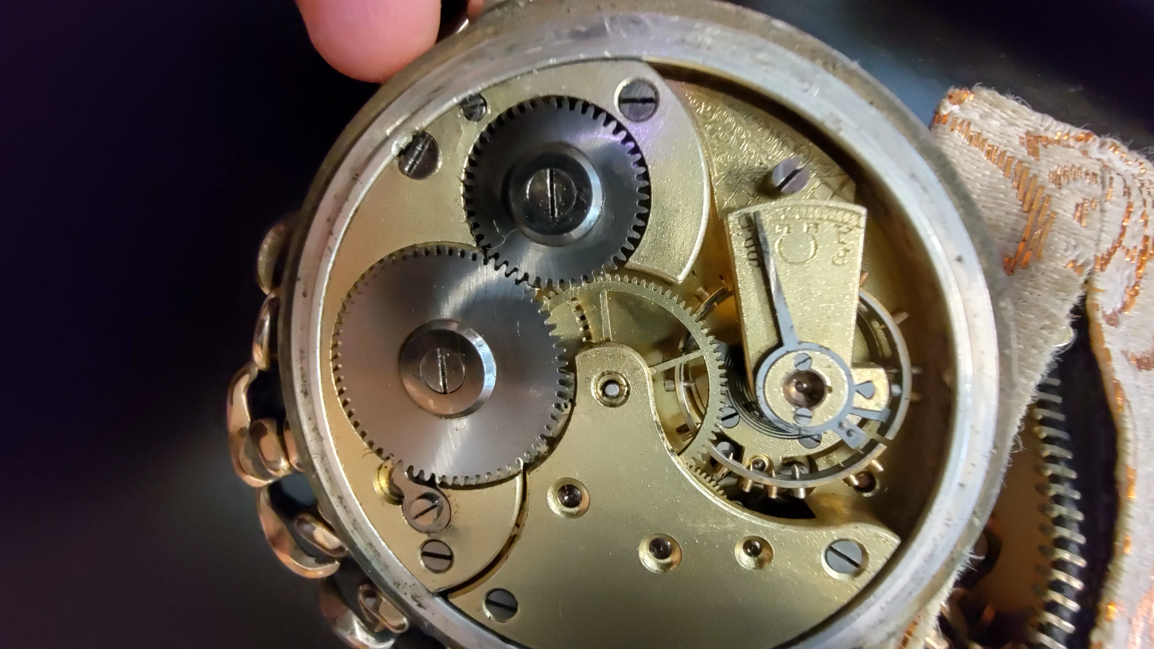

Last but not least the inner workings, there is still quite a bit of grease in there, some mixed with dust and grime.

Google Omega serial number chart, and use that information to date your watch approximately. Is there nothing engraved on the movement at all?

There is the Omega symbol on the balance cock. Looks authentic. Coin silver case (.800) with authentic markings. Locating another example to match the dial exactly will lead nowhere, in my opinion.

Hi Dan,
Thank you - based on that it's somewhere between 1894 and 1902.

And no, there is only the omega mark with some indices plus decorative engravings.
Thank you Canuck - regarding the dial, is that because there were so many versions of it during that time?
Most picture I found online have the "chequred" pattern around the clockface instead of these golden "pyramids".

I suspect that there may be 1% of the Omega production of that era of which pictures might be found on line. There could be other similar dials around, but to find them? Referring back to your original post and using your thumb for scale, I suspect this watch was made for a woman, hence the decorated dial. Dials on watches for men likely were plainer. Movements and cases were more or less standardized back in that era. Dials? Less so. The case and the movement will tell you more than the dial will tell you about the watch.

In addition to the above, the movement with the stepped balance cock is a caliber 13''' L 7-16P which was introduced in 1896.
A count of the jewels would confirm the exact reference.
The movement serial number may be stamped on the main plate under the dial.

The only other number I found (apologies I forgot to add a pic of it above) - is the 22 and a K under the serial number on the second backplate above the movement. Any idea on what these might stand for please?

15-jewels. No jewel on the centre wheel upper pivot, only one cap jewel visible in the posted picture (balance staff top pivot).
