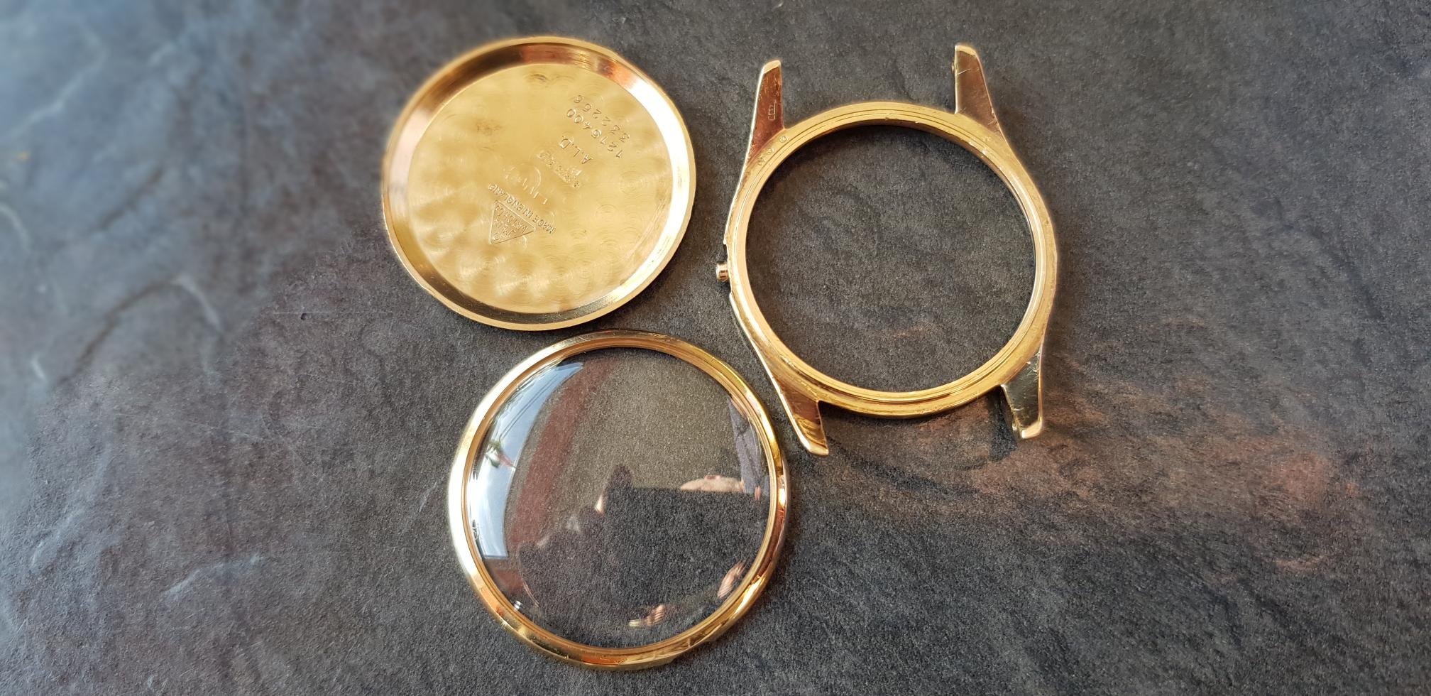

Afternoon Everyone I am a Newbie,
I have a complete Omega 9ct gold watch case stamped 266, photos attached.
Please can anyone tell me what Omega movements will fit this case?
Thank you in advance.

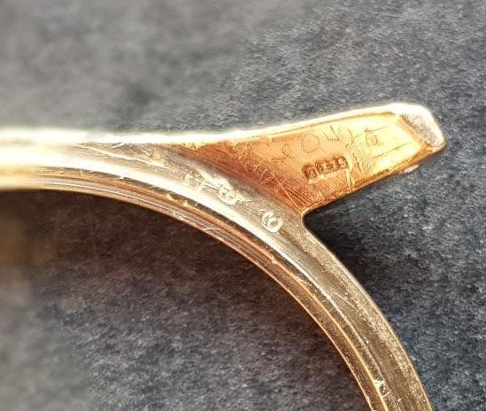

The "266" is just the last 3 digits of the case serial number. This was used at the factory in the UK to match the pieces to each other.
There is also a case reference number of 121(.)5400. When you Google that reference, these turn up:
https://www.blackbough.co.uk/produc...ld-vintage-wristwatch-hallmarked-1964-wwomgw/
https://www.blackbough.co.uk/produc...ld-vintage-wristwatch-hallmarked-1963-wwogw3/
So this watch should have a caliber 269 movement from the early 1960's. Here it is in an old Omega UK catalog:
http://www.old-omegas.com/catuk63.html

Hi,
Thank you for taking the time to reply. I'm looking to see if any other Omega movement other than a 268 or 269 movement will fit in it.

You don't have an Omega case at all in fact. You have an English 9K case made in Handsworth Birmingham. The numbers in the back are not Omega numbers they are Dennison numbers. I can't read them but you can, so that is where you need to research. It is probably made for the 30T2/26X movement but then it may not be since Dennison made hundreds of different cases for Omega movements, some in steel some in gold, some for manual wind, some for autos. They made for Rolex too and many others.
Respectfully disagree. Vintage Omega watch cases were made by contractors in various countries, including Switzerland.
So either all cases with the Omega trademark are “Omega” cases or none of them are.
All depends on how you define it.
gatorcpa

Good point in general, it's a legit Omega case. But I assumed that @padders may have been trying to make the point that the nationally made case probably doesn't have an Omega reference number, which is relevant for the OP's research.

I’ve shown it in a UK catalog, and found the same UK reference twice from a UK seller with the same caliber 269. I’m not sure how much more research on this case is required.
The OP is going to need to match a dial to the case. It is possible that only UK export dials will fit this case. No way to know without detailed measurements from many angles.

Fair enough You have the advantage on me there. As I mentioned, I couldn’t read the numbers stamped in the caseback on my phone clearly and perhaps didn’t pay enough attention to the detail you provided which does seem comprehensive. My excuse is that I drive for 6 hours through the rains of storm Babet today and am a little zombiefied as a result.
I would question whether a local case is always regarded as fully factory though. They are often (and often wrongly) considered somehow inferior by some. Omega used cases made in Italy, France, UK etc etc for those markets but did treat them differently and the assembly was usually local so there is a difference. The 5 in the case number for instance is a UK specific thing, more usually seen on later Shackman made stuff. It is rare to see an Omega number in a Dennison case, it must be a late one.

Omega refers to these as "National production" and in the diagnostic vintage handbook they give some background on these...
"The "National Productions" are, in most cases, gold, massive or plated watches, the movements of which have always been dressed by a distributor (Such as Brandt Frères Paris, OWC London, or SCR Buenos Aires) or a general agent (e.g. De Marchi Turin, Norman Morris Corp. New York or Gameo Lausanne). They developed during a very long period, going from the end of the 19th century (mostly in North America) to the mid-1980s. There were several reasons these collections came into existence:
• Economic and Political: Prohibitive tariffs and/or other prohibitive taxes; shortage of deviations; quotas; import restrictions to protect the national/local industry, etc.
• Industrial: Impossibility or refusal by the factory to supply the products required by the markets, due to inadequacies in their collection (especially gold ladies watches) with the needs of the latter or the limited capacities of the suppliers of cases and, consequently, failure to keep delivery times, e.g. before the end of year celebrations.
• Marketing: National production was necessary in order to remain competitive against other watch companies, and to offer a comprehensive collection to clientele in the widest possible range of prices.
In 1985, OMEGA stopped all national productions in order to create a single international collection of Swiss origin."
