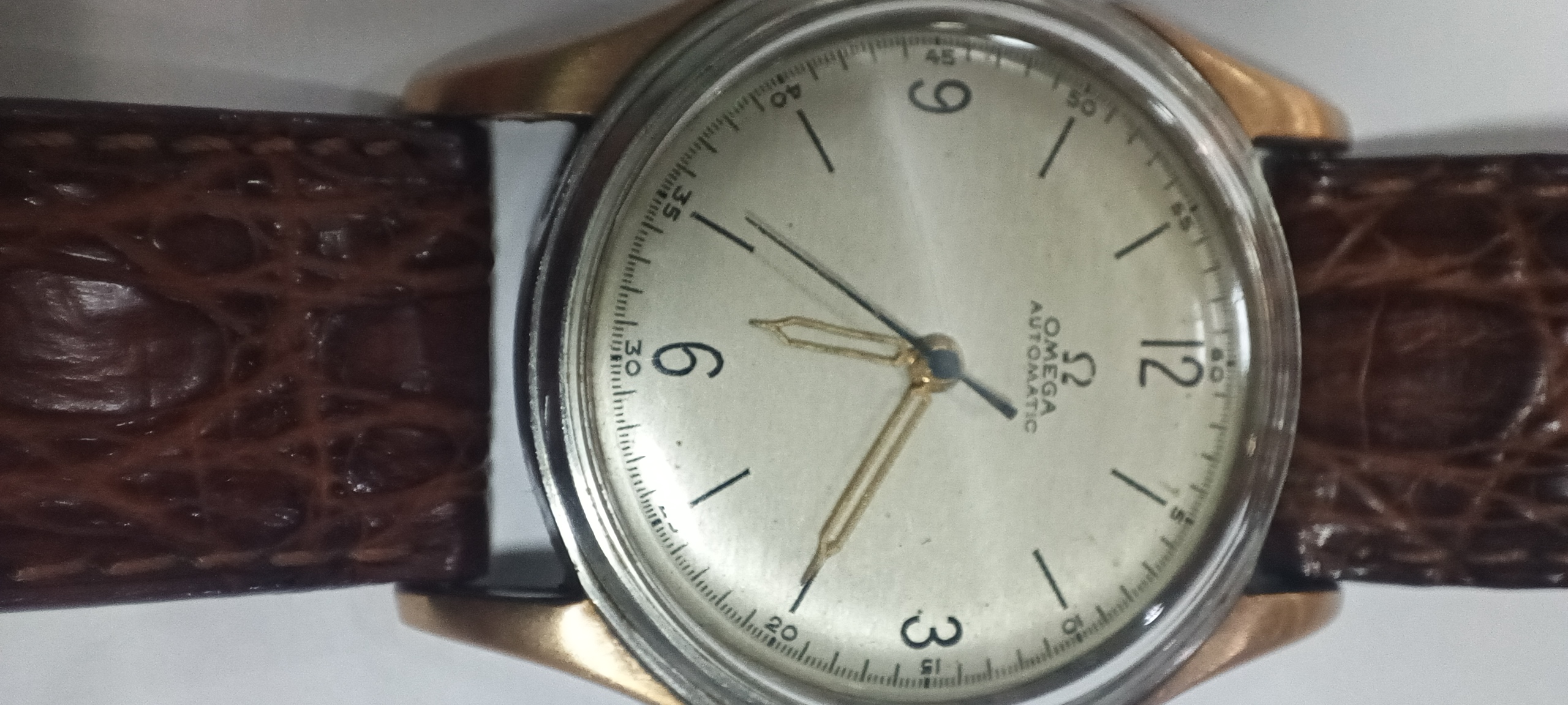

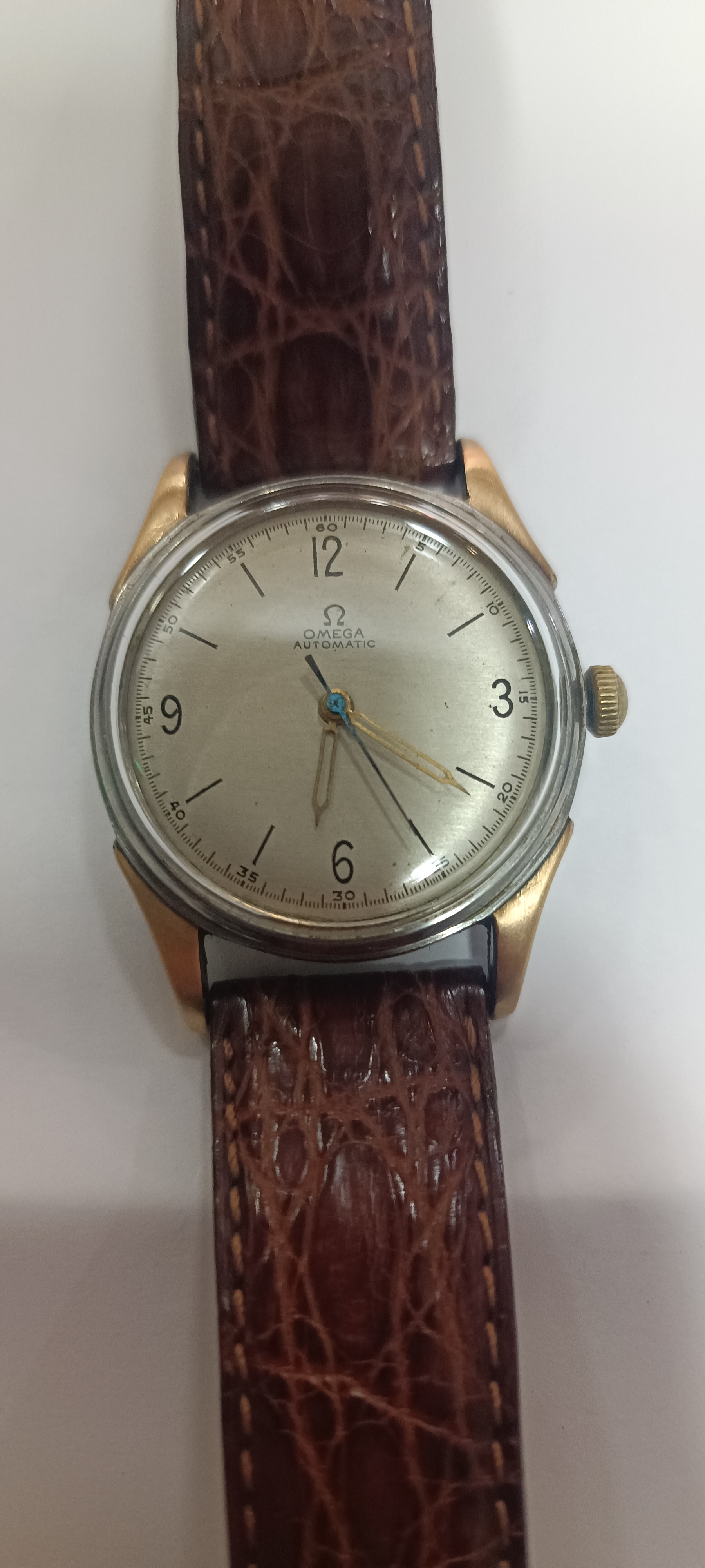

Hi,
I've Bought an old omega i'm really happy with It.馃槈 However i'd like to ask, a more informed person if it's all ok with This watch. I've tryed to find It on Google but i'm having a really bad time. From my search This watch was made after 1942 and It was Mr. Charles Perregaux that designed the movement. I also believe the dial is in good shape, Not refurbished, Not sure about the second hand and o really don't know how to find a ref for the correct crown. Any help or coment are really well welcome. Thanks in advance.
Regards

Closer and sharper (not blurry) pics would help a lot. But from this distance does not look good.
Thank you for your answer. Will get It done as soon as i get home 馃榾

Hi mate.

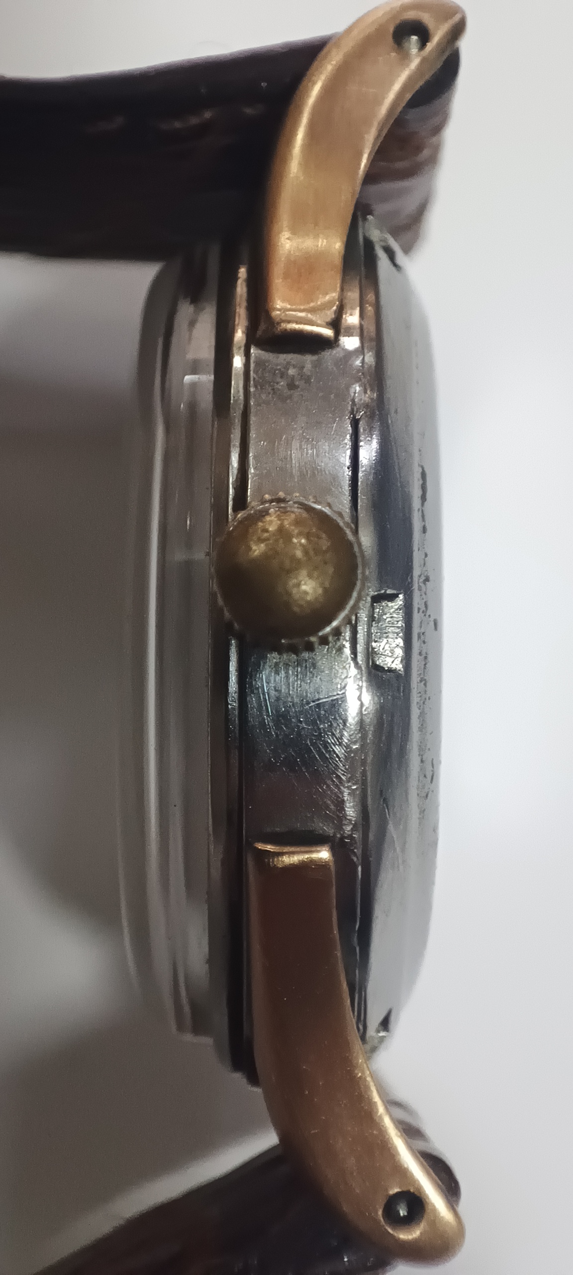

I am afraid this one has value as parts only. The dial is refinished, the hands are wrong, the case quite polished and missing the gold bezel too. The movement looks very rough and may be a franken - the rotor seems to come from a chronometer-rated version which I doubt fits with the rest.
28
4

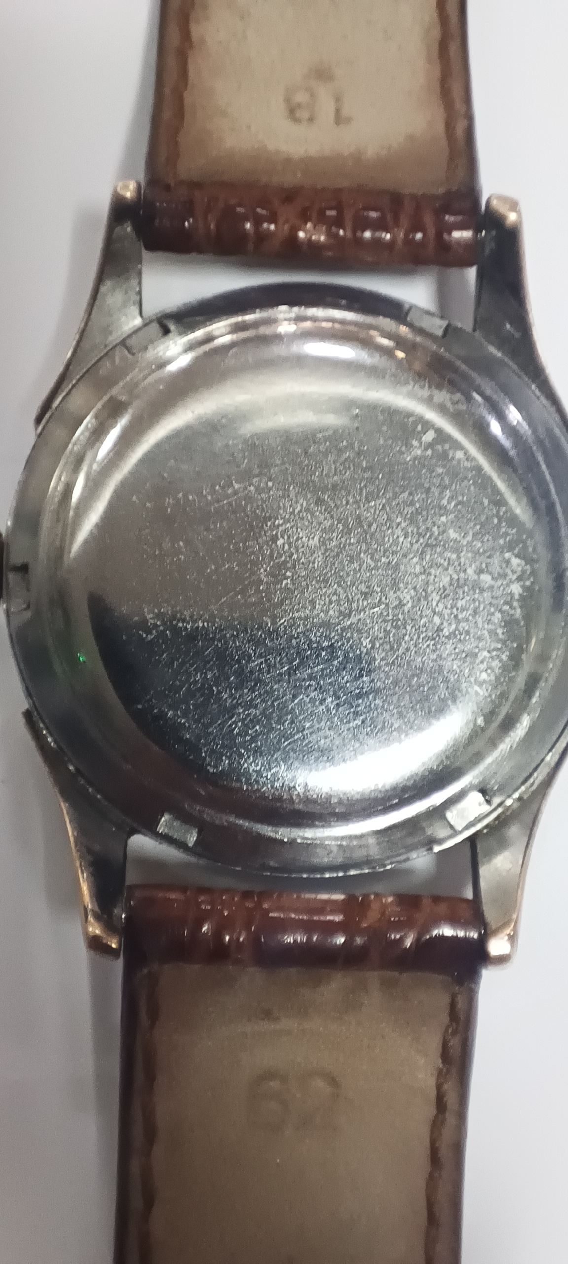

According to me dial is refurbished. It is not an original dial. No swiss made or swiss sign. I see that hands had radium lumes, and there has to be radium lumes on the dial as well. I believe neither case nor the crown are original. But the movement is original and looks 3xx smt. Caseback is terribly polished but inner shows its original.

As mentioned. Bezel is missing and going to be difficult to find one if not impossible
Hands not correct and dial refinished. Rotor is not the right one for the movement
If you can return it. Do so. If not. Best you can do is replace the hands, but they will have to be generic and you will need to measure lengths to match the dial.

I disagree with DON, there is a bezel there. Whether it is the right bezel is a separate question.
Dial and hands don't match the case in any event, so if you can return, I would recommend that.
