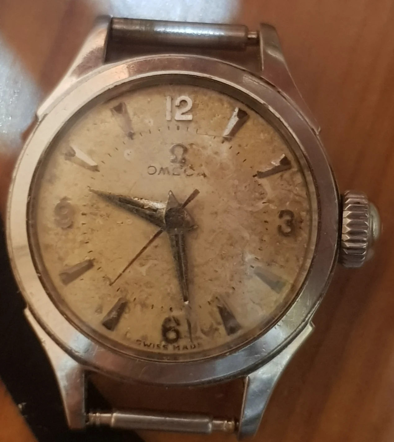

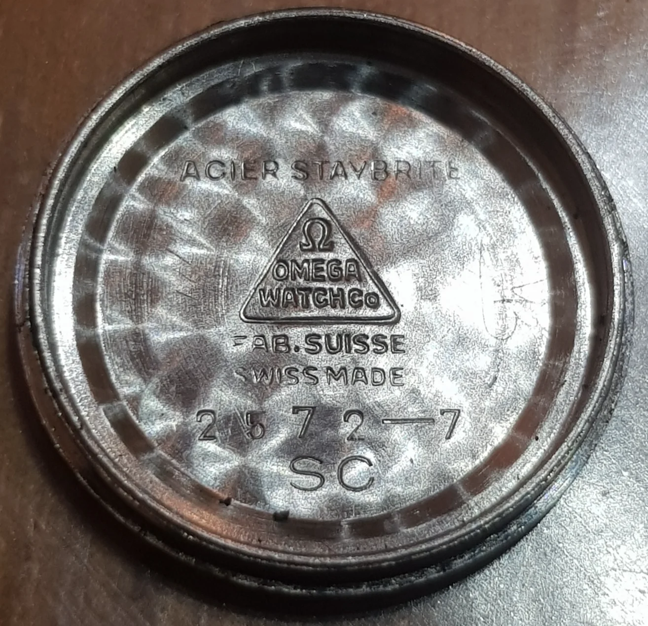

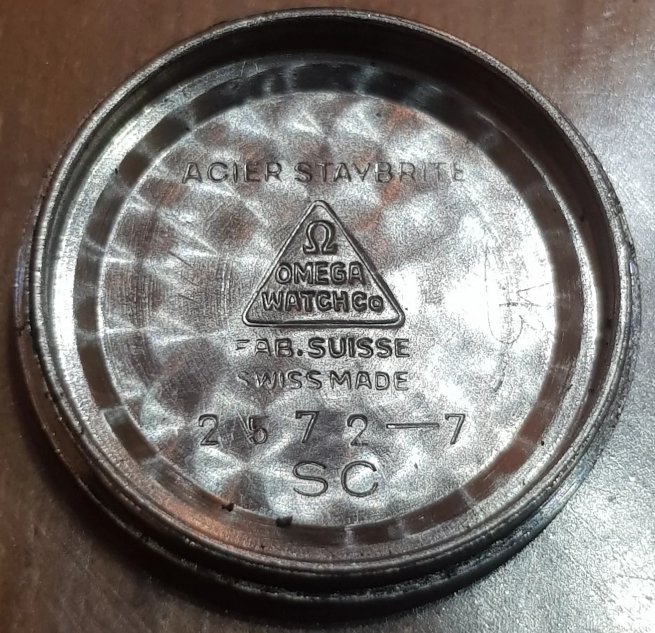

Hello everyone!
I came across this model of women's Omega. Please tell me a couple of questions.

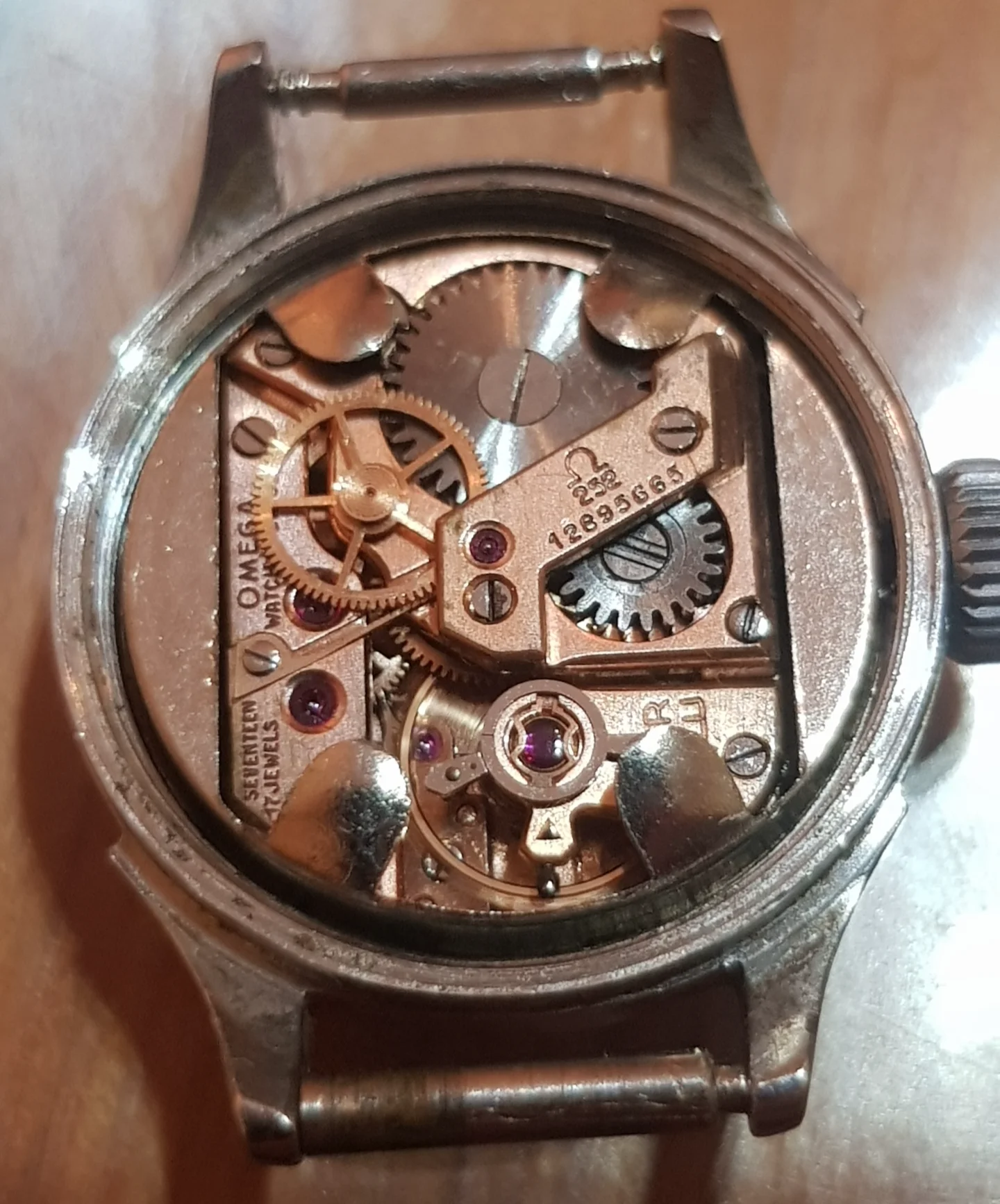

Firstly, I don't really understand how the movement is attached to the case. Around the movement there is a stamped insert with 4 tongues that simply rest against the back cover and press the mobement to the front of the case by the dial. And that's it. Is that how it should be?

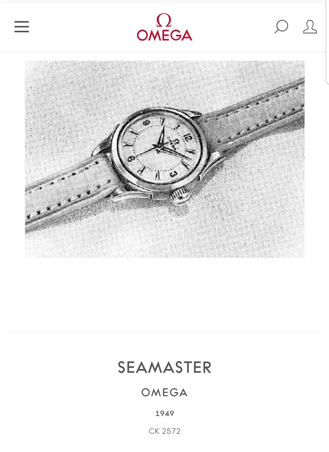

On omegawatches.com this model is listed as seamaster, and the movement is listed as "automatic".
https://www.omegawatches.com/ru/watch-omega-seamaster-omega-ck-2572?ysclid=m53kz2l1q0934246495
Is that correct? Was the mechanism replaced in this watch?

The movement holder ring with flaps is well known from other Omega watches. It is original.
Thank you!
And what can you say about the movement, is it as it should be or should it be automatic?
And I don't understand why on omegawatches this model is listed as seamaster, just because of the screw-down case? There is no seamaster inscription anywhere on them.
24,724
54,916
Early Seamaster watches did not always have Seamaster written on the dial.

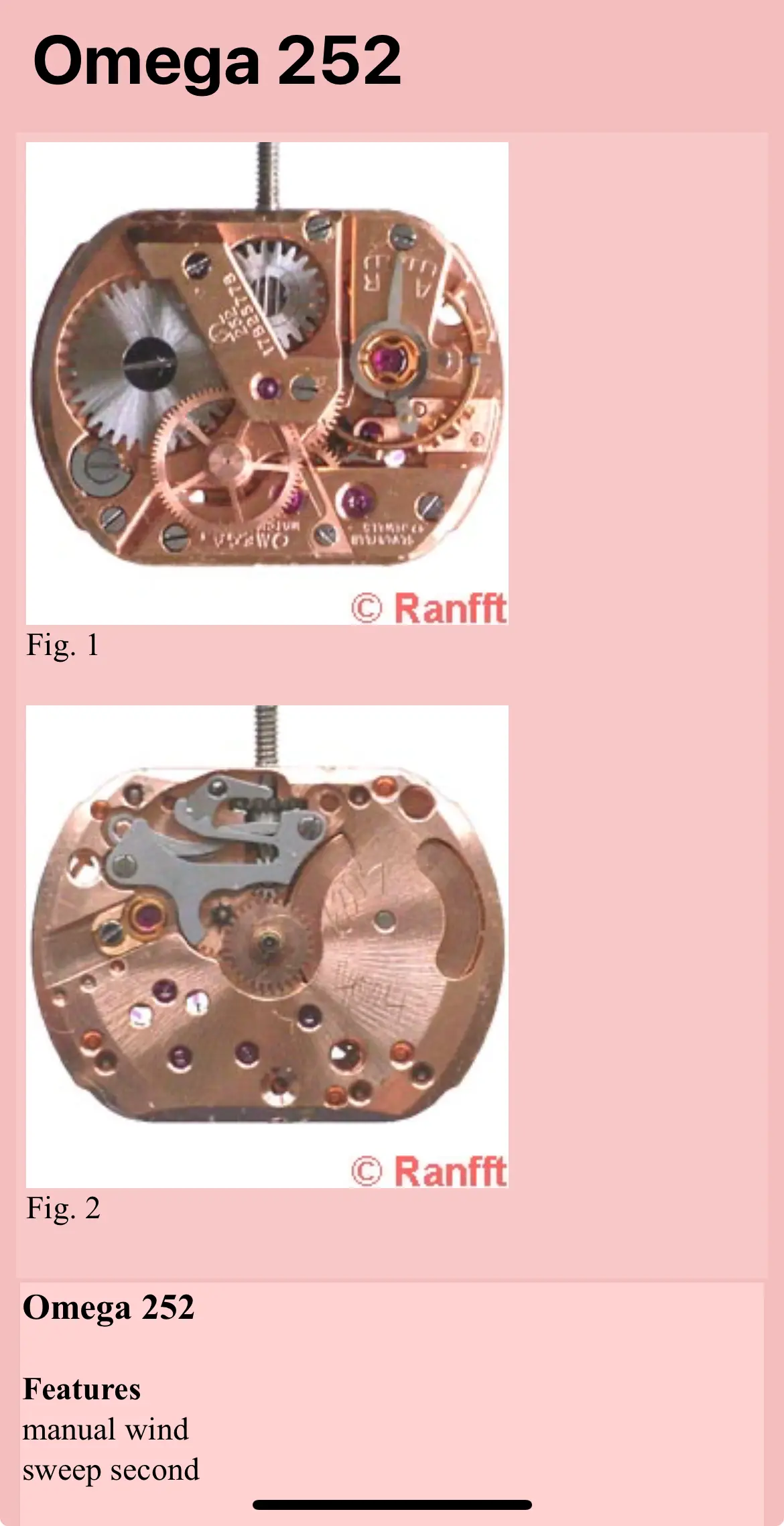

There seems to be a discrepancy in the Omega database regarding that reference. This case would appear to be too small for a cal 352, which is a bumper movement. It appears that there may have been a transcription error where 352 was substituted for 252.

Thank you!

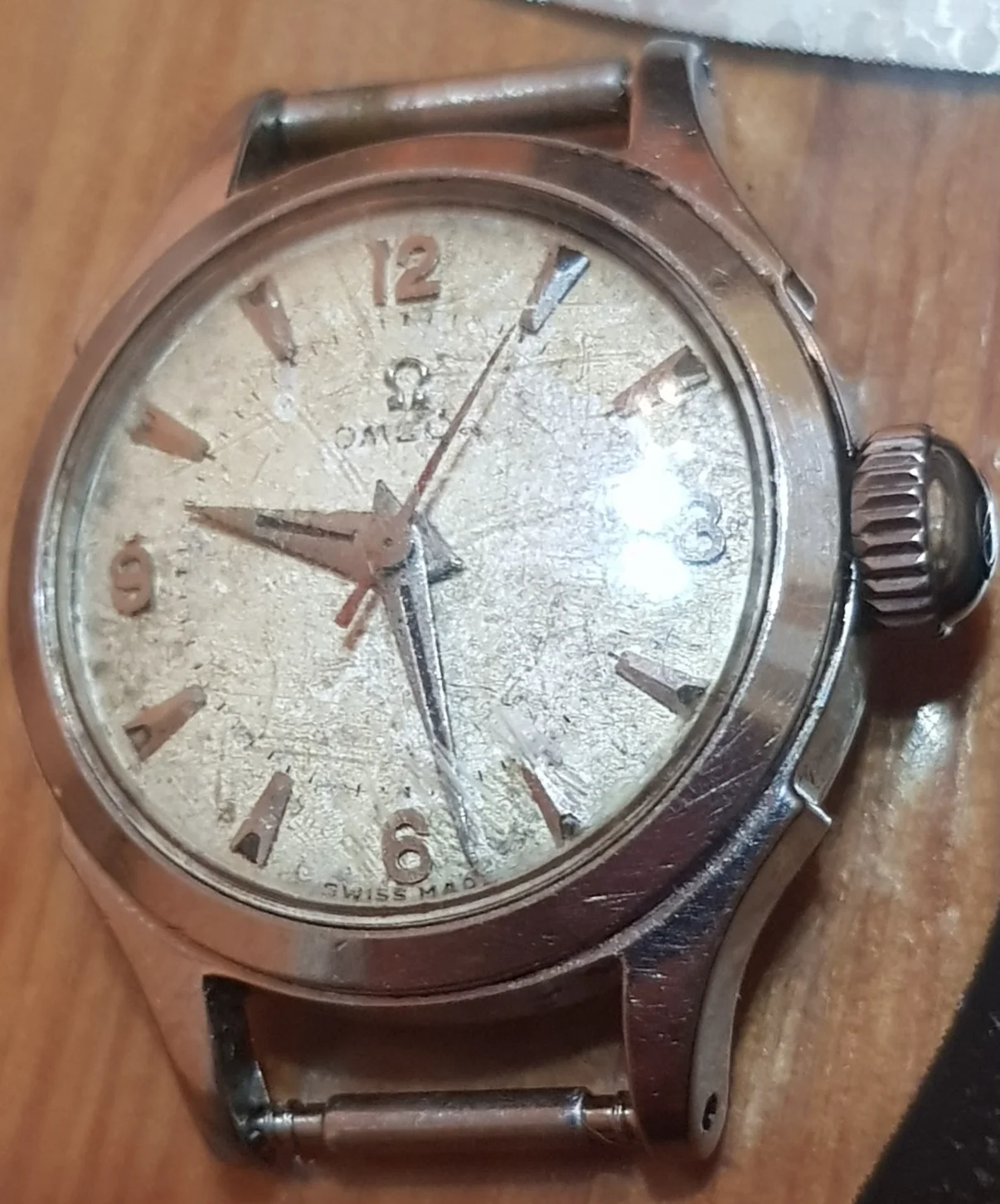

My watch is about 1951 by the serial number of the movement.
I found this thread:
there is a newer watch, about 1954, and with the same movement, a different mount in the case.
I wonder from what year they started to mark them as seamaster.
Yes, I think it’s just a typographical error. Here is a listing for another Omega with cal. 252 that shows it as manual winding:
https://www.omegawatches.com/en-us/watch-omega-seamaster-omega-ko-2968
Here is a picture from the old Ranfft database:
I think the “Seamaster” name began appearing on Omega dials sometime around 1951, but not all models at first. Gradually phased in.

Thsnks! This is very helpful information 👍👍

Please tell me, is there radioactive paint on the hands and hour markers in this model?
yes.

Oops. I hope it wasn’t very radioactive; it no longer glowed in the dark. I thought it was just dirt when it fell off 😬
What happened to the "dirt" after it "fell off"?
I wiped everything I could with a damp cotton pad, but apart from a couple of grains in the bag where the disassembled watch had been, I didn't see anything else. I tied all the cotton pads and the bag into another bag and threw it in the trash 😅😬

In general, there were no pieces of paint falling off inside the watch case when I took it apart. However, on four or five marks the paint had fallen off a long time ago, from the previous owner. The paint fell off on the hour hand, and that's what I noticed. Perhaps I broke the law when I bought this watch, because they should have detained it at the border, but they didn't)
Not something you should be admitting to in a public forum, but OK.
