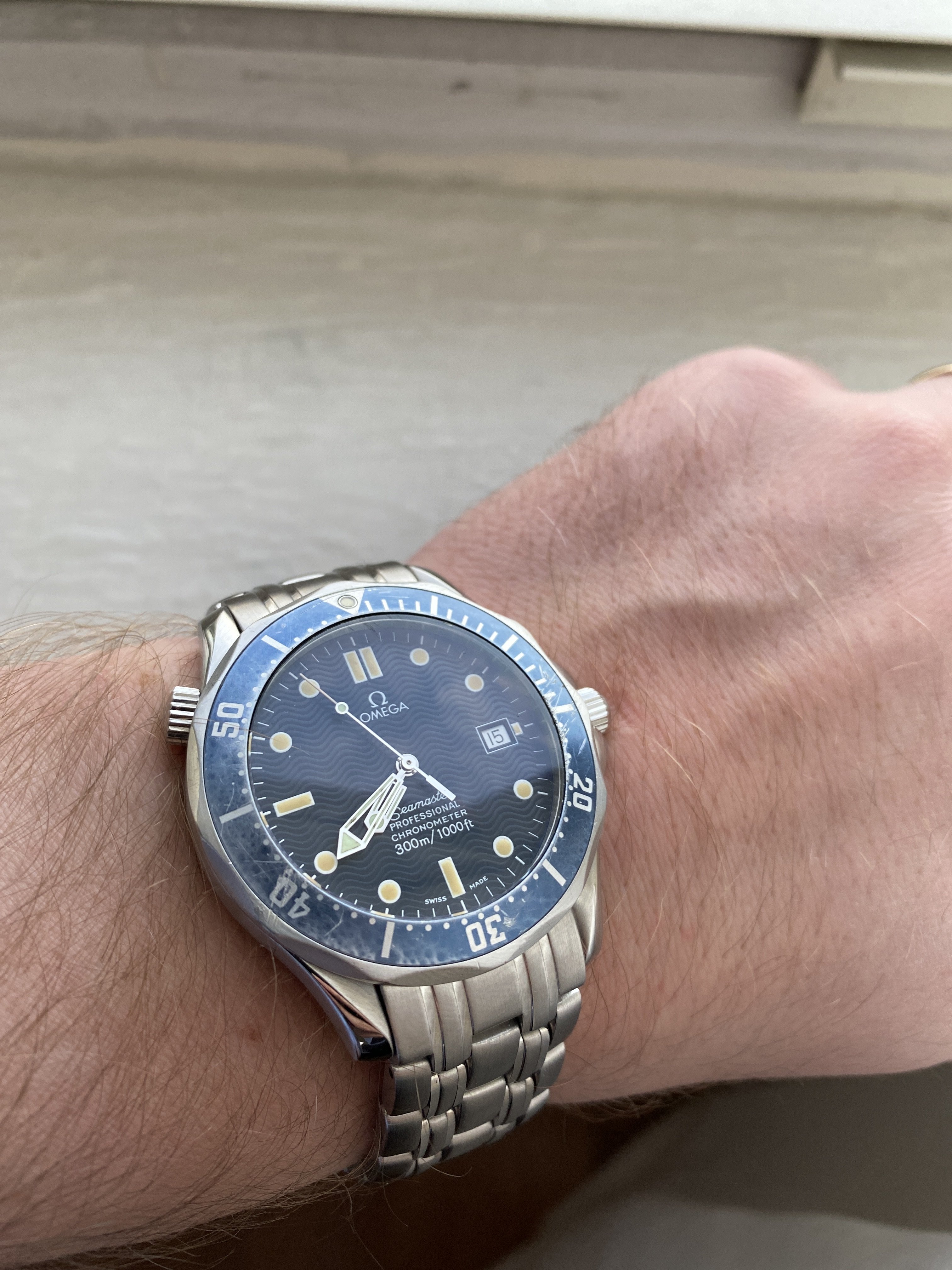

I recently came into possession of a classic 007 sea master (Ref. 2531.80). It’s a great watch, however I’d like it serviced to ensure everything keeps running smoothly. I’m located in Milwaukee.
The watch is keeping good time, however I think the self winding mechanism has some “stickiness”, and I want the rubber gaskets replaced and pressure tested so I can use the watch to its full potential. Also I want the bezel reviewed. While I recognize this is a harder style to rotate and that I don’t have expert knowledge on how this model’s bezel should move, I think the action is a bit stiff.
I don’t believe my normal watch maker has pressure testing ability, and my other biggest concern is I do not want my tritium dial or bezel swapped.
Does anyone have any recommendations?
Any suggestions greatly appreciated!

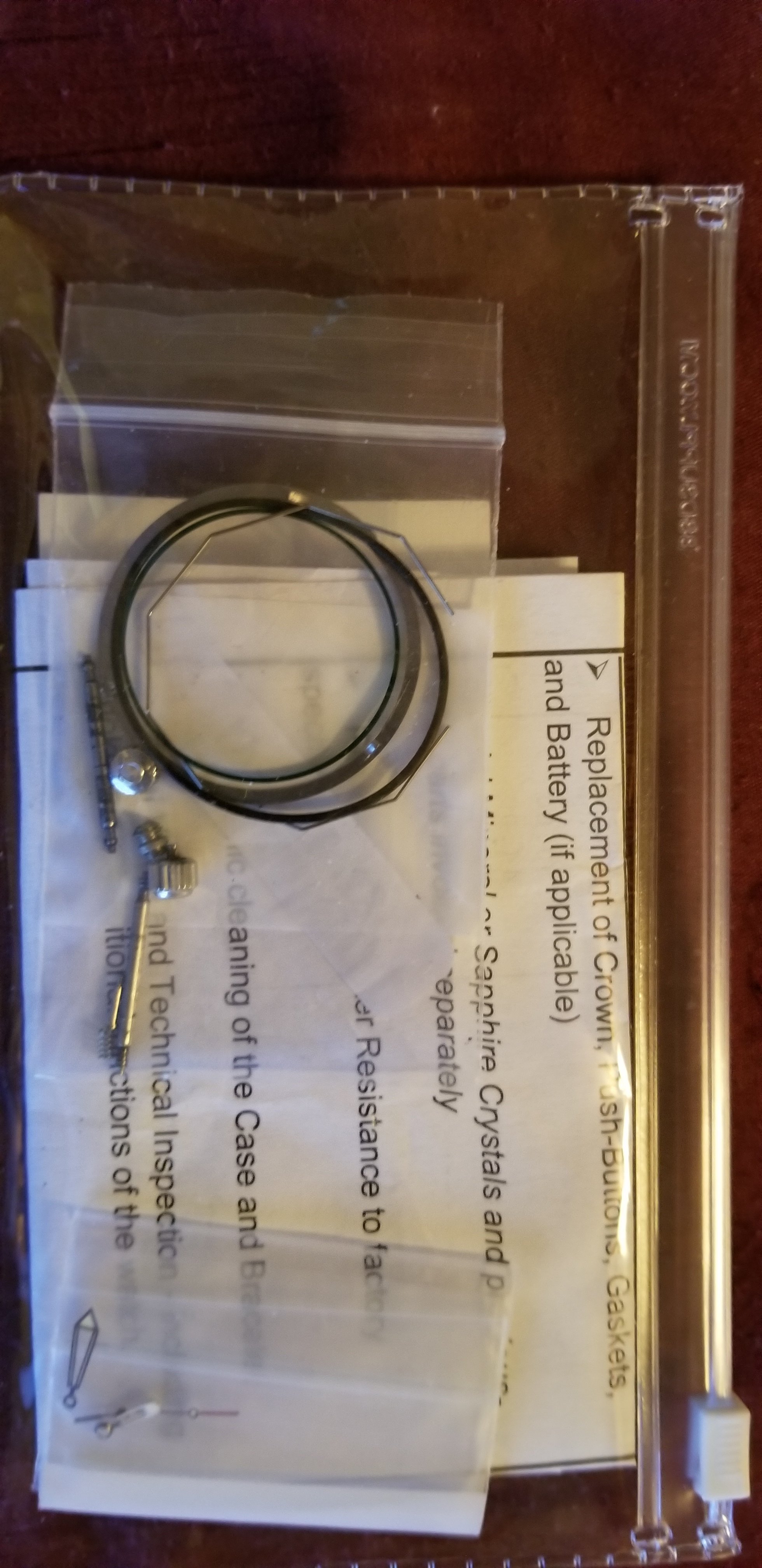

I have the same watch and after reading all the reviews on Nesbitts and others I eventually sent mine to Omega in NJ.. I had a great experience with them even during this pandemic , the whole process took about 3 months.. they replaced gaskets, hands and did an automatic service. I was totally ok with them polishing out the clasp and bracelet scratches and replacing the hands, they sent all the old parts back to me, total cost was just over $700
