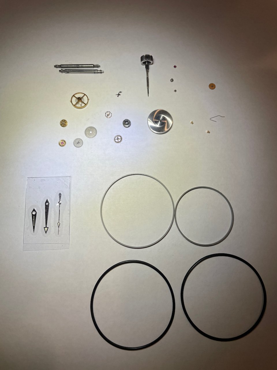

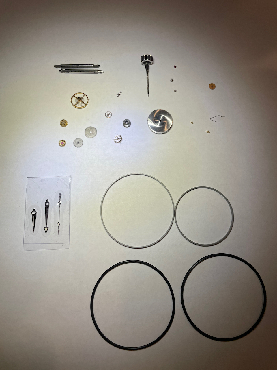

You should get a small bag of parts returned with the watch after service - please post a clear photo of them and that may shed some light on what was actually replaced.

Okay - received my watch back from service yesterday. So far keeping excellent time 0s lost/gained against time.gov in 24hrs. The Omega Boutique claims it was upgraded to 2500D and the beat rate does seem a bit different than before, plus the crown pulls out much farther than before. Here is a picture of the parts returned. What say ye? Is the OB full of it, or did they actually upgrade the movement.

If the watch was updated from a B to a D, then there would be other parts there. The main plate would have been changed. Very unlikely that this was "upgraded" in my view.
Does your invoice say what parts were replaced, what the movement version is, and what the serial number is?
498
248
I'll assume. If they completely replaced the mechanism with a new one, then they should return the old one.

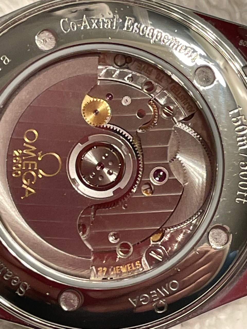

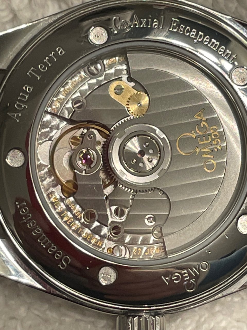

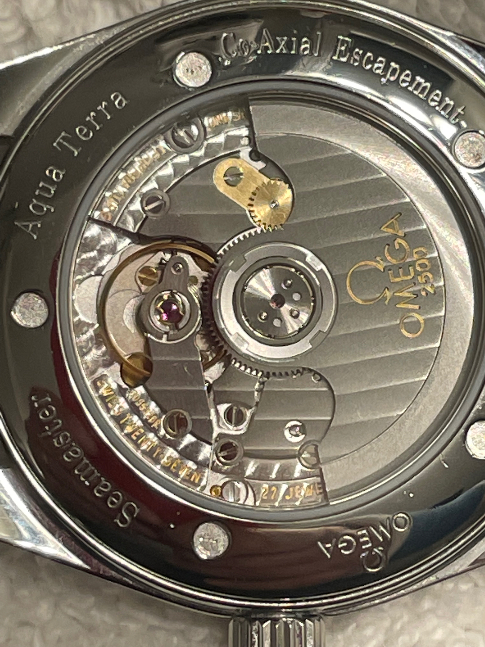

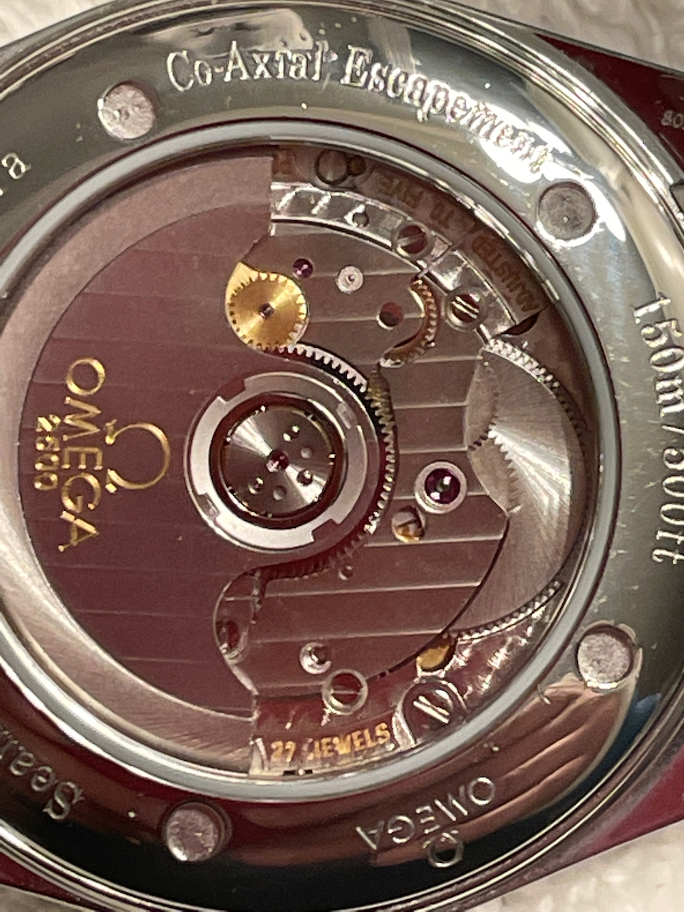

Here are a few macro shots of the movement after service in case it helps anyone figure out what was done.
30,261
78,109
As I’ve said, the only movements that are upgraded from one version to another, is the 3313. They have simply done a normal service, and the person giving you this information likely has no clue what they are talking about.
