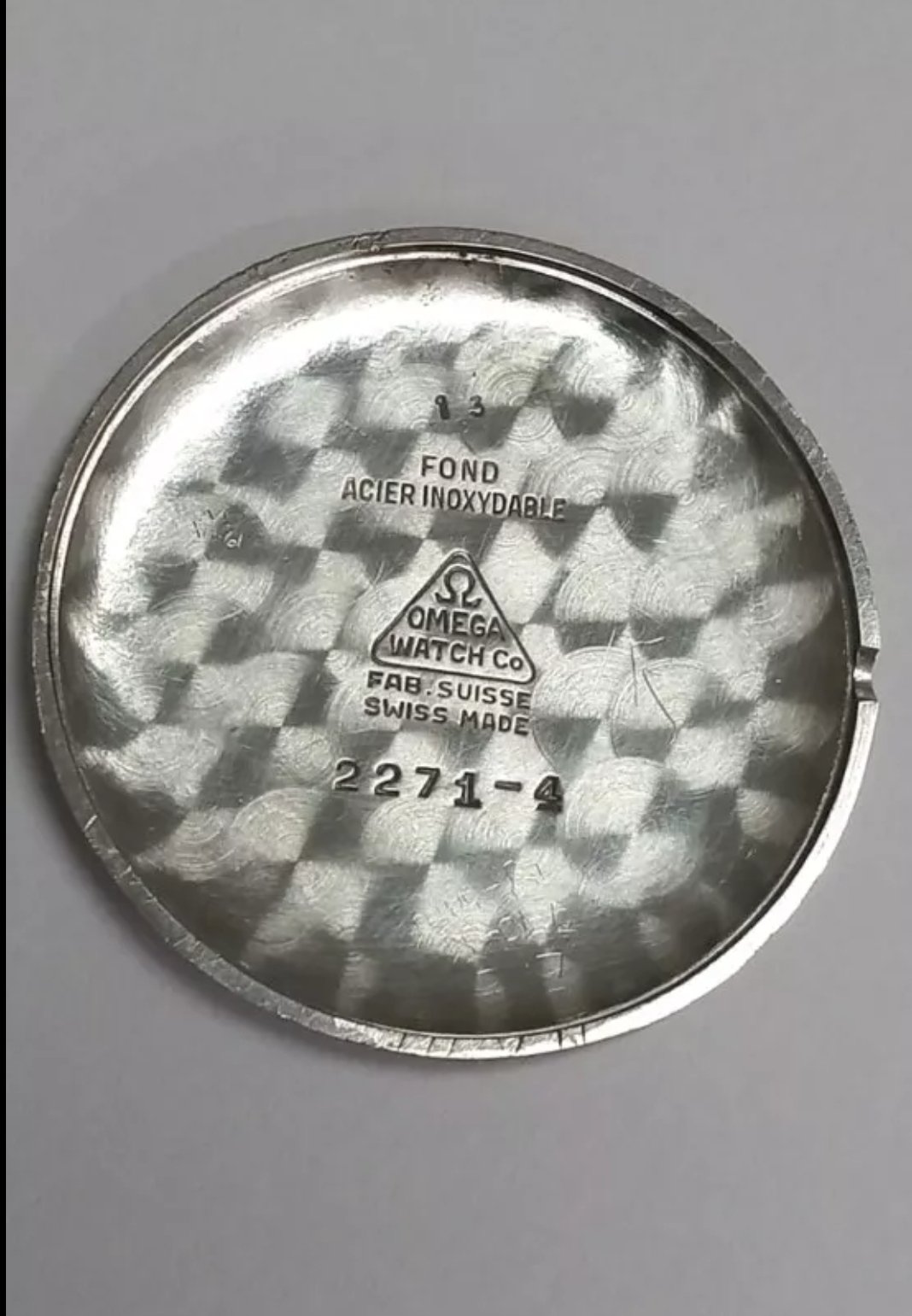

Boa tarde, vou me apresentar, meu nome é Diego e moro no Brasil, há algumas semanas venho pesquisando relógios ômega para fazer uma compra. Encontrei vários à venda, mas um em especial me chamou a atenção, o vendedor descreveu como todo original. Gostaria da opinião de especialistas sobre originalidade, pois o pouco que entendo é que o número na tampa não corresponde ao modelo. Desde já agradeço a atenção de todos. obrigado

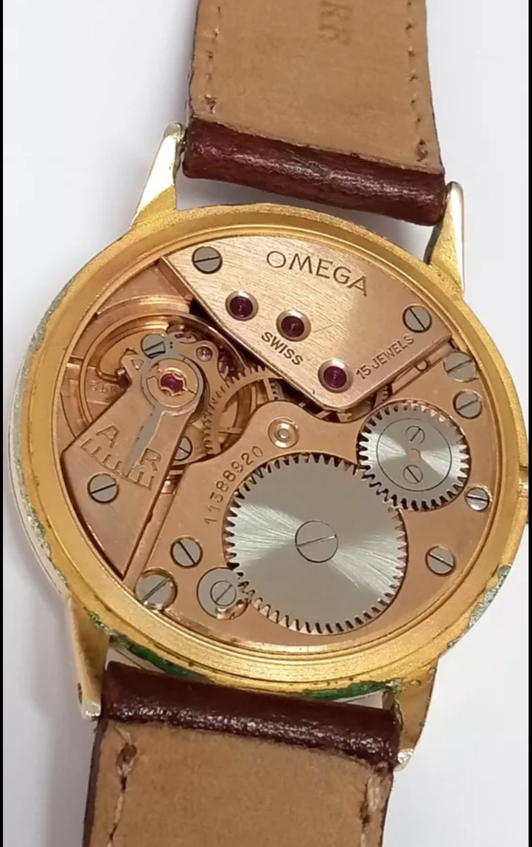

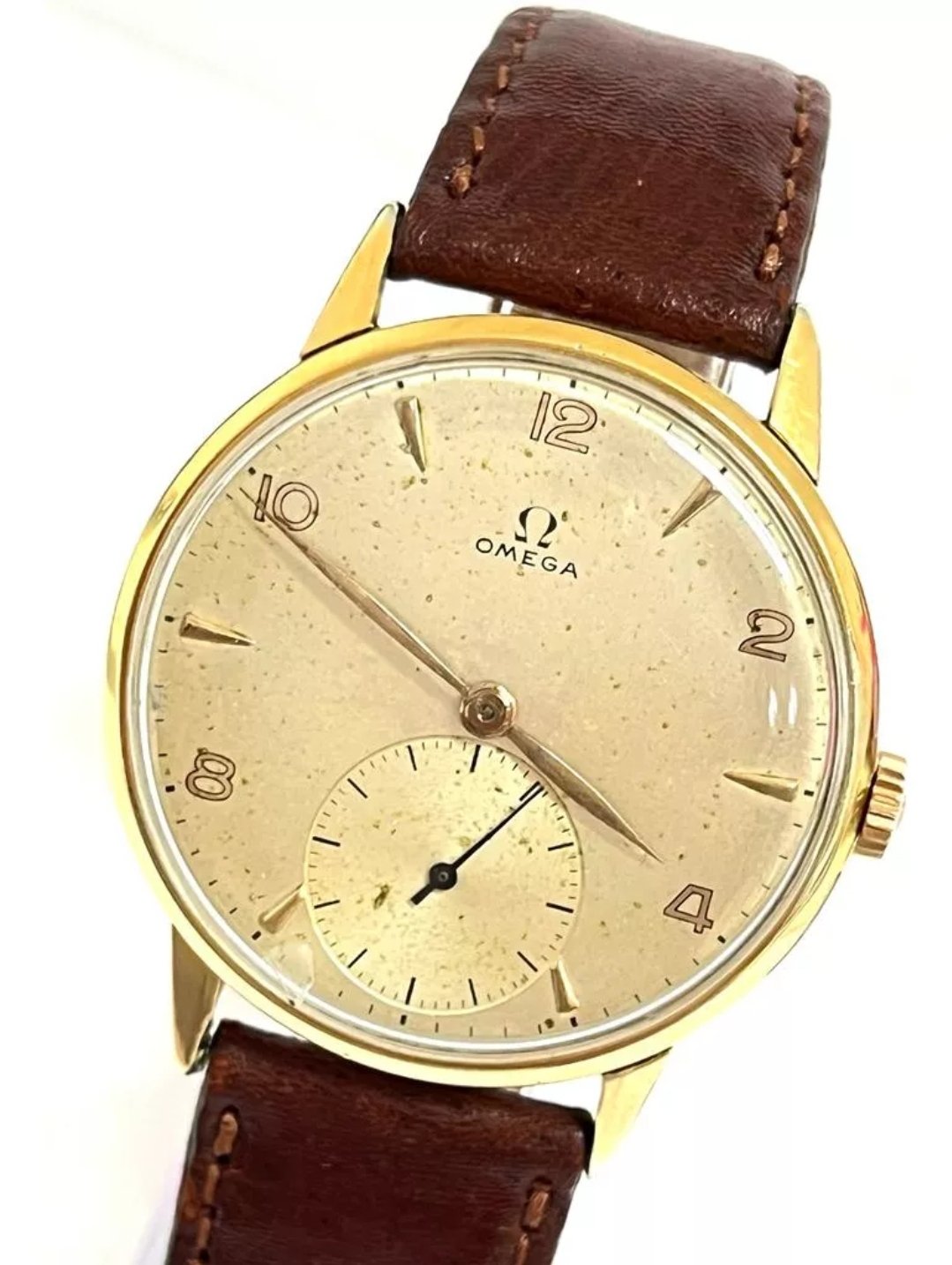

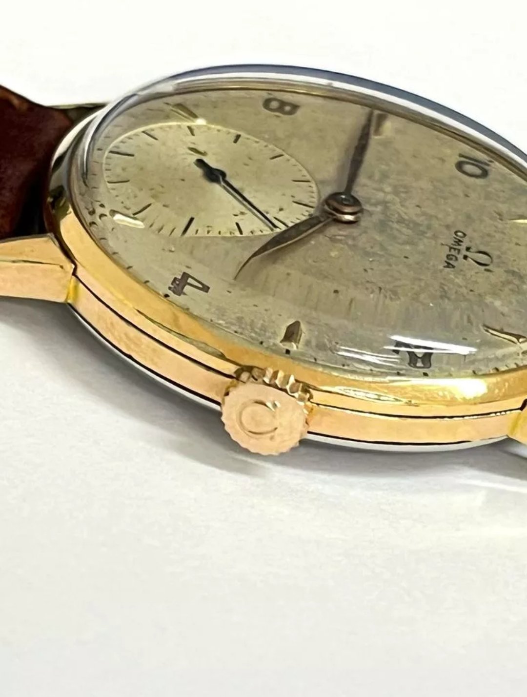

Looks like ref 2271 with 30T2 movement dates to approx 1947. Case reference and movement are period correct. Dial and handset have age spots but look ok to me- see what experts think. Crown is a service replacement. Movement looks pretty good. Case has had some polishing.
more experienced collectors here can comment further and correct my observations as needed.

That case is in very bad condition. There is wear through on the lugs and bezel. That’s shame, as the movement, dial and hands look correct and are in decent condition.

Restoring/replating the case is possible at a cost, but then the shiny new looking case will not match the spotting and patina on dial and handset. And you will have a vintage watch with no real attraction to a collector and you will not come close to recouping your investment. if you think you will never want to part with it, forget that as you will move on to other things for sure and regret putting money into this- it’s the fate of all collectors.
