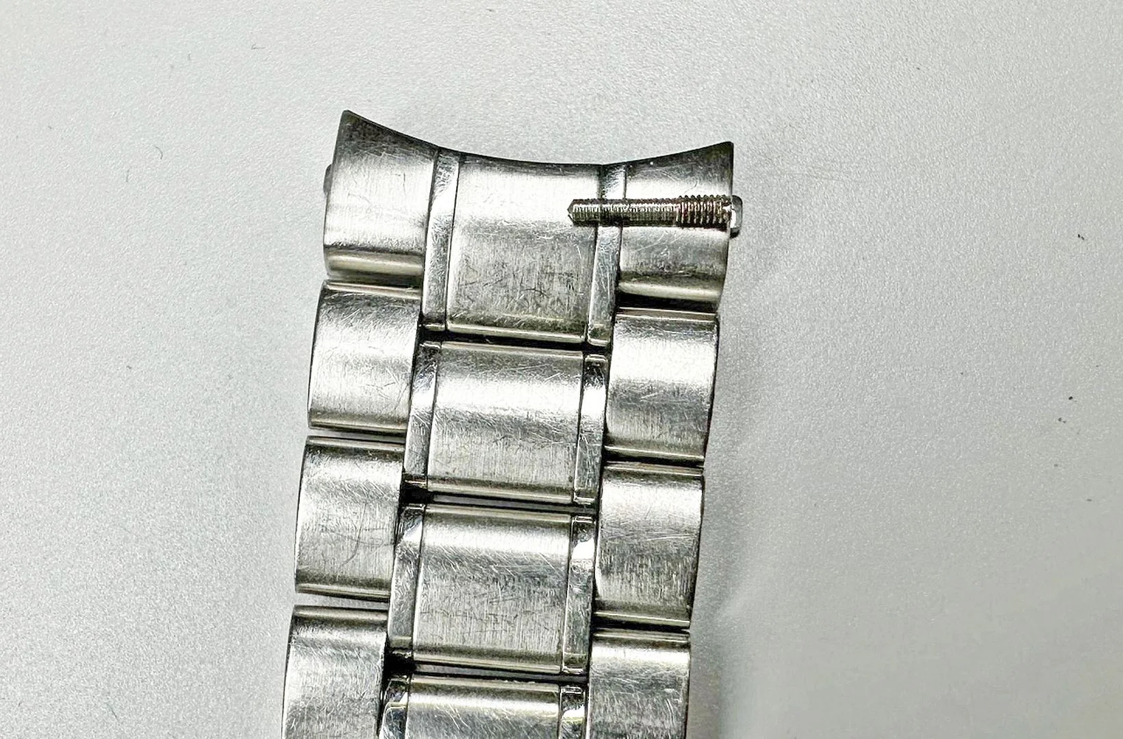

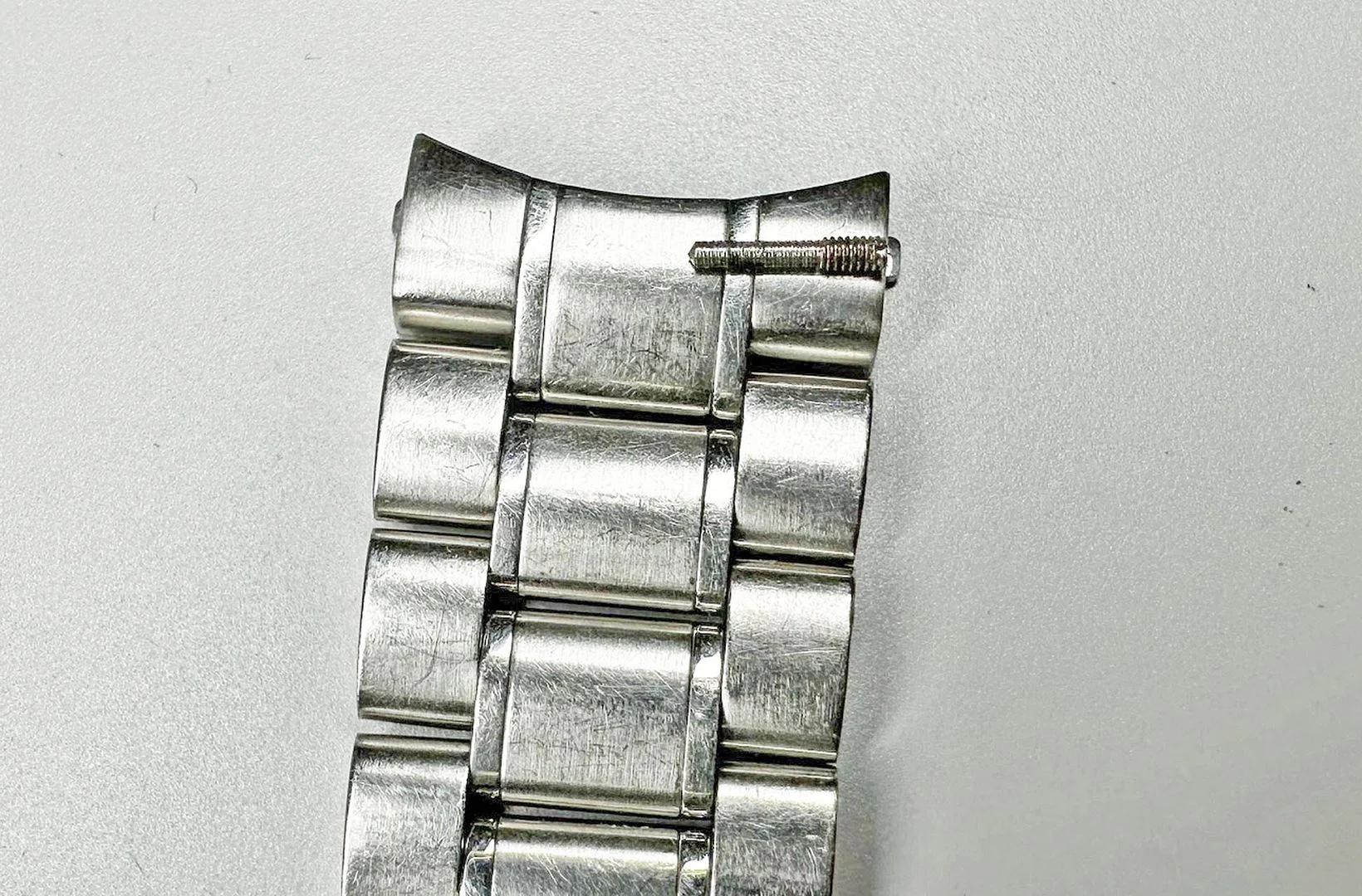

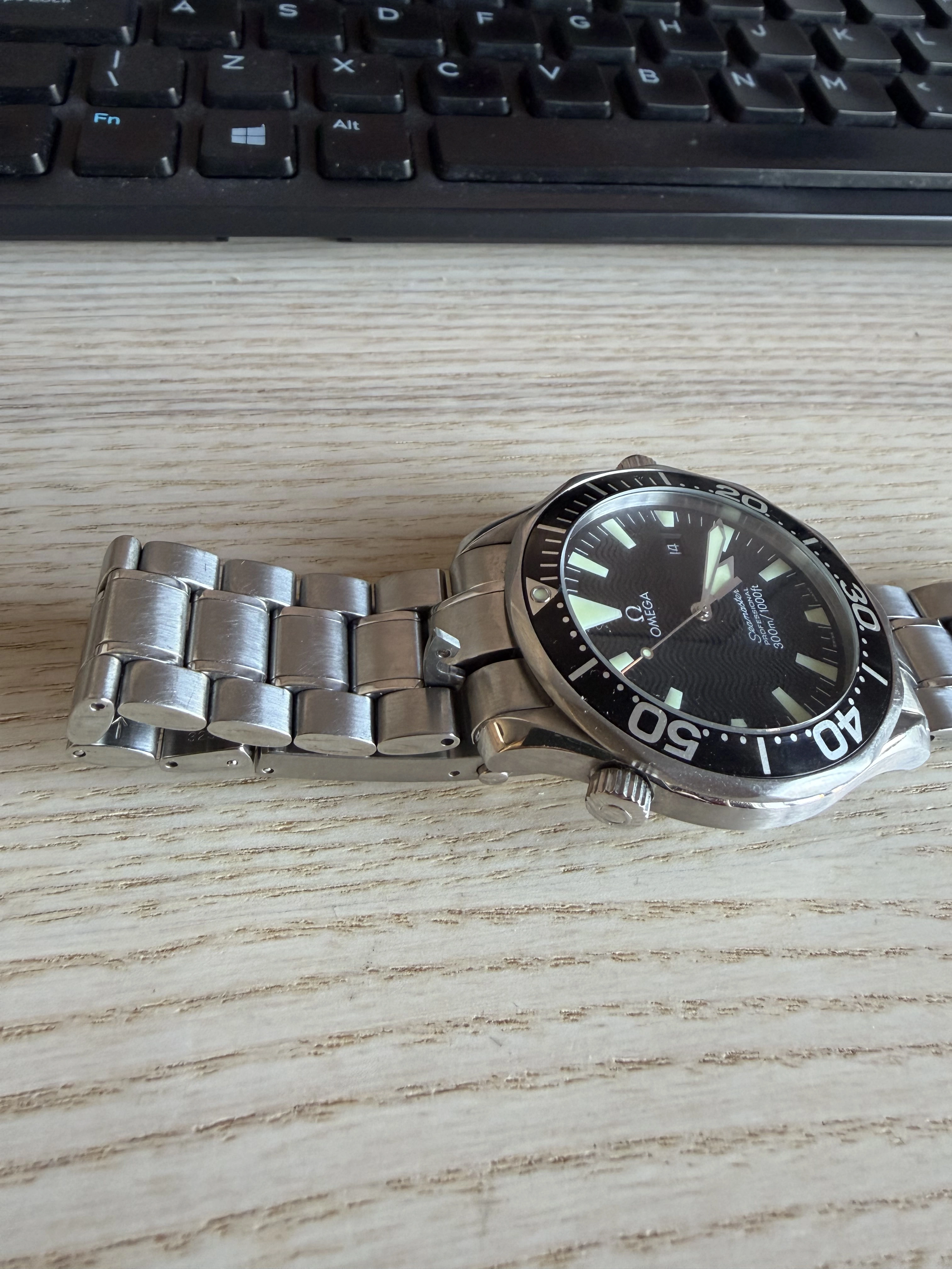

As you can see from the attached pic my Omega 2254.60 watch strap has a bit that sticks out of the end link. A small pin must be missing. This means I am unable to wear as catches on sleeve.
Please can annyone advise on what part I need to fix - is it just a pin or the end link itself?

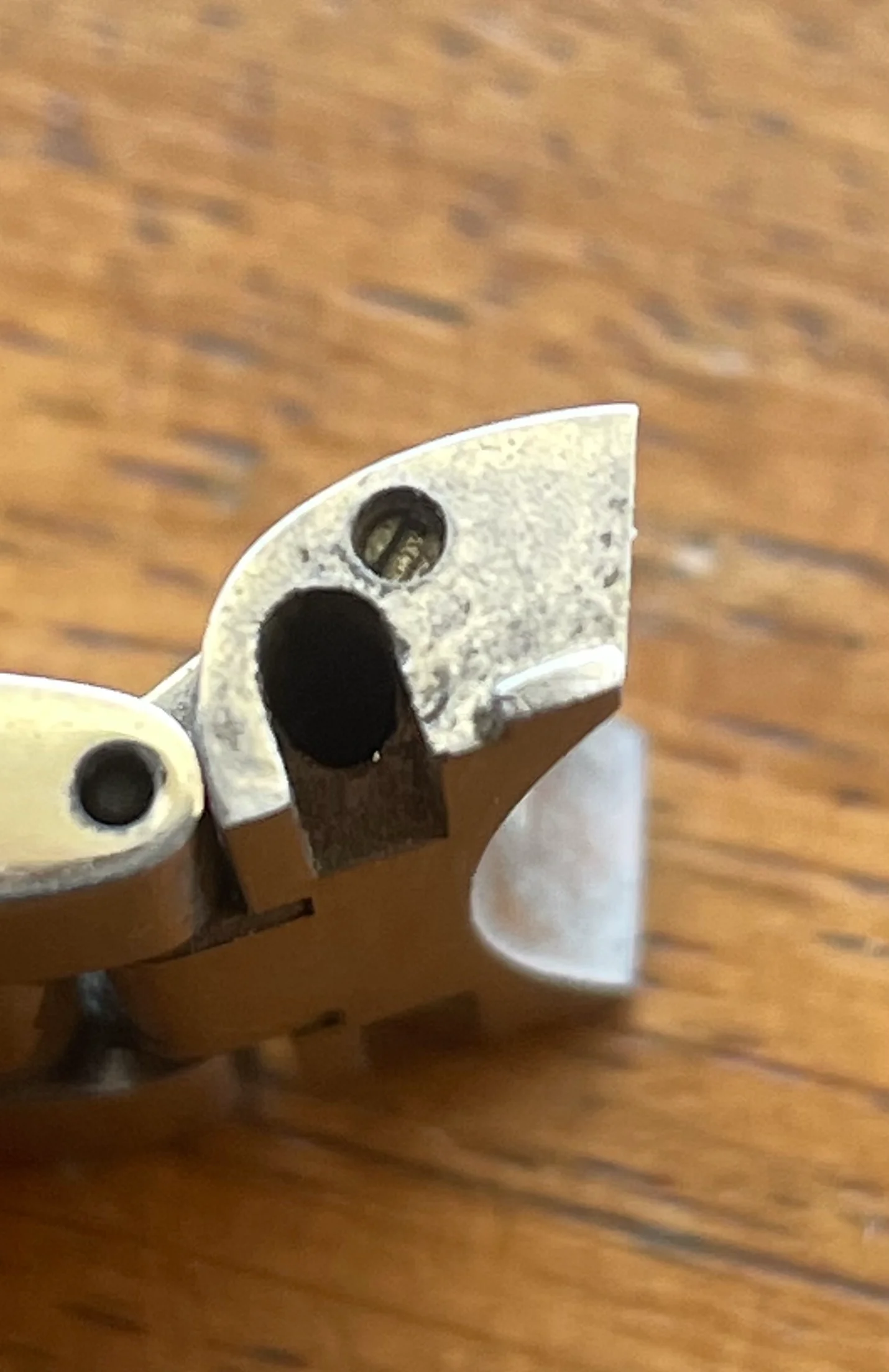

I took a look at my bracelet and it looks like you a re missing this screw:
1,130
1,180
You missing a pin that runs the length of the endlink. And perhaps the screws on each side that would keep it in place when it's not installed.
6

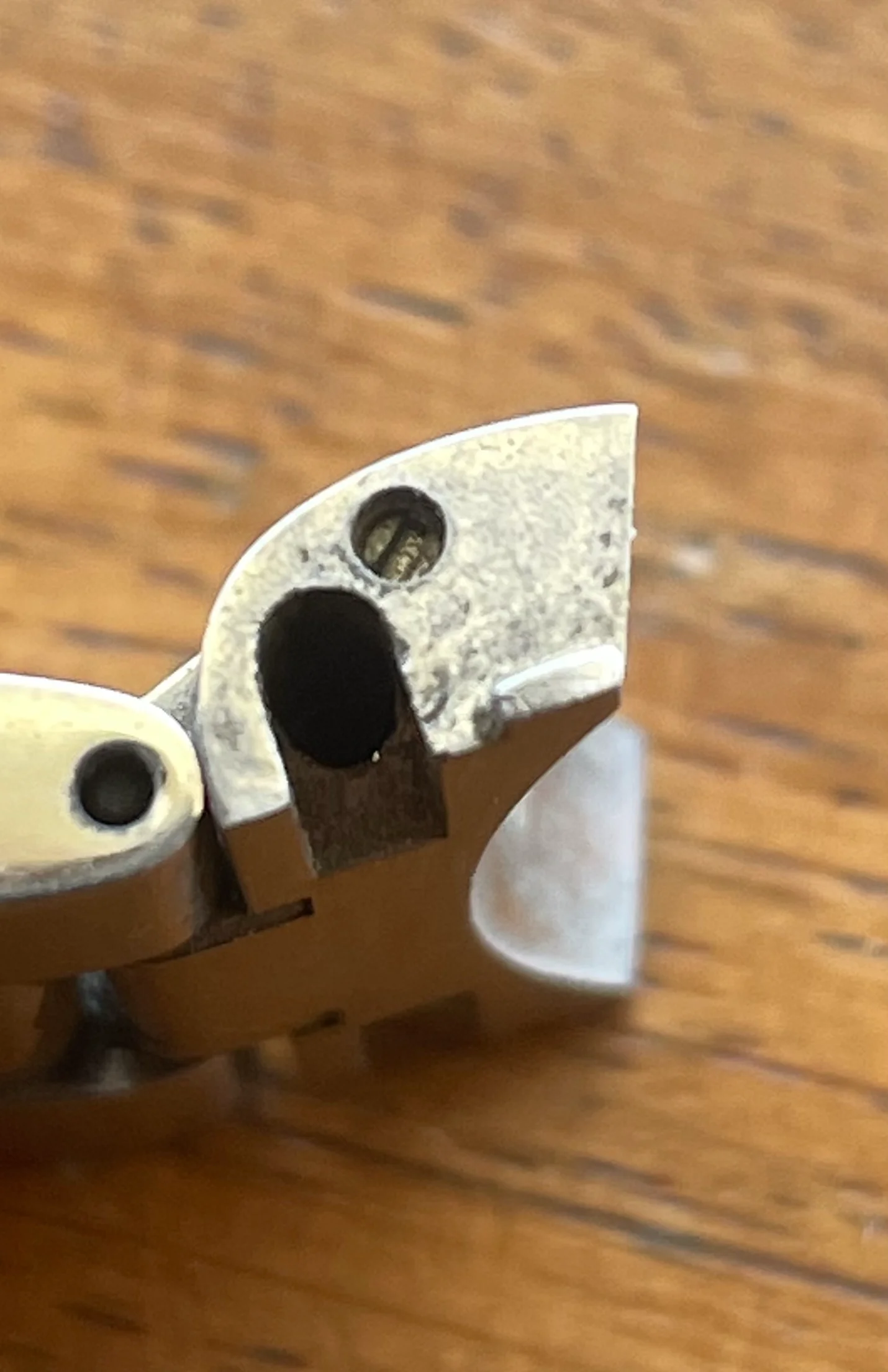

Yes I’m missing the tiny little screw in one side. Any idea where to source a replacement screw?

The only screw listed for the end link is this one...
124ST3101 | SCREW W/H S1.40 L7.7 STEEL​

Just ignore that - there is no pin and all you need is the screw.

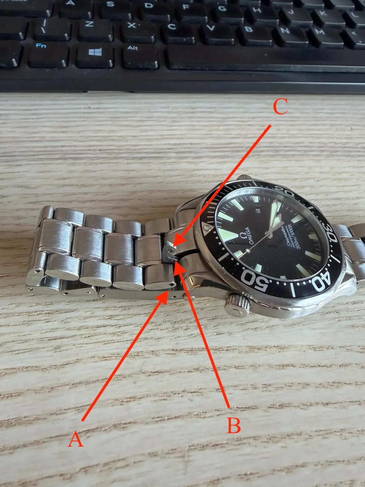

You really only need the little screw Archer gave you the reference for:
A) Full length pin (which you obviously have)
B) The springbar goes through this opening
C) Short screw you need goes through this hole
