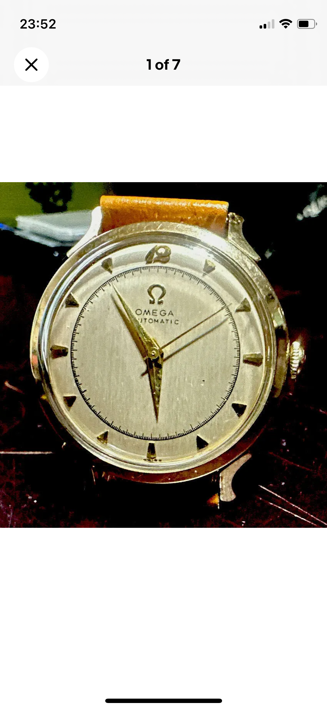

Hi all,
Found this on eBay and it seems nice, but was wondering if it is redialed. Due to my lack of experience, I need your help.

I’m betting it’s redialled and that the sweep second hand is missing a tail.

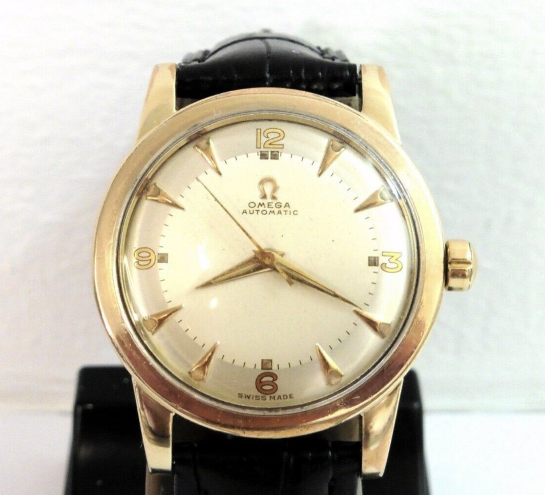

Three of those 4 are redials
912
1,255
Which one it isn't?
Just to have it as reference.
Number 3 is the one which looks the cleanest. The print on the others is really sloppy on the omega text and indices.

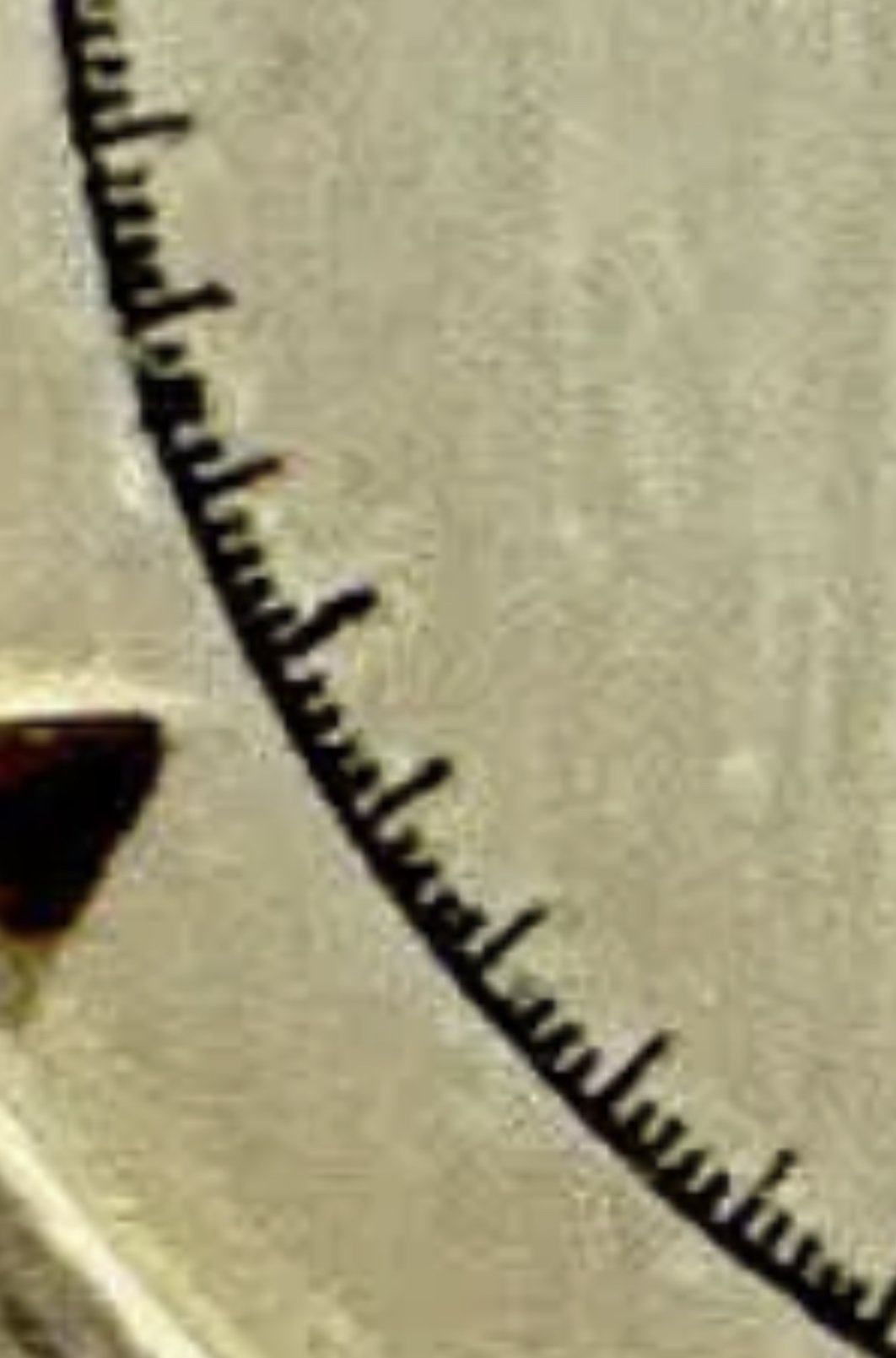

These pictures look like they were taken with a Nokia 3310…
Quality aside, the minute marks are very badly lined up… some are missing, some are doubled up, none of them have the same length.

Also worth watching the lugs, I think several of them you have attached (perhaps also the first one) have some bend in one lug. Easier to tell with a face shot, without perspective.

Almost every dial in this thread has been VERY poorly repainted. I would suggest taking some time to observe and study.
