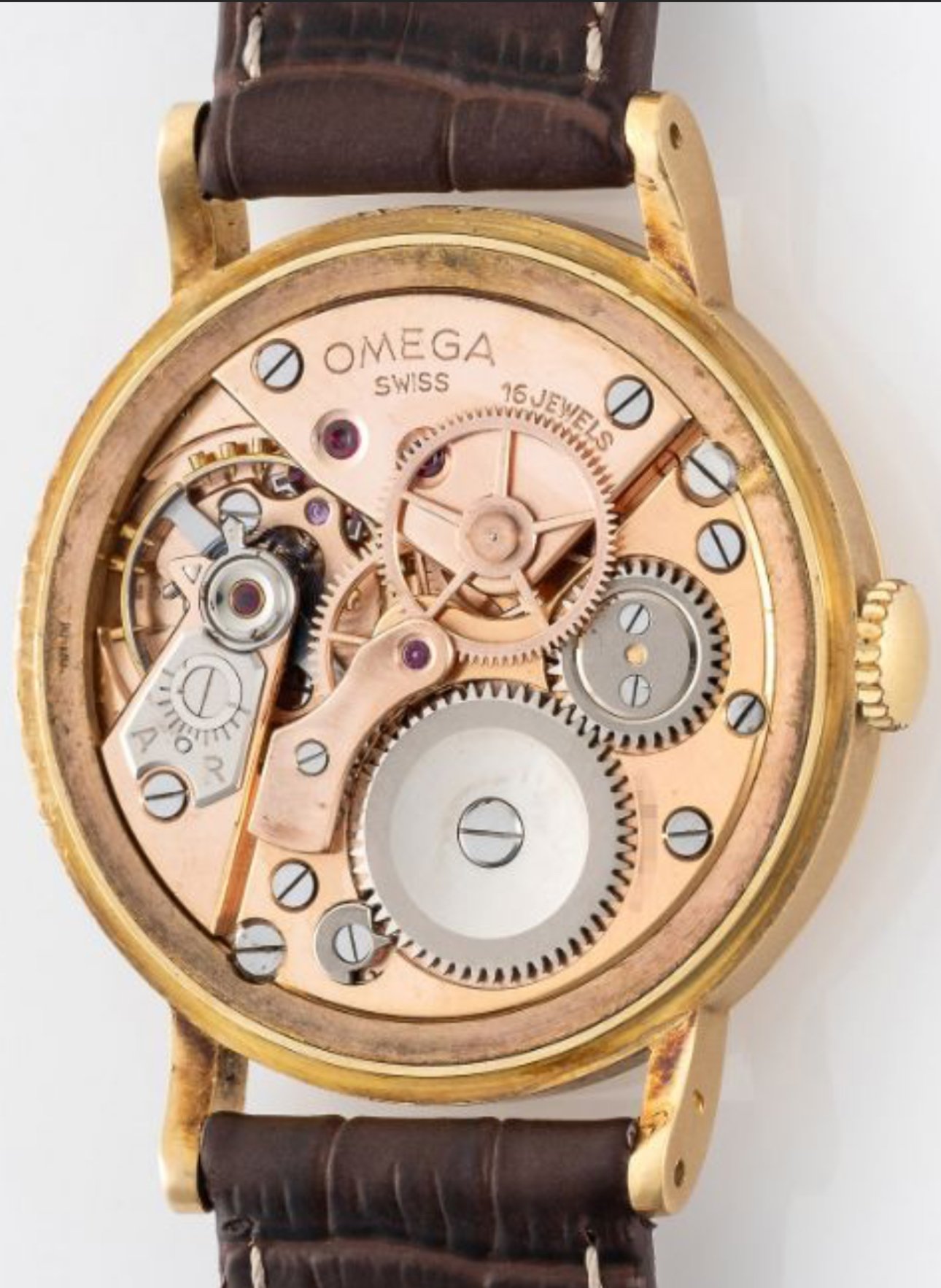

Omega 1940s 30T2 SC RG, 16J movement

Highly processed pictures....so, I have no idea what the dial actually looks like but fonts and spacing seem OK.
Movt screw heads are very nice, even through the blurry picture.
Tarnish is a good thing on 70 year old 14 or 18kt gold.
Any better pictures?

Better pictures are in the link.
I took a screenshot. The dial looks good and original to me. The movement as well.

That’s British £’s. + 26% at end of bidding. Have you checked EBay to compare? Bear in mind they say it’s a larger 36 mm size

Is the movement missing the “arrow” indicator that swings between A and R to adjust the movement’s speed? Sorry I don’t know the technical name

Regulator. On this design. It sits under the bridge and is set by the screw in the plate

Due to the Brexit consequences I seldom bid in the UK recently. The watch was tempting though. dial original and not bad for its age. but there are also issues: soft case (most likely polished), movement shows different colours in the plating, so likely put together with plates from at least 2 different movements.
