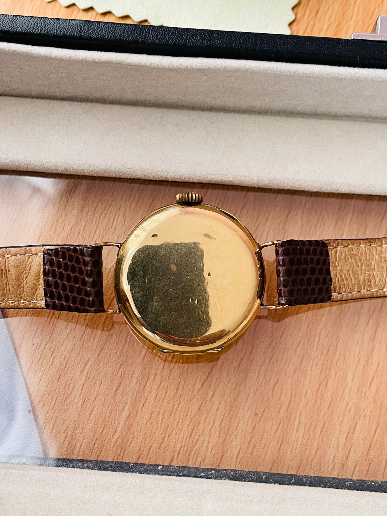

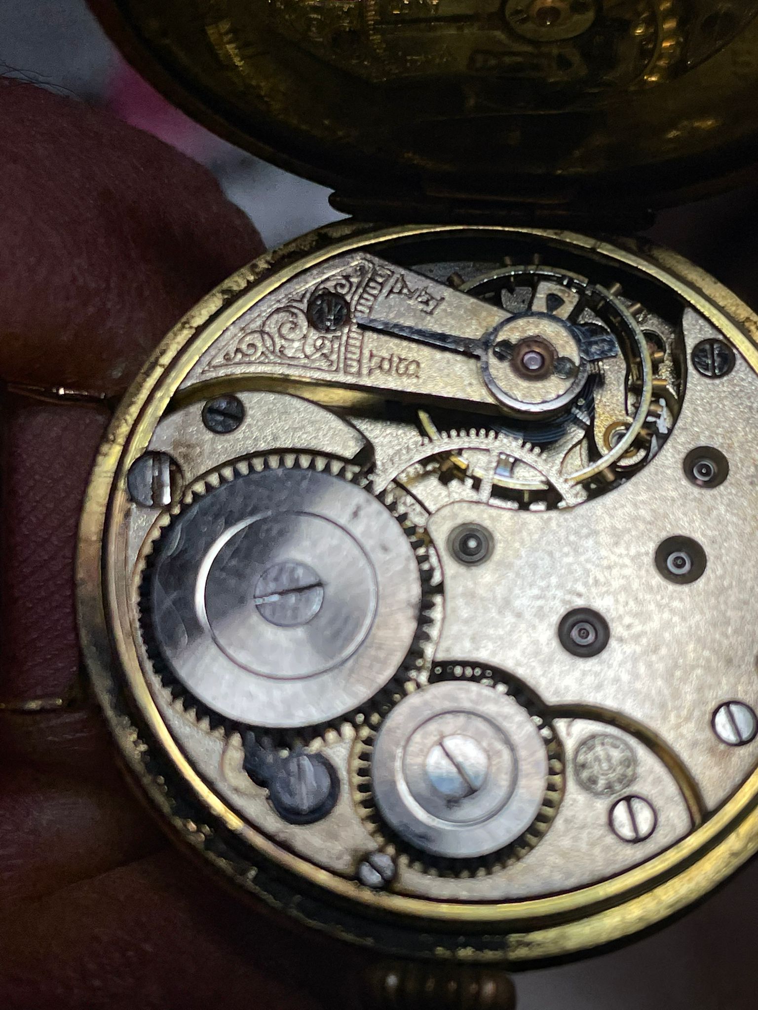

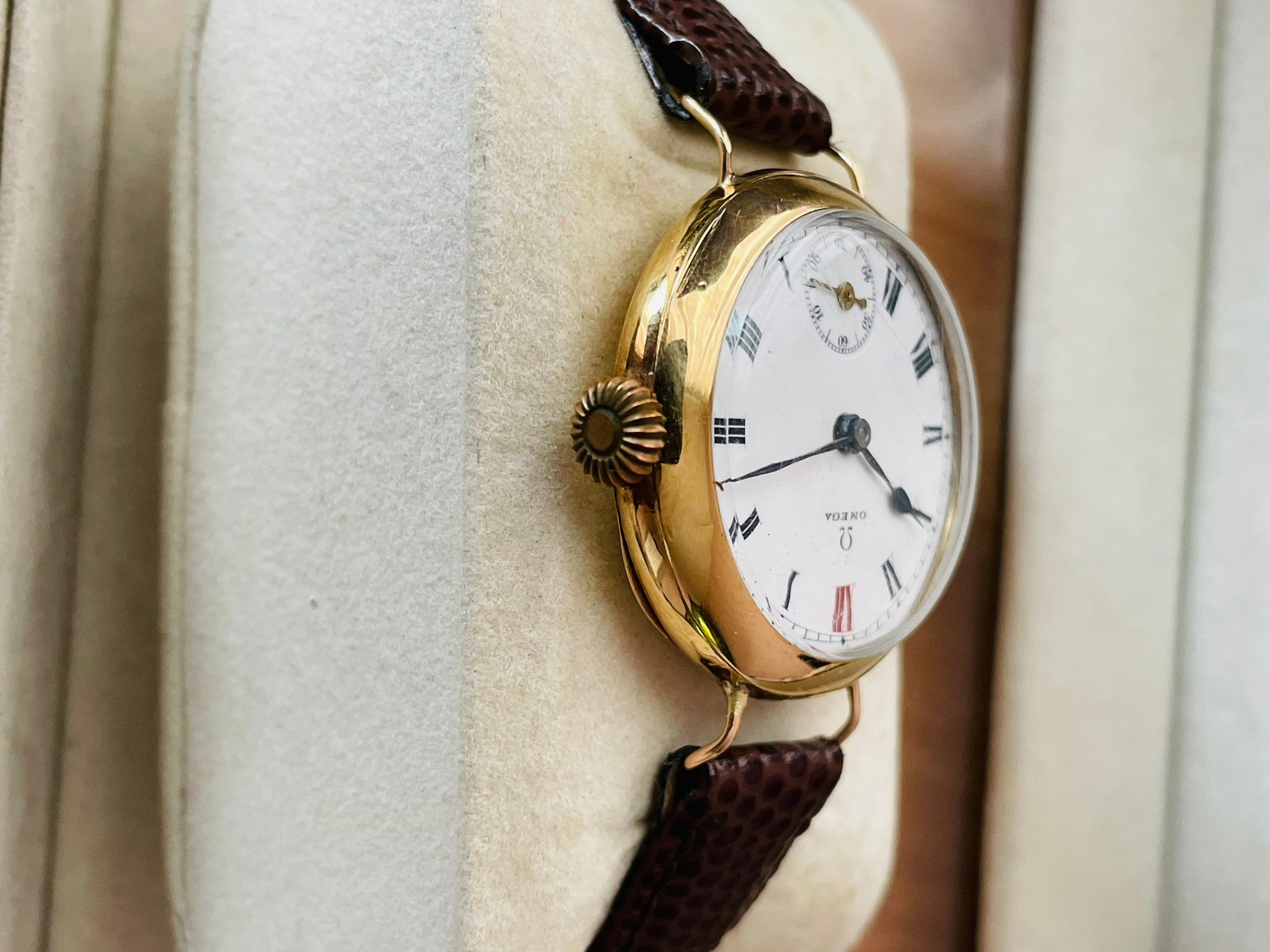

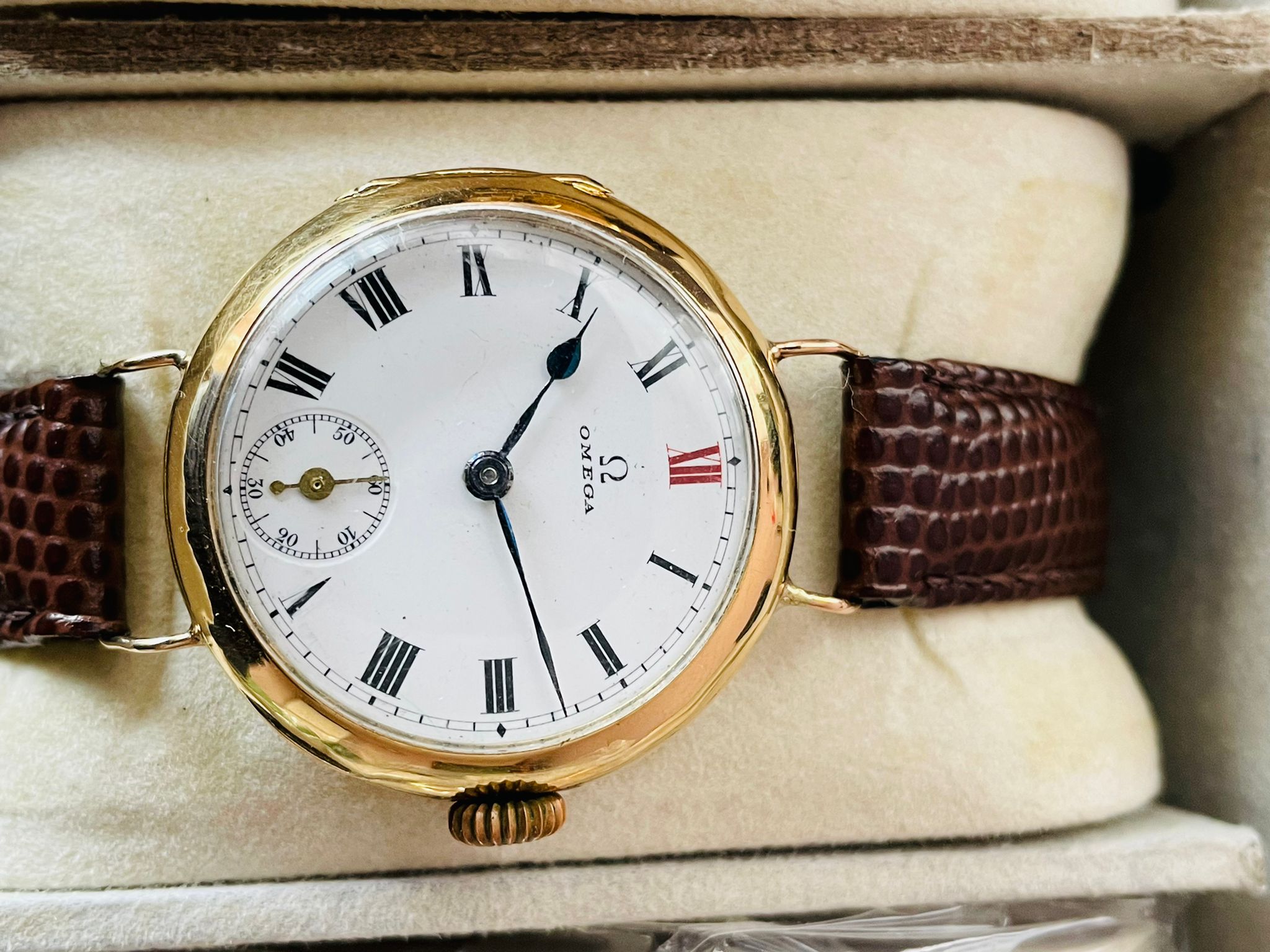

Hi, just came across this omega trench watch. It's in an 18ct Solid Gold case. Any thoughts would be appreciated. Thanks.
3,593
8,210
Peter, you have me stumped!

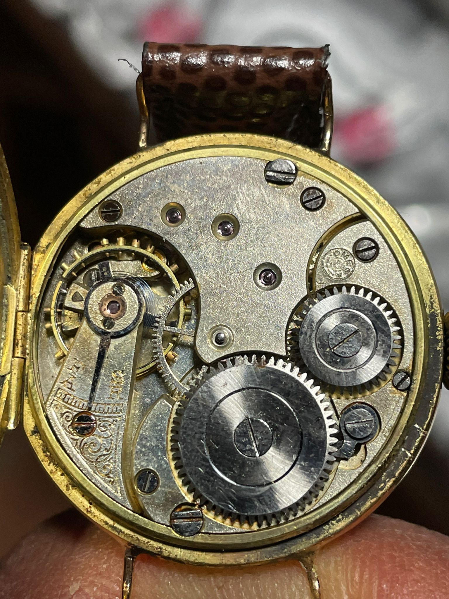

I can't find a movement that matches yours very closely and that ratchet wheel coming all the way to the movement edge is easy to look for.
I can't say I've seen that type of logo on an old movement before either.
What size is it?
Any chance to peek under the dial?

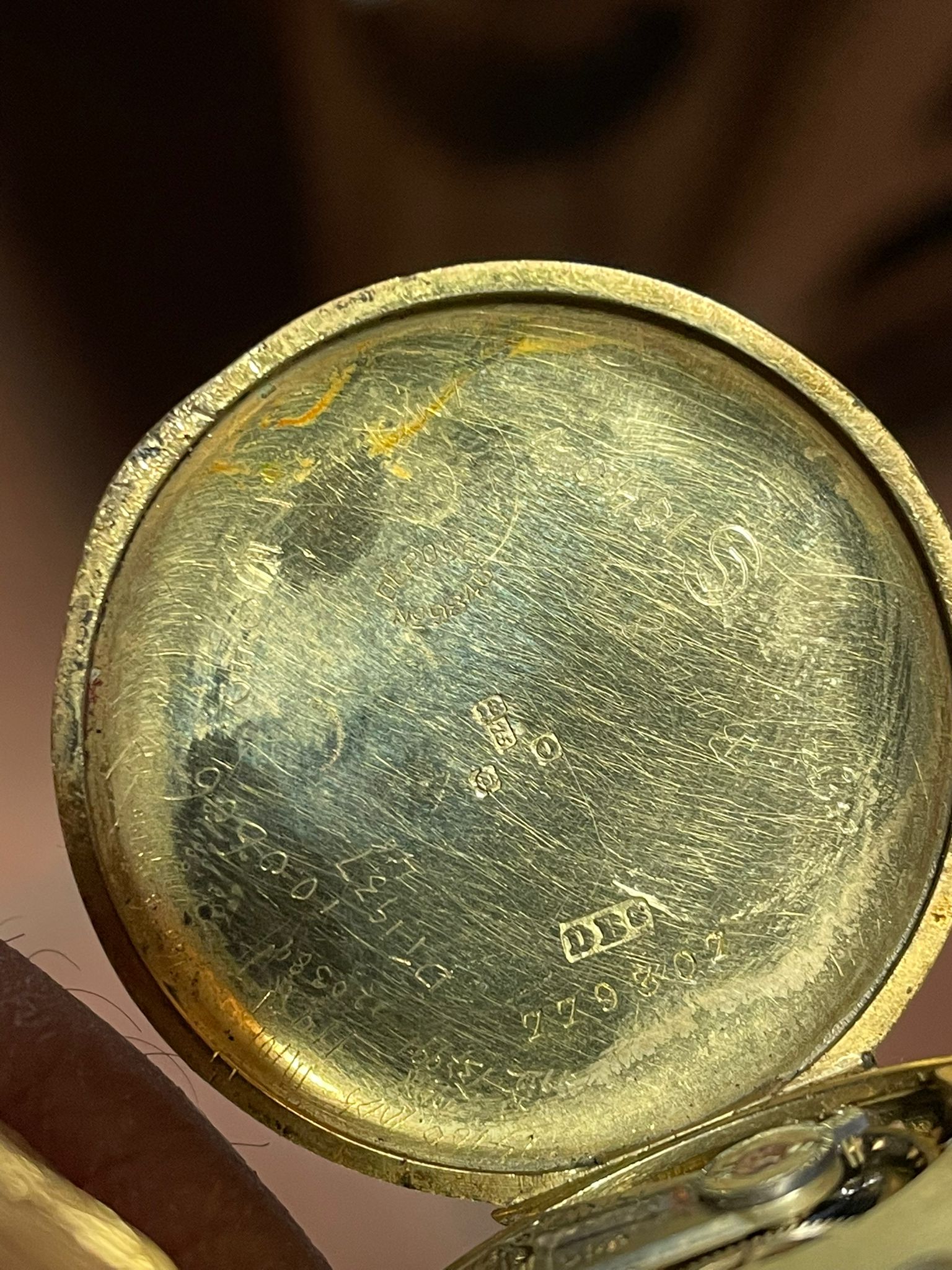

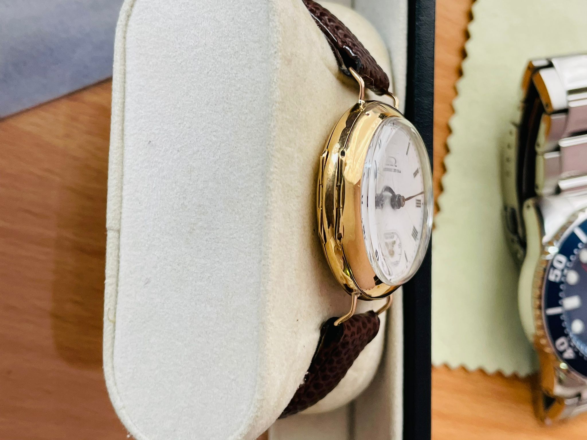

Dial to delicate to touch for me. The hallmarks seem to suggest a date of approximately 1904 from my research. I have seen the omega stamp on early movements before. The watch seems to have London import marks. Makers name I can not find anything for. Size is 35mm including the crown.
3,593
8,210
Caliber 12''' could be about the right size and has the click in the right position, otherwise I don't see anything that really seems similar.
Time frame would be right, also.

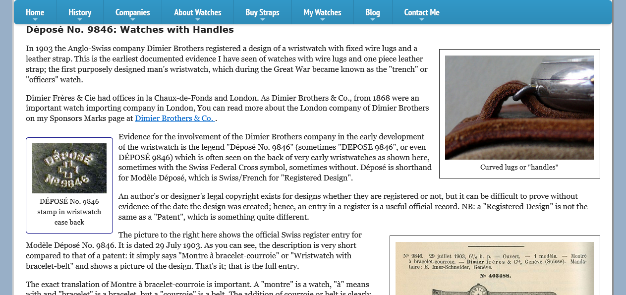

Case mark looks like the Dimier Brothers which would also be the right time.
Can you make out the Depose number clearly? Could it be 9846?
947
605
Dimier Brothers seem to have registered the depose 9846 which is registered on my watch.
3,593
8,210
You replied while I was editing.
Well that ties this in with one of the earliest ! Very, very cool.

Hi, I know the thread is a bit old but thought I'd let you know the date letter O for London would be 1909.
