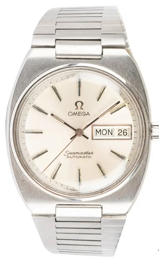

Hello, I need to replace the acrylic crystal with steel tension ring for my Omega Seamaster Day-Date 166.0216.3.
Can anyone provide the correct part number for this case?
Thanks in advance.

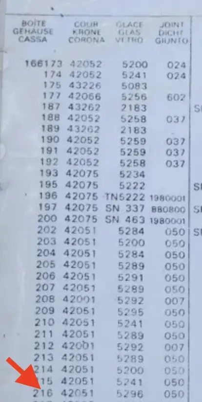

Thanks, I've already seen the list and my case number is not listed.

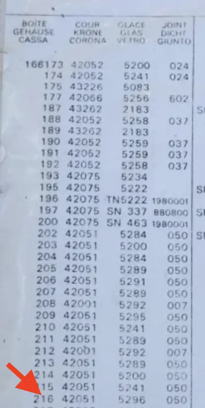

Your case is listed.
From the document posted in the link. Reference 166.216, crystal 5296.
4
Oh, I was looking in 166.0xx's as I tough 166.216 is a different ref. thanks.
24,823
55,209
That leading zero ... sometimes there, sometimes not.
