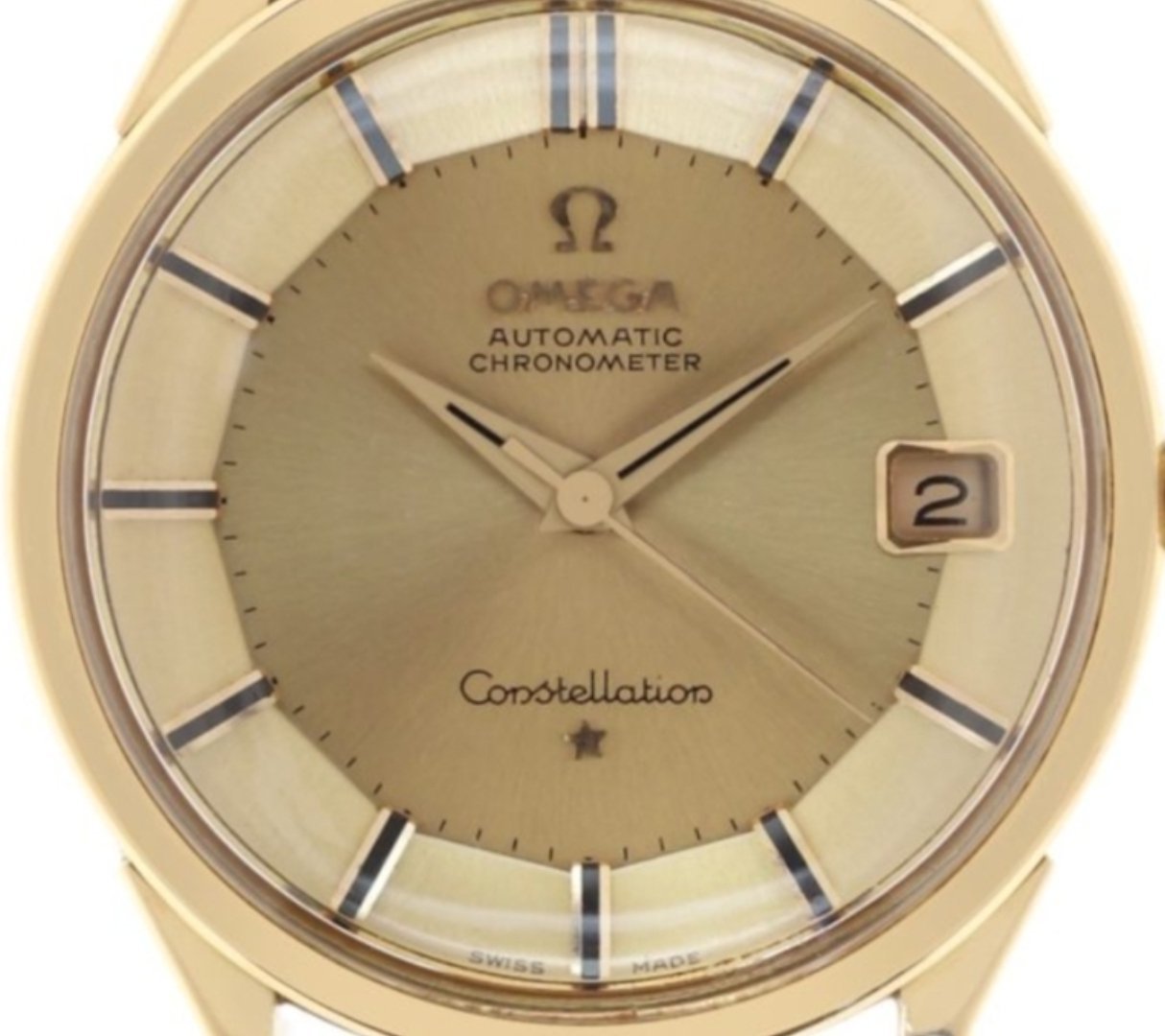

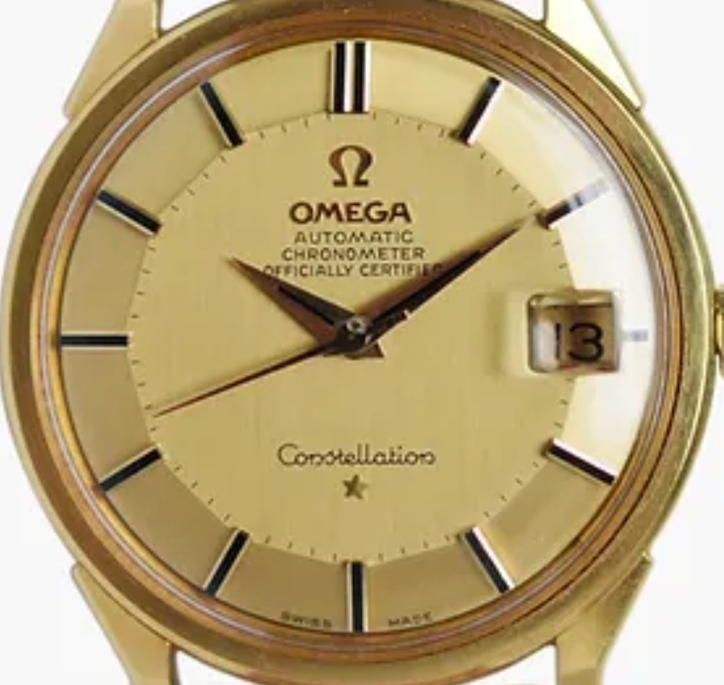

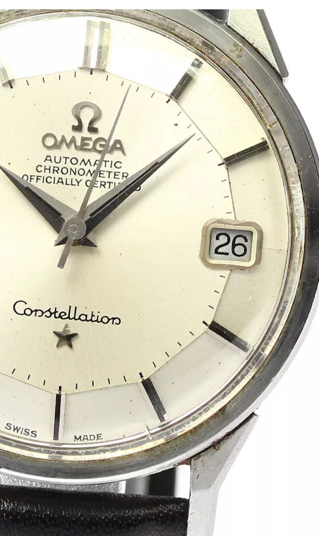

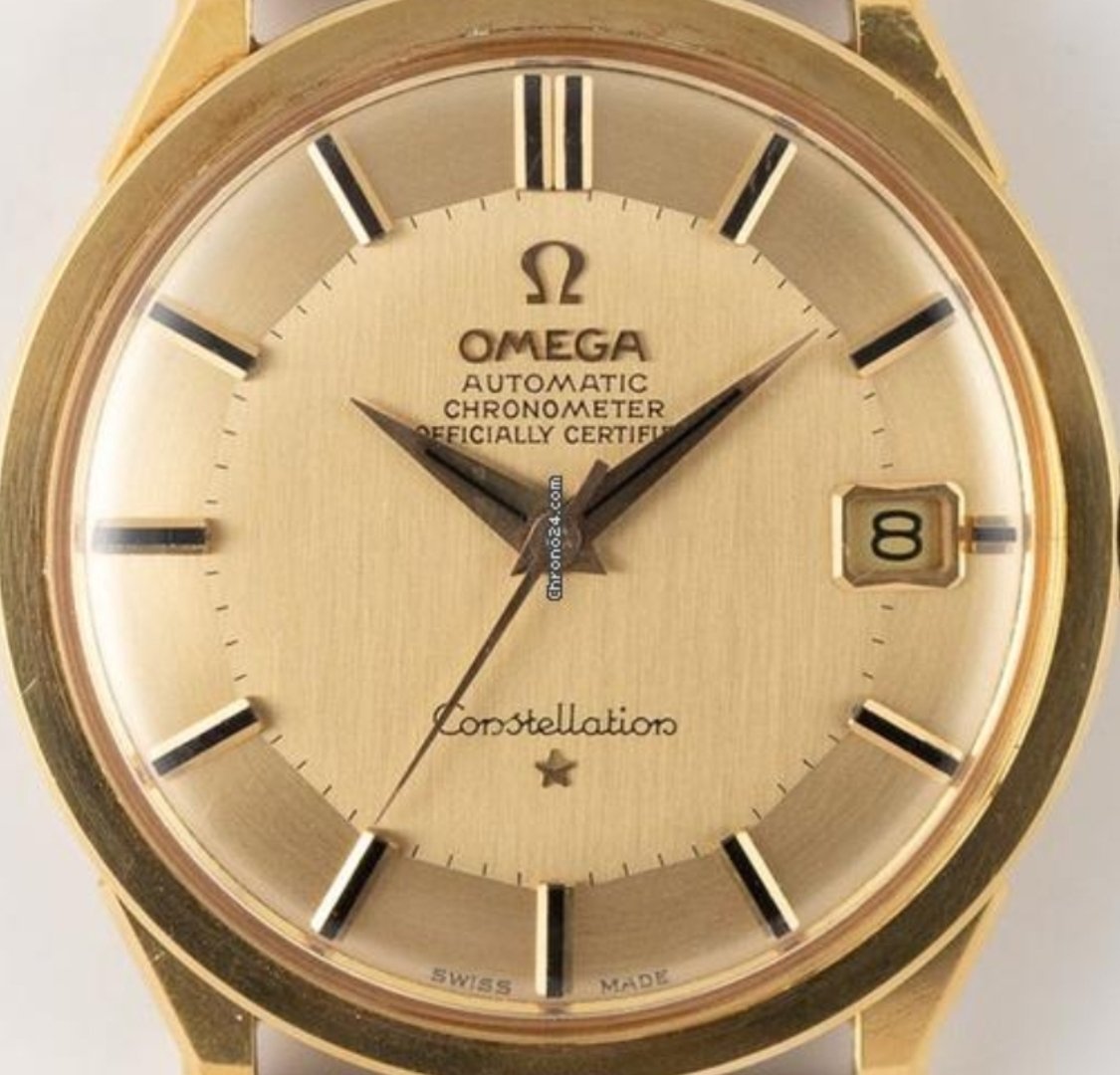

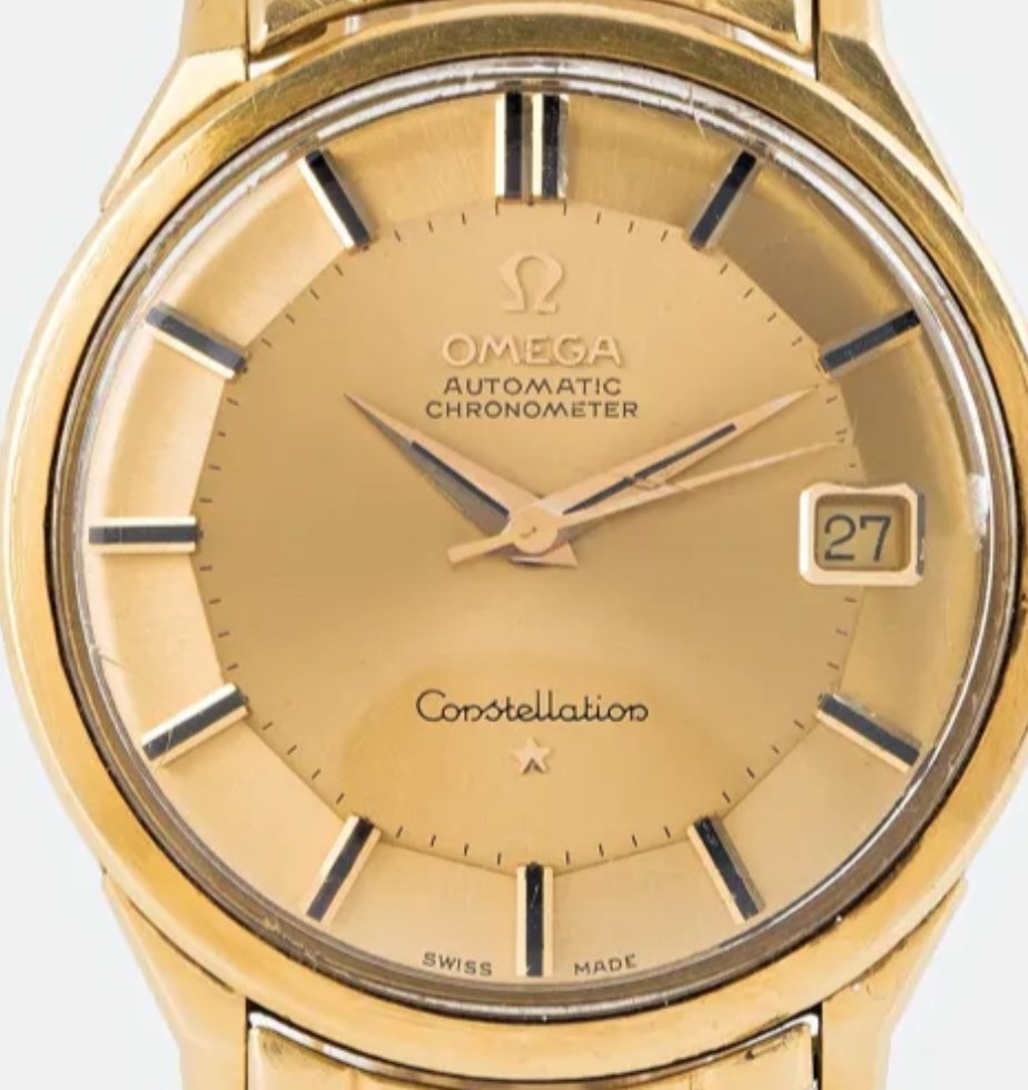

Hallo friends,
I searched for Constellations 14902/3 with pie pan dials.
(I did not find a thread answering my question. And I have not seen this on an allmost identical 168.005/6)
I came across two different dial versions
  • version 1 with full text ..'officially certified' and an index marker at '3'.
  • version 2 without the text ..'officially...' and without the short index marker at '3'.
(see pictures)
=> Are both versions valid and original, what is earlier or why these different dials?
Konrad
6,835
10,505
Firstly, the examples you show all look like deluxe dials.
The ‘missing text’ dials were the tail end of Omega’s dial experiment.
I believe both types are valid.
No-one knows why Omega allowed the production of dials without the 3-index ( it’s a subject that @hoipolloi finds particularly vexatious)
It is likely down to different dial manufacturers - and continued into the 168.005 references.
Given general timescale of other references with missing text dials, sense would dictate the missing text dials are earlier than the full text dials - but that is just an assumption.
