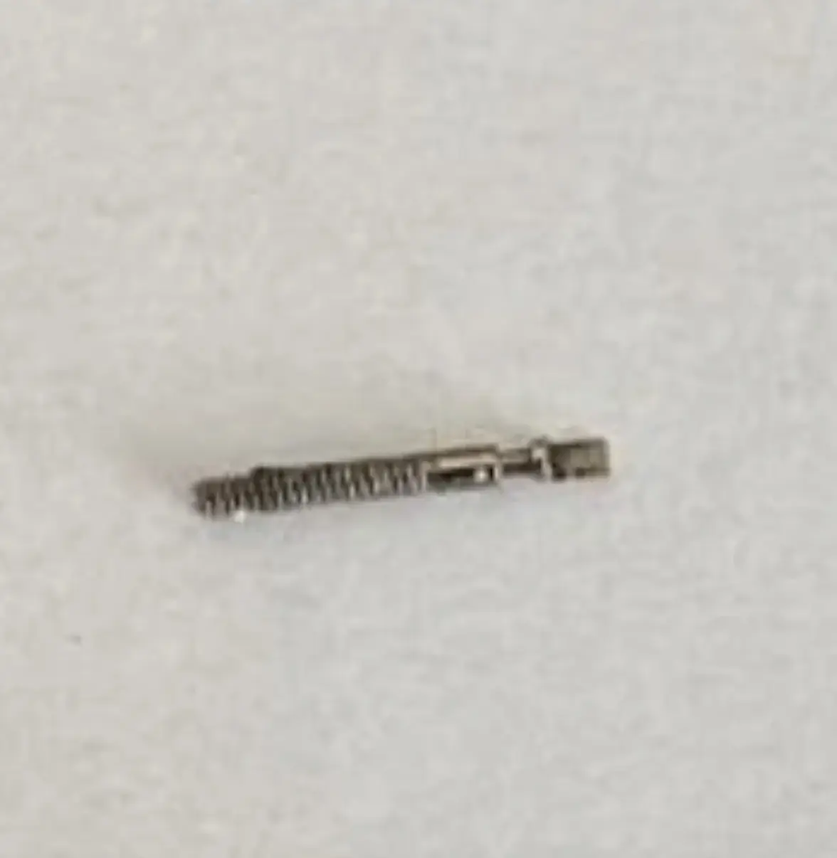

Does anyone know which stem I need for omega 1378 outer stem it has the 210.001 eta
But is omega 1378
I bought a outer stem but doesn’t fit from cousins
Case number 195 0078.2 thread size tap eight
2,382
2,549
What part of it doesn't fit? That looks like the ones I see, a 1378-9100. According to Emmy watch/a bunch of listings it should actually be a tap 11.
Also, you say 'outer stem', but that in the picture doesn't look like a 2 piece stem?
3
Hi the split has broken on the one in pic
I need the outer stem as there is one part in watch and the outer stem as shown in pic is broke cal 1378
2,382
2,549
There is some language mis-match here. That is supposed to be the part that goes into the watch side. ARE you looking for a CROWN? The little knob that goes on the end of that?
3
Hi no I want the outer stem it’s a two part stem but the original one is broken where it joins the inner stem
2,382
2,549
Got it! Actually I was a bit confused, that stem photo LOOKS like it has the square part on the end, so it looked like the 1 piece stem.
Split stem seems to be 1378-9140 and 1378-9120 (outer and inner), but the listings I see list the former as tap-13.
I don't see any listings for 195.0078 on the publicly available lists I have, so I can't help more specifically than that.
