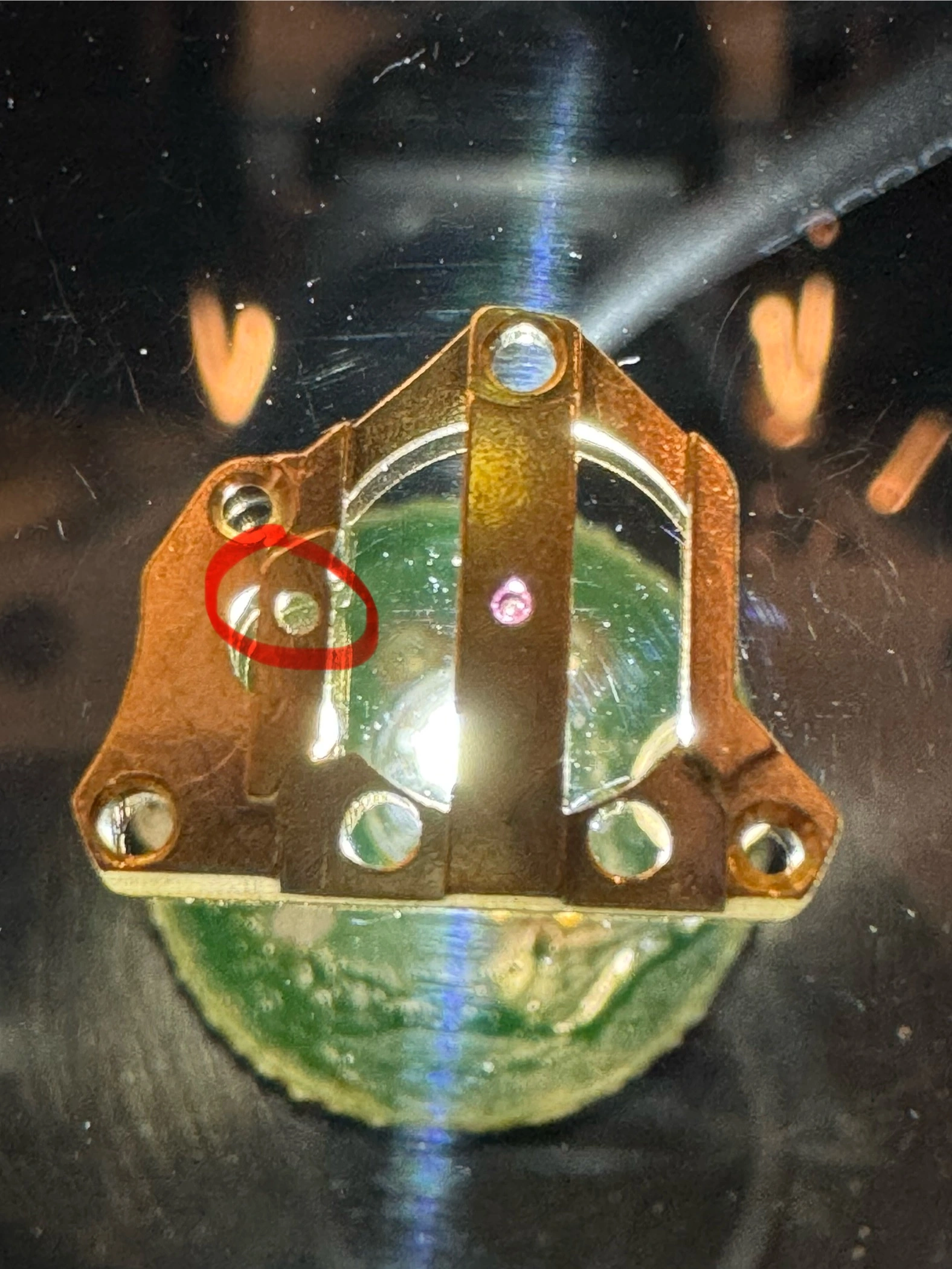

Troubleshooting movement in 198.029 and found that the gear train bridge is missing a jewel! "Well there's your problem!"
Anyone have a 1250/1255/1260 bridge in a parts bin or know of a jewel that will fit in that spot?
Bridge part # is 1250-9002
Thanks!

Silly question, but aren't jewels available in tons of sizes? Could you just use some gauge pins to figure out the OD and a micrometer to figure out the pivot size and order one? I see esslinger has an assorted set for like $13: https://www.esslinger.com/hole-jewel-assortment-for-watches-100-pieces/
You MIGHT need some reamers to enlarge the hole in case you don't find one that matches perfectly (and it might be worn out, since why else would the jewel fall out?), but I would expect these to be available in a ton of sizes.

It's a rebadged ESA movement? You might have more luck in seeking out a 9162 or 9164 part.

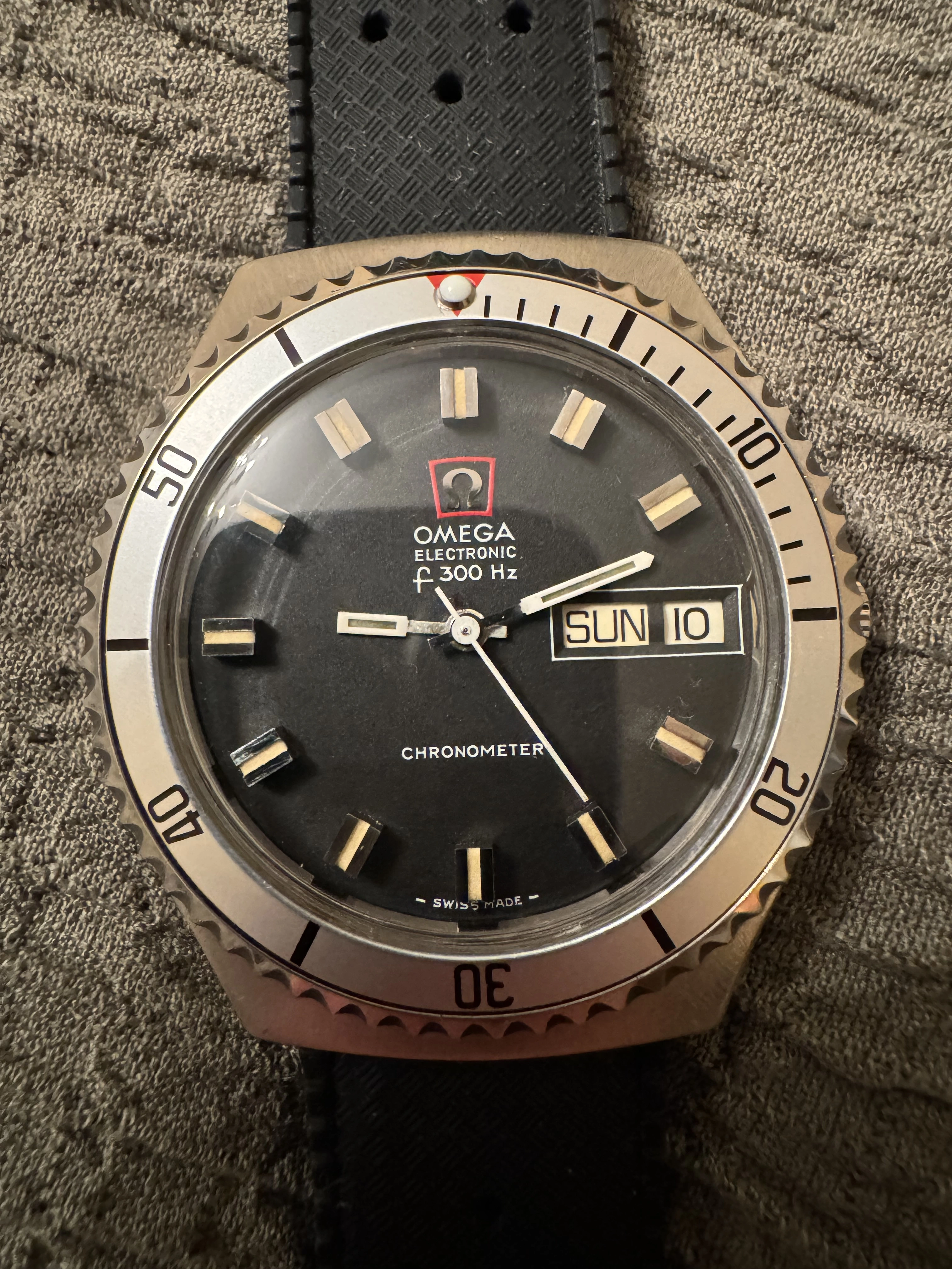

You presumably know that the bezel fitted is very wrong?

Thank you. I ended up finding a jewel I hope fits on JBorel. Will follow up, if so, and link the part for others.
