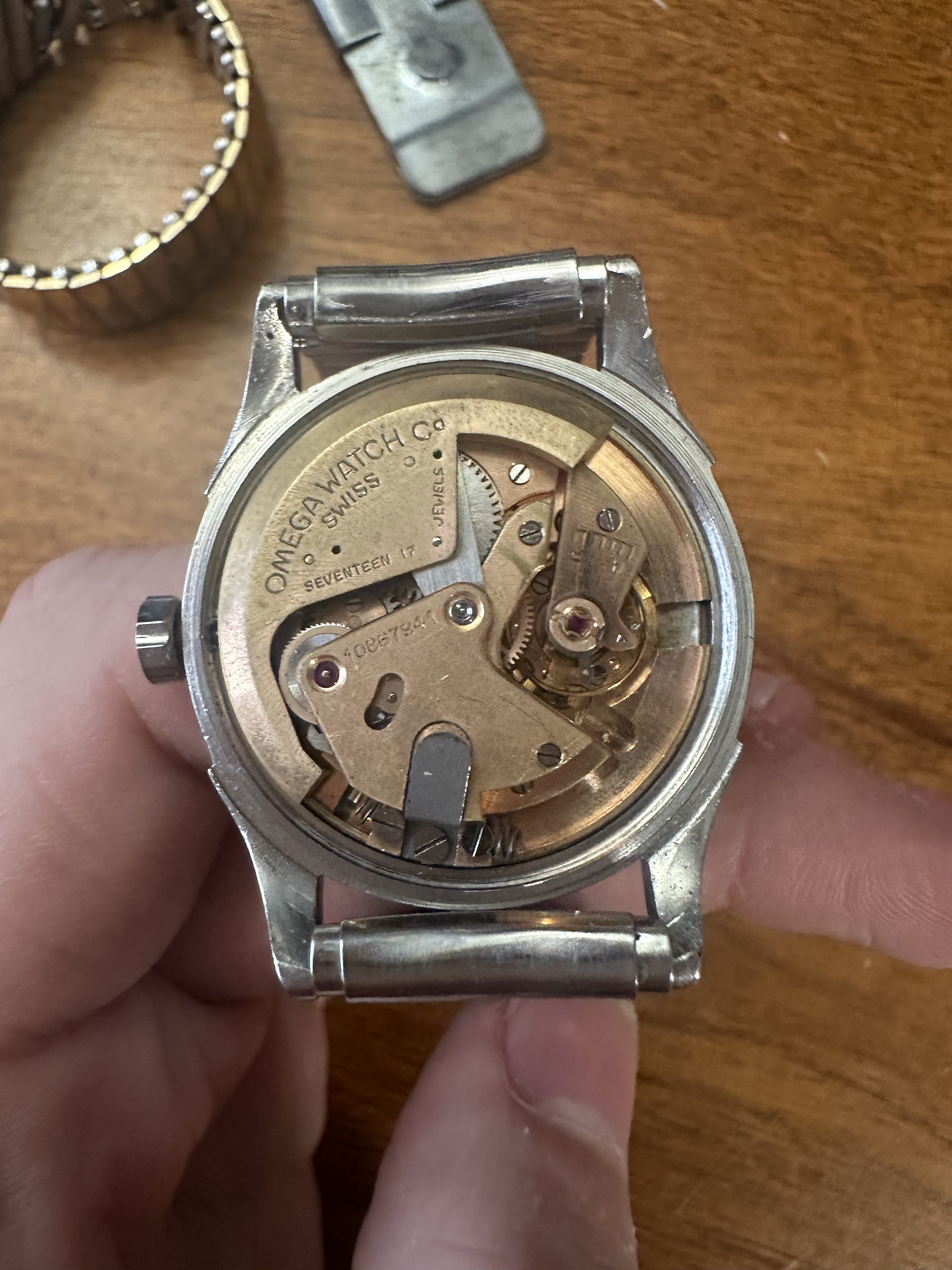

I have a 1944 Omega Bumper Automatic and recently after wearing it for the first time in a while I noticed a rattling coming from inside the case so i opened it up and the bracket that holds the oscillating weight was missing one of its screws (The oscillating weight is the style where the screws go thru the bracket and thread into the weight) So what I need help with is finding the three screws that hold the weight assembly together.
Anything helps!
Thanks,
Matt Rubin
What the oscillating assembly in my movement looks like.

There are three screws holding the oscillating weight to the oscillating weight bearing.
If only one is missing the weight would not be rattling, the noise may be due to the loose screw being trapped between parts.
It's essential that you either find the screw, or confirm that it's no longer in the movement.

One screw as mention3d would not cause a rattle.
need to check and see if any of the jewels are broken or one of the pins on the rotor arms is not broken
also check the other screws for tightness

Do you have an actual photo of your watch's movement?
A nice big clear one.

Its not the screws making the rattling, its the oscillating weight that is missing two of the screw causing it to shake and thus causing a rattling sound.

In case you cant read the S/N it is: 10867941

Sorry if I'm missing it, but I don't see any empty screw holes. There are a couple of small holes on the weight, but screws don't go there (at least not from the top side of the weight). I think yours is a cal 330 maybe (edit: sorry - I was still waking up, totally missed the title of this thread)? Check Google images for comparison photos.

28.10s had the weight screwed in from the back which is why you don't see screw heads.

30.10, 332, 28.10 Notice on the 332 where they went to screw on either side of the word "jewels"

Yes the screws go in from the bottom (thru the bearing plate and thread into the weight). The one silver dot to the left of the word "Jewels" is the only screw left holding the weighted assembly together. The screw to the right of the word "Jewels" and the screw above the word "Seventeen" are both missing.
