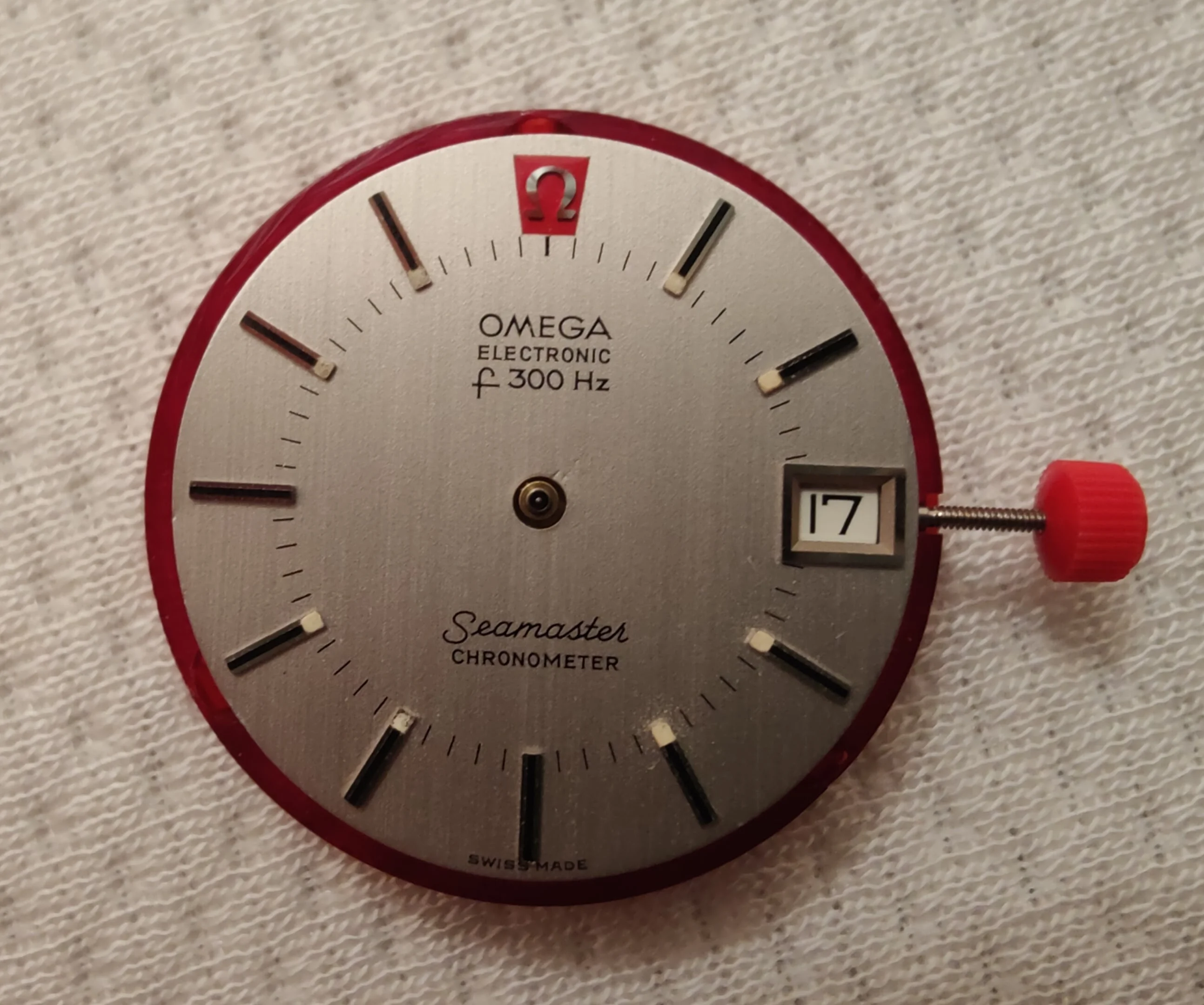

Hello everyone,
Just wanted to check if anyone knows if I could use the 1260 (day/date) movement interchangably with the 1205 (date)
Basically the 1250 in a constellation is not running, and I had opportunity to purchase a 1260 at a resonable price, would the day wheel be an issue?
Any help appreciated.

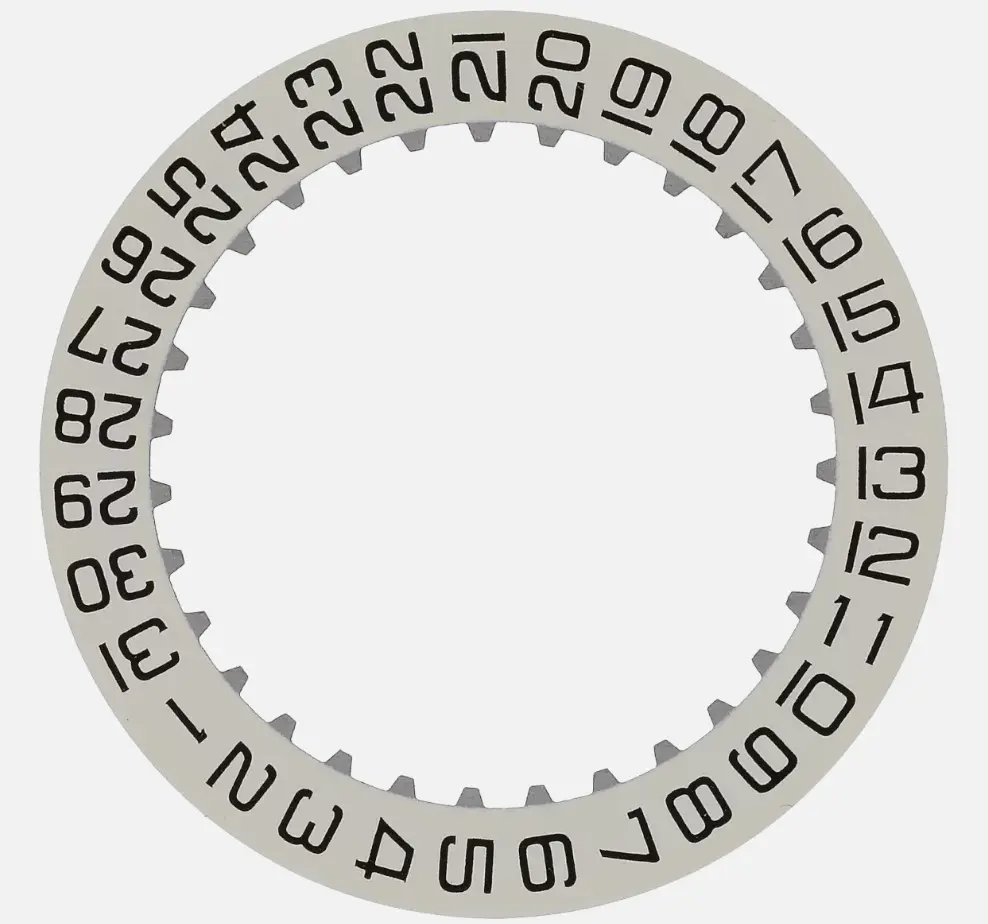

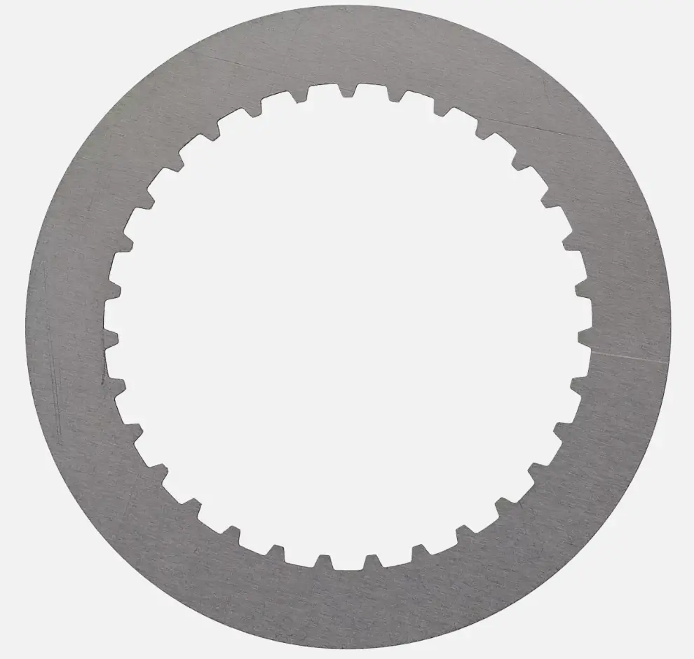

1250 and 1260 date wheels are different and not interchangeable. The best is to get hold of a metal datewheel. You can find them on eBay from time to time

Thanks i will absolutely buy a few of those wheels, i guess rephrase my question. could i just put a 1250 watch face on a 1260 movement? or will the date not line up? or will there be any other problems?
403
998
The date disk is in the same position so it will line up just fine:
But, the 1260 / 9164 is 0.7 mm thicker on the dial side of the stem so it won't fit the case. The oscillator module is the same and interchangeble. So a quick fix is to just transplant the module.

Anyone know where I can source an original 1250 plastic date wheel in the gold colour rather than standard white please? I already have the only one I've ever found listed on eBay. I need to find another one ideally🤞 Any help would be greatly appreciated. Thanks.
